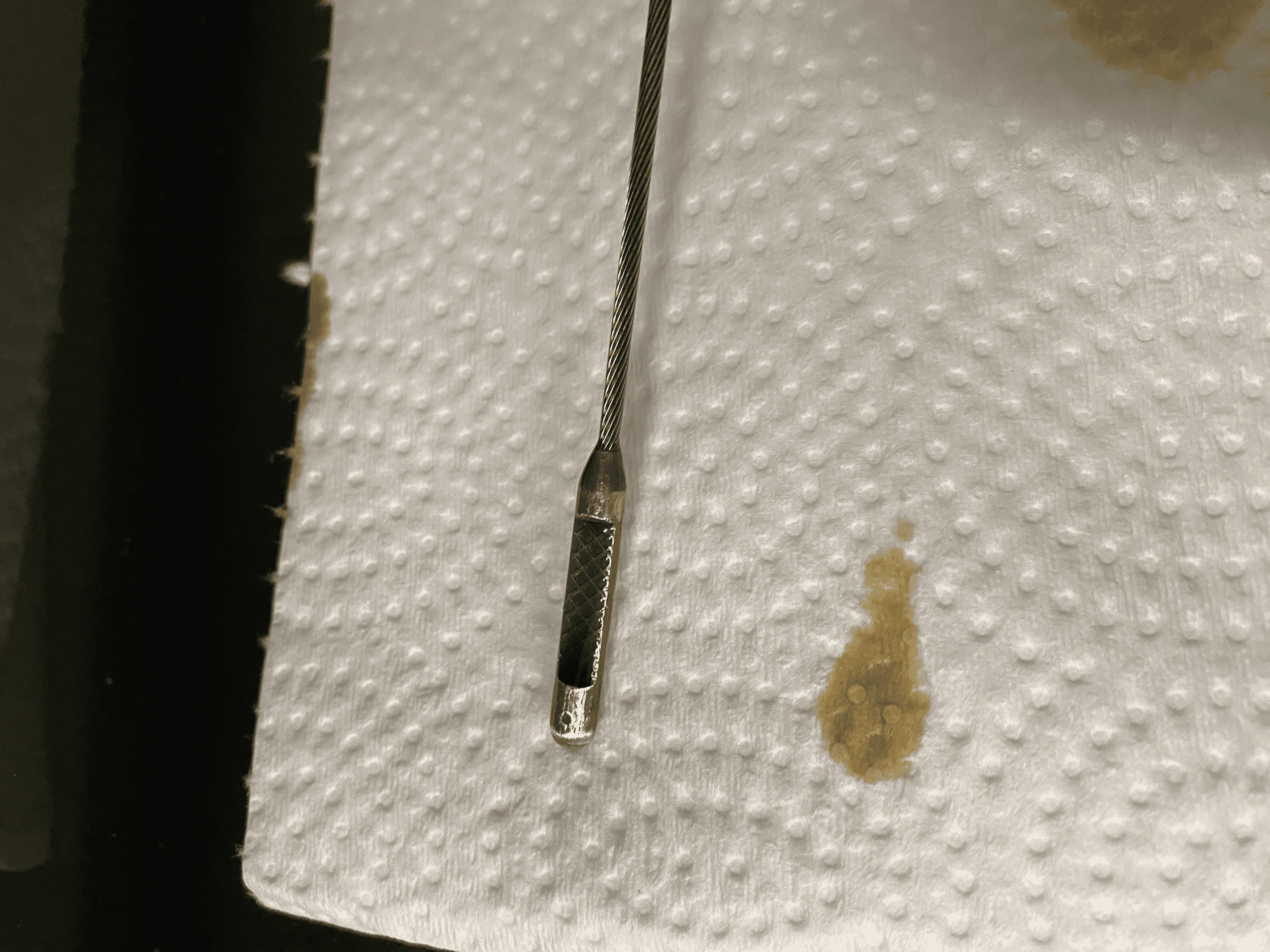

I do all my own oil changes as well but "free" is too good to pass up sometimes. If I put the oil in, I have a lot of faith in it. Maybe I'm reading this wrong as it is my first braided wire dipstick. There is a little bit of oil on the braided wire, here is a picture of the dipstick fresh off the pull.
Jeep Wrangler JL Jeep Wave Overfill? 1686278254624
EDIT: Maybe it's spot on, when I run a paper towel on the braided part there is clearly a little oil. I think I'd feel better forgoing my 3rd "free" oil change.
With 5 quarts it's often just above the cast end and onto the braided "stick". All of my 3.6s have read that way even with the exact amount of oil in them.

...here is a picture of the dipstick fresh off the pull.
Not sure I'm seeing what you're seeing. Looking at the oil on the stick itself, and the impression on the paper towel next to it, it appears to me that the oil just goes to the tip-top of the cross-hatching, which is exactly what you want.
Perhaps it looks different in person, and it's not coming through in the photo?
You've already let some oil out, so it's resolved now. But for other folks looking at the thread, if my dipstick looked like this post-change, I'd smile and say "perfect."

After my first Jeep Wave free oil change, I checked my dipstick too and it was really hard to tell. New engine and clean oil is hard to see on the stick. I wiped down the stick and was still having a hard time seeing it. It was indeed higher than the cross hatch marks, but not knowing exactly what 5 quarts looked like, I had a hard time telling.

I used to see the same dipstick complaints on an NC Miata forum I was on (same style of dipstick).
The key to getting a good read on these, is to wipe them completely clean (zero trace of oil), on the cross-hatch area prior to reinsertion.... (that sounded a bit strange ??).
This makes reading these dipsticks a snap.
