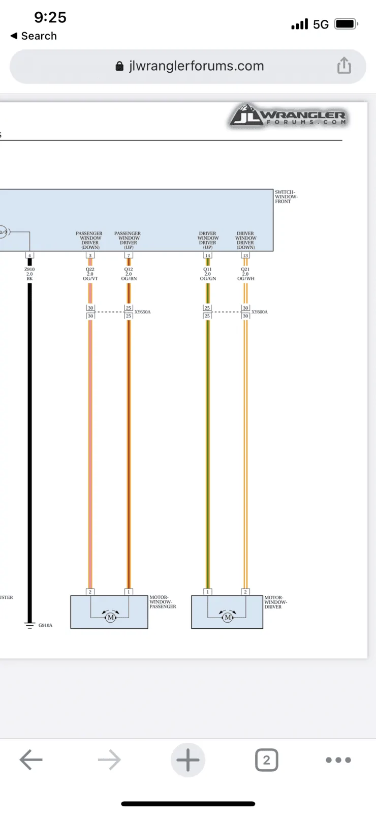

I was assuming there would be can bus involved, but looking at the diagrams it may not be.
Looks like you can just splice a momentary switch in line with the up circuits behind the factory switches.
Edit Should be able to do a single discrete switch to roll them all up at the same time.
