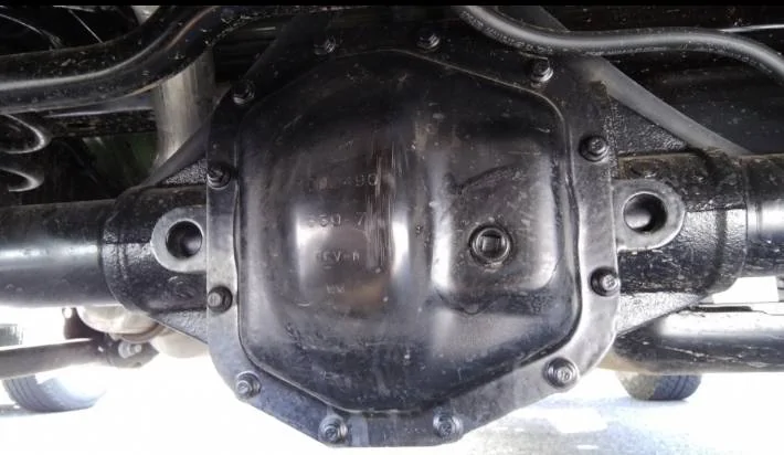

I have a 2022 wrangler unlimited Sahara,.
See attached picture
Can anyone tell me what it is?

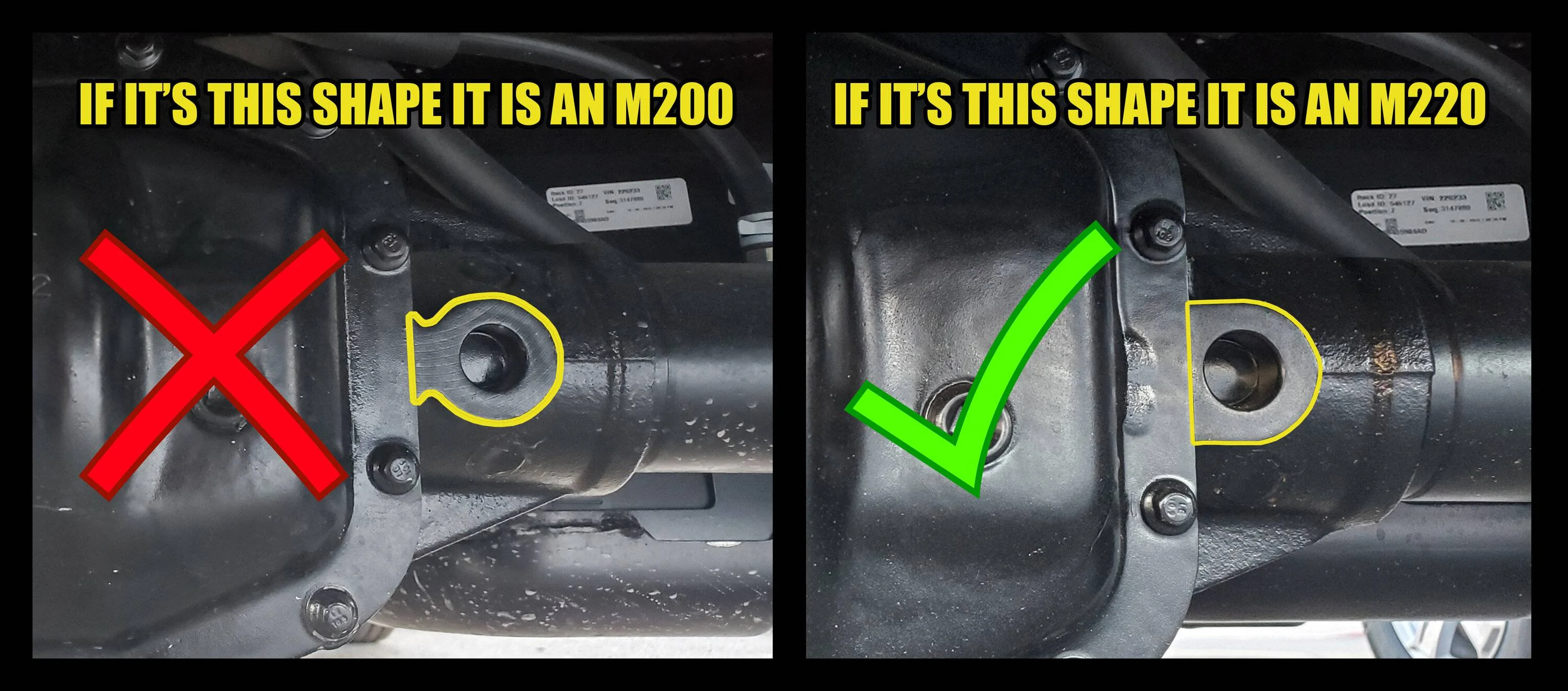

That’s a D35. Aka M200.
This is a D44 (aka M220)- note the rectangle that the fill plug exists on is larger:
Jeep Wrangler JL identify my differential? 60C77F96-3A05-437D-8539-50CF46F9B16A
And there’s this too-
Jeep Wrangler JL identify my differential? 29A61127-2EFF-492D-91B4-8AC3A0F47033
Edit: I should clarify that what we commonly refer to as D35 or M200 and D44 or M220 aren’t technically the same axles. The M___ axles were released with the JL.
Definitely not the same--the 2xx number is the diameter of the ring gear in millimeters.
