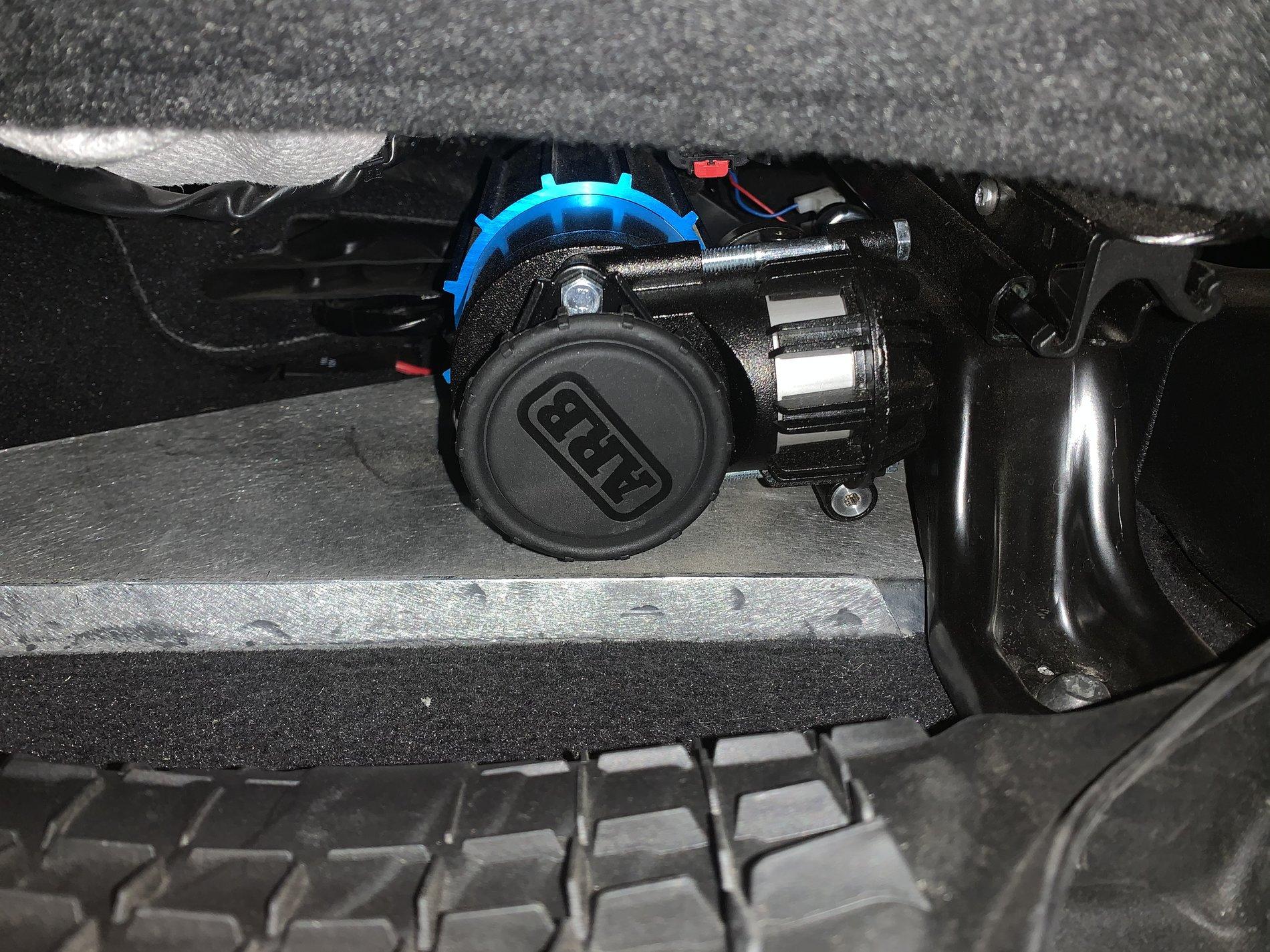

I don’t turn the compressor on until it is hooked up to the tires. The blow off is inline between the output and the air coupler at the end of the hose mounted to a tee. The arb comes with an integrated blow off as well but using it over time can cause leaks if it gets corroded/ sticks. ( per arb rep).
