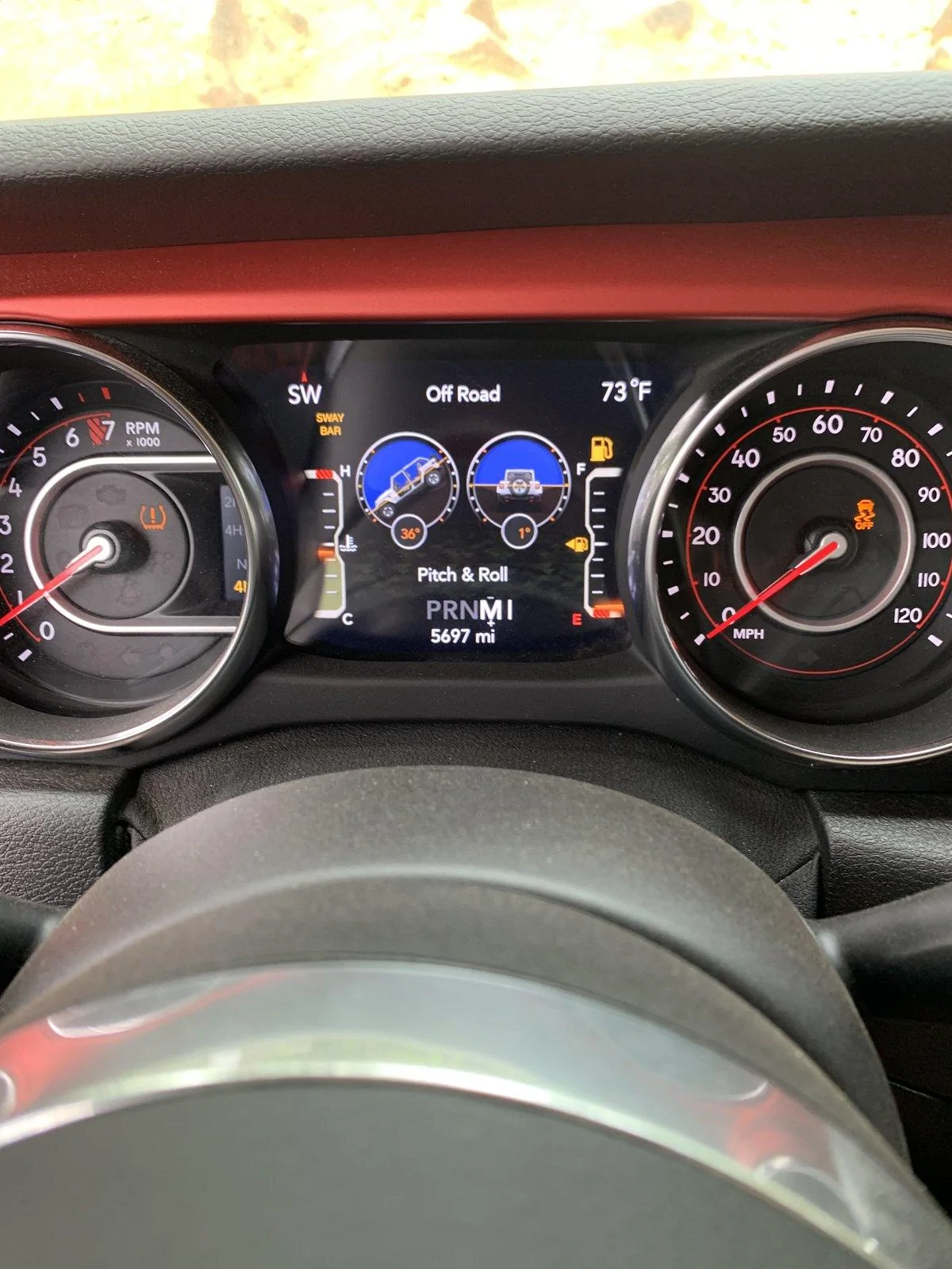

I hit 27 degrees this past weekend. Butt puckered up for a second when the tire slipped. Will try to push it farther next time to find your answer :rock:
30 isn’t too bad. Got a lil worse later at SMORR Jeep Jamboree today

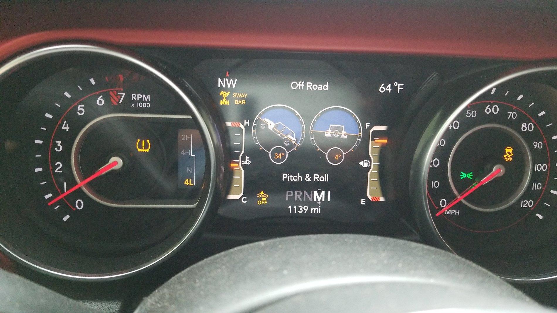

I decided to try my first hill.....
Do I get man points or stupidity points?
I have 3.5" metalcloak lift with 38" tires.

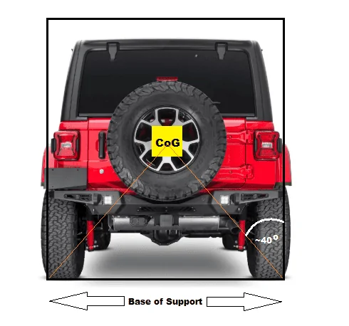

It is a physical fact that any object will tip over only when its center of gravity gets outside its base of support. A jeep's base of support is easy to measure -- it is simply the vehicle's track width. The center of gravity, however, is not so easy to measure. A stock, static vehicle by itself will have a very precisely located CoG, but fuel tank levels, lift kits, mounted accessories, and occupants have a huge effect on the dynamic CoG -- especially the number, placement and weight of occupants. For instance, a single occupant in the driver's seat will raise the CoG of the vehicle slightly and move it a little to the left. A driver plus two passengers in the right front and right rear will raise the CoG even more, but move it slightly to the right. Yes, placing two occupants on the uphill side of your vehicle will help significantly.
As long as you keep your CoG over your track width your are in good shape, provided no additional force is applied (like momentum) which would swing your CoG past the tipping point.
In the Wrangler diagram below, if you assume the CoG is at the center of the spare tire mount (quite conservative, even with four occupants), I calculate the rollover angle would be roughly 40-degrees. It's easy to see how lowering the CoG would increase this rollover angle.

Agreed! A bone-stock Wrangler is capable of some pretty amazing feats of physics.
