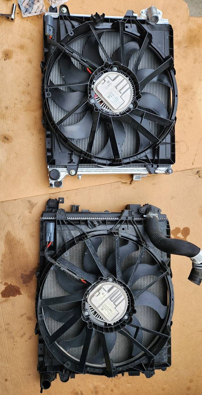

In the picture below, you see two fans with radiators. Both are factory fans. The original fan on my 2018 3.6 JLUR is a 650w fan on the bottom. Note the narrow cord of the blades. The fan on top is a 850w Gladiator fan with wider blades and more power to turn it. Plug and play. The harness on all the jeeps are the same. You will need to change the z-case fuse from 60 to 100 watts for the fan.
And you can also see the radiator in the top is all aluminum. This is a Mishimoto higher capacity radiator. I installed it, but even without it, but with the other three mods (especially the RPM Extreme fan controller), you'll see a large drop in temperatures.

I think you'll also note that even the JL driver cluster gauge doesn't move much. That gauge is intentionally programmed to not move much out of the center of the range, even when the temparture is running 235F. You have to pull up the actual temperatures to see any change in the gauge.
Once I installed the RPM fan controller, larger grill mesh, 850w fan, and the Mishimoto radiator, my temps run more steady and about 20F lower across all conditions.

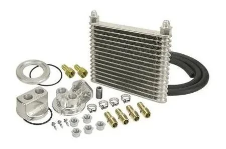

Folks,
I see allot of emphasis on radiators and fans. Which is great. There are many ways to get that engine cooler.
But another way is to install and oil cooler. Its smaller and even with a fan can cost less than a ungraded electric fan alone. There are many varieties, some with fans and others with just fins.
In my experience with tractor oil coolers most will cool engine temps as much as 10 degrees. But average was around 4 with RPMs around 3-4,000. With tractors speeds at 3-6MPH average depending on tilling or harvesting there is not much air going across the radiator as you can image. Also radiator screens get plugged my field debris at times. So manufacturers have leaned to remove heat buy cooling oil as well.
I believe for me if I get a high mounted winch, Ill add an oil cooler to my Rubi to supplement lost air flow to the radiator.
Heres one of the more expensive ones. From Summit racing at ~$150.00
