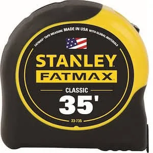

Tape measure, angle meter, digital level, length of string. Flat surface, hopefully concrete.
Here is the deal: WeBeAlignments and Stomach Pump Room has a $18,999 laseer machine and they can align down to 1/10,000th fo an inch.
Or so they say.
Can the Laser get down to 1/10,000th, BET ON IT if they have the right one, however its all EYE WASH.
You see you suspension system is put together with Rubber bushings, KEY WORD, RUBBER, so accuracy is a mute point as long as you get get it down to a few degrees +/- you are good as the shop.
Few tools, some string and a digital level and bingo you are as close as the $99.95 alignment at the Stomach Pump Room.
