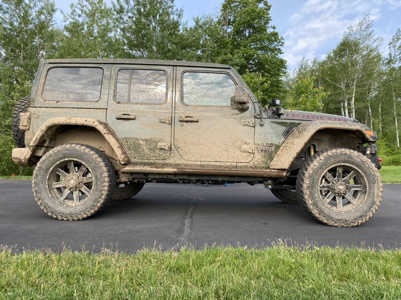

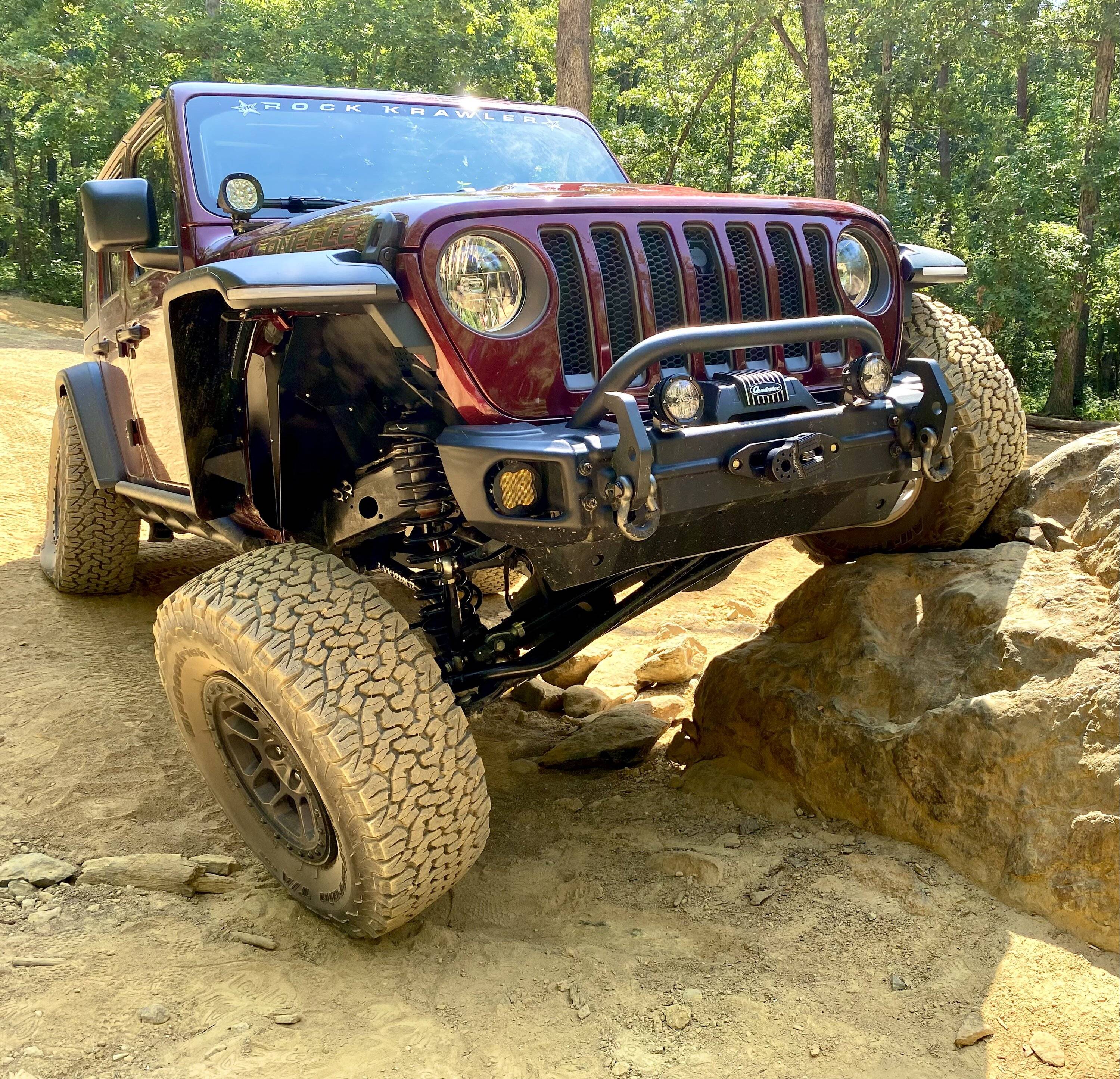

AEV 2.5 Dual Sport RT with 37s (very small 37-KM3s) does just fine.
Simple kit does fine for my needs on moderate trails and drives great on road.
I drive 600 miles on road to get to uncrowded areas and remote locations. So that played into my buying process as well. Wanted it drive great on road and to keep in simple, knowing full well it has much less flex than other offerings.
Front bumper and winch incoming.

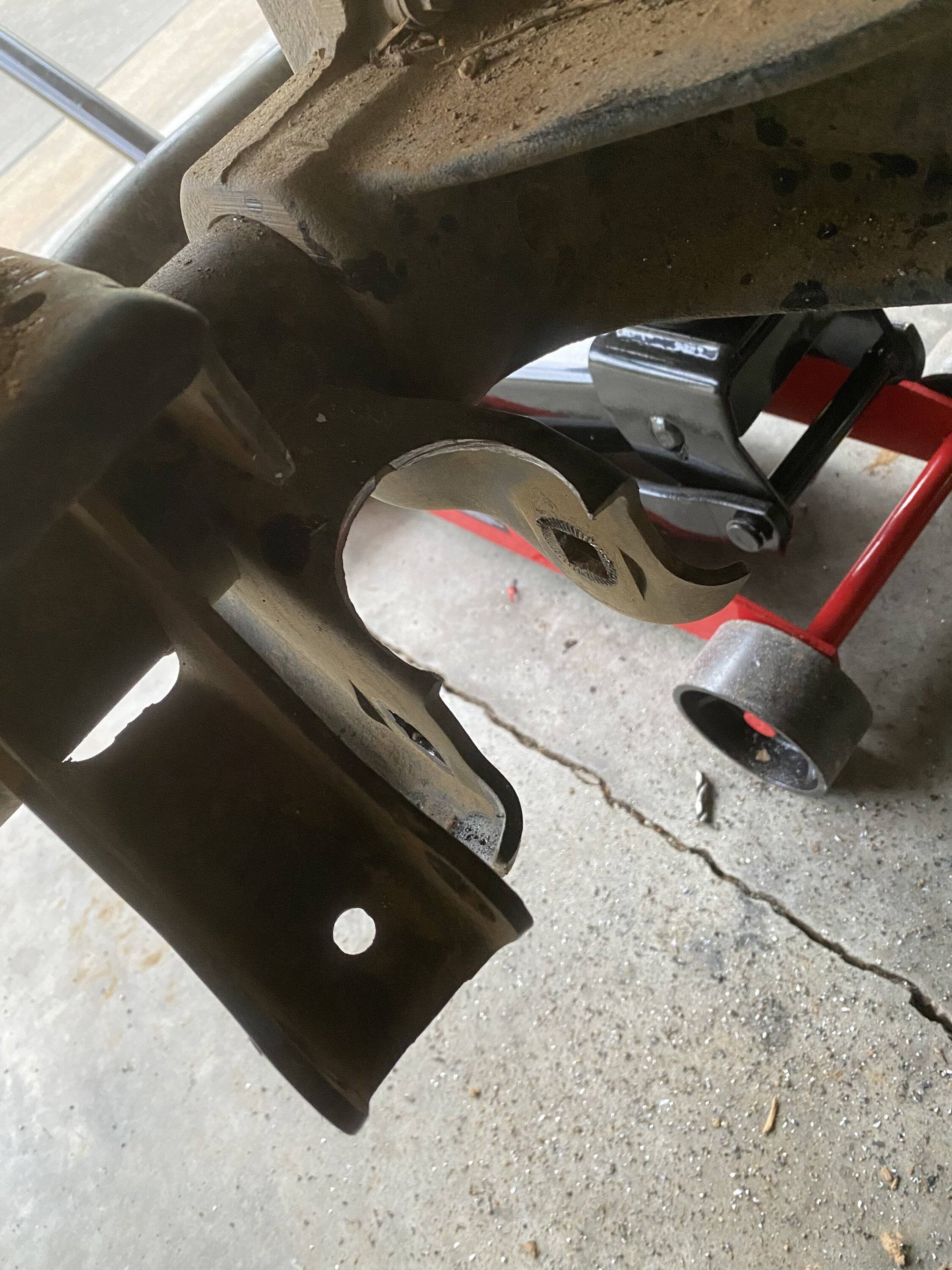

Any consideration towards Rock Krawler? I have the 2.5” Flex no limits lift with the Rock Krawler TT shocks. I have done light to moderate off-roading and really appreciate the extra flex.
On road handling is great and off-road it provides lots of flex. The height will be as advertised.
The install is very straight forward. You will need to clearance the front axle LCA mounts. Easily done with a hole saw. You will also need to remove the brake line brackets that attach the front brake line to the front LCA’s. I did this with a Dremel and vice grips. Bump stops were not included in the kit, but I don’t need them with the XR. I did add wheel spacers because a had a slight rub on the front control arms . Minor maintenance will be required as far as greasing the joints occasionally.
I remember when I was getting my RK kit I saw your build thread on it. That’s an awesome Jeep.
When did you purchase your kit? I also got the 2.5” flex system with the TT shocks (which, so far, I’ve absolutely loved) but with mine I didn’t need to cut into the mount since they had switched to maintenance-free joints. And I also had rubbing on my LCAs, I just did a steering stop extension though.
