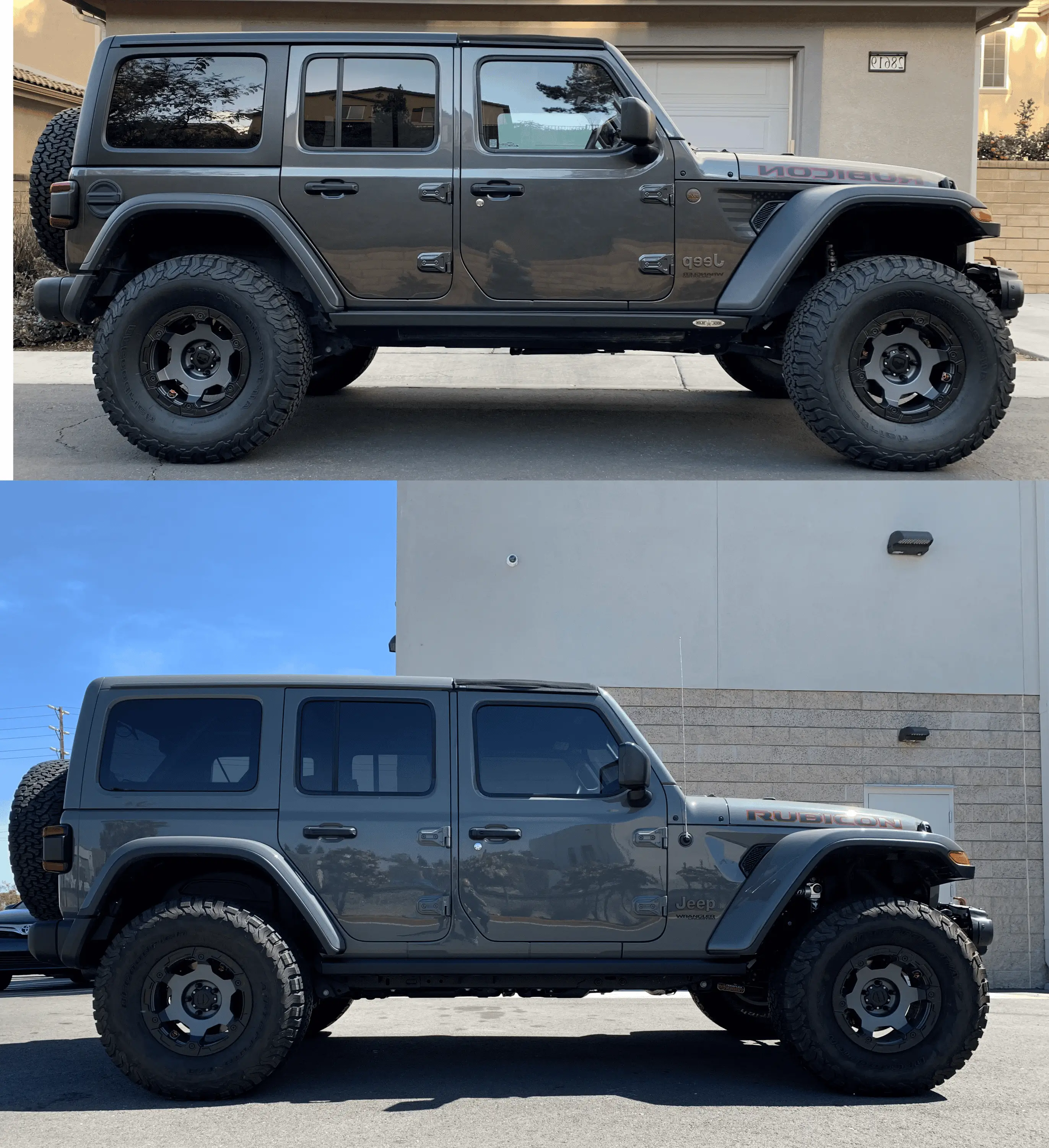

I have had a JLUR 3.6 with a Mopar lift and 37s (top picture) and now a JLUR 3.6ET with the TeraFlex ST2 with 37s (bottom picture). Both are great. Between the two I like the TeraFlex more.

The Mopar lift will give you 2 1/2 to 3".
Either one sit higher?

I wish I would have measured them because I think that they ended up being almost identical in lift height.
The top one looks higher if you see where the rock rails and bumpers are in relation to the tires.
