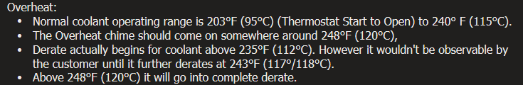

I've posted this before but it is probably good to push it out there once and a while.
It came directly from a MOPAR engineer when I was corresponding about heat issues with them a while back.
I'm old school and still don't like this high temp. On top of that, when ambient is above 80°f, the coolant temp will climb FAST...

excellent info; thanks for sharing (again)!
