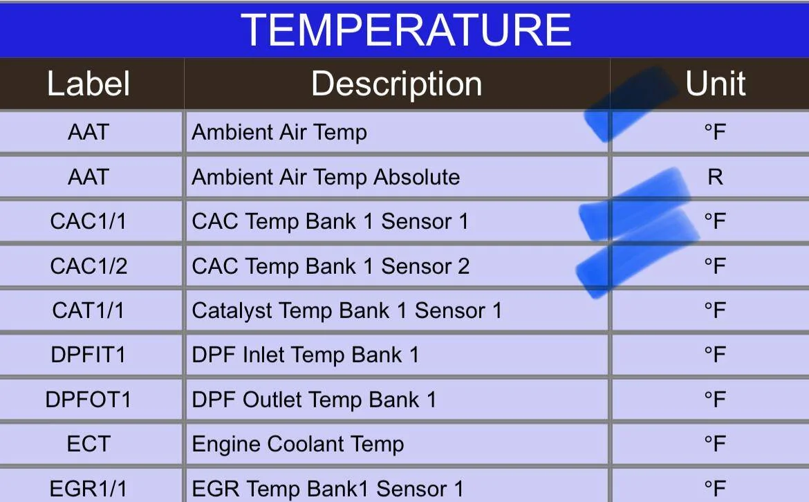

Any chance you have a link for those PIDS? I couldn't find them....

On iDash they’re all under the temperature category:

I dash shows these 2 readings ? Under what abbreviation ?
ya unless I’m misunderstanding. It’s in the image I pasted in above.
AAT Ambient Air Temp
CAC1/1 CAC temp bank 1 sensor 1
CAC1/2 CAC temp bank 1 sensor 2

I’m a bit confused but believe you. I have a derringer tuner with the gauge it came with Is there another idash?
Mine doesn’t have pages like this. But I’ll take another look
Ohhh I think I’m following- that image is from their PIDs documentation on the web. The iDash shows the first bit when you’re monitoring them:
AAT
CAC1/1
CAC1/2
