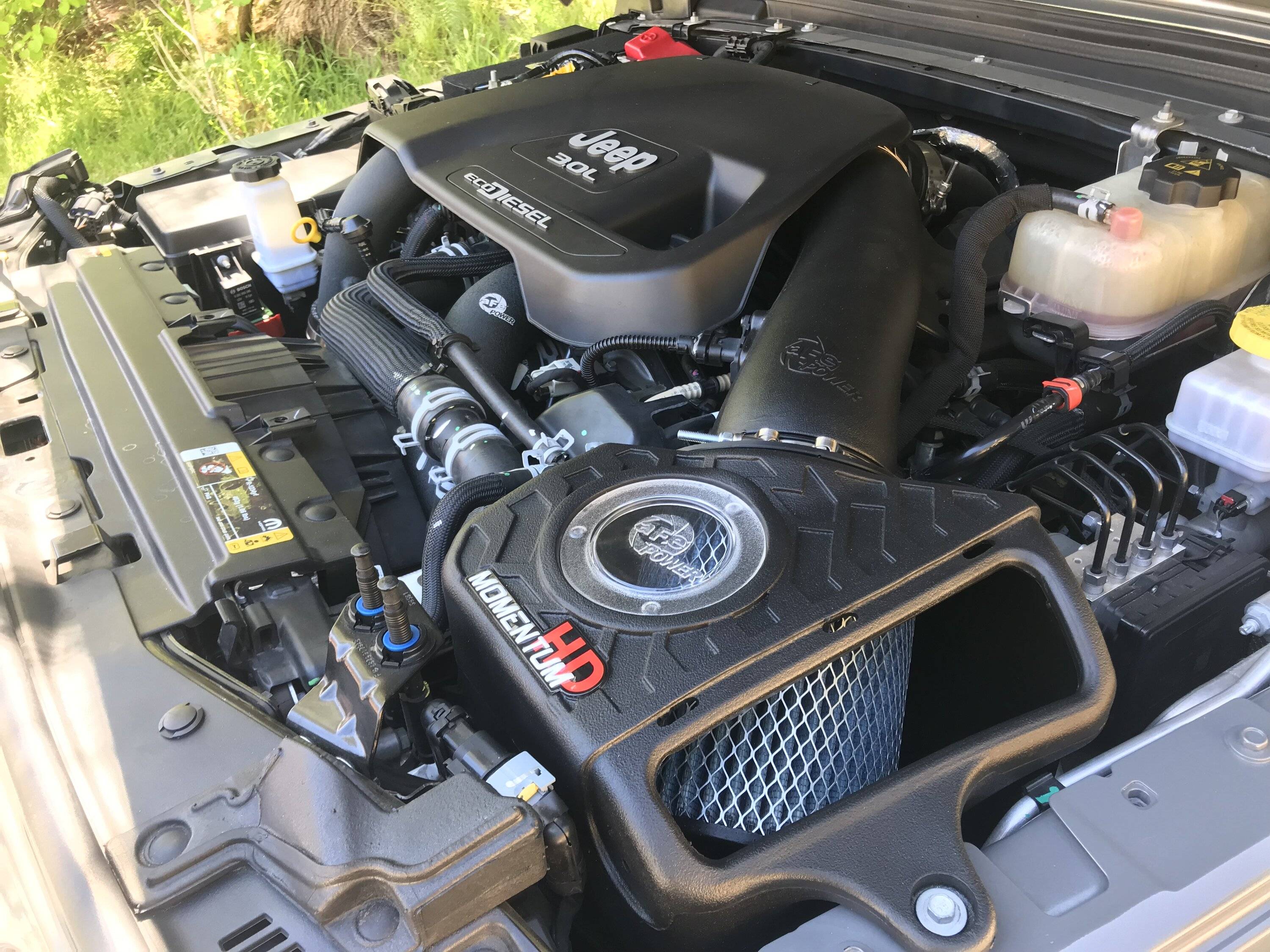

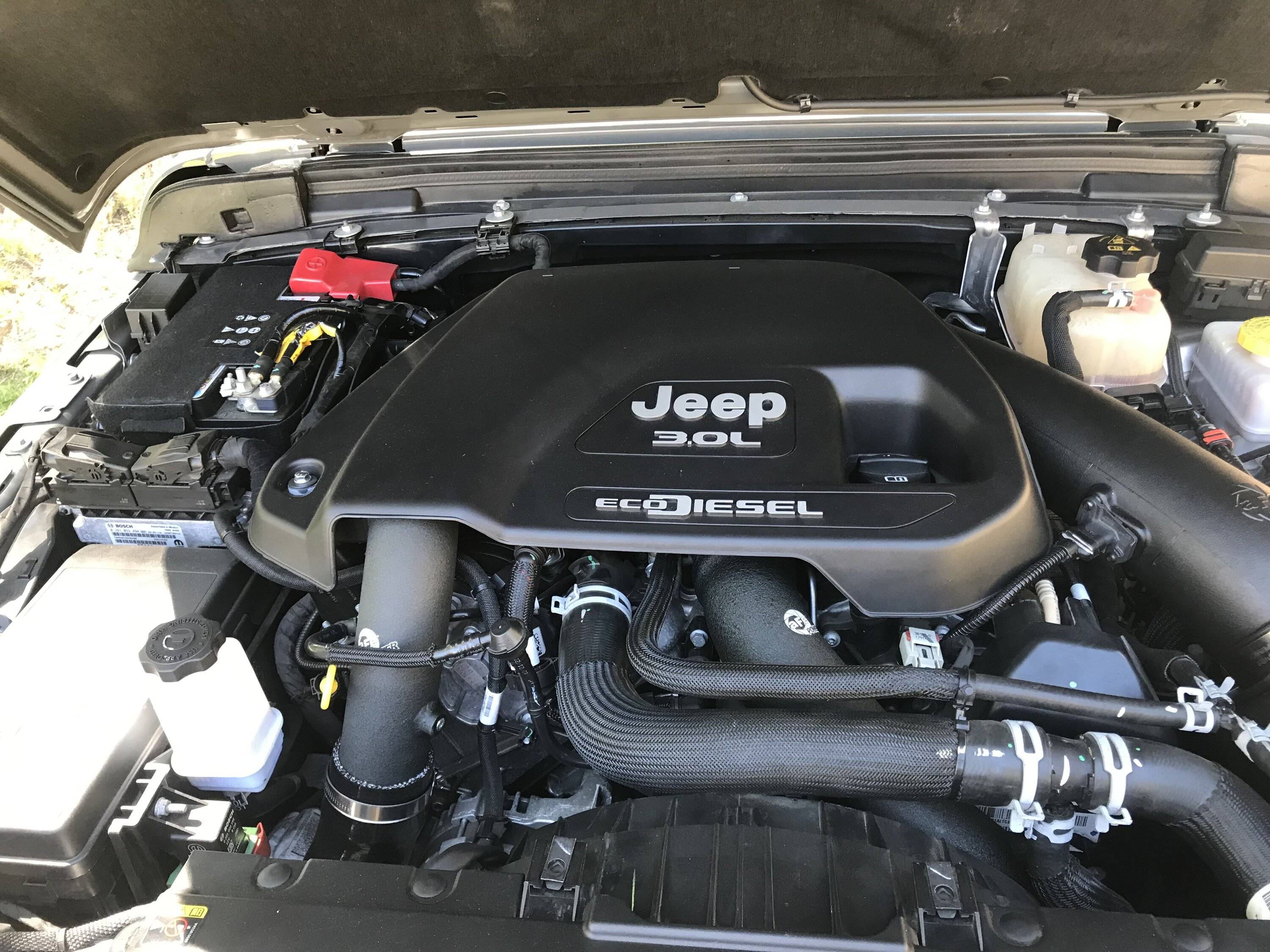

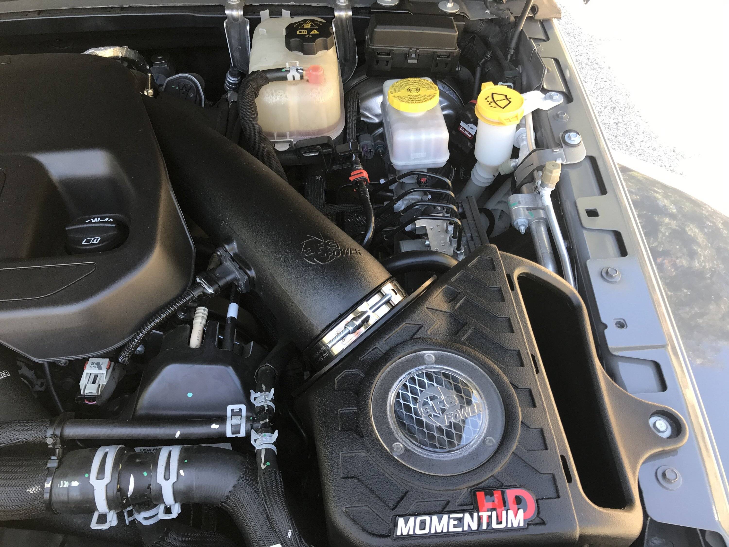

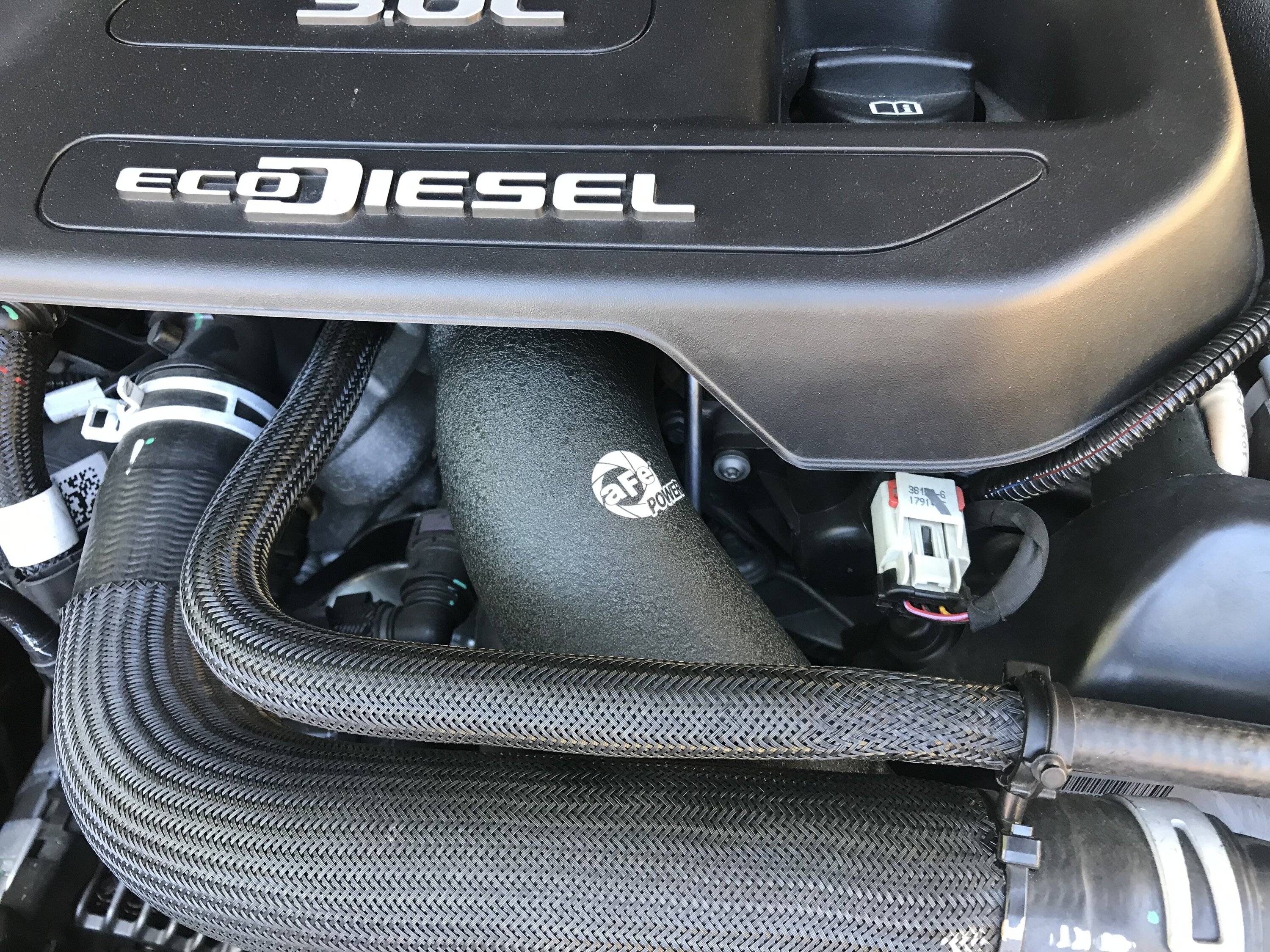

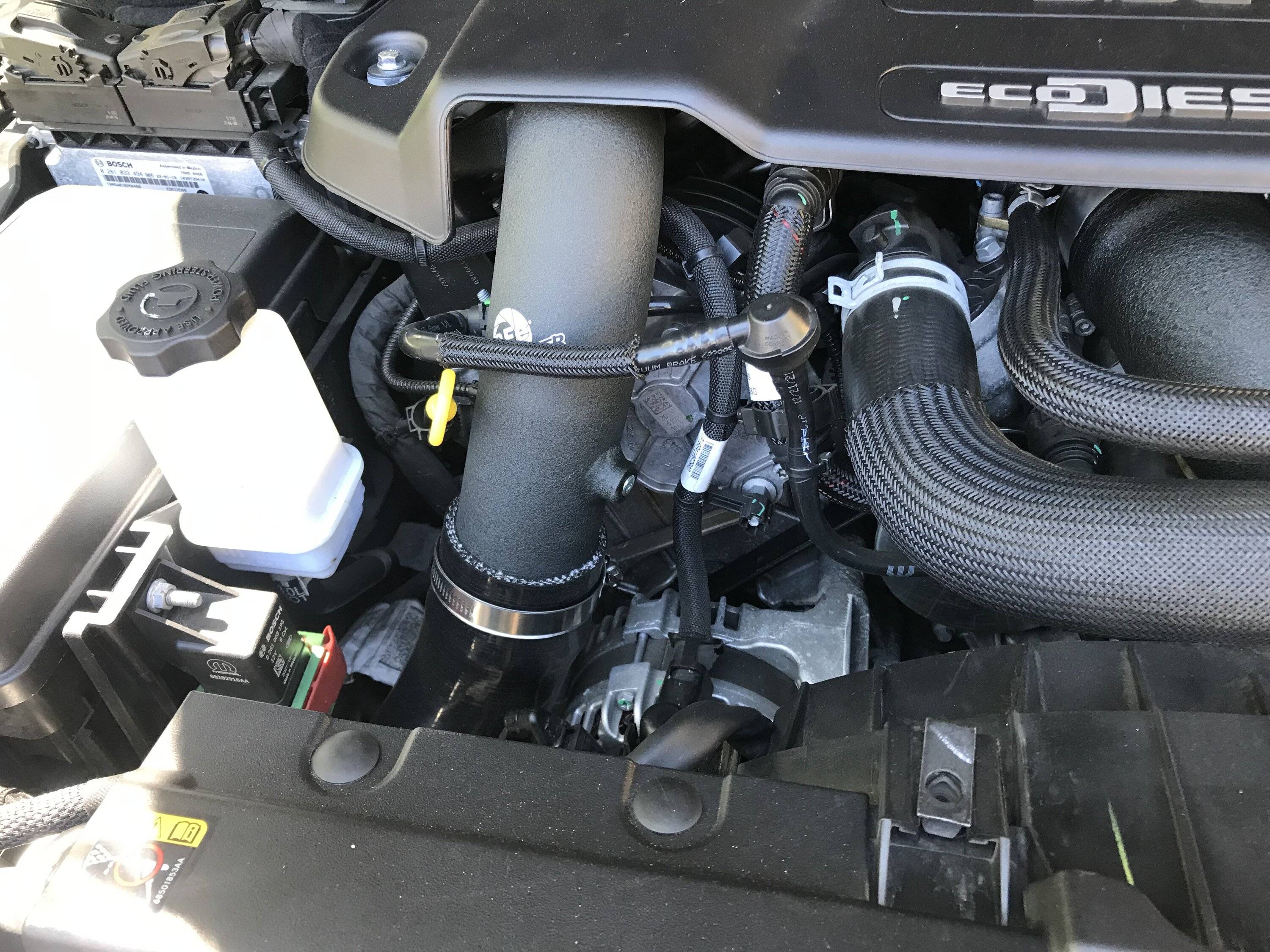

Installed the aFe air intake and the blade runner intercooler piping
The turbocharger whistle is louder and more noticeable
Great products and materials
Installation was very easy for me
l noticed a bit more easy take off from a complete stop. And noticed about 2 mpg throughout the rpm range.
Overall I’m happy and was looking for this exact outcome !
Wish I could get rid of the dpf system
But can’t At least not yet
next upgrade will be a cooler thermostat and the auxiliary radiator
And also the external bypass external oil filter system from insane diesel
then maybe the external auxiliary oil cooler with twin fans

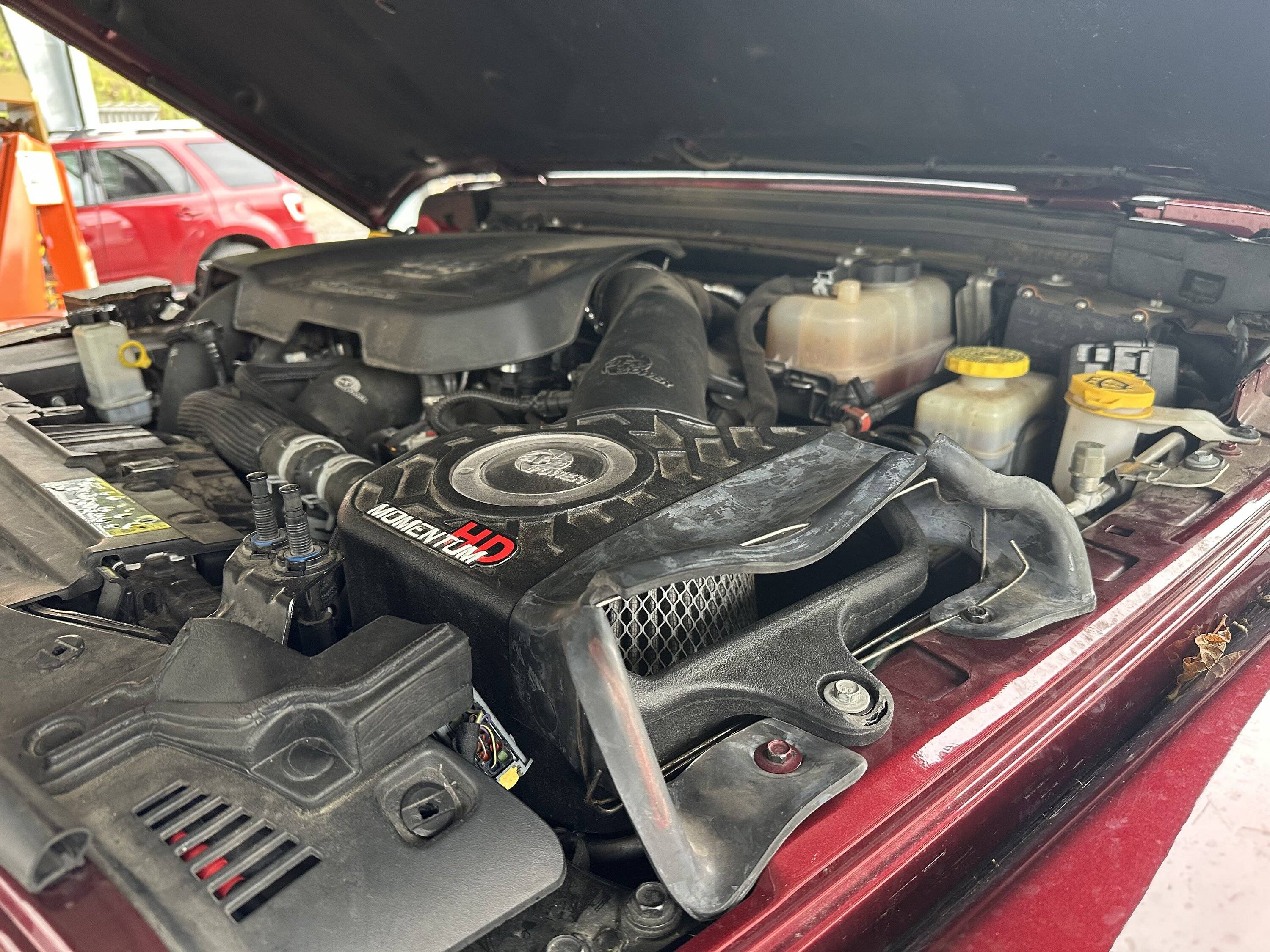

Nice! I did the same. Why not run the rubber flap on the airbox? It would help keep hot engine air out the intake
installed it after the photo I snapped lol

I ended up running some stainless tig wire around mine to keep it open. I read a lot of people had issues with it closing and causing poor performance. Not beautiful but it works
this is one reason, i installed it then took it off , the rubber doesn't let the hood properly close, and once it is closed one side is a bit lifted , which doesn't look right to me .
