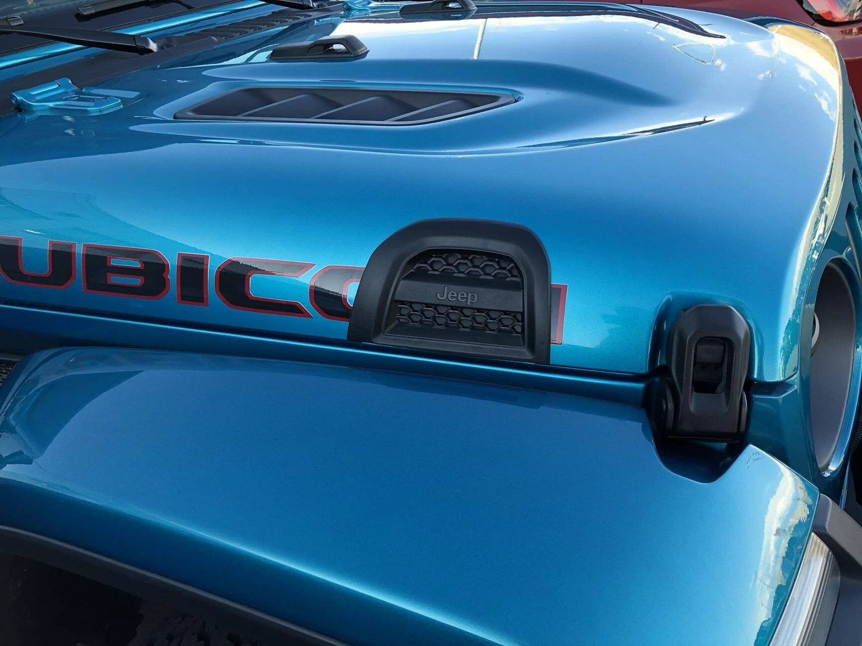

AFE makes a less restrictive intake, but I am specifically referring to this: (Example from @JPAloha 's build thread, but there are other examples)

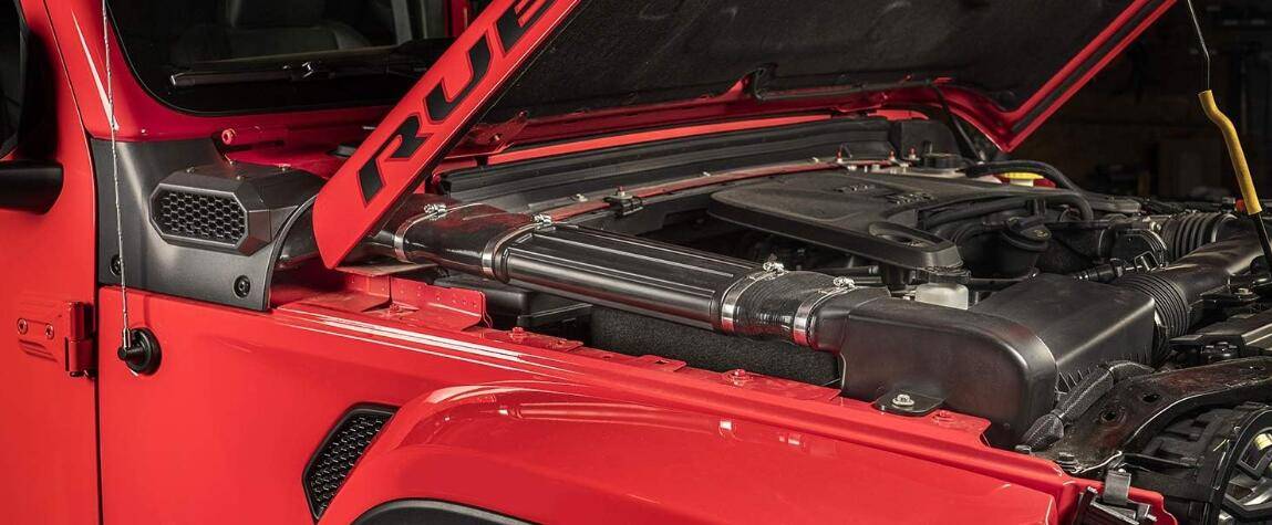

I wish Rugged Ridge made this one for the Ecodiesel's so I wouldn't have to cut a hole in the hood.

I have another vent piece on the way, my plan is to see if it can fit on the other side of the hood. It’s going to take a while to arrive from HI but I’ll post any updates in my build thread.

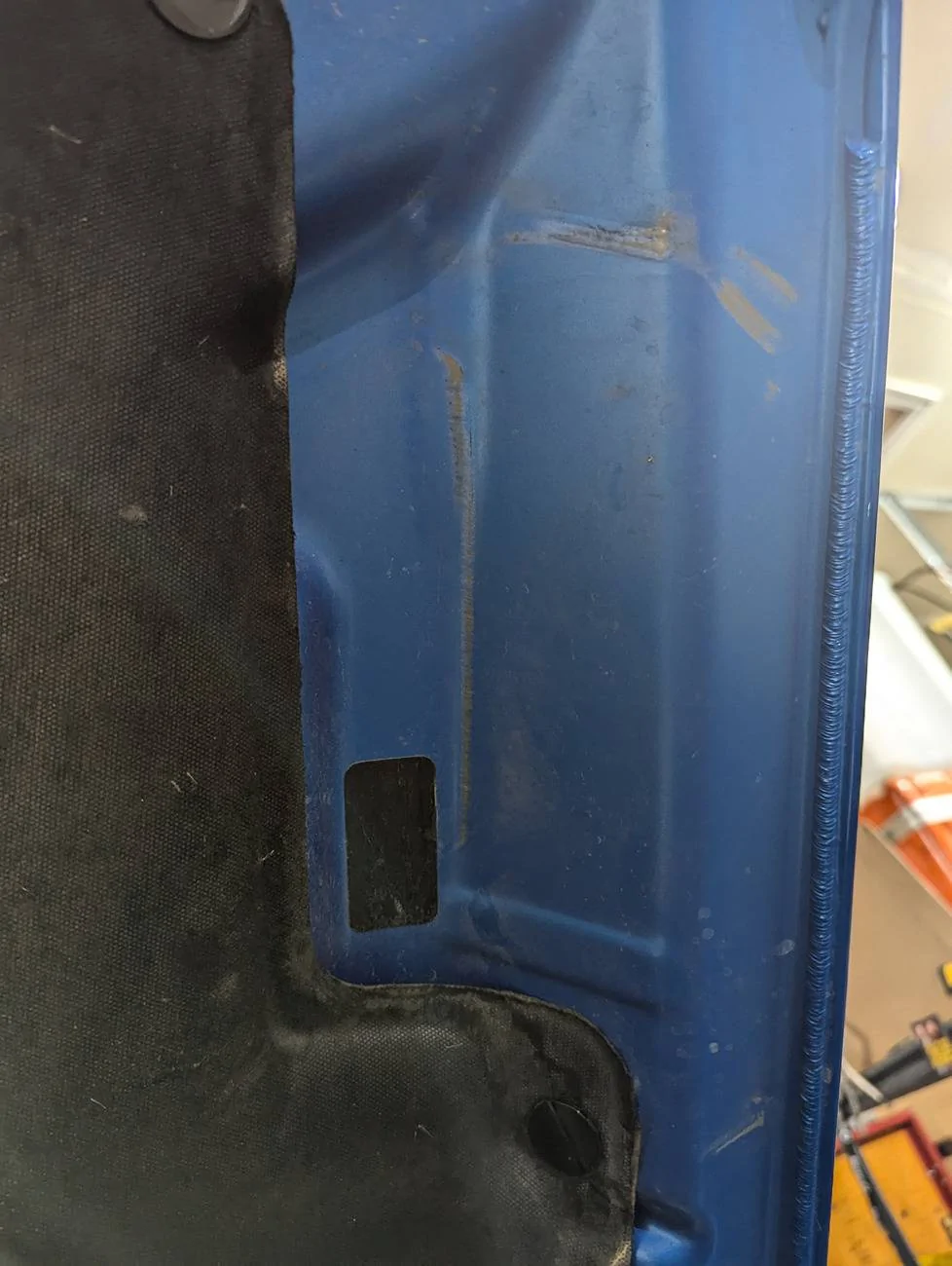

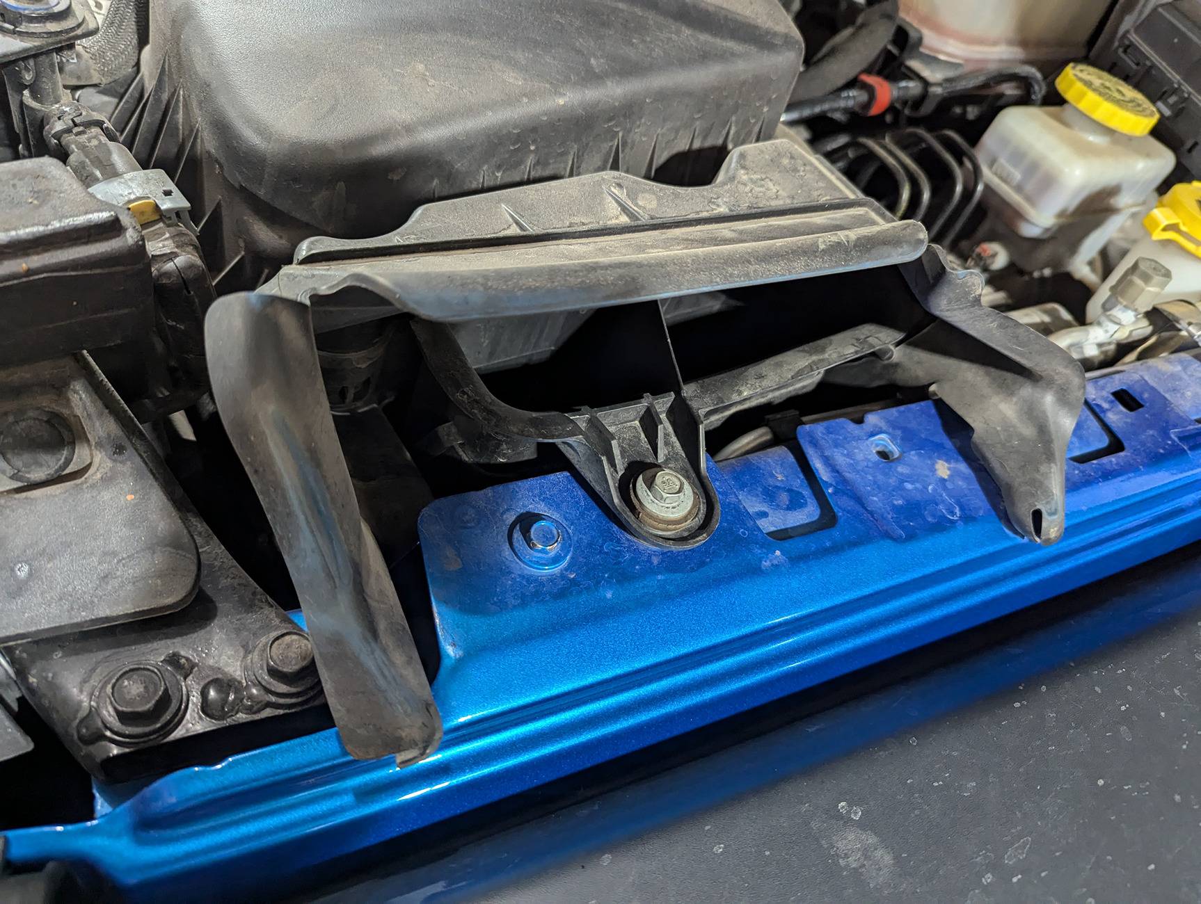

For Engine tune, I'll go Green Diesel and eventually I might get the Pedal Monster, but for me it's more about temperature management and reducing restrictions anywhere possible. My concern with restriction is that my Jeep seems to have a really good seal around the intake (see below pictures showing excellent contact between the intake seal and my hood). With how close the clearance is between my hood and body, there doesn't seem to be very much area for the engine to get ANY airflow, let alone hot/"dirty" air from the engine bay. A vent like the one which exists already for the 3.6L crowd would just be a quick way to guarantee basically no restriction. Maybe it's supposed to have more hood gap? I noticed when I was cutting my vents (again for temperature management) that the Driver's side vent is actually pushing down on the intake piping from the airbox... Maybe that's not normal and I need to figure a way to adjust my hood spacing?

Looking more closely at the cowling etc around the air box, maybe I am missing something, or maybe the vent holes on the CavFab fender liners I plan to get will be enough to get more airflow to the box...
