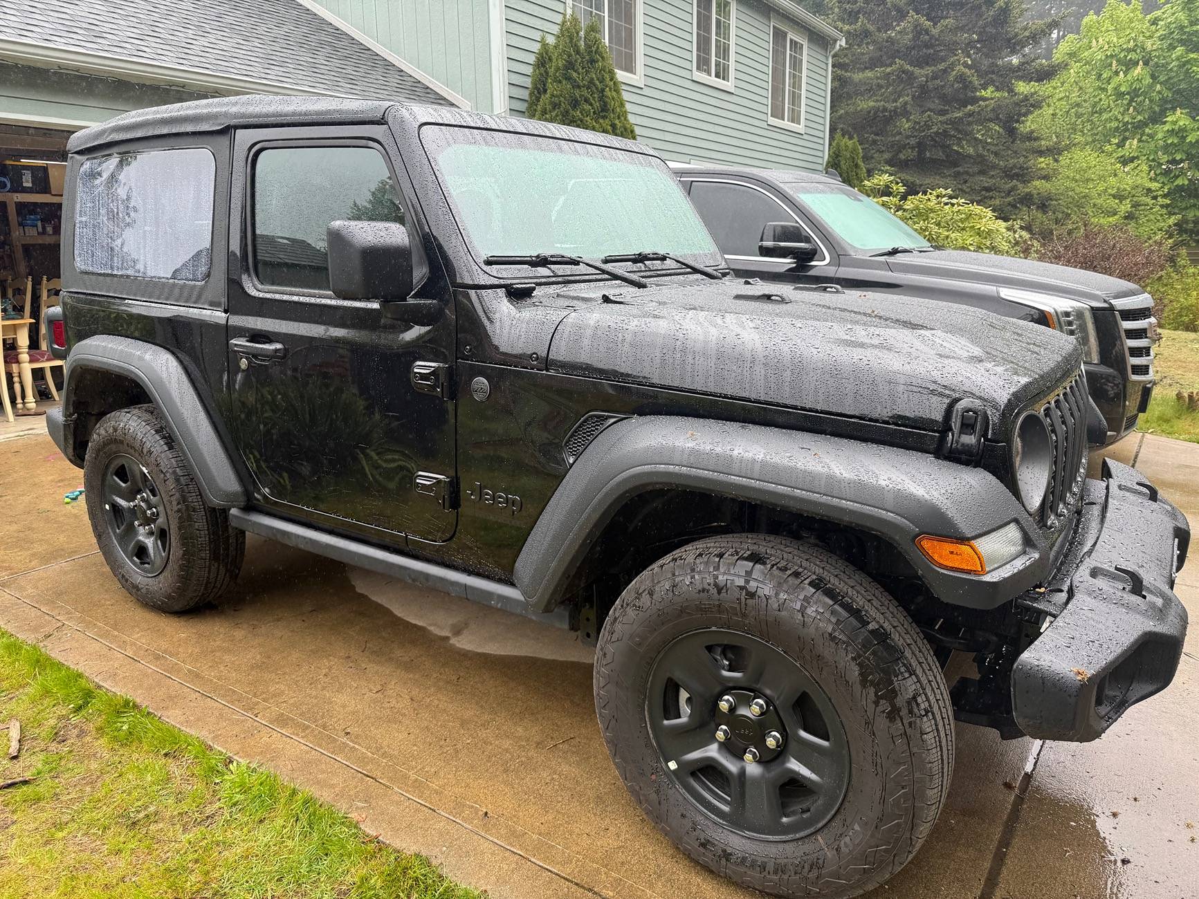

Stock 2025 JL Sport 245/75/17 tires fit well into wheel arches.
Jeep Wrangler JL Help!! What tires should i get?? IMG_3558

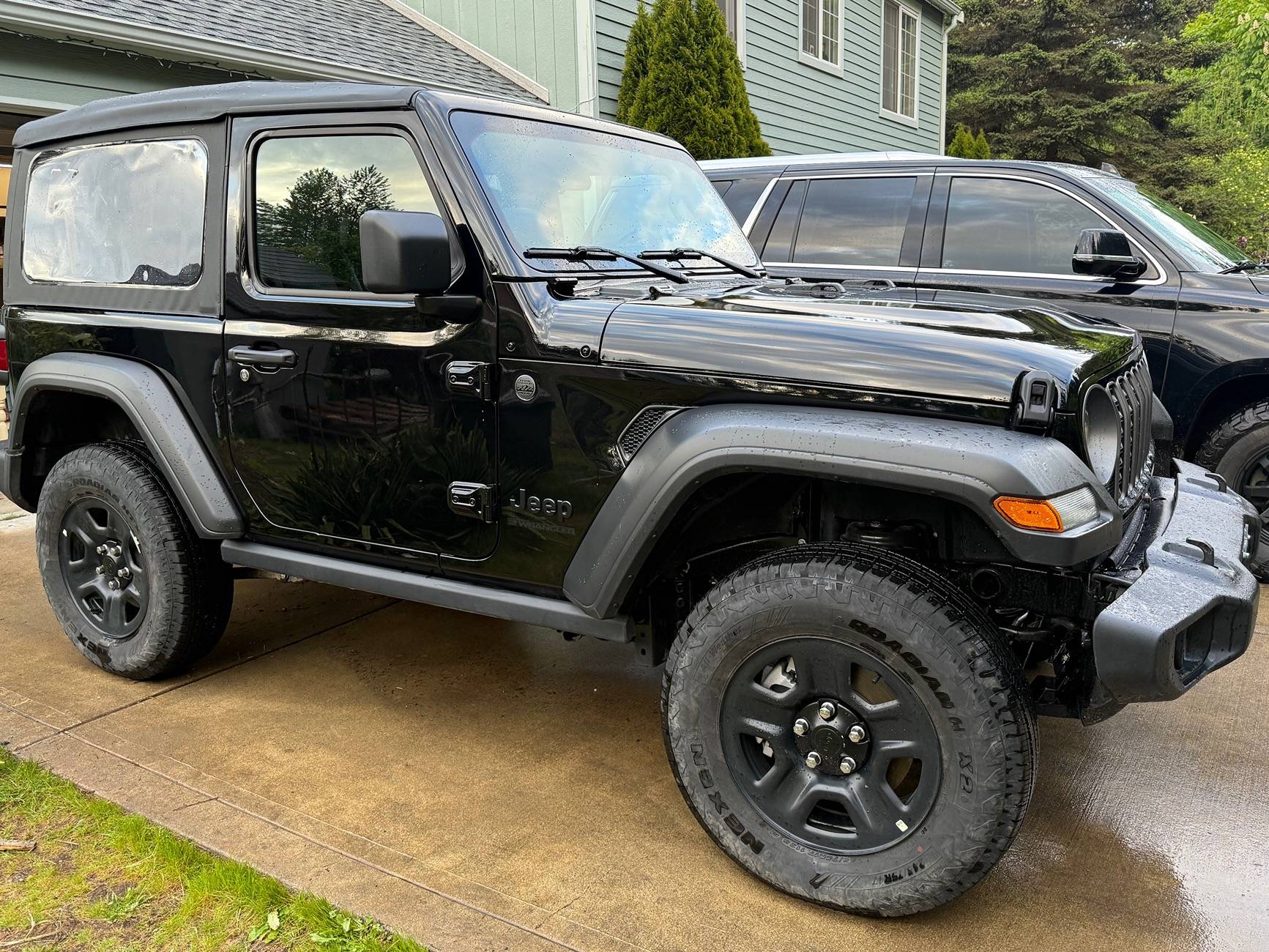

Rubicon take offs(springs and shocks) 245/75/17 same tires look stupid now lol.
Jeep Wrangler JL Help!! What tires should i get?? IMG_3591

I know that doesn’t help with what tire to get. But maybe it’ll help with what stock tires look like with a decent lift. I’ve been contemplating MT BB AT in a 35. But I’m more of a pizza cutter tire size person myself. I have Dick cepek extreme country 35x12.5x15 on my 97 Silverado. And the 12.5 wide even in that truck are WIDE.

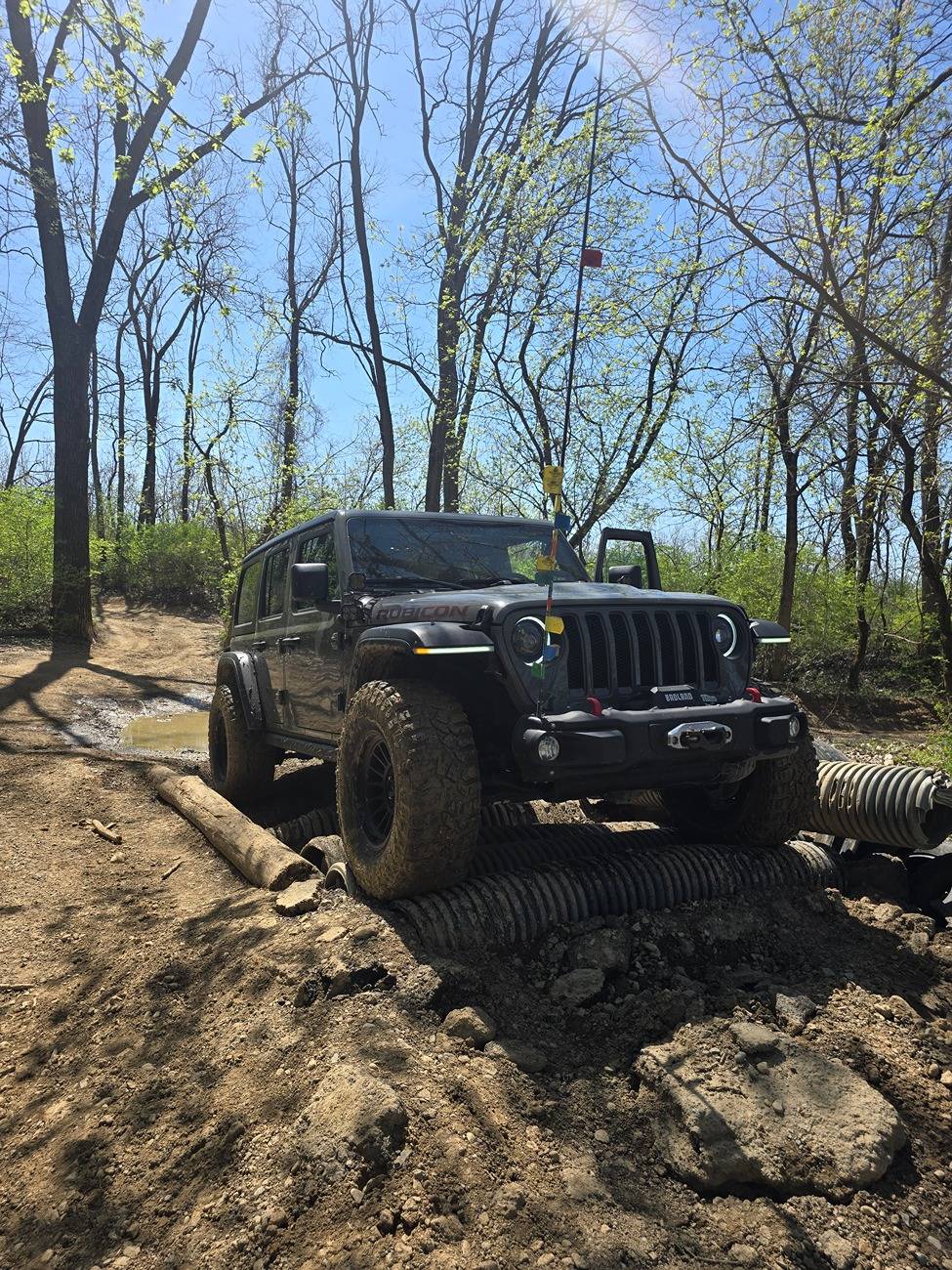

I'm in stock rubicon suspension. I went up 1 size in tire and then got a wider tire with a negative offset rim. I'm really happy with the look and performance of this set up.
Jeep Wrangler JL Help!! What tires should i get?? 20250427_120527
