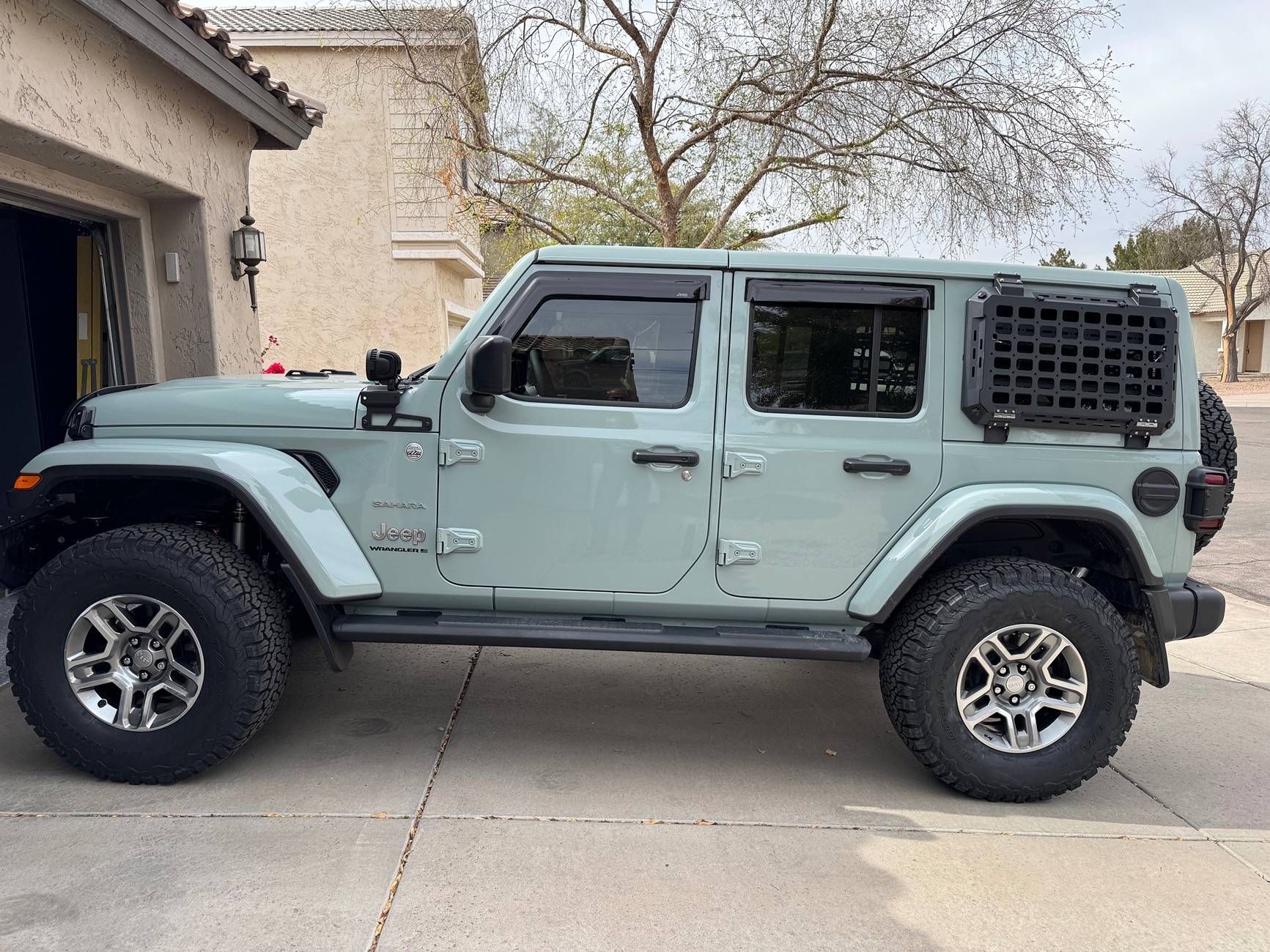

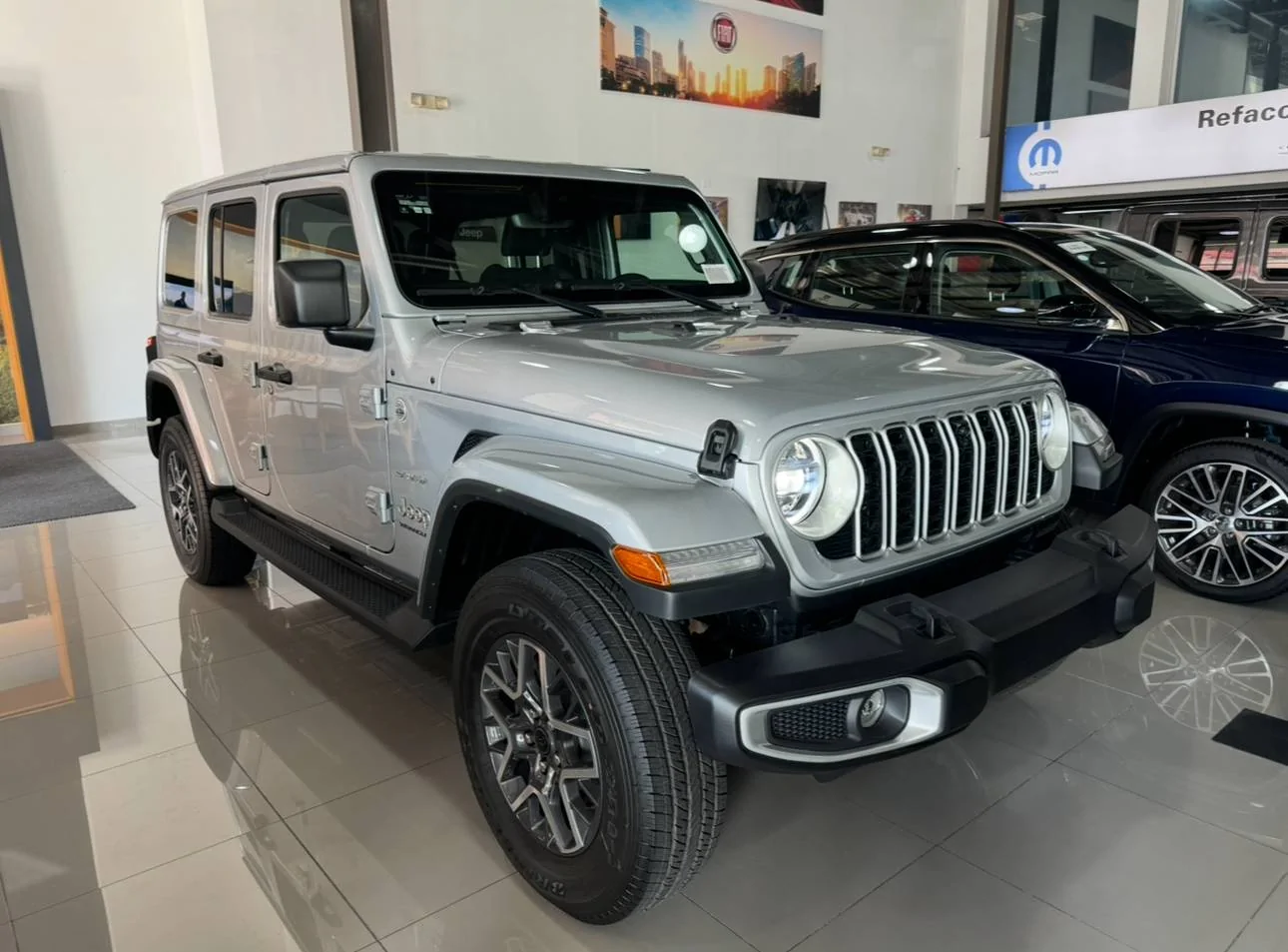

Here is a pic of my jeep.

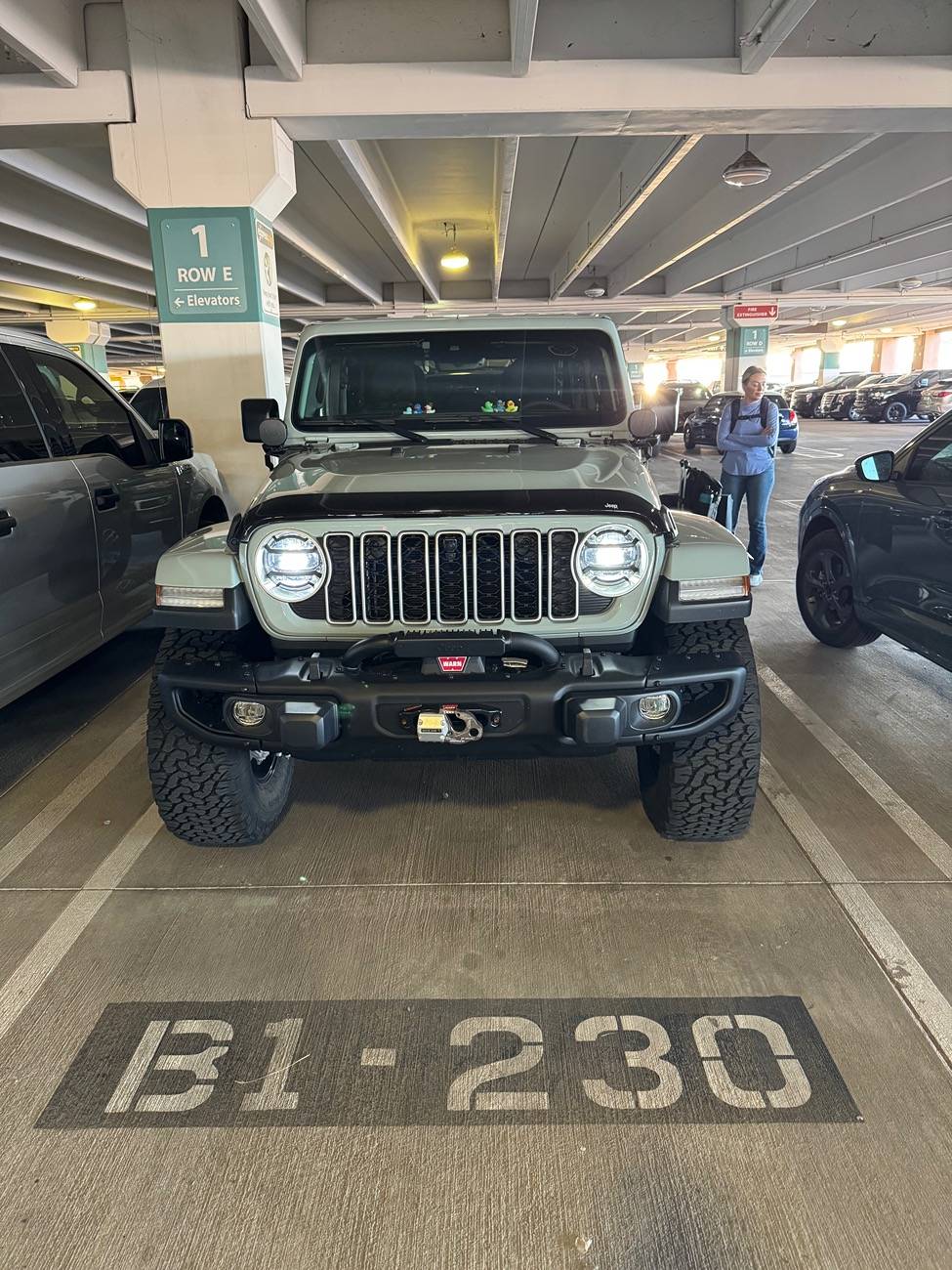

Agree on 35” tires. I gained about 3” on my Sahara (this is with steel bumpers and winch that I installed prior to the lift) with the 2” billstein lift and less than 35” tires looked weird. This is with KO2’s. Regearing is not a necessity, its a preference and I have not seen the need to do so yet.
Thanks for the response and pics! Looks awesome!
How is the ride quality with the 35" KO2 in your sahara? And how about getting up to 65mph and going down the freeway? feel lots of difference?
