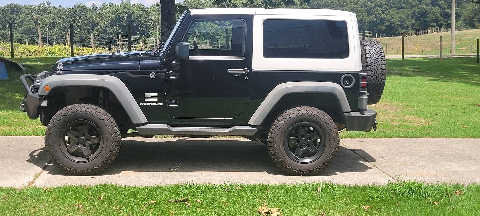

My JK came with a "moderate" (~2"?) lift, and 265-70-17s. 32s.
I don't think it looks bad, but the PO apparently had 315/70s on it, since that's what the speedo was still calibrated for, and what was on the spare. (I wondered why people were passing me like I was sitting still, when I was showing 75 on the speedo. When I got home and connected my AlfaOBD, I figured it out.)

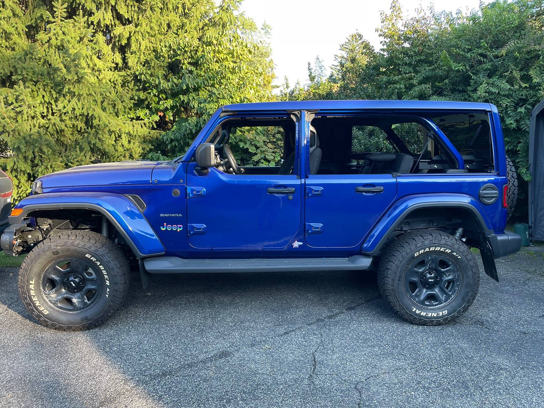

My JLU Sahara came with 255/70-18s on it. When I bought new wheels, I replaced them with 275/65-18s. Also ~32". Stock height, but regeared to 4.11s and added lockers. Wildpeak AT3Ws, since it's my daily.

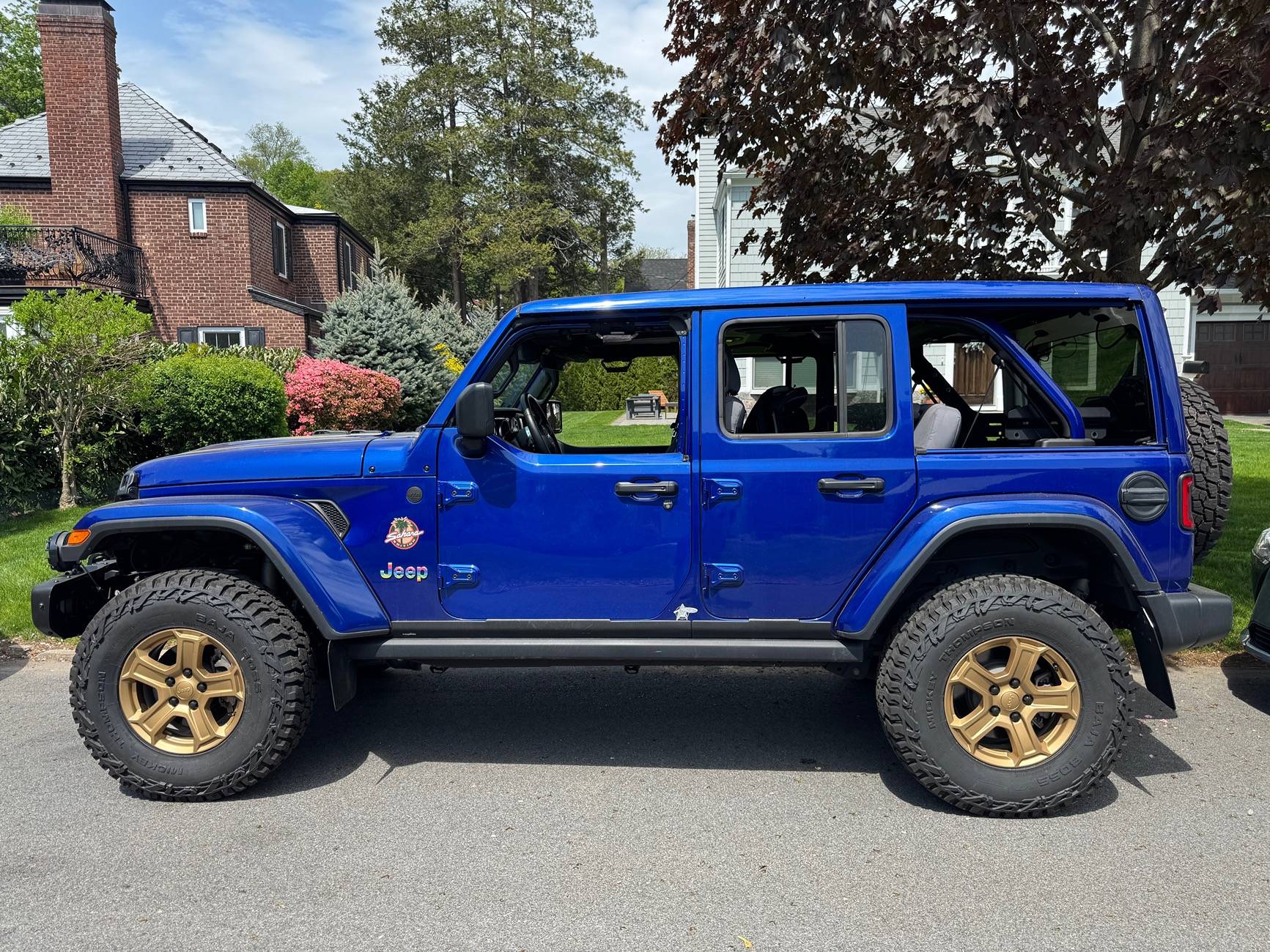

This is what a Sahara with a 2.5in lift with 33s looks like:
And here it is with 35s (255/85 MT BB ATs):
keep in mind both are on 17inch wheels though
Those are load Range E though. Too stiff harsher ride.
