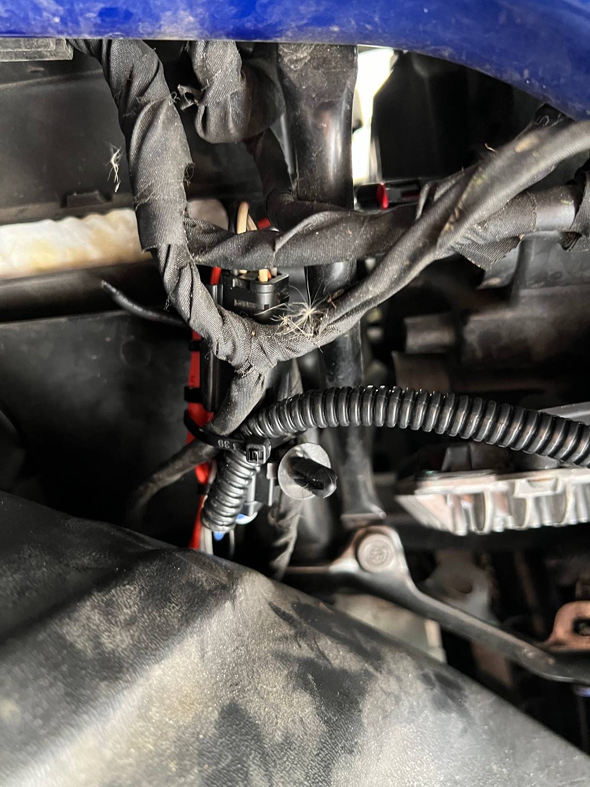

Finally got my KC prototype harness installed (only testing it, haven't wired lights yet). Works!
The passenger side isn't really a tight fit for the harness, but it's a tight work area - at least with an AEV snorkel and hands the size of mine. I used a Christmas tree clip puller to help get everything lined up and plugged. The process only took a few minutes.
A little red, white, and blue + ground:
I'll probably remove it to cloth tape it, then reinstall. And, I'll likely clip off the butt connectors and add marine grade spade connectors for a relay.

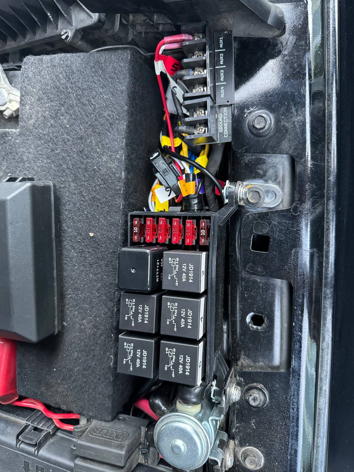

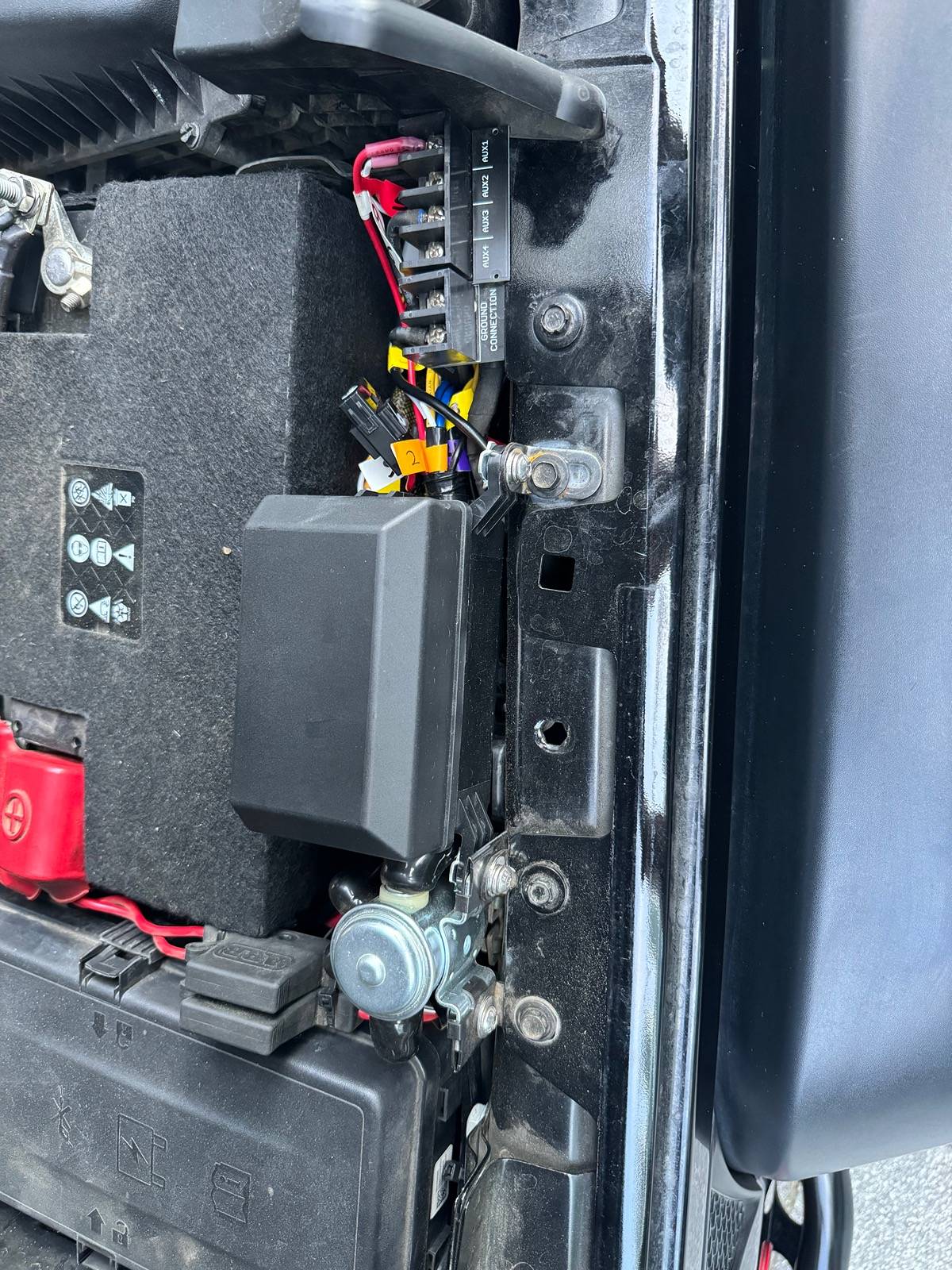

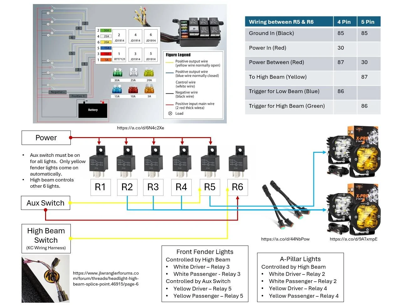

I finally got a chance to diagram out my lighting for the off road lights. Mind you, I did the diagram a month after completing the lights, so I "think" it's right. . . Use it at your own risk. Thanks again to KC Lights for the high beam splice.
you can see I was able to wedge the relay box in between my winch solenoid and the aux switches hookup

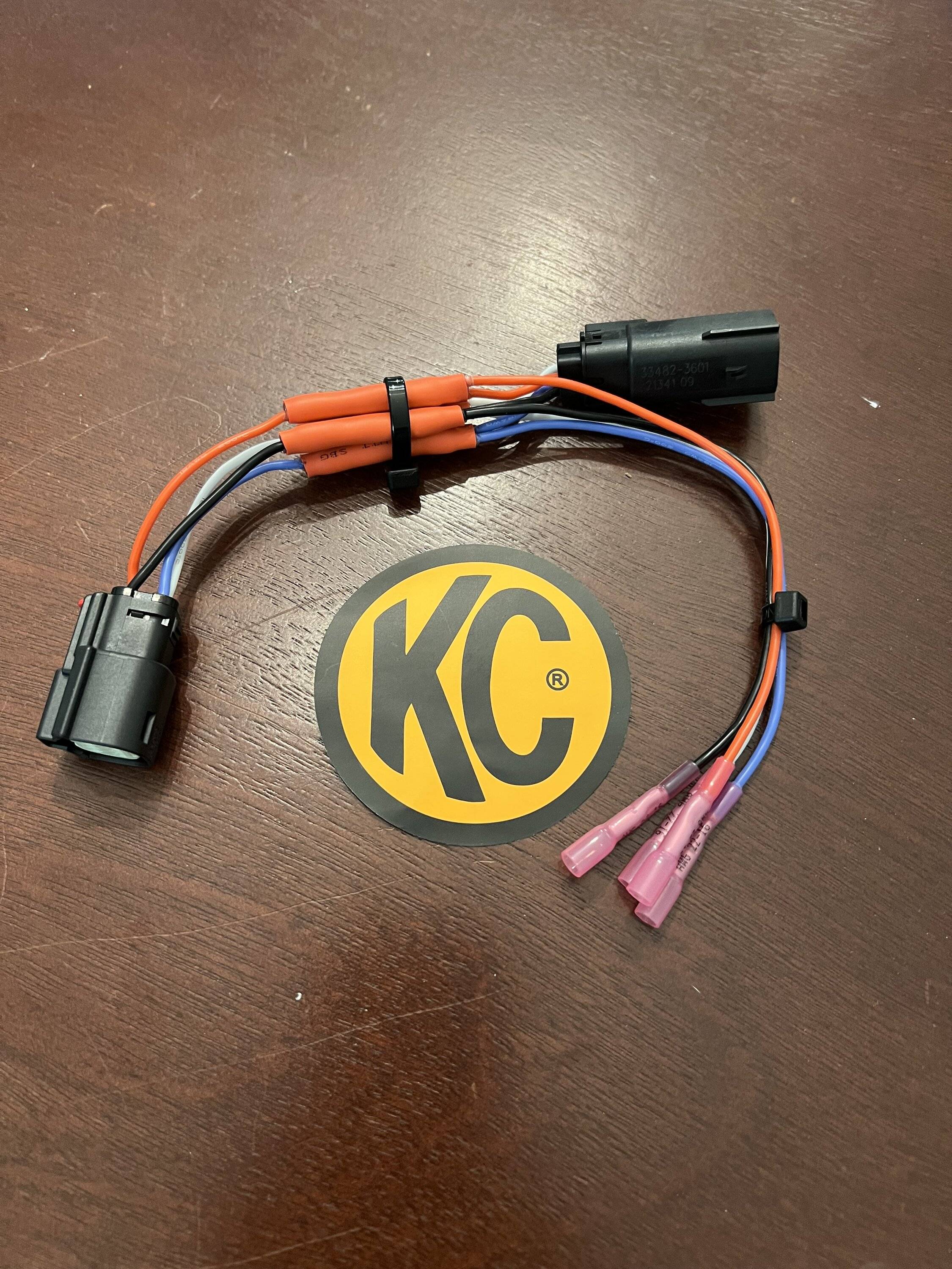

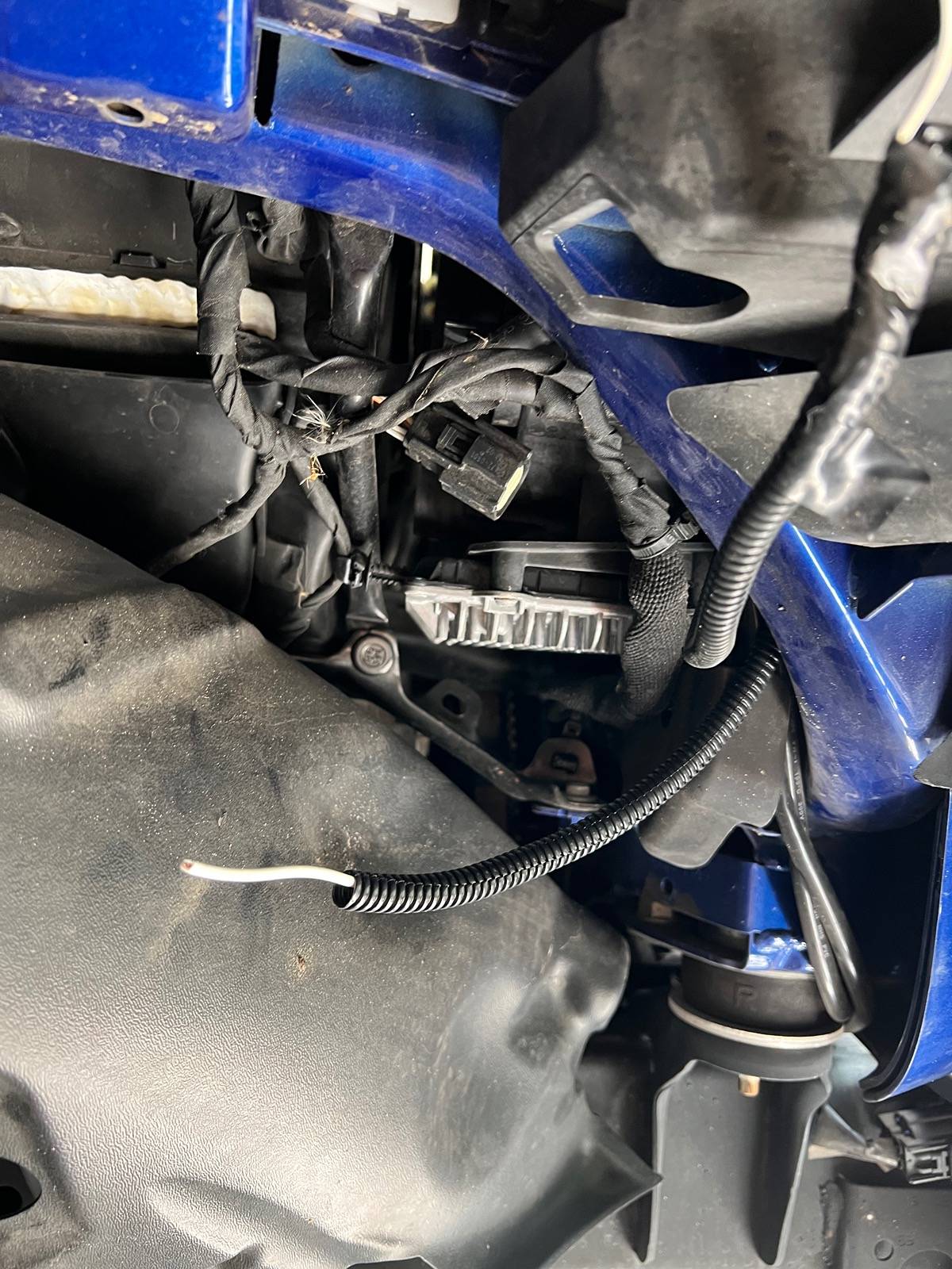

THANK YOU @KC HiLiTES for sending me one of the demo wiring harnesses that I FINALLY got to install today as the shit in my life is almost settled…
The wiring harness:
So my first lighting upgrade I did was installed IPF lights to my bumper and connected them to Aux switch 2. They were an upgrade to the high beams at the time, but when I got the KC Flex4 Cowl Light, they kind of became a waste of my Aux 2 switch because I never used them. I still love the look with the IPFs so I wanted to still have them be usable.
SO I decided to try the new harness and have them removed from Aux switch 2 (swapped the Flex4 to Aux Switch 2 from Aux Switch 3) and have them come on when I use the high beams.

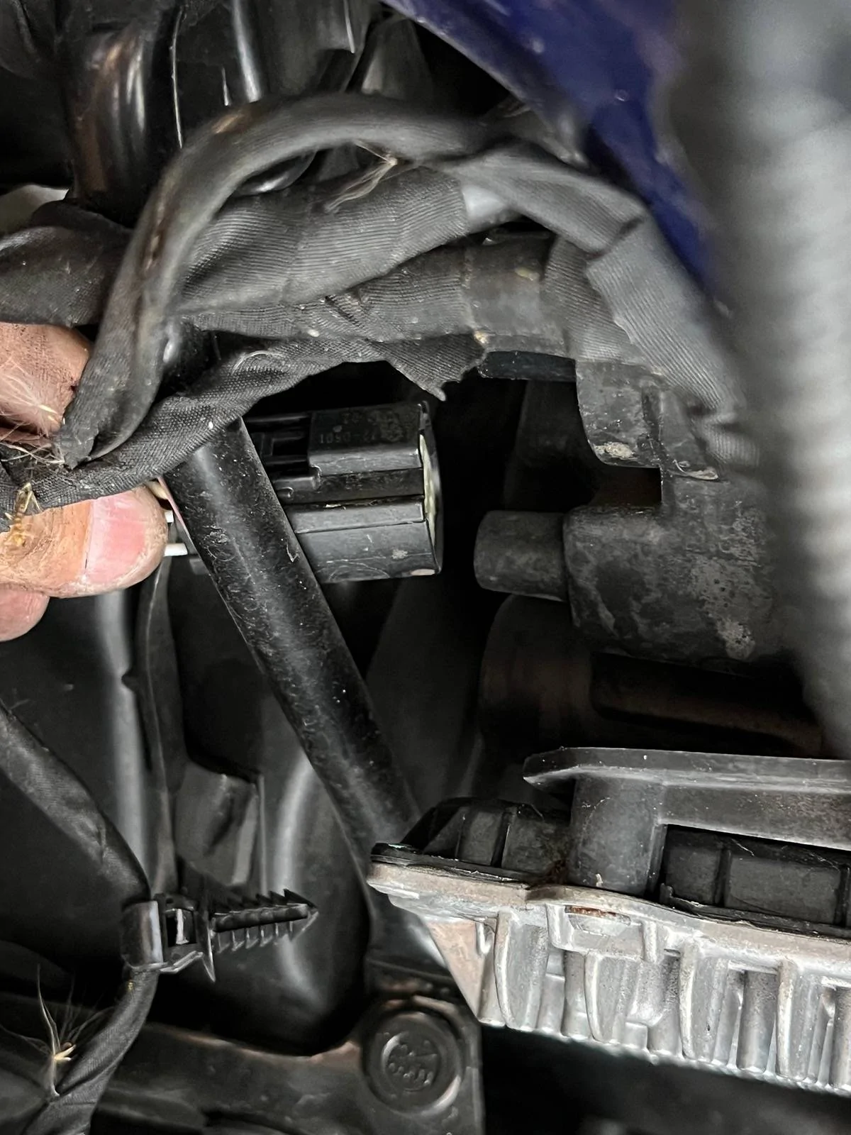

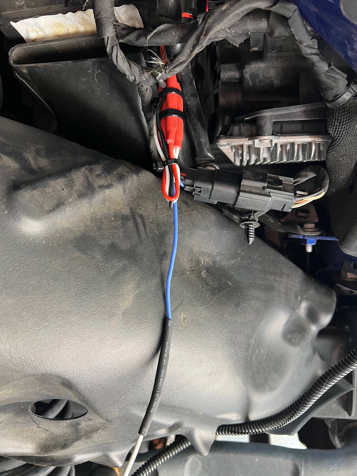

The harness plugs in between the head light connector harness end and Head Light Connector end.
So all you need to do is disconnect the Harness connector out of the head light connector and plug new harness into the headlight connector and the Harness Connector into the new harness:

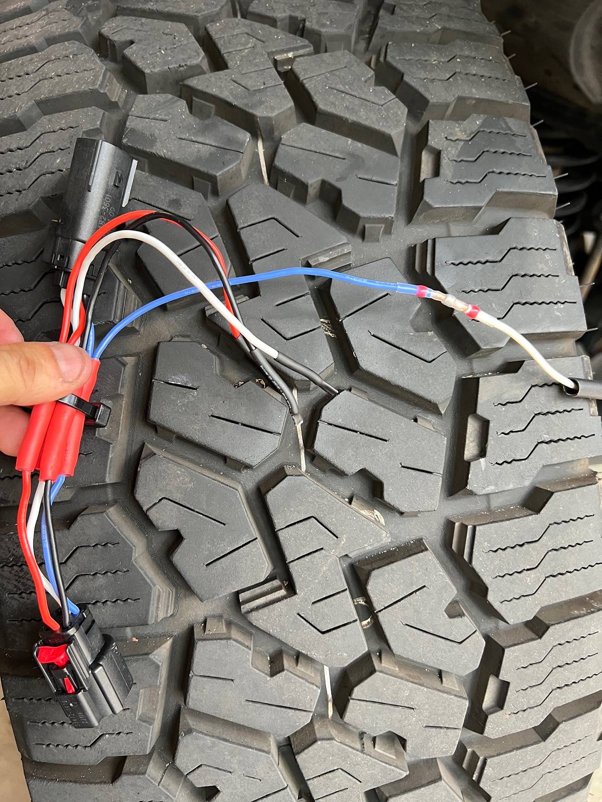

I ended up cutting off the butt connectors that came on the Demo KC harness and used heat shrink to seal ends and tied into the Blue wire that was to the high beams:

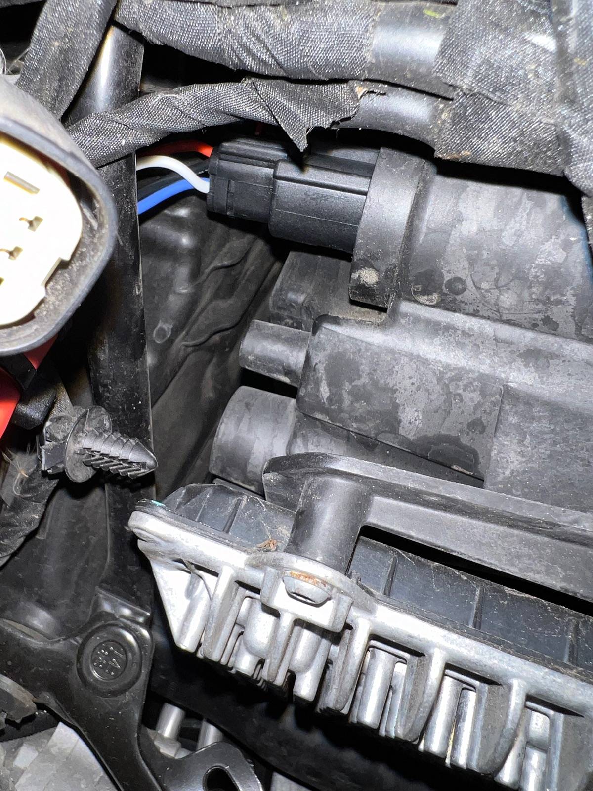

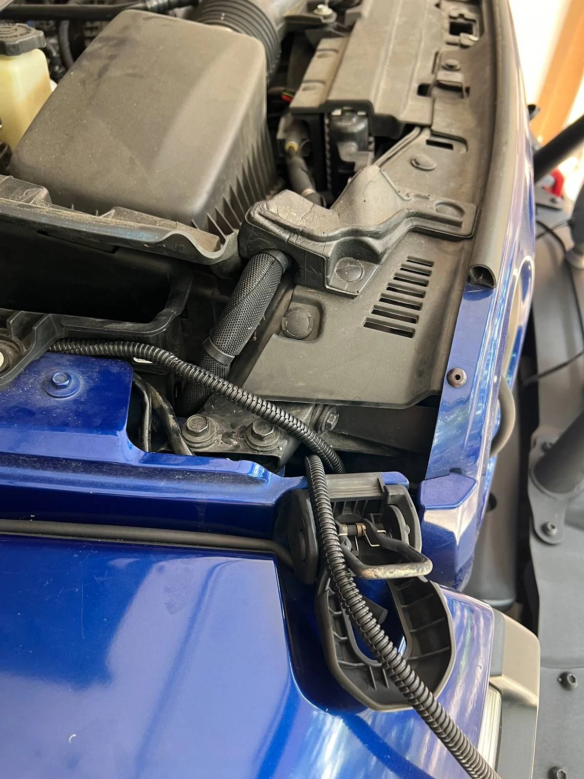

I then had to tuck the harness installed with zip ties and run a extension wire from the wiring in the engine bay that couldn’t be shortened:
AND final successful result:
