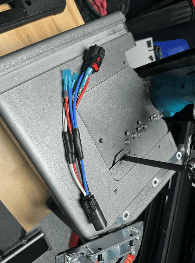

If anyone is still interested, one of our engineers made up a few samples for testing.
Plug and play between factory harness and headlight.
Giving an output for low beam, high beam and parking light.
Has a butt connector on the ends to tie into a relay for control of another light.
We have 5 to giveaway to forum members in this thread who would want to test them. First come first serve.
Just send me a private message with...
- Name
- Mailing address
- Year/model of your jeep
- What headlights do you have
All we ask for in return is pictures/videos of your set up, how you are using it and some feedback. Our lights, other peoples lights, does not matter.

This is slick! Had I not already spliced my wires I’d be all over this!

Thank you for doing this; very cool. I already spliced mine as well, or I would be asking for one too! It is my opinion that you will sell a ton of these! Thanks guys.

Just sent you a PM! Hoping I’m one of the first 5. :). I’ve got everything wired up except the piggyback! Appreciate you doing this!!!!

You were the 1st. :)
We have 3 left to give out.

I sent a PM. Thanks for looking into this, I sure appreciate the effort. I hope lots of others see the benefit in what this opens up.

Sweet! That looks like a pretty slick setup.
