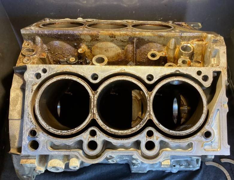

I don't like the "open deck" unsupported cylinder deck design of the pentastar. I don't like the new PUG intake VVL cam/rocker design. They went from one problematic design to another. I don't think 4 chains in an engine is reasonable.

TBH, the JK with the pre-PUG engines never had the same head issues. This seems to be something more recent causing separation between head and block and allowing coolant to bypass the gasket, definitely a more recent phenomenon. The MLS gaskets used in the 3.6 are pretty squared away generally. Something's just going screwy with either heads/blocks not being true (warping from overheating or what have you) or not being torqued right to maintain a seal.
The PUG has the higher compression and all the VVT and VVL stuff to increase BMEP, which is what challenges the head gaskets. Then they recommend low octane fuel for it. If it detonates, pressures skyrocket.
True, but with VVT and VVL they can change timing umpteen different ways to compensate and avoid pre-det. Really just smells like build quality issues, either making the heads/blocks or assembling them.
