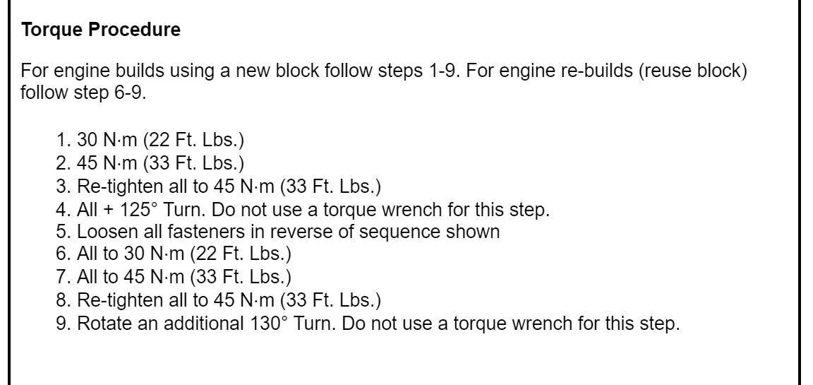

what value would you recommend I retorque my head bolts to? just starting to see early signs, may be too little too late but ill cross my fingers
You'd have to pull the cams off to get to them, Not really worth doing as a preventative measure, as once the cams are out you're like 20 minutes away from pulling the head anyway.

Head gaskets on 3.6Ls are incredibly common. They also blow on the 2.0L if they're overheated even once.
I think the 3.6L issue is the head bolts aren't properly torqued at the factory. We get a seriously high amount failing around 50-70k these days. Considering the same factory leaves the valve covers loose I'd say it's a good bet.
Any chance the head bolts are stretching with time and not necessarily loose from the factory?
If that was the case we wouldn't have so many failing at 60k while some go to 100k+ without issues. I doubt it's a material defect
