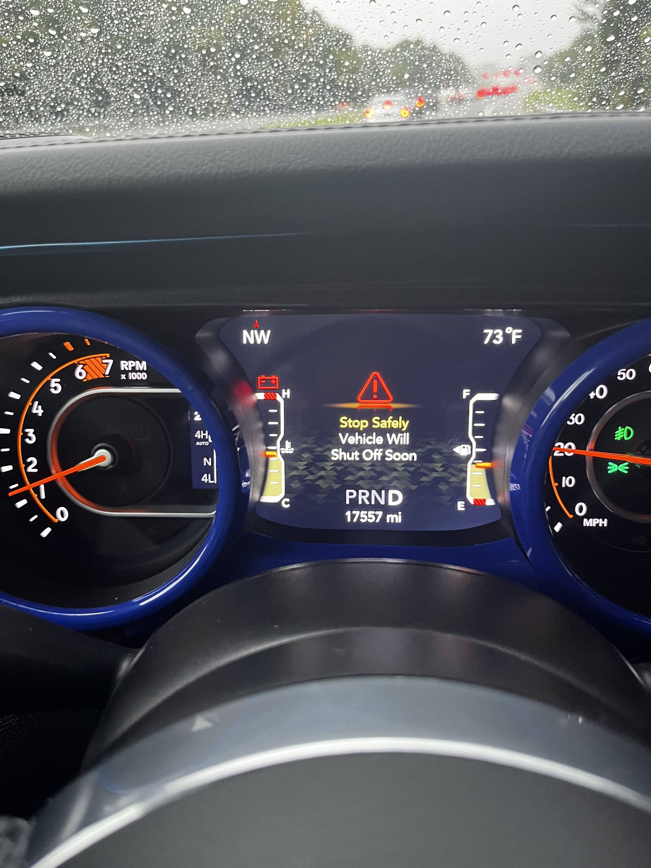

I see that the "battery" light is on....j Would suggest a charging system issue? If voltage drops below 11 volts, it will shut off.....
Yes it is a charging system issue.. when I test the battery it ranges from 12.4-13.5.. the dealer says it’s a malfunctioning alert since the battery voltage is good, the mechanic claims there’s no fix right now (just got it back Friday) then this message came up on the Jeep app

I got that message. After ignoring it, it went away, then came back with a vengeance.
My Jeep shut down and I was able to coast into a parking lot and be towed home.
Aux battery was shot. I removed it permanently, bypassed by taping the aux ground and rerouting the aux positive to the main, and installed a new main battery to be sure.
