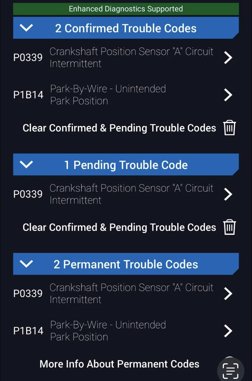

Has anyone seen this code?

I was idling at my mailbox and the Jeep stalled. I was able to start again but it took a few seconds to catch. It then ran fine for a few days and the stalled twice at an intersection. Again it started after a couple attempts.

I ran into it stalling at a stop.
Change your crank sensor.
Stalling should stop.
