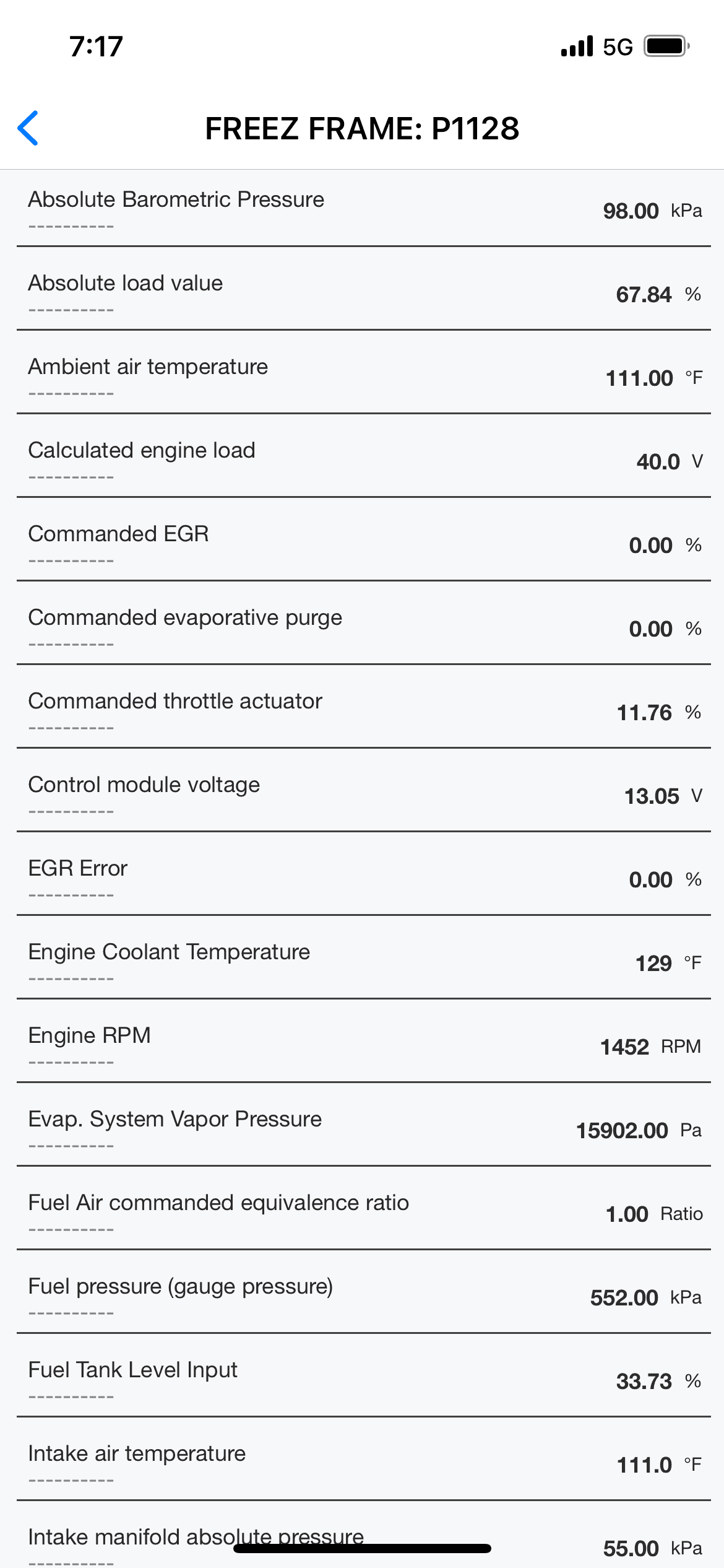

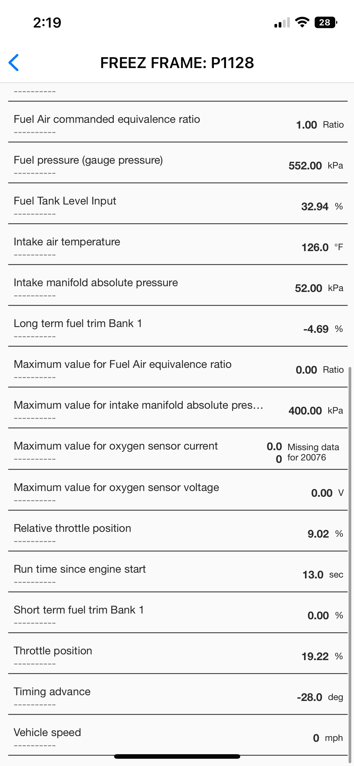

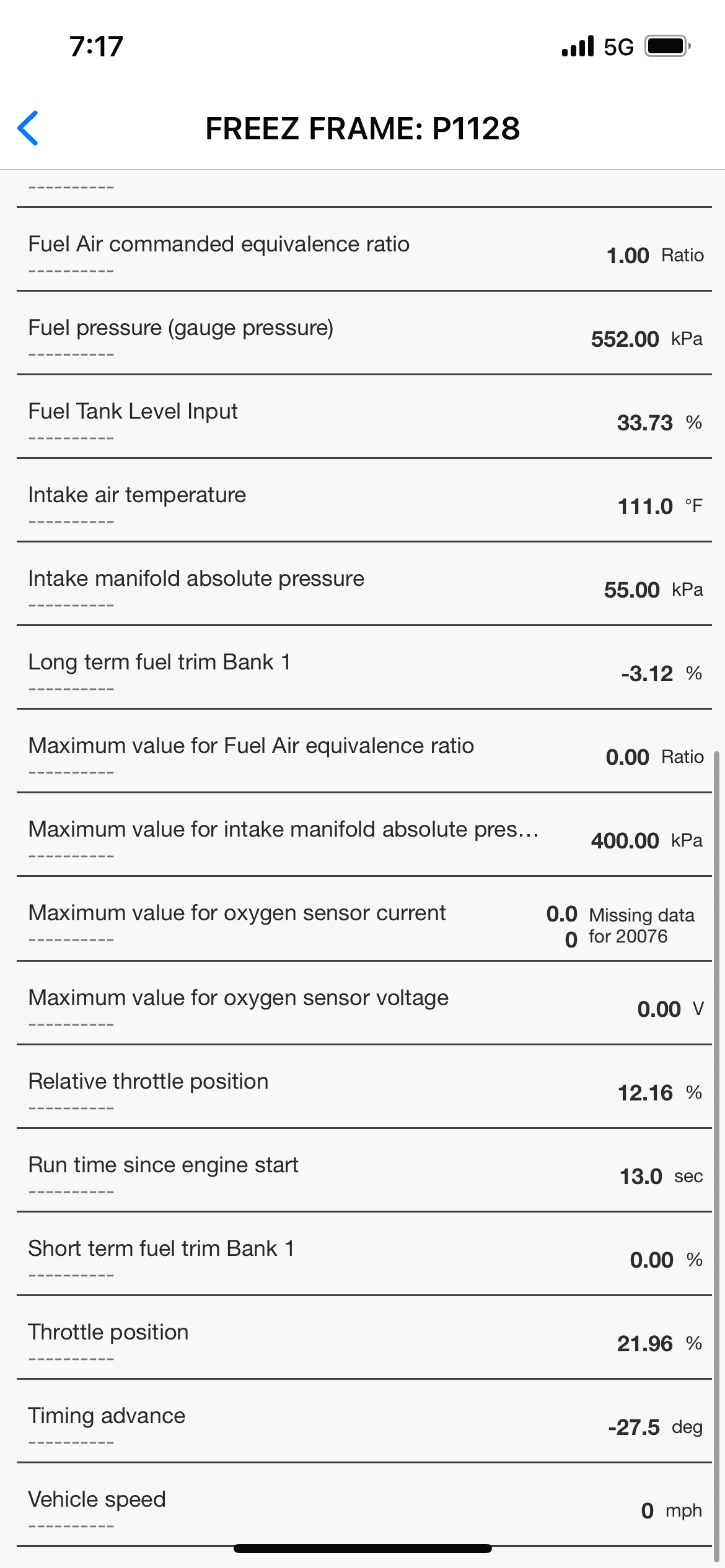

@mwilk012 the CEL came back this morning after clearing the code 1500 miles and over 100 warm ups ago. super weird! the freeze frame looks fairly similar, with modest negative LT fuel trims (vacuum leak?) IAT and AAT are both read high on the freeze frame (111 degrees each, and coolant temp 129) for 13 seconds after a cold start in a 70 degree garage.
i did cycle the jeep on and off a few times last night for under 20 seconds each time while cold to check for an exhaust leak on a newly installed muffler delete pipe. The code illuminated this morning at start up. coincidence perhaps, and maybe not related to the pipe, but related to cycling the jeep on and off quickly before it entered closed loop twice could trigger it. the CEL already shut itself back off after a few cycles.
around 1000 miles before the first CEL i put an intake in, and 500 miles before the first CEL i did an oil change. can't say its related, but just figured worth mentioning as coincidences are never my assumption for things.
Also, running live data a little while ago at ;lunchtime, all of the temps were much more normal, with AAT at ambient around 65 degrees and IAT lower as well as coolant up at 185 at warmed up idle. It did record a couple of misfires in the first few seconds of the cold start while running live data at lunchtime in cyl 1 and 2, but no codes and no more misfires after.
Despite all my googling, I cant seem to find the conditions that need to be met for the engine to enter closed loop. i wish I could find that spec, this way I could see what number is the one that is out of whack. It will be a dealer visit perhaps, as it is under warranty. I just like to troubleshoot myself.

Here is the freeze frame.

My guess is a bad temp sensor reading. Do you have a freeze frame from when it’s not throwing a code? If so compare the two, see what’s off.
I dont have a freeze frame, but looking at the live data, when its not throwing the code (or even after the code was thrown and still there for that matter) the IAT and AAT temps are all normal. may just be wonky readings at startup that then normalize. your guess is the same as mine. but 1500 miles and no CEL is weird. So maybe its not a bad sensor, but a sensor that every now and then gets a bad reading and i believe 2 times in a row is what throws the code.

Drove home (no CEL) with live monitoring on my JScan and Ambient temp was right on a mid 50's (the actual temp) and the IAT was within +5 to +15 degrees of the ambient the whole ride. Weird that both the Ambient and IAT sensor would BOTH show ridiculously false high temps at the same time on a cold start and both be bad, and then both be working. Also curious if there is a potential PCM feature that doesnt allow a reading on the IAT to be significantly below Ambient, and accepts the ambient value as an IAT in that event. Meaning Ambient sensor showed 111 degrees on a cold start in a 70 degree garage, so IAT was forced to accept that value. In no way was that anywhere near the actual temp at the time the code was thrown. Either that, or as you said the circuit (maybe fuse?) or PCM itself. I'll get to the bottom of it one way or another lol
