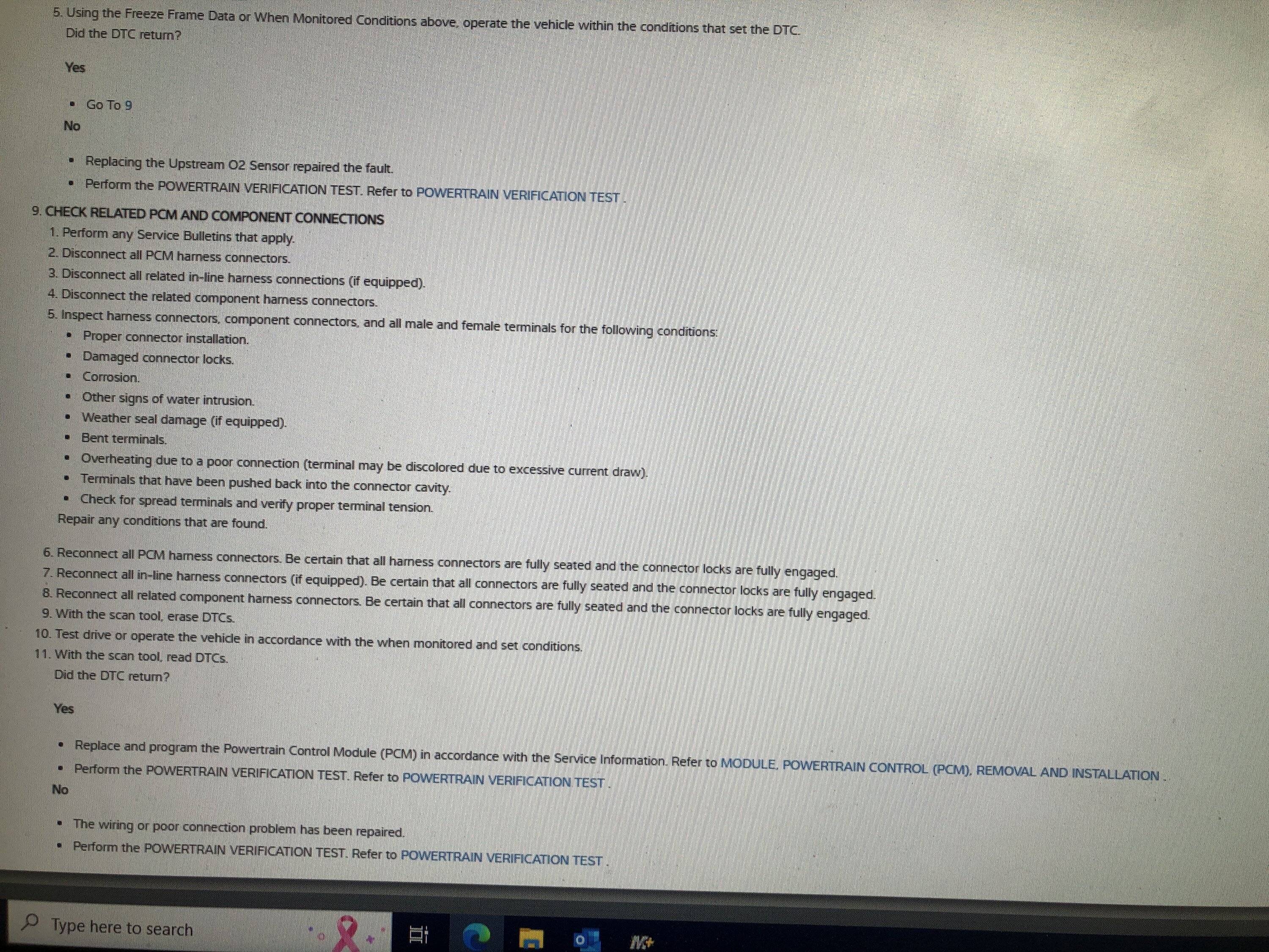

I failed to mention, but my uconnect and dash display were stuck on 39 degrees for 3-4 key cycles over the weekend which it was 55-60 degrees out. i know a lot of people have issues with that from time to time. could be related that the ambient temp sensor got stuck at 111 for the morning of my CEL. it was never 111 outside, but sitting after the car shut off would definitely heatsoak the AAT and IAT sensors until it cooled down.

Awesome, thanks for that. perhaps the AAT and IAT bad readings in relation to the normal warming up of the ECT were enough to trigger the light. I see step 2 saying replace the ECT sensor, but i am sure that one wasn't the one with the bad readings, it was the other 2.

I wonder what the Intermitten condition procedure is. Because that's clearly an issue for me. most times the IAT and AAT read correct and the CEL does not come on. it took 100 warm ups from my first reset last month to see the conditions again to trigger the CEL.
