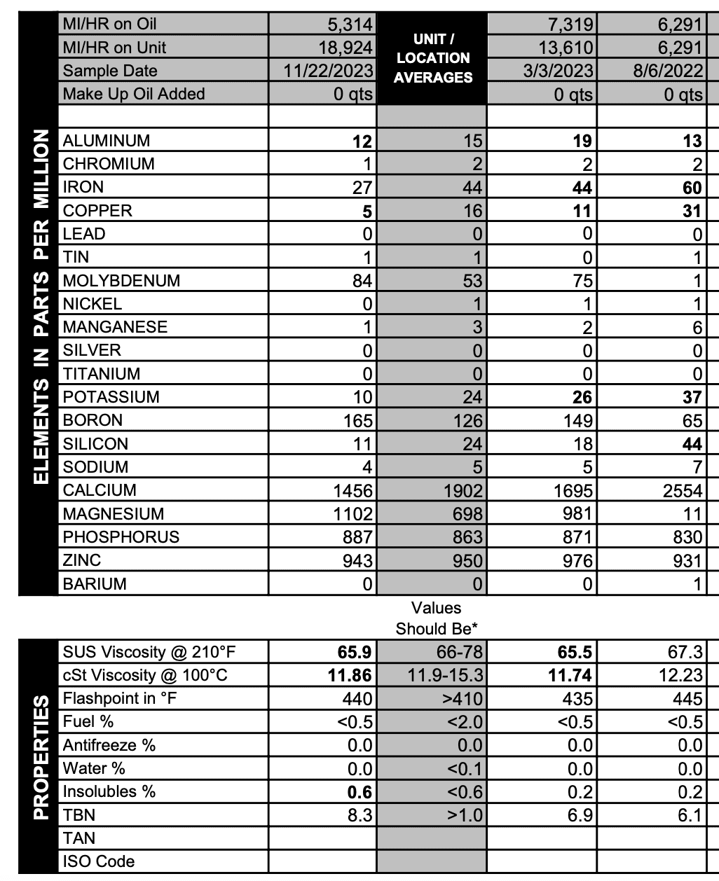

What I would be interested in seeing is fuel dilution without the GDE tune so that it could be compared with the tune. If the dilution with the tune is drastically higher then there is a lot of wasted fuel. And that isn't a good thing.
I will have a data point for you all in a little over a month > I am quite curious as well, as to impact.
Been performing UOA for the life of my EcoDiesel. Right before implementing the tune, Fall '23, swapped out the oil.
Jeep Wrangler JL Green Diesel Tune Drivability Screenshot 2024-06-03 at 9.31.33 PM
Average, one way, work, commute is ~14 miles. Now, that could vary from highway speeds to pretty slow/congested traffic. Occasionally, get out for the longer 100+ long run on weekends.
As for drivability, absolutely love the tune so far. Acceleration vastly improved, lag nearly eliminated, plus it now sounds like a proper diesel. Sure, it does hold a gear longer for the first few miles, to bring temps up. I just don't hammer on it during this period.

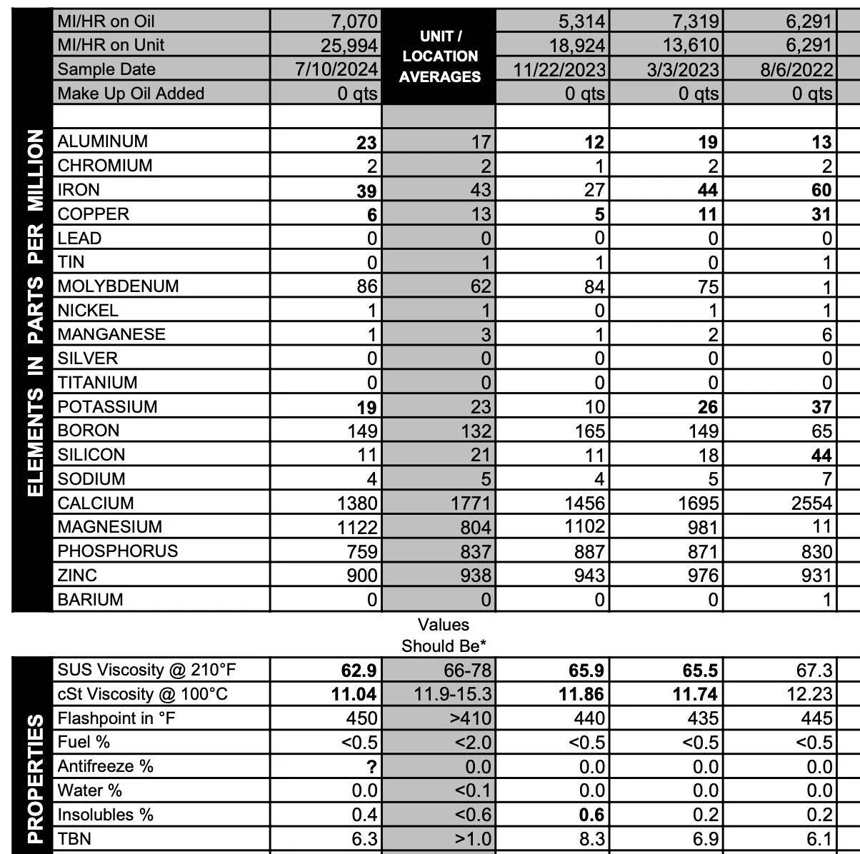

Following up, as promised. Received today and I still need to fully digest.
Jeep Wrangler JL Green Diesel Tune Drivability 1723087130986-a7
Viscosity has been low across the board, possibly due to shear? Oil has always been the mopar 68524020AA that one receives with the wave services.
I am targeting another ~7K miles or so this round and then will likely switch to Motul's 8100 X-Clean.
Tune still drives great btw.
