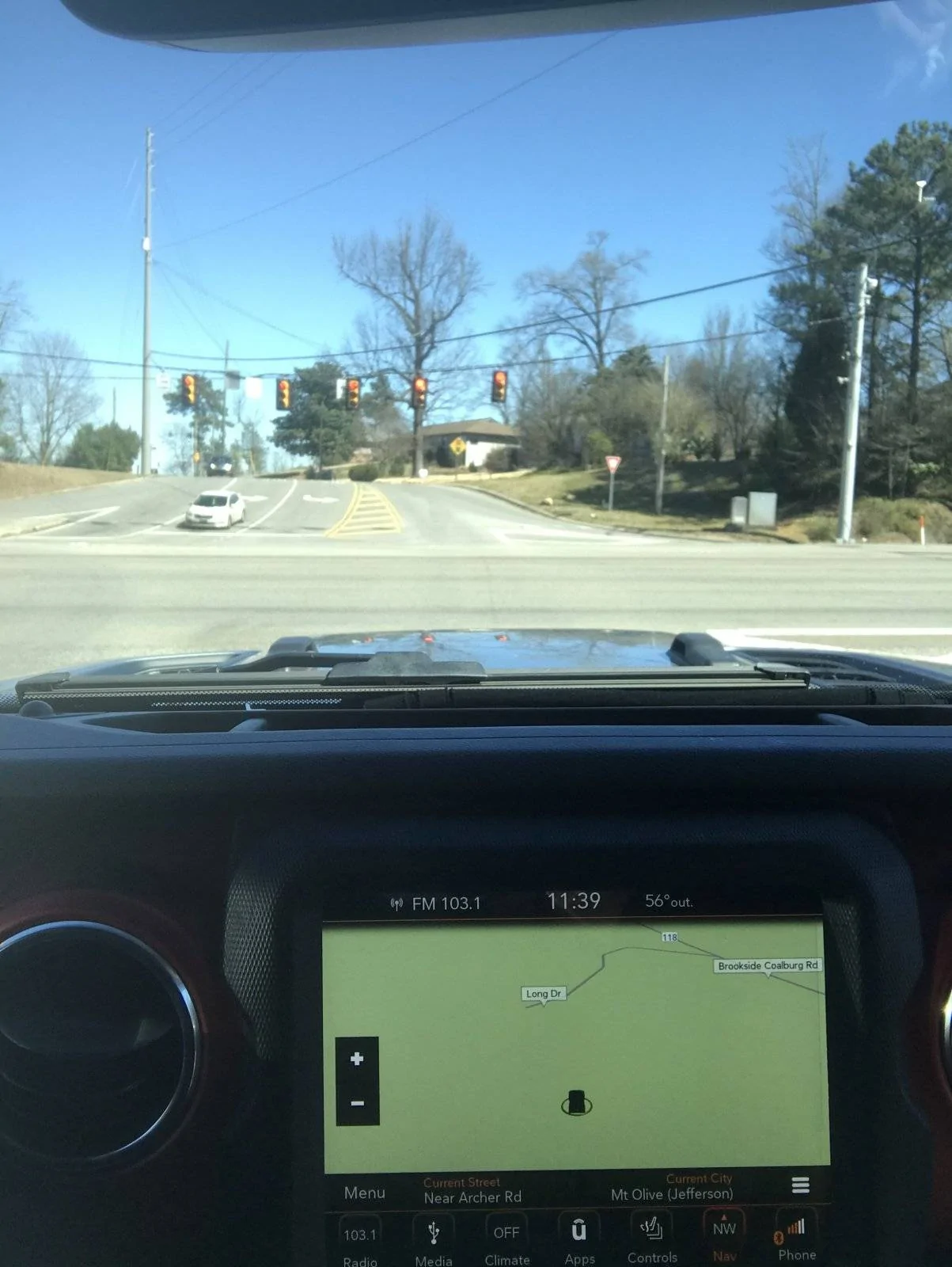

Nav is about 15 miles off course here. It seems there would be a way to force it to recalculate without disconnecting the battery. I’m running just the soft top.
