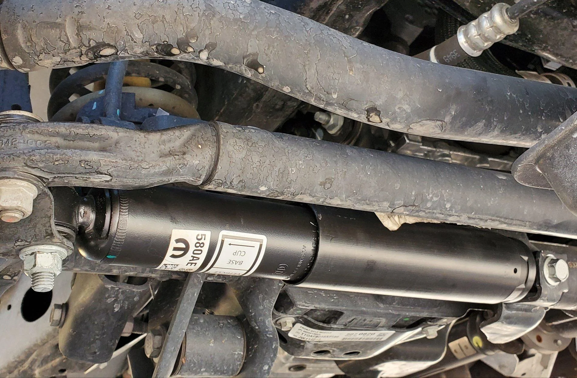

Just had my V41 work done, along with an oil change. When I got home I took a look at the new damper and noticed the sticker with the arrow pointing the wrong way. Got on this forum (which is the best thing ever) and got my suspicions confirmed -- that it was installed incorrectly.

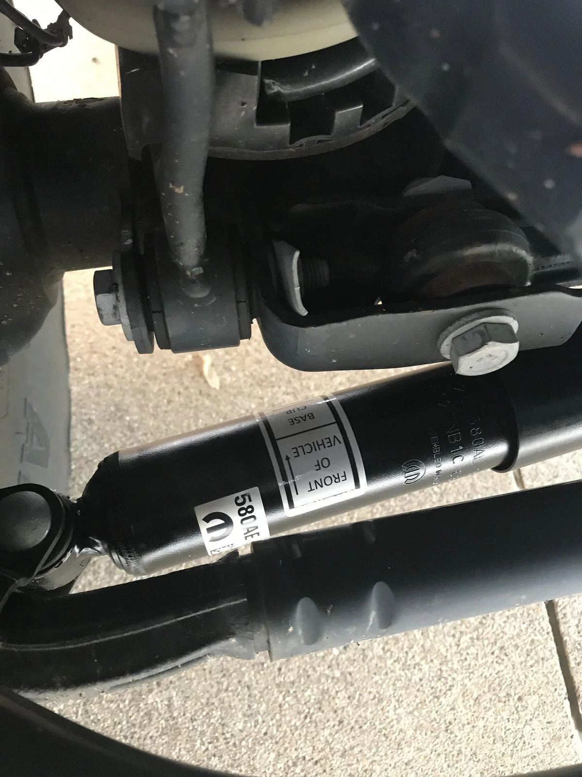

Yes
They had it wrong. Took it back and they flipped it the right way.
Advisor said it wouldn’t matter. I didn’t argue with him as it was installed the way it was supposed to be.
If you have your done check before you leave with it. Cause it will make a difference in the way it rides.

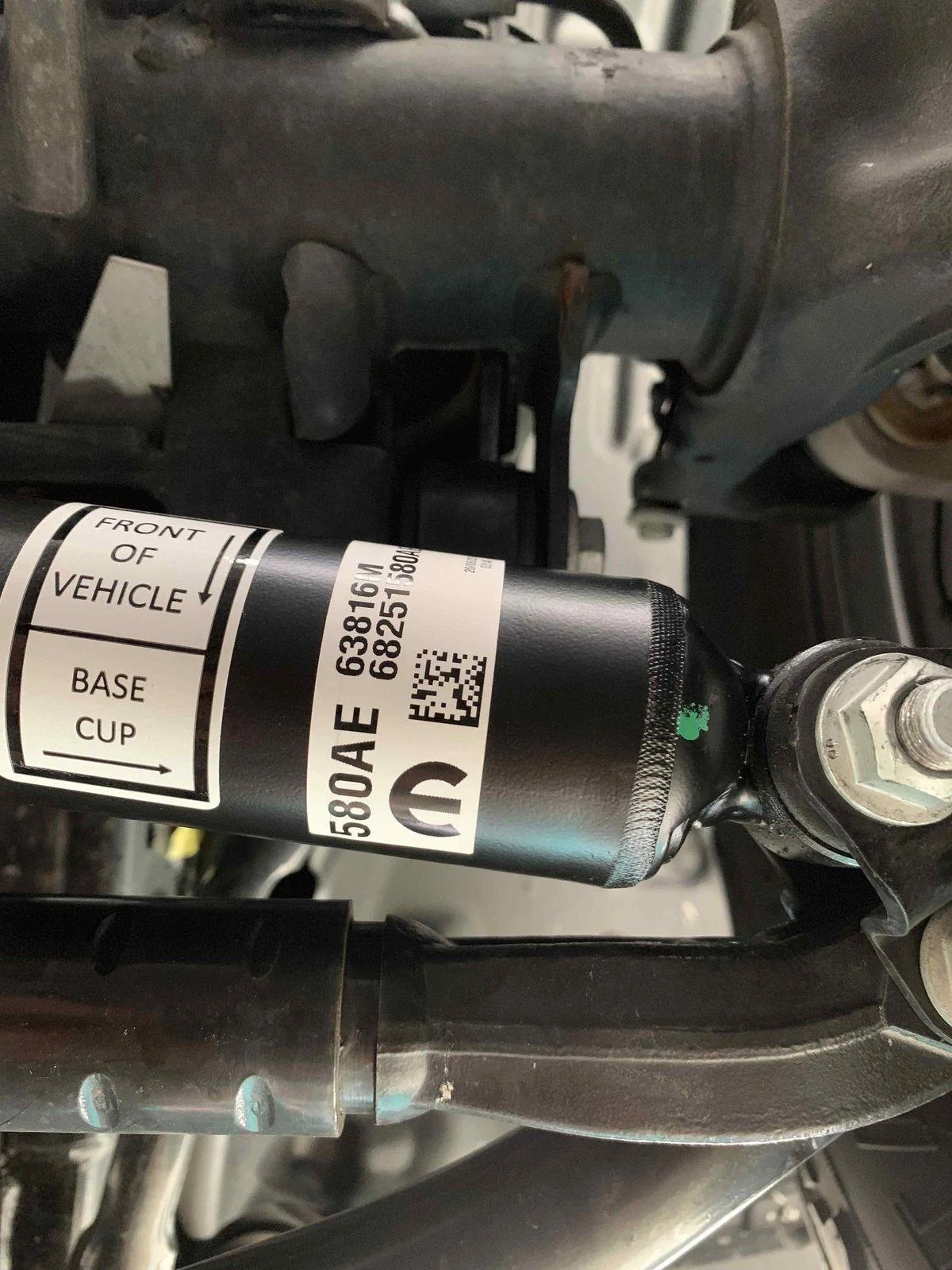

My wife took this picture with her today to have the dampener changed.
Showed it to the service writer upon arrival.
It was installed correctly....
Seems to have tightened it up a bit on the 50mph twisty state route.
Haven't had it 70mph on the interstate yet.
