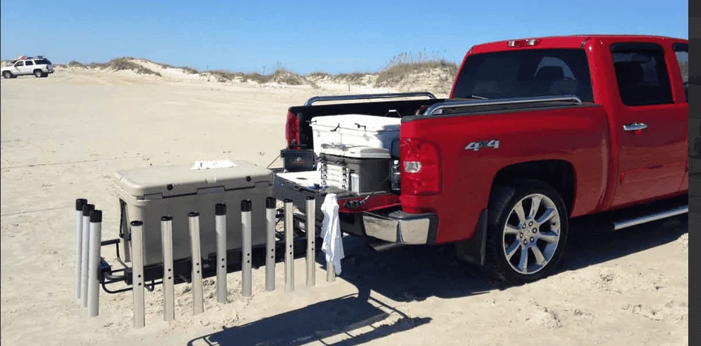

I am going to make a cradle of sorts for the spare tire that can also be attached to the hitch on my Ram. 4 rod holders bolted to a plate that can adapt to other mounts.

I have tried a couple of things. 1st was the few times when I made it to the coast without the hardtop once I got on the beach I could bungee the rods (usually a 10ft, 12ft, and maybe a 15ft) to the roll cage when traveling to different spots on the beach. I did try to make a harness for a rod holder to mount to the spare but couldn't make it work. Finally ended up with a hitch mount. I don't travel with rods assembled since i have to drive 6-7 hours to get to the coast but once I hit sand I don't leave it for several days as I camp on the beach. The hitch mount works well and only a minor inconvenience when needing to open the tailgate.

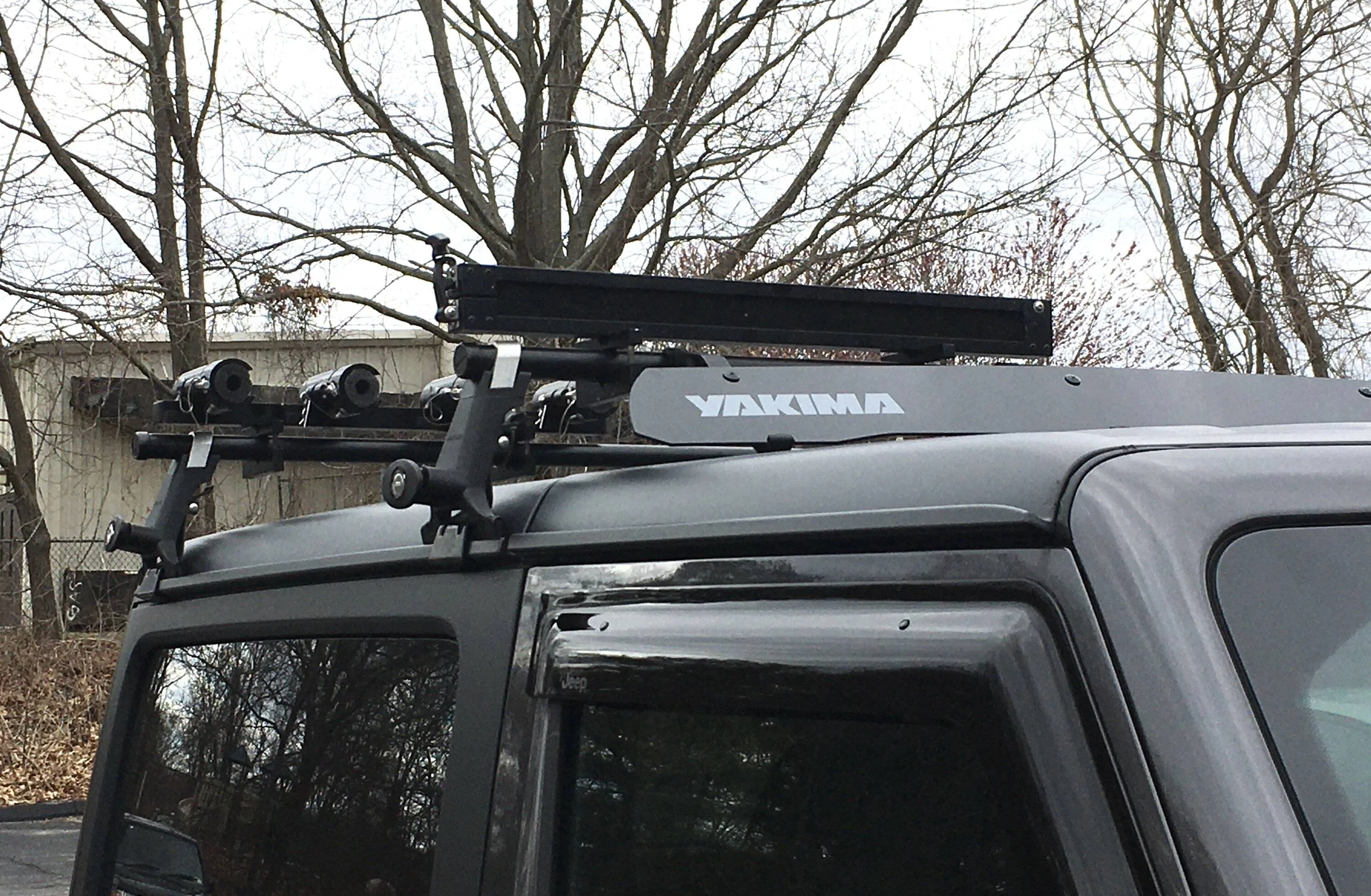

If you have 12 and 14 foot surf rods mounted on a spare tire rack watch out for low hanging branches, etc. The rack that @Ronwho shows looks like an ideal solution for you. I mount my rods on a roof rack attached to Yakima round bars, not an inexpensive solution but it works great.
Jeep Wrangler JL "Goldilocks" solution for carrying surf rods outside JLU? 597F9B47-A93C-4139-AAE9-1C5A632A30A1

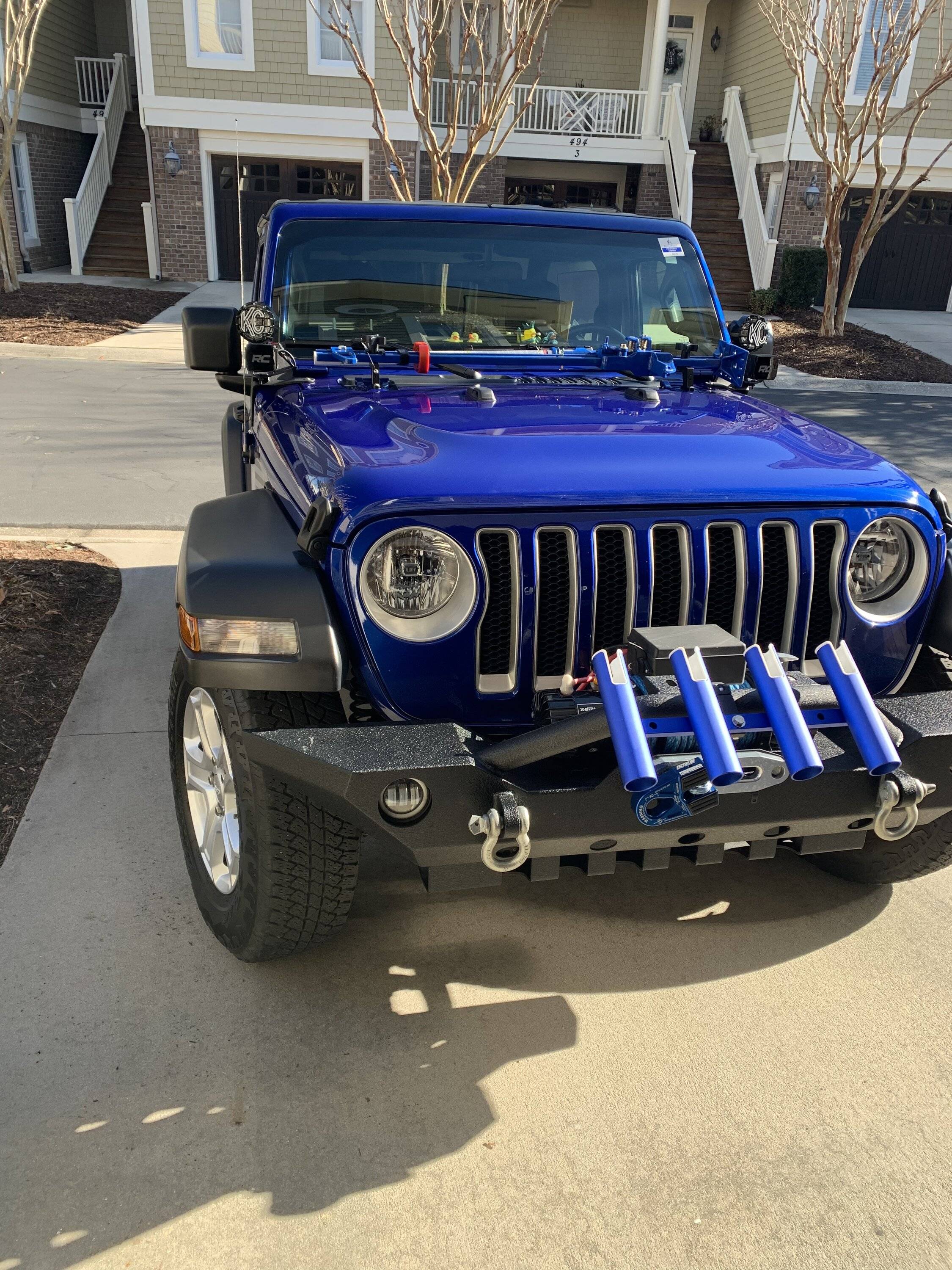

Not clear exactly how it’s mounted, but if the OP wants to avoid getting rooftop cargo bars, then how about getting a bull bar on the front bumper and using this:
https://www.amazon.com/Scotty-339-BK-Power-Holder-Clamp/dp/B001444XGS
which should clamp onto up to 2” diameter bars.
https://www.amazon.com/Nilight-9002...t=&hvlocphy=9010381&hvtargid=pla-783252148247
Thanks, that looks like a solid solution
https://www.amazon.com/Aluminium-Fi...cphy=9061284&hvtargid=pla-1244152495856&psc=1
https://www.amazon.com/Nilight-9002...t=&hvlocphy=9010353&hvtargid=pla-783252148247
I used stainless steel hardware to attach the rod holder to light clamps, also needed to drill new holes in aluminum holder to line up with clamps. Then simply mounted to front bar.
If your rods have a thick end cap like some of mine do, i used a 2" wood spade drill bit to ream the plastic liners to a larger bore. Kind of a pain but rod holder works great.
I have been on interstate and have had no damage to rods or reels at all.
they do make reel covers but so far so good.
