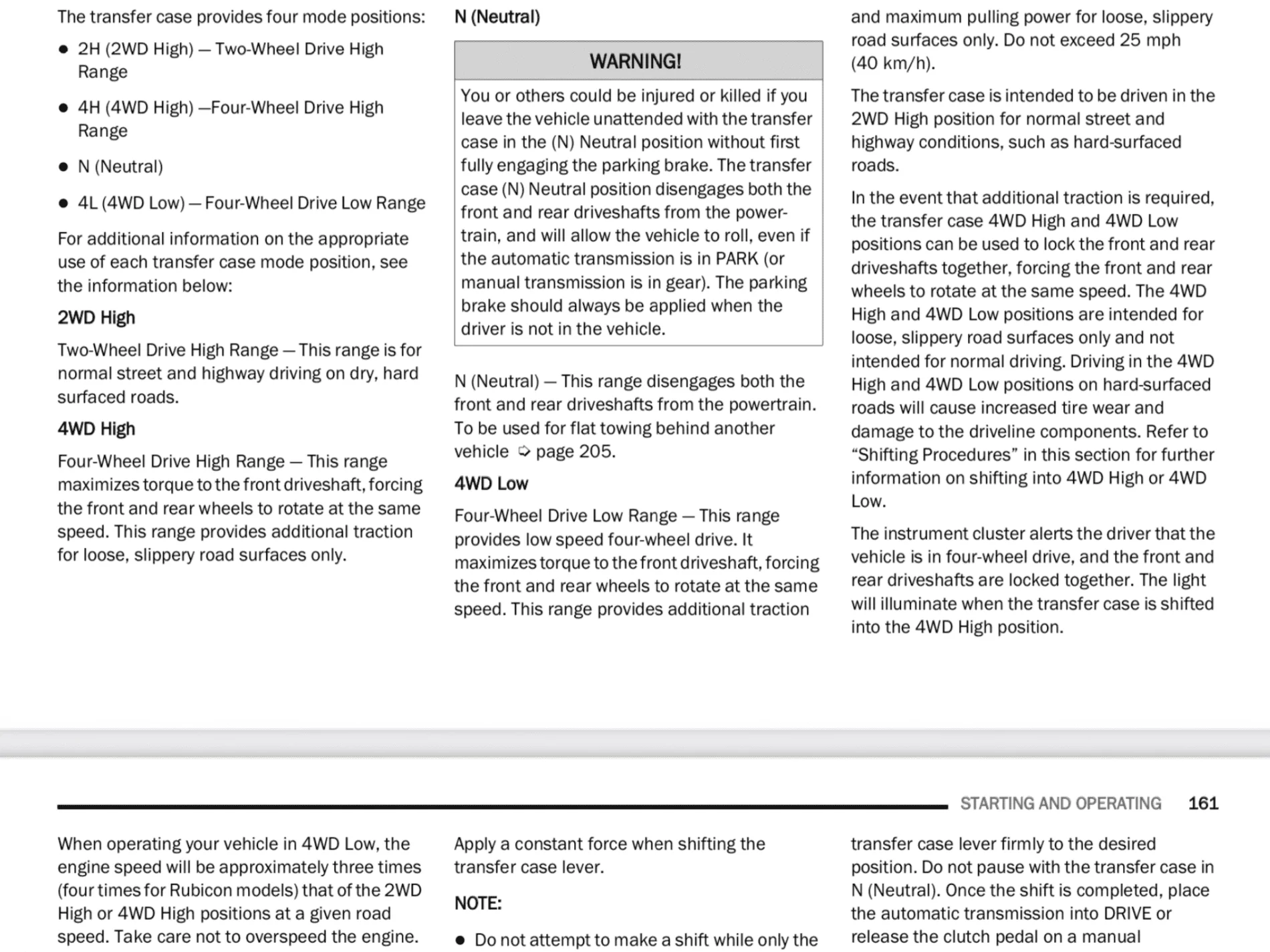

Not intended to spoil all the fun in 4Lo - but FCA states:
1 Do not exceed 25 mph
2 Hard-surfaced roads will cause increased tire wear and damage to the driveline components
3 Take care not to overspeed the engine
We stay pretty much to this in 4Lo - but 2Hi we let the V6 stretch out as the auto shifts just below redline. Actually has decent pull right to the very top end.
EDIT: Yeah was more about 55 in 4Lo just might affect a warranty related issue if something went amiss. Of course any owner can do what they want with their JLs. FYI is all.
Engine rpms are engine rpms, be it 1st gear in high range or 8th gear in low range. The 4-1 gear set is susceptible to pulling/ heating issues if run at high speed for long periods. Blanket statements are made in order to remove all judgement calls that may or may not cause issues. Apply logic to their blanket statement on hard surfaced roads, lo range is safe on moab slickrock, that has better traction than pavement, but will cause driveline damage the second you hit pavement? If you drive at high speed, for prolonged periods sure. If you drive 500' down the road from fins & things to hells revenge at 30 mph in 4 lo you'll be just fine. Of course I'm also the guy who's first mod was a Tazer so I can use my lockers and sway bar disconnect whenever I see fit. FCA wouldn't recommend it, but say bar disconnected and rear dif locked, in 2wd, sideways in the desert is a blast and I 100% would recommend it. Those electronic nannies and recommendations are there for liability more than anything else.
