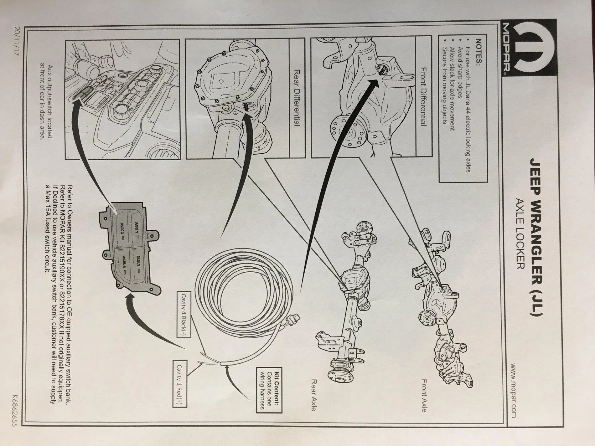

Did you simply re-route the factory wiring or did you buy two new wiring harnesses so the stock switches could be reactivated if necessary?
I ran the Mopar wiring harnesses to the diffs and I just plug them in when we’re headed out. There’s a little chassis symbol with an exclamation point beside it that stays on the dash over the fuel gauge. Also there’s a service locker message at start up but goes away like the seatbelt sign. This is because you’re bypassing the computer.
The Mopar harness is just hot and ground. If it’s going to be a while between wheeling I’ll plug factory harness back in so the wife doesn’t have to look at the dash code.
I did this back before the tazer was able to engage lockers. And I wanted to use my lockers in 4 hi and the rear in 2 wd. Even though I can use the tazer now to do it , mine takes a little longer to disengage and aux switches are instantaneous. Here’s my thread on it from back in the day, lol.
https://www.jlwranglerforums.com/forum/threads/lockers-whenever-i-want-them.18939/post-460016

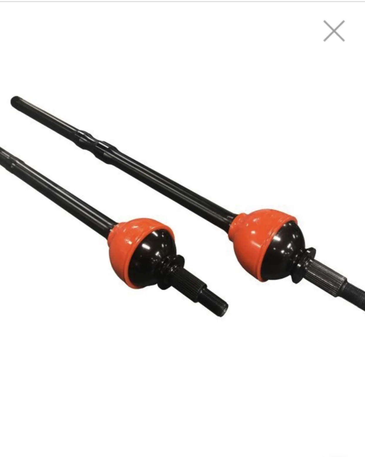

I’m still using the fad....... But the best way in my opinion, is to replace the 2 piece axle with a one piece axle like the rcv........
You can see the indentation on the axle shaft in the picture, that’s where the fork of the fad is located. So when you engage to 4wd the fork still moves so it doesn’t throw any nanny codes. It still thinks it’s working.
Have really liked the idea of the RCV axles. Was going to install them in our 2015 RUBI until it crashed. I am going to do the solid RCVs without question and the FAD delete dimple is serious Icing on the cake.
Is there not a way to mechanically lock-in the FAD on the JL? I locked mine in on my old YJ by removing the cover and bolting the mechanism in place.
