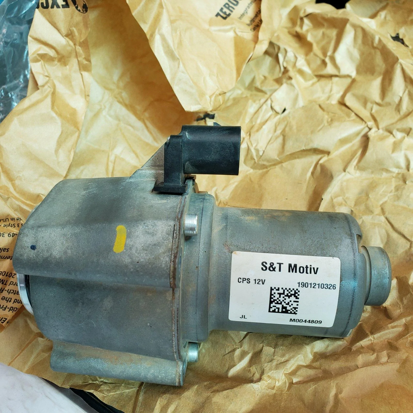

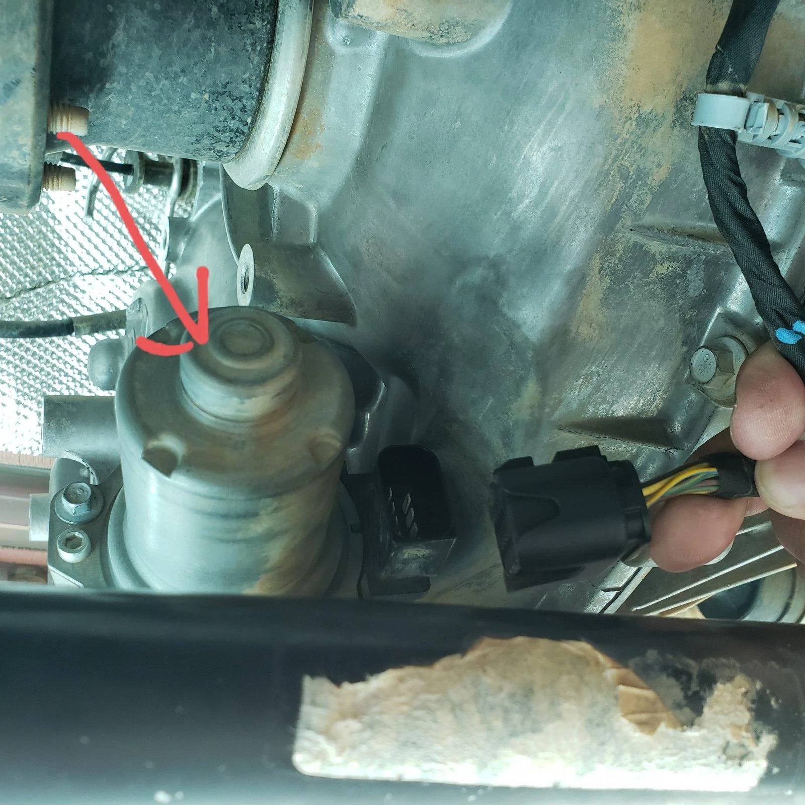

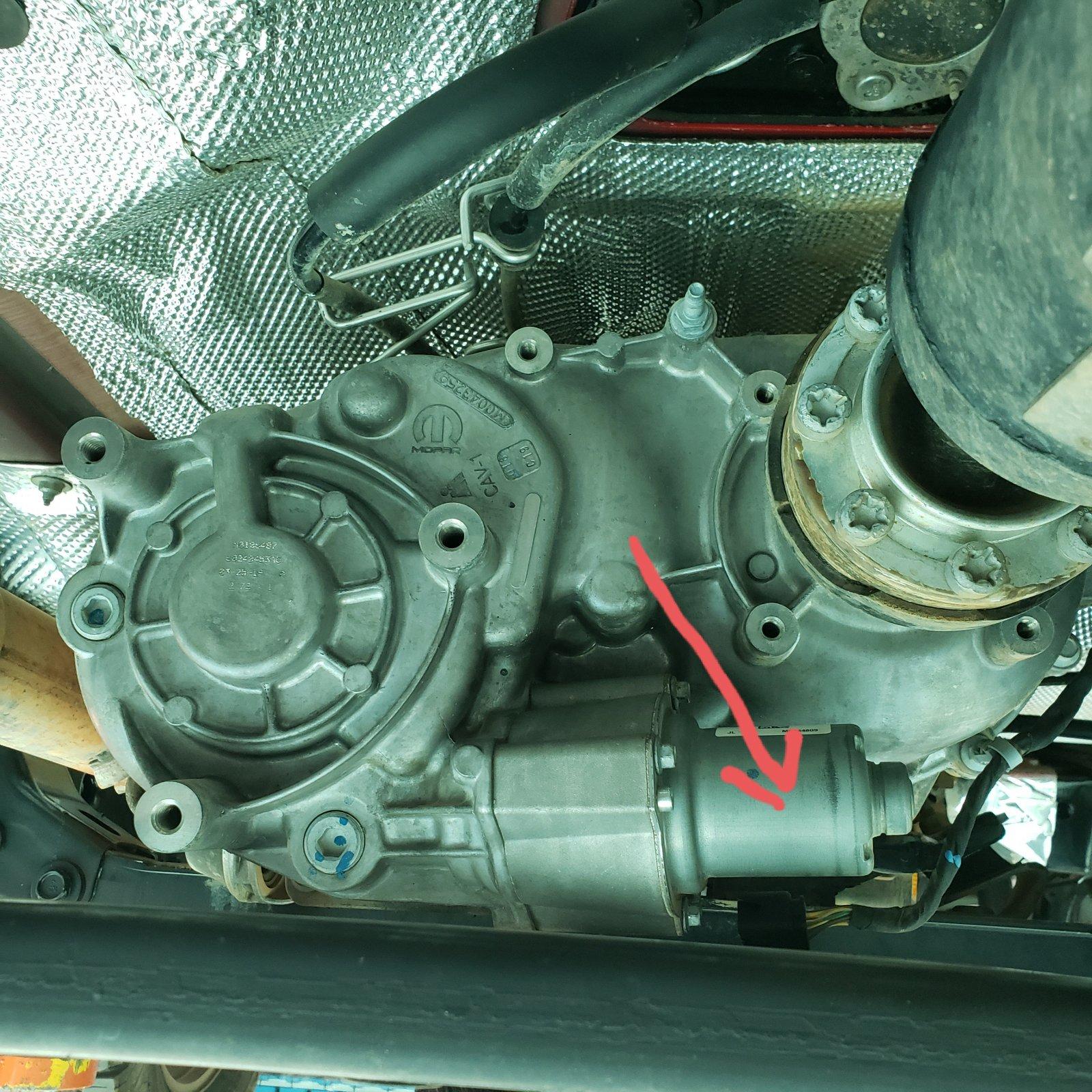

Hello Imbon, Good night. Yes, the problem has been solved. The small motor attached to the transfer box was identified as the cause. This exchange was carried out under the guarantee. The photos illustrate this little engine.
