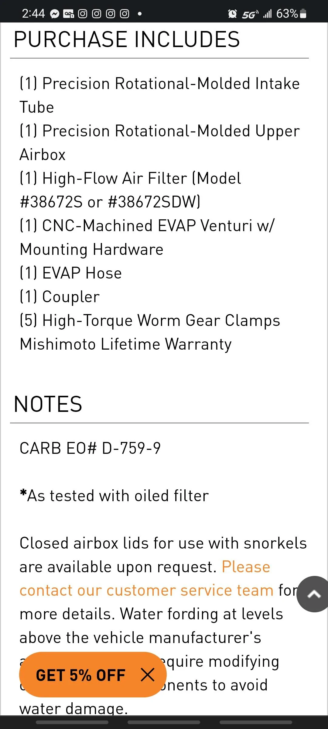

As far as the carb eo compliance, here's a screenshot of the product page...
Jeep Wrangler JL Go Fast Bits DV+ install question Screenshot_20221207-144408_Chrom
One of the install videos I recently watched ended with the installer attaching the included CARB EO decal on the top of the filter housing.

I guess Mishimoto does have a CARB EO now... not sure how I missed that. I hate to sound like a Banks fanboy, but I do like that all their products are CARB approved... As I've gotten older I've learned it's just easier to comply with the laws.

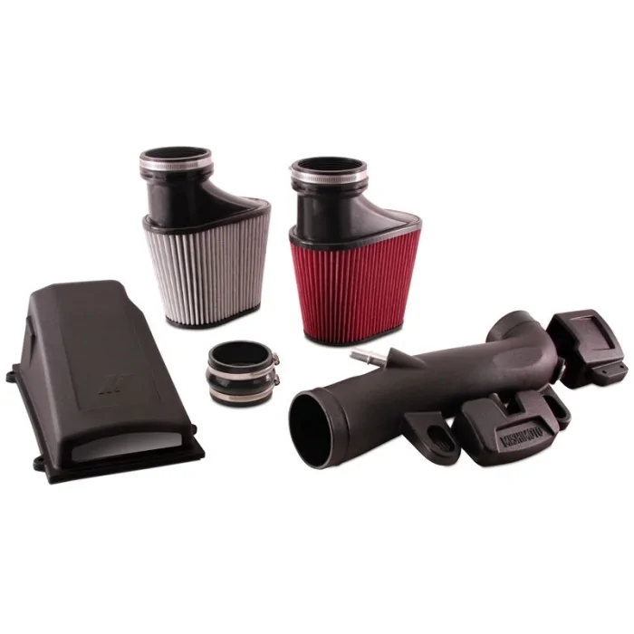

I'm pretty sure Mishimoto is calling their Helmholtz chambers "dyno-tested resonators". They can be seen as the growths off the side of the tube. I also noticed that they re-use the lower half of the box & turbo coupler, whereas the Banks replaces the entire box & attaches closer to the turbo... I actually like the Mishimoto style better as it modifies less and reuses more OEM parts. In theory the Banks should be better for performance, but in reality I doubt we'll ever see a noticeable difference with the tuning available.
Oh, don't take me the wrong way. I'm not at all trying to sway you in any particular direction, just wanted to mention that mishimoto's intake is carb eo certified to both open up your options and to keep it in the running for other like-minded people.

Also, it does replace the rubber turbo coupler with their reinforced silicone version. It shows that piece in the pic you posted, unless I'm confused about the part in question.
They're different... compare these videos (hopefully they start at the correct time).
Oh yeah, different in deed. And yes, they both started at the perfect spot. Thanks for clearing that up for me.
