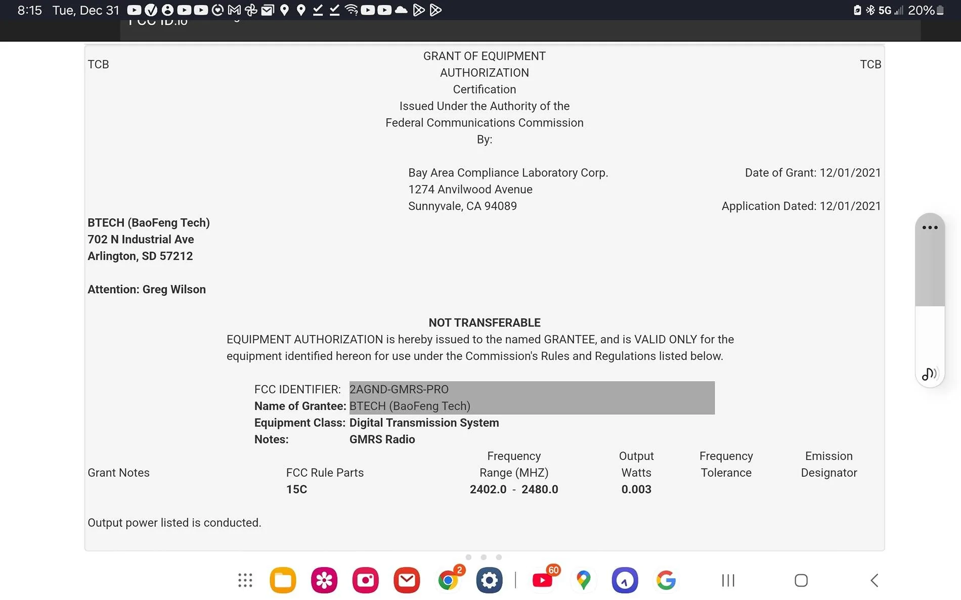

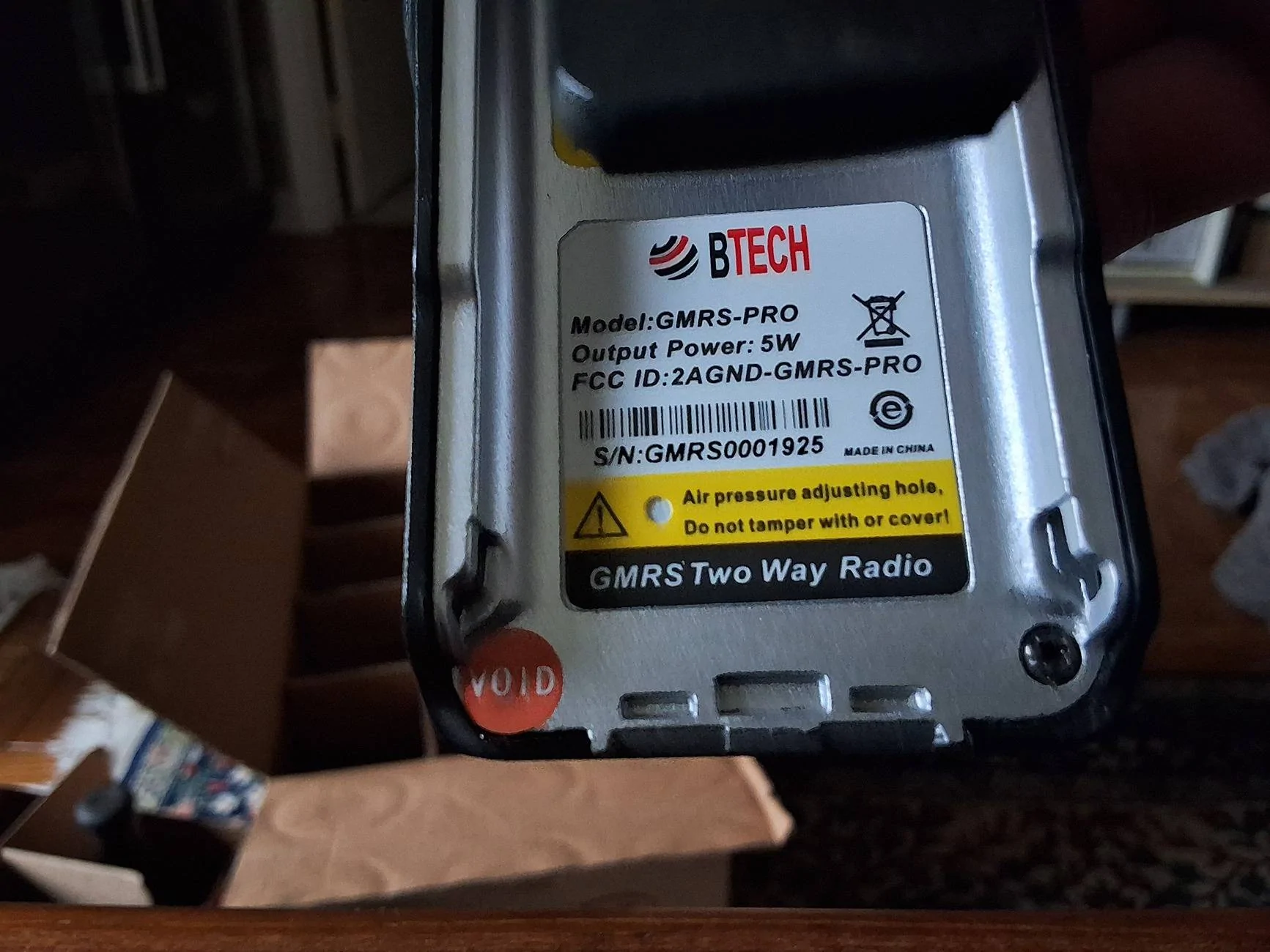

Well, since I didn't fix my cherrios yet, I decided to see if my cheap chinese radios were type approved. So, I read as much of Title 47 Part 95 as I could on an empty stomach. In my career, I spent a lot of my time researching the Code of Federal Regulations for airplane certification and operation. So, I'm very familiar with the CFR architecture, but it's still a pain to navigate.
Apparently, the proprietor of BTech is an importer based in South Dakota and submitted these Bao Feng sourced radios for certification.
I had found the grant certificate for my radios and was going to post it with a screen grab, when the power around here went down. So, I'm on a mobil device for now. But I just wanted to post that my BTECH (a.k.a. Bao Feng) GMRS-PRO cheap chinese radio (not all that cheap @ $150 ea today) is indeed FCC certified. So, not all Bao Feng radios are junk. In fact, my GMRS-PRO radios have very clear reception and transmission. I've used them for trips lasting a few days, leaving them on the entire time on a single charge. So, they have a battery saving mode when there's no transmission/reception activity. I'm pleased with them and would recommend them after having them for a couple years now.
Jeep Wrangler JL GMRS Radios? 20241231_072814
Jeep Wrangler JL GMRS Radios? Screenshot_20241231_081533_Chrom

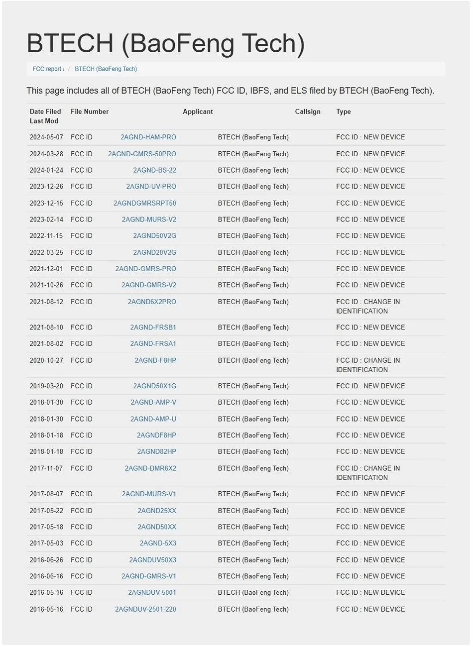

Just to level set on BTech (Bao Feng) radios and FCC approval. Here's the list of approved radios from BTech. I have no idea if this is all of the radios they sell or most or a small part. But, this is the list of their radios meeting FCC requirements from the FCC website.
BTECH (BaoFeng Tech) FCC Filings
Jeep Wrangler JL GMRS Radios? Btech approved radios

If you are curious if your radio is FCC approved, remove the battery and look for a sticker with an FCC ID. That number is evidence of approval and can be verified on the FCC ID lookup site. From the chatter on the web, the BaoFeng UV5R might not be.
