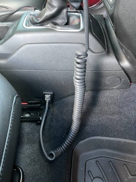

Yes some info overload here. You are correct, no need to overthink it just get two decent handhelds. Also not KISS but MXT275 has a power out connector allows you to use a splitter cable to charge two handhelds. I know, I know not helpful. I ran a usb extension cable to the glove box so I can charge two handhelds there
Jeep Wrangler JL GMRS Radios? IMG_2301

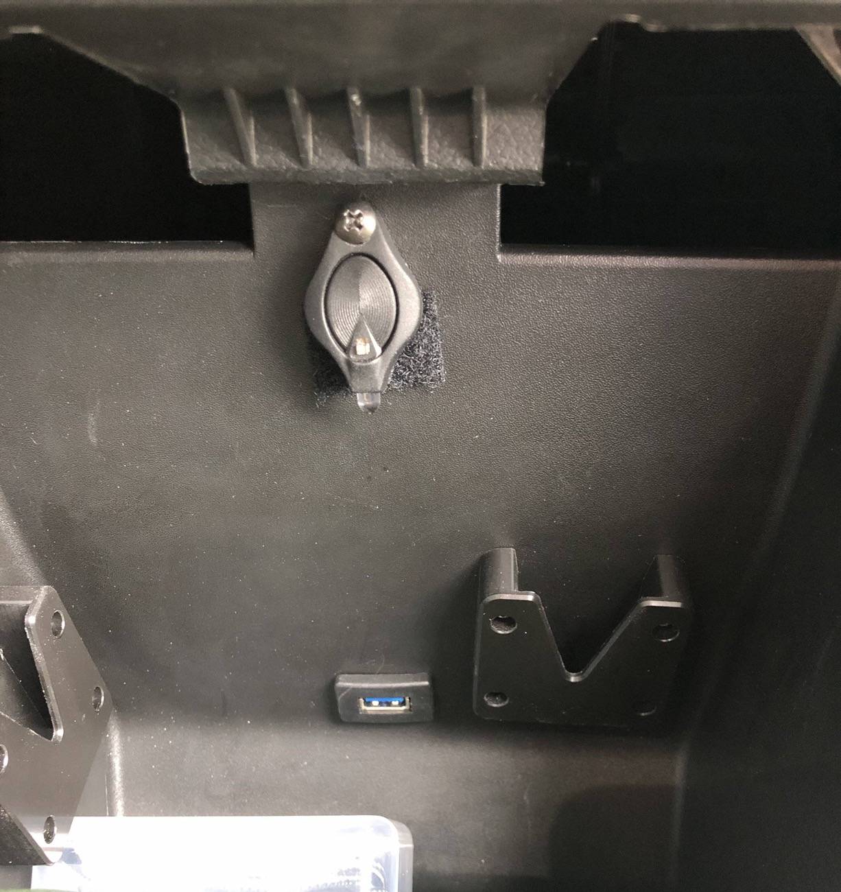

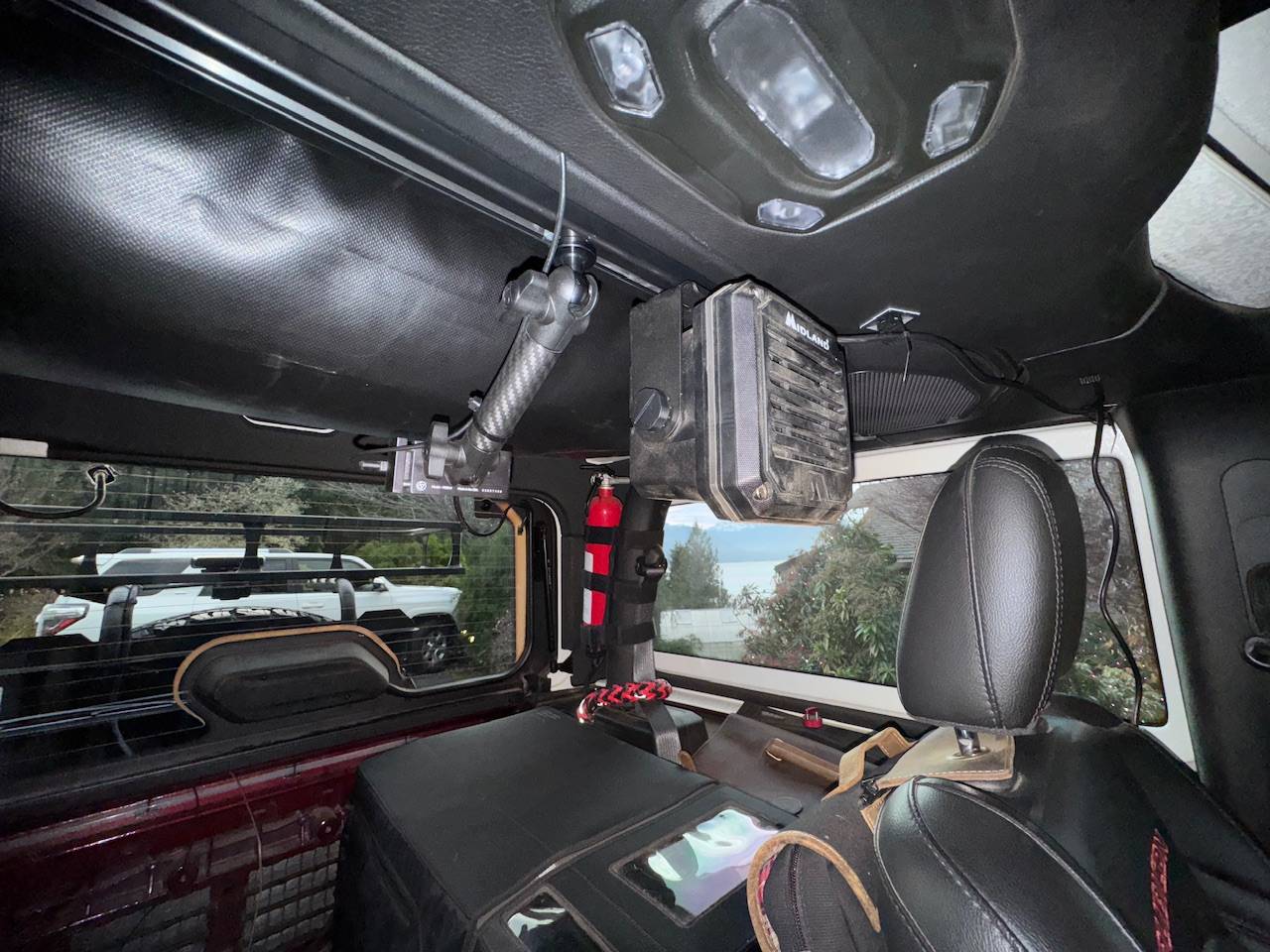

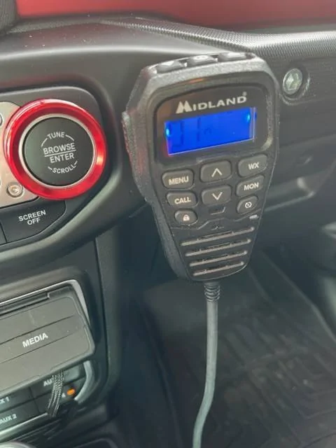

I do the same with MXT575 mounted under the seat and a Ethernet port for the mic. Also ran an external speaker near my head on a Vector E rail mounted above me.
Having two rechargeable handhelds are ideal for spotting/sharing as Terrymo mentioned. Here is my set up…
Jeep Wrangler JL GMRS Radios? IMG_1429
Jeep Wrangler JL GMRS Radios? IMG_1430
Jeep Wrangler JL GMRS Radios? IMG_1564

Yeah pretty sure I stole your idea on the center console mounted Cat5 extension 👍
