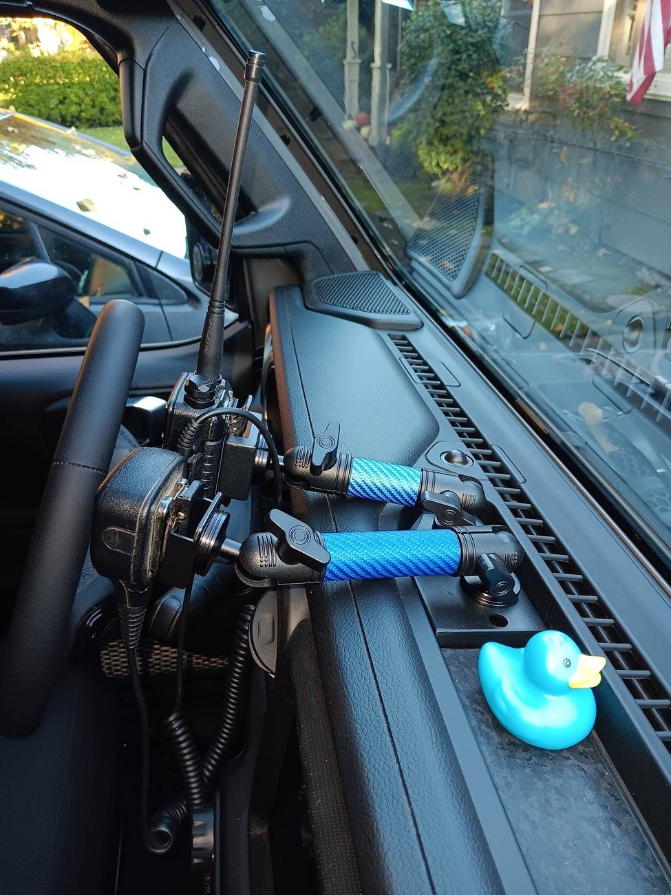

Baefeng UV 8w radio with an attached mic using Bulletpoint mounts. Also a battery delete so the radio is plugged into the cigarette socket.
I have both my Ham (KI7TSP) and GMRS license. This radio handles both Ham and GMRS frequencies. Eventually I'll get a larger radio, but till then this works fine for trail use.
This set-up works nice as I don't have to worry about setting the radio down as I'm driving, or dropping it on the floor while driving. The sound comes out of the handheld mic.
