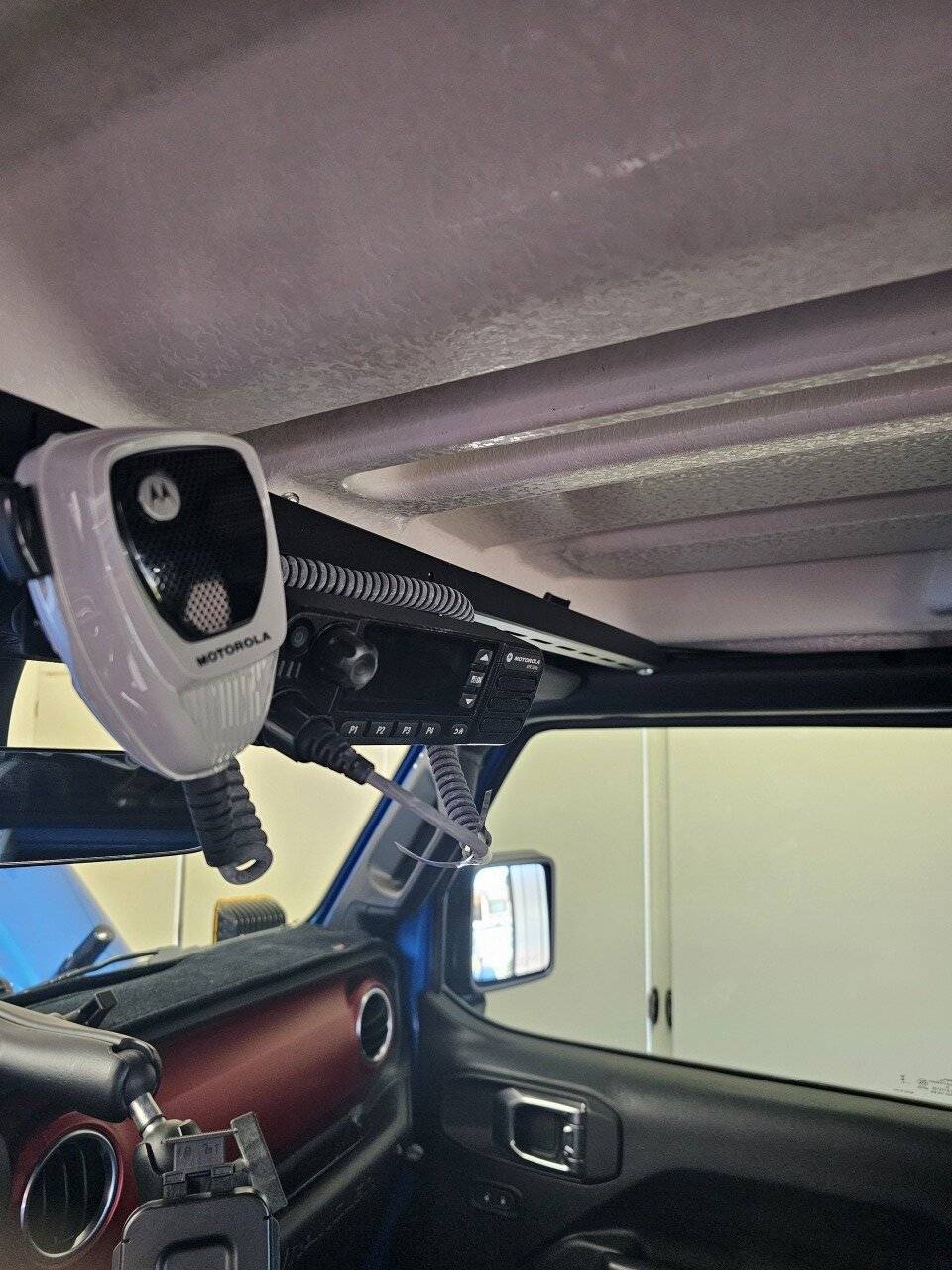

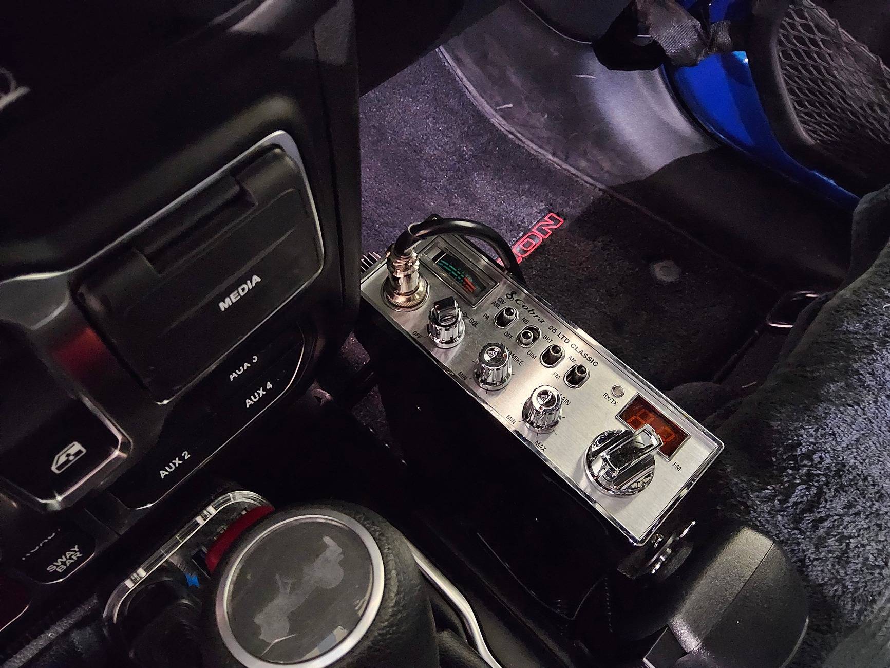

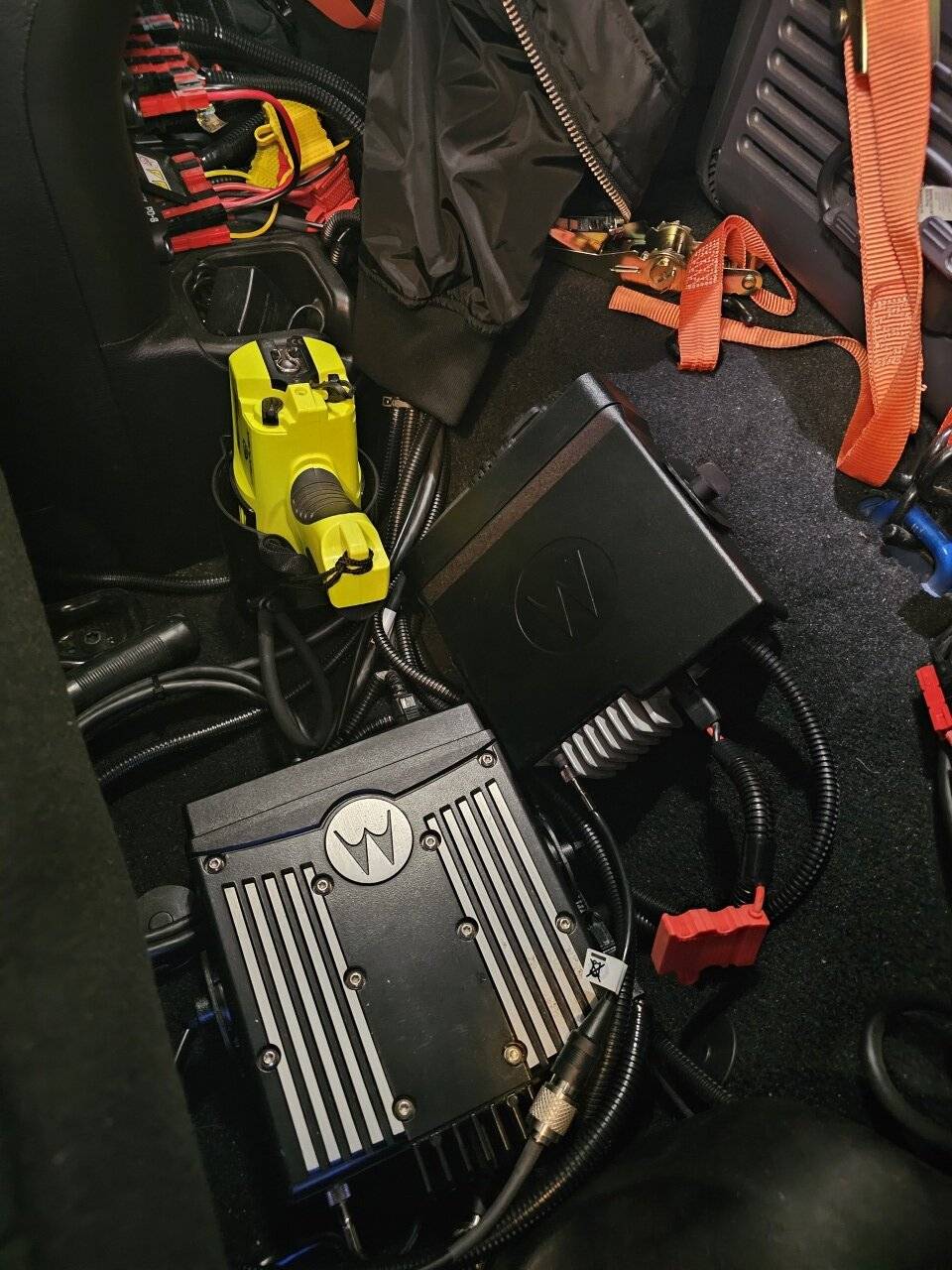

I have a Cobra 29 LTD Classic AM/FM CB, Mototola XTL2500 840 Channel VHF remote mount, Mototola XTL5000 High Power UHF Remote Mount, and Motorola XPR5550e UHF DMR Remote Mount. I also carry two Motorola XTS5000 Model IIIs (VHF & UHF) and a Motorola XPR7550e (UHF) portables.
I use the Motorolas because I am licensed on a bunch of Part 90 freqs and use them for other purposes in addition to GMRS. I also use some VHF & UHF Business Radio Freqs for some off-road trail group runs.
As for a good quality consumer grade GMRS radio that is simple to use for the trail, I would look into the Midland MXT500 or the MXT575 radios. The MXT500 is a 128 channel 50 watt radio and you can customize 98 channels. The MXT575 radio is only a 30 channel 50 watt radio with no ability to customize channels. Either radio will be perfect for Jeep groups on the trail.
