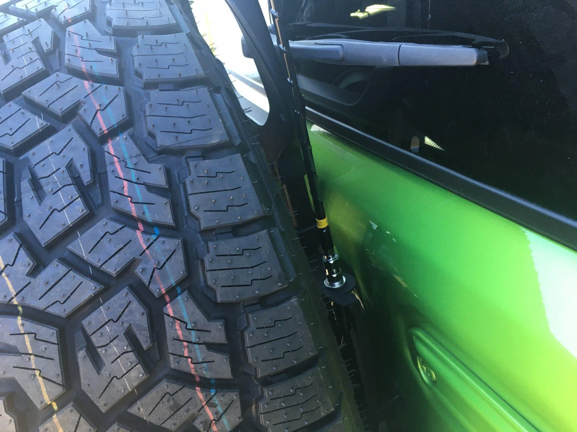

Jeep Wrangler JL GMRS antenna mounting PXL_20201114_215218517.MP
late to the thread, but here's mine mounted. I'm not in love, but the reception is good on my QTX radio (HAM and GMRS). I have the CoolTech mount for my CB off the spare tire... Same fitting, so tempted to mount it back there but worried the tire, top, etc might impede signal.

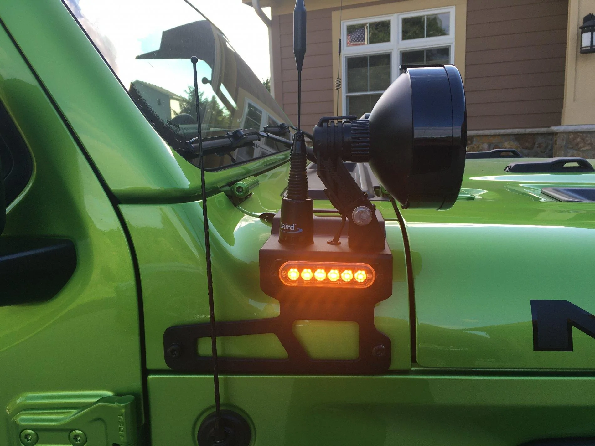

Good Day All! Some of you may have seen the modified cowl mount for driving light, antenna, and turn signal (pic & link here) that I built earlier this summer, but I have since made a couple of other additions.
https://www.jlwranglerforums.com/fo...t-antenna-turn-signal-mounting-bracket.55867/

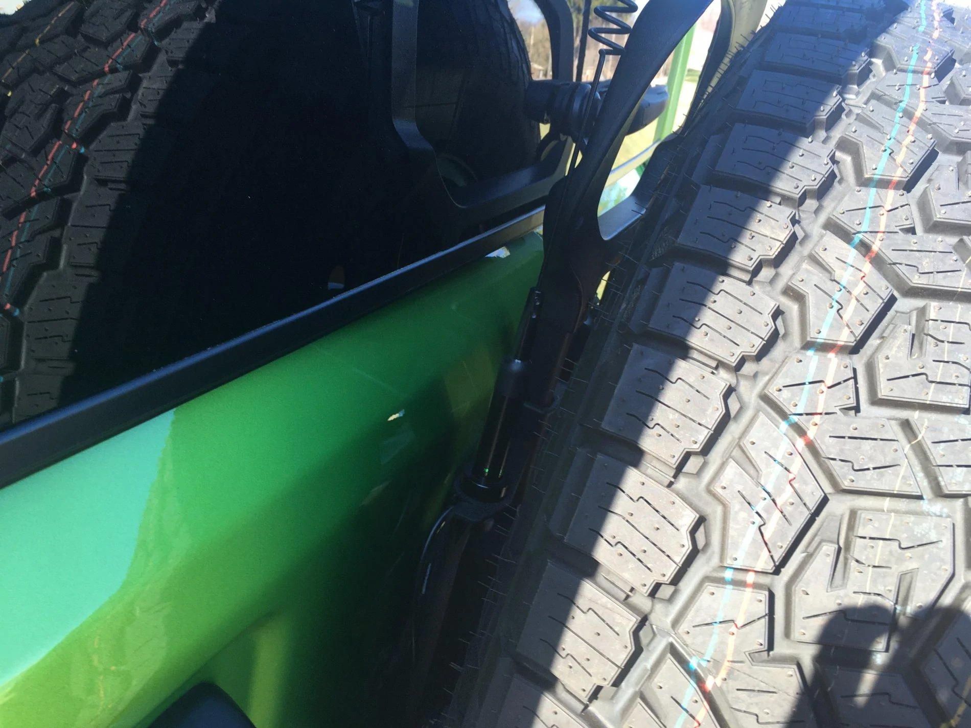

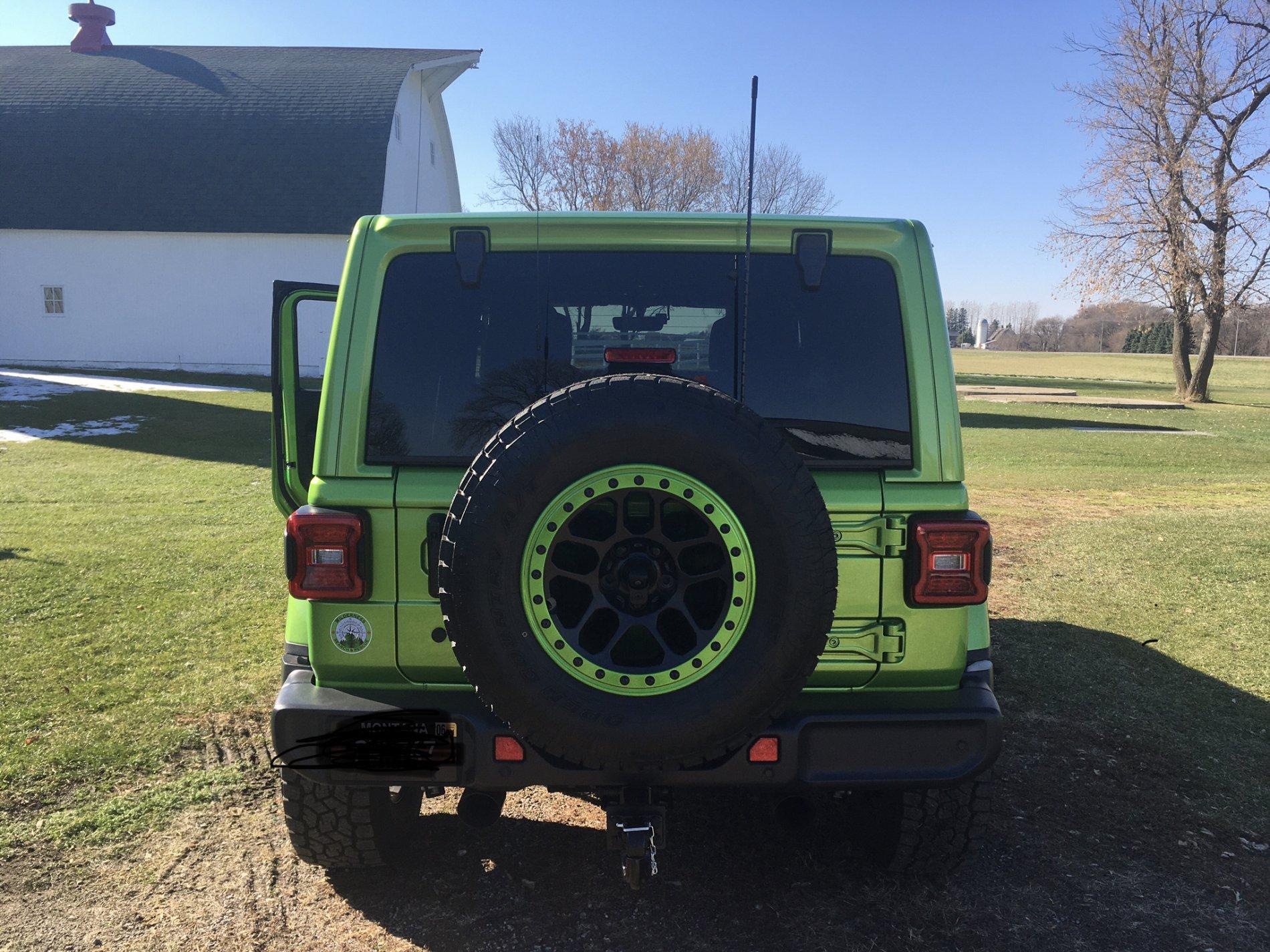

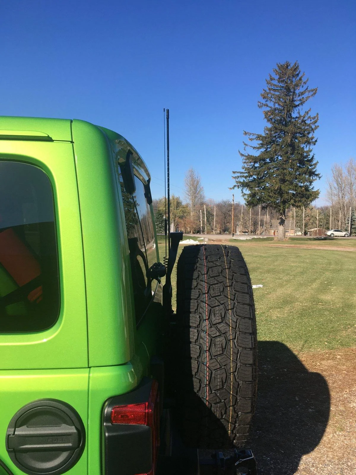

I added two more antenna mounts to the rear (I operate on HAM, FRS, GMRS, CB, and Public-Safety bands). The mounts are ā€œKraken Offroad Premium Antenna or Flag Mount Bracketā€ (both driver & passenger). The Amazon link is here, but I believe they are available directly from Kraken and others.
https://www.amazon.com/Wrangler-Premium-Antenna-Bracket-Driver/dp/B07YXFVJLC
On the driver side, I moved my no ground plane Diamond NR73BNMO dualband (VHF/UHF) antenna from the front to this location (and now use the front driver cowl mount for a monitor antenna). On the rear passenger side, I am using a FireStik 3’ no ground plane CB antenna. Both of the tailgate mounts work great (as an aside, the factory bolts they attach to are grounded) and were easy to attach (less than 5 minutes total). Ran the coax thru the already existing tailgate grommets and brought them forward (because of its properties, I did not want to coil or bunch up the CB cable so I sort of zig-zagged it thru the passenger compartment so it never overlaps itself).
Neither antenna hole was drilled-out; the CB antenna mount hole is standard size and the dualband mount I just used a 3/8ā€ NMO cable kit. My only concern with Wrangler tailgate antenna mounts is that every time you open and close the tailgate, the coax bends. Nature of using this location. They have survived four years on my ā€˜16 JKU so hope they survive here, as well, particularly the CB antenna because the coax is also part of the artificial ground plane. For fun, next spring I plan to try a 2’ NGP Firestik CB antenna if it will clear the roof.

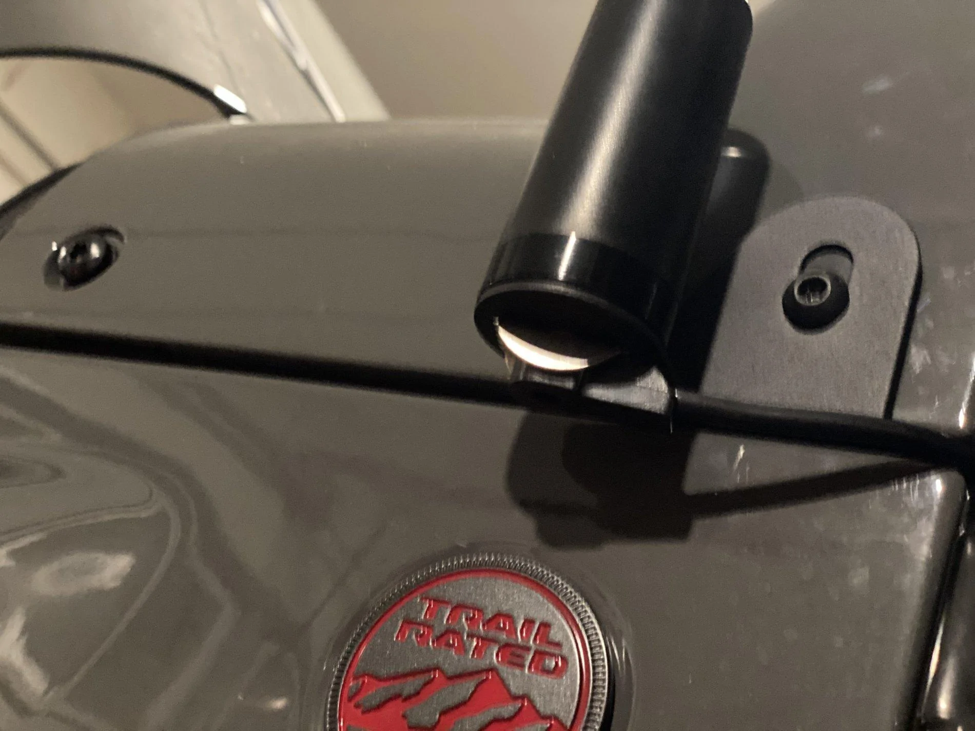

Just mounted mine up using the Rugged Radio bracket. It will only work on the driver’s side cowl unless you are running the antenna delete on the passenger side. I plan on running the Rigid cowl mounts and this appears to work perfectly since you can’t place the mount on the foremost cowl bolt because the cowl is tapered (ask @chevymitchell as he did the radio and wiring install and identified this first - I sent his video to Rugged Radio and they are supposedly updating the website).

Is reception hindered on the tailgate? Would much prefer that over a front mount.
Reception will have minimal interference(attenuation), but transmission will be reduced a bit in the areas obstructed by the jeep assuming a standard monopole or ground plane antenna.
DrPerez007
Nov 1, 2017
279
848
Wisconsin
See Signature
Public Safety & Legal Consultant
@DrPerez007
Unfortunately, I’m in Florida for awhile at my winter place and do not have my MOAB with me, so my experience is limited since I just made the change-out before I departed. If I were guessing, maybe one to two ā€˜db loss’ at the rear, but effectively insignificant for all practical purposes. The rear antennas are both ā€œno ground planeā€ antennas, but, yes, they will have some issues with the ā€œnon metalā€ Jeep top, particularly in the back with the rear window defroster wires and the spare tire (which both can create a ā€œreflectorā€ issue) and the fact that the antennas are not clearing the roof by that much. In reality, the front mount will give you a more omni-directional pattern, and might slightly improve the signal, but I don’t want the RF beaming into the passenger compartment, even at my wattage (nothing more than 50 watts).
IMHO, at the end of the day, both of these locations are a toss-up. Actually, the best location would be the roof with some type of artificial ground plane installed (like copper tape) or mounted on the front grille guard or near the winch or on the front bumper. Short of that, I don’t really think any of the freqs we operate on or the power levels we use make that much difference for most mount locations (other than noted above). A bigger issue for a lot of people is the type and quality of antenna, coax, and connectors, which can result in more ā€œlossā€ than antenna placement. I see a lot of people spending good money on radios than skimping on the accessories needed to make them work properly.
