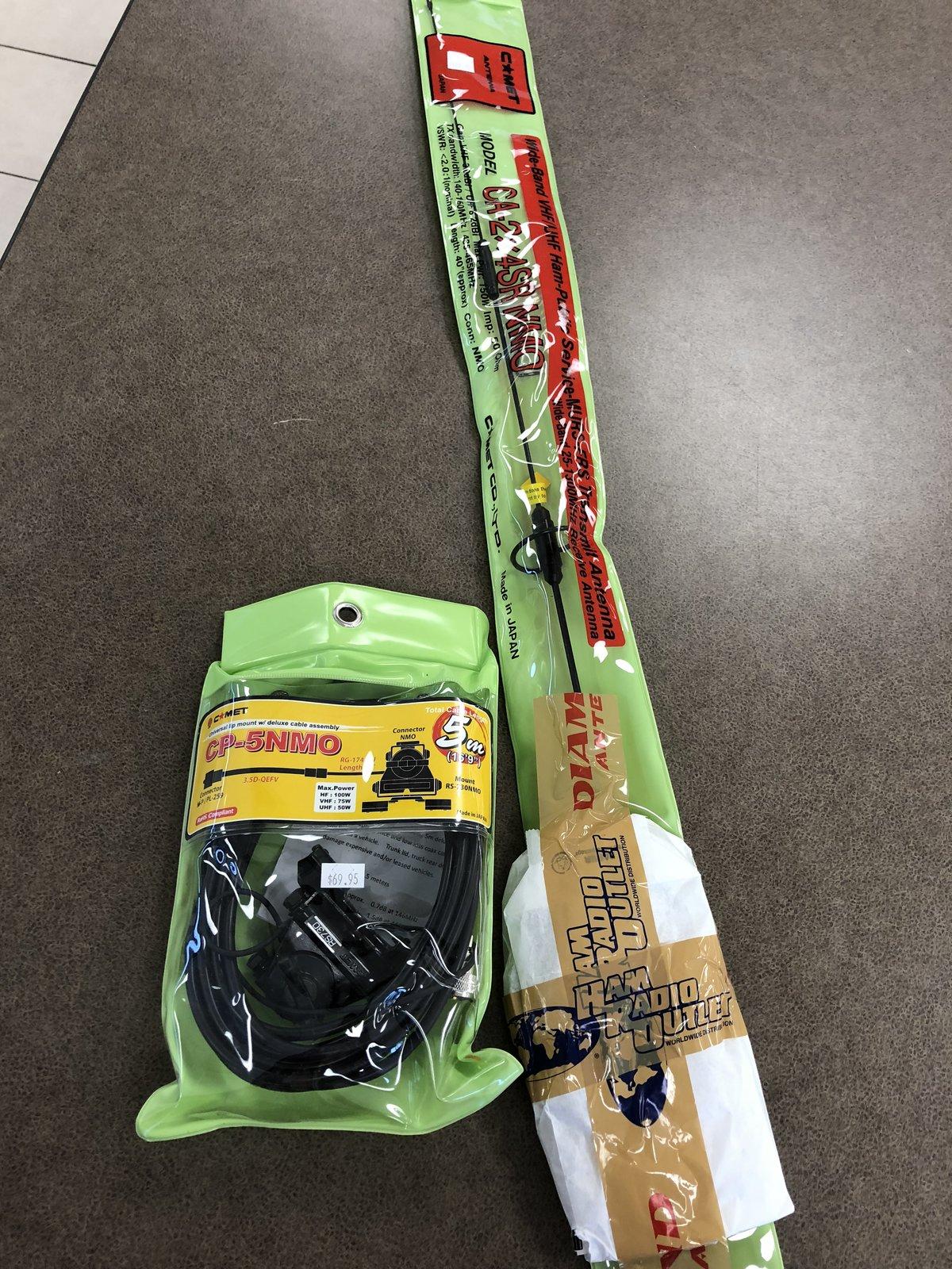

Someone pointed out that if I bought a wide band antenna, I wouldn’t need a meter, so my Comet antenna and mount arrived today. Radio won’t be here until Monday unfortunately.

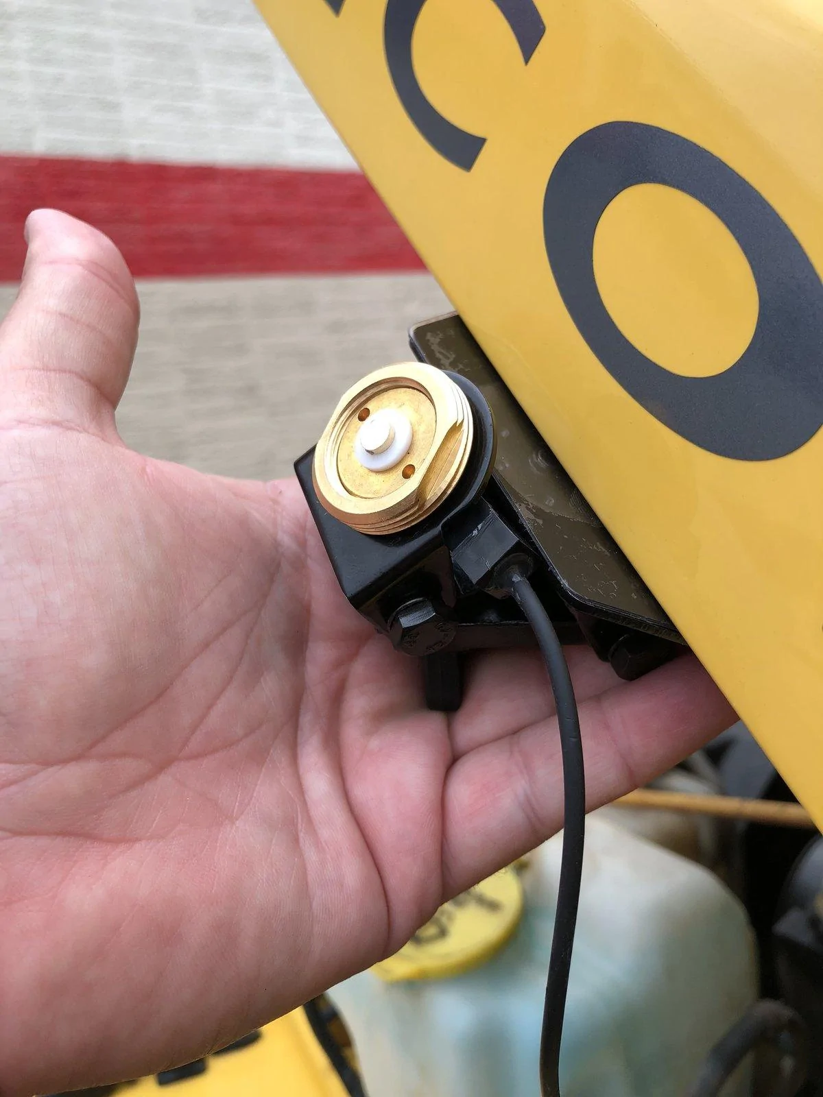

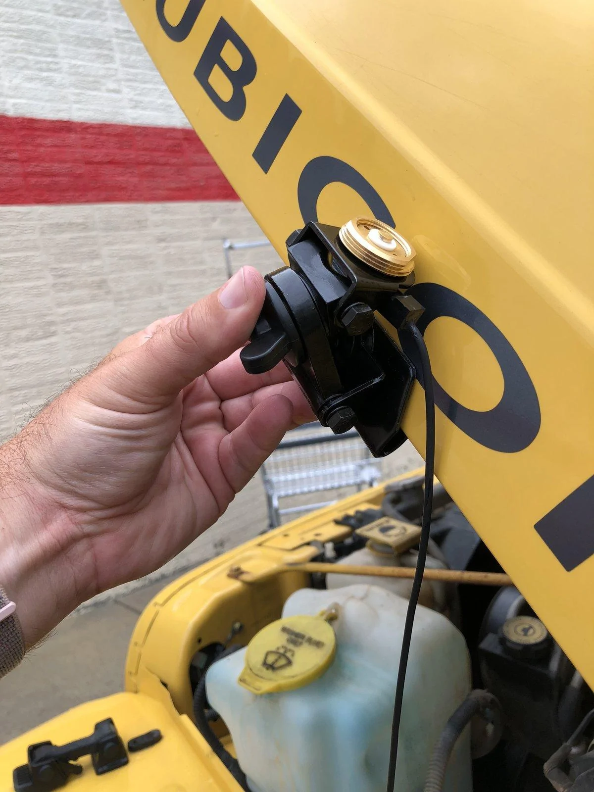

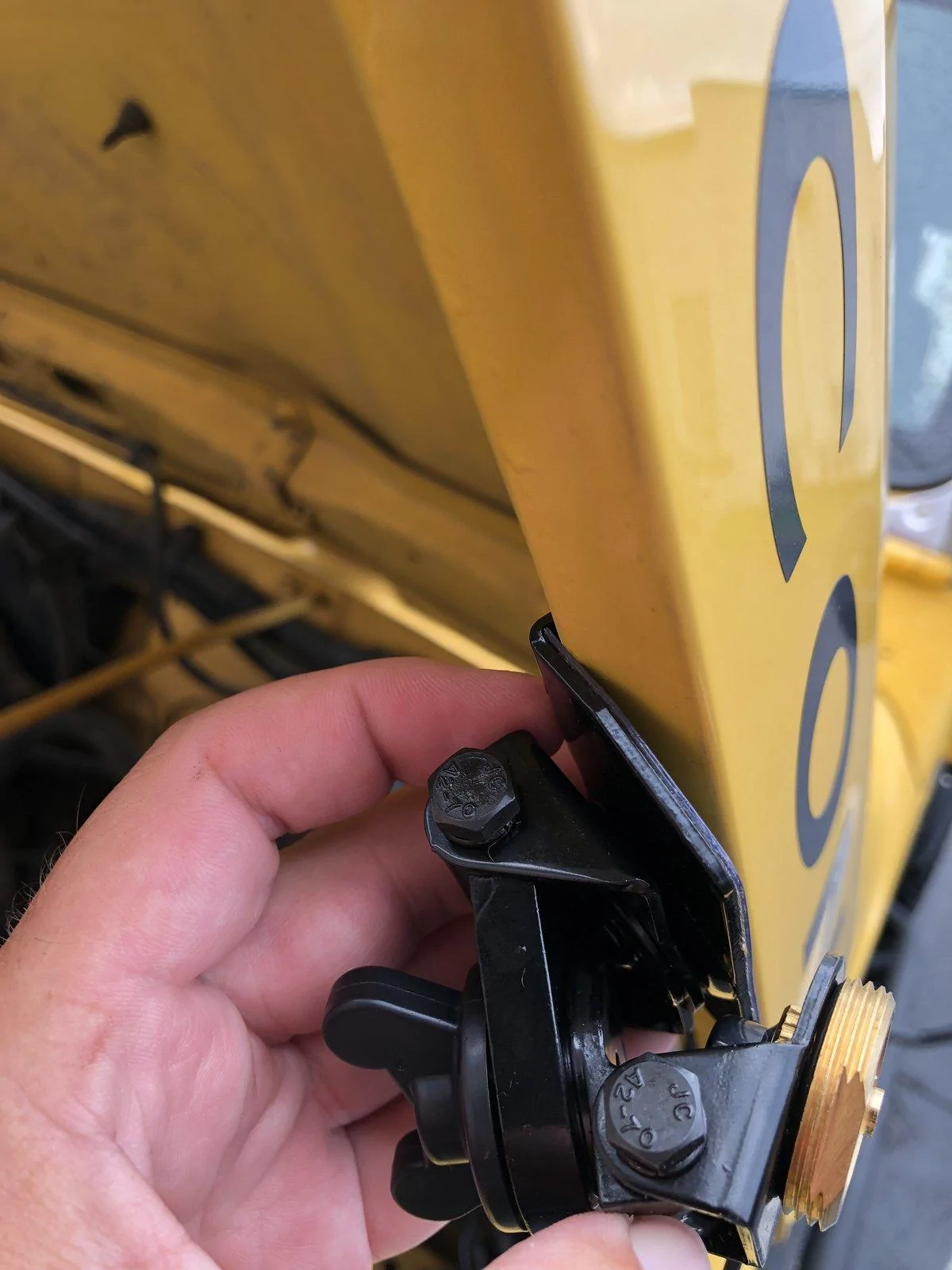

Let us know when you mount it up and post plenty of pics. I'd love to see that thing be the ticket!
So, yeah, it won’t work without cutting.
Keep in mind this is a (replacement) TJ hood. Your JL may work fine.
Here’s how it’s supposed to look.
Jeep Wrangler JL GMRS antenna mounting 51422F7A-FA20-40A6-B235-F57B50BA6292
But I have a horizontal lip on my hood.
Jeep Wrangler JL GMRS antenna mounting 4230B3D3-85F5-4427-A076-EAB6CDF5AF84
So without cutting a couple of gaps into the horizontal lip the base and antenna would be pointing off at an angle.
Jeep Wrangler JL GMRS antenna mounting 0AB24A0A-6E1B-43A0-9673-38A811C64E90

Does the vendor you used have a good return policy?
I assume so but haven’t checked. The link I posted earlier was to the vendor if you want to check it out.
I’m just going to cut the spaces I need. It’s not as though I’m going to be reducing the resale value and my goal is to never sell this anyway.

Update: I tried cutting slots into the horizontal lip, wasn’t going well, so I just put it on the tailgate (close to the hinges) instead. The coax cable was exactly the right length to run it along the passenger side and along the front of the cabin to my mounting spot under the steering wheel, but a JLU is
a bit longer than my LJ and it wouldn’t reach following the same path I used.
I took a look at a JL hood and it should be fine mounted on that, although I didn’t have the mount with me to verify.

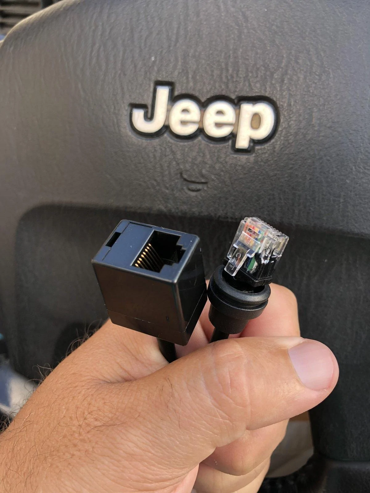

I’m using the new Midland with the mic controls. Tucks up well with my Uniden behind the dash; I miss analog controls but appreciate the waterproofing afforded by hiding them.
Now if only the microphones themselves were waterproof.
The Uniden Ethernet cable extension I ordered seems to work fine with the Midland, btw.
