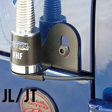

We have the Uniden 760 CB mounted on the tailgate so I was looking at options for an antenna mount for a MXT275 GMRS unit. I found the Rugged Radios fender mount and decided to go that route.
https://www.ruggedradios.com/index.php?main_page=product_info&cPath=736_1353&products_id=2759
Do you have any pics of your finished install?
Which antenna did you go with?
Any issues with the install?
How satisfied are you with the rugged radios fender mount?
I am eyeing the MXT275 as well, and looking to pair it with the MXTA25 3DB gain ghost antenna, and that fender mount looks pretty sleek.
