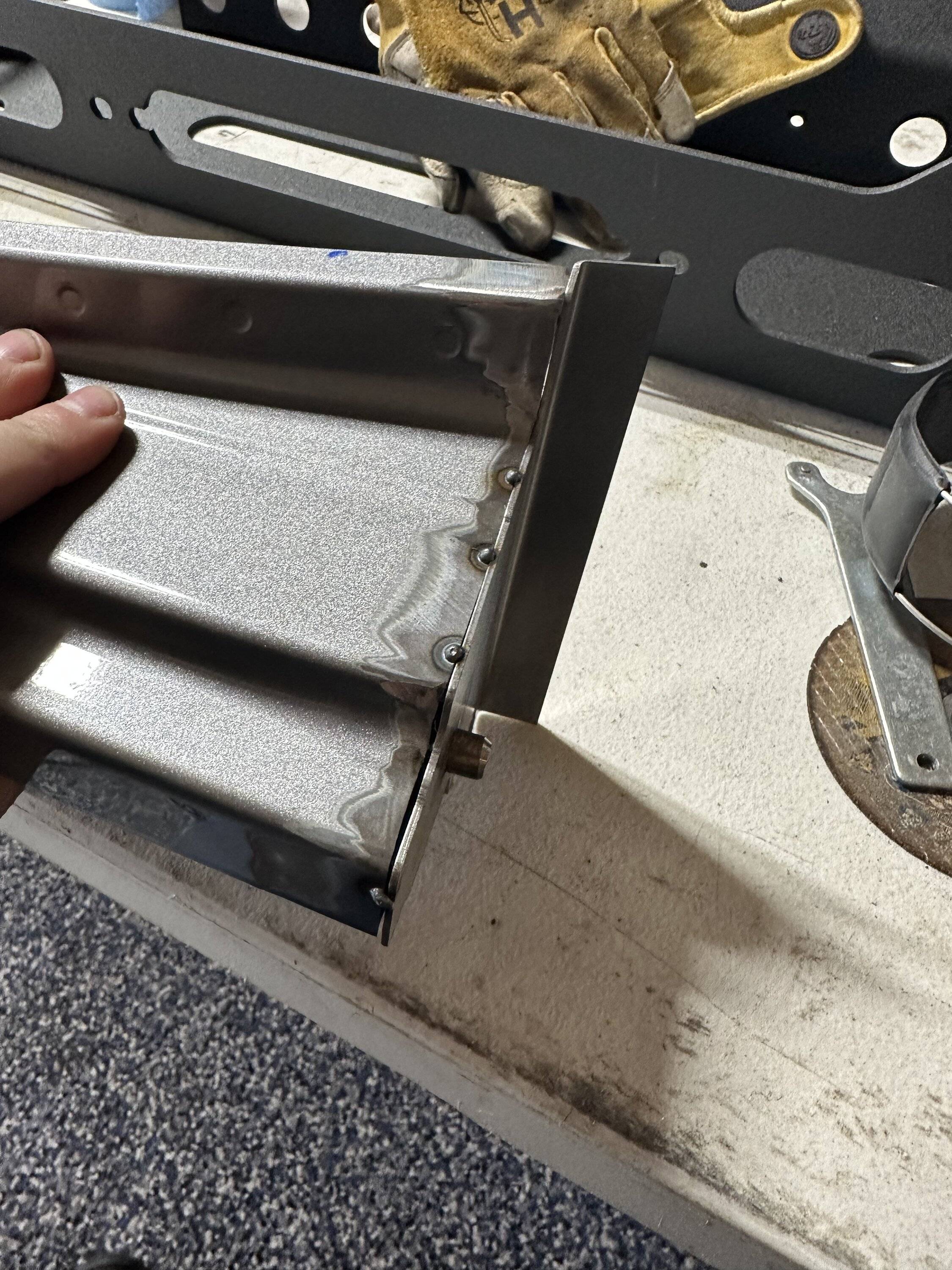

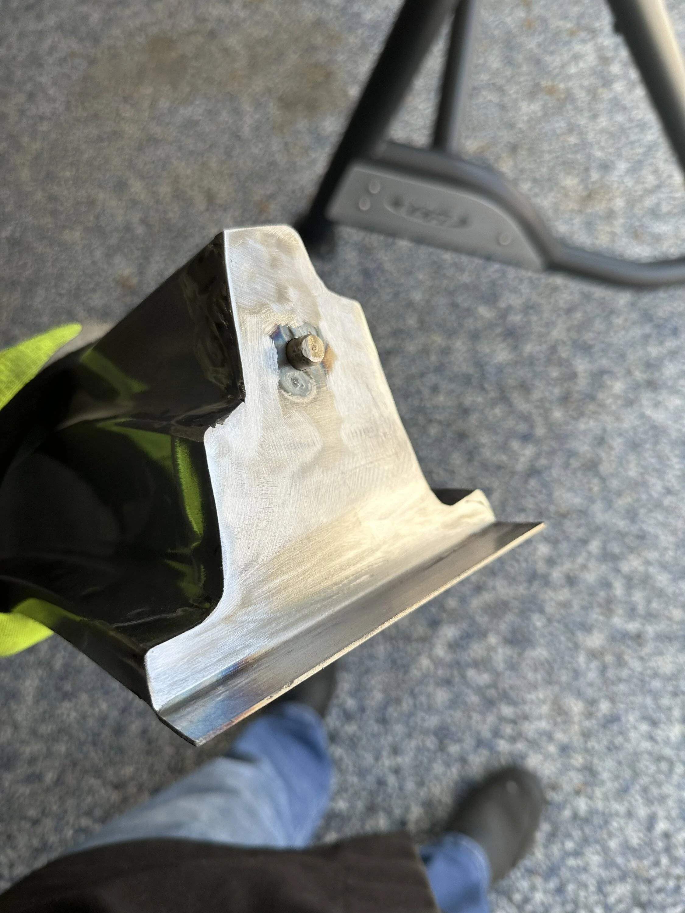

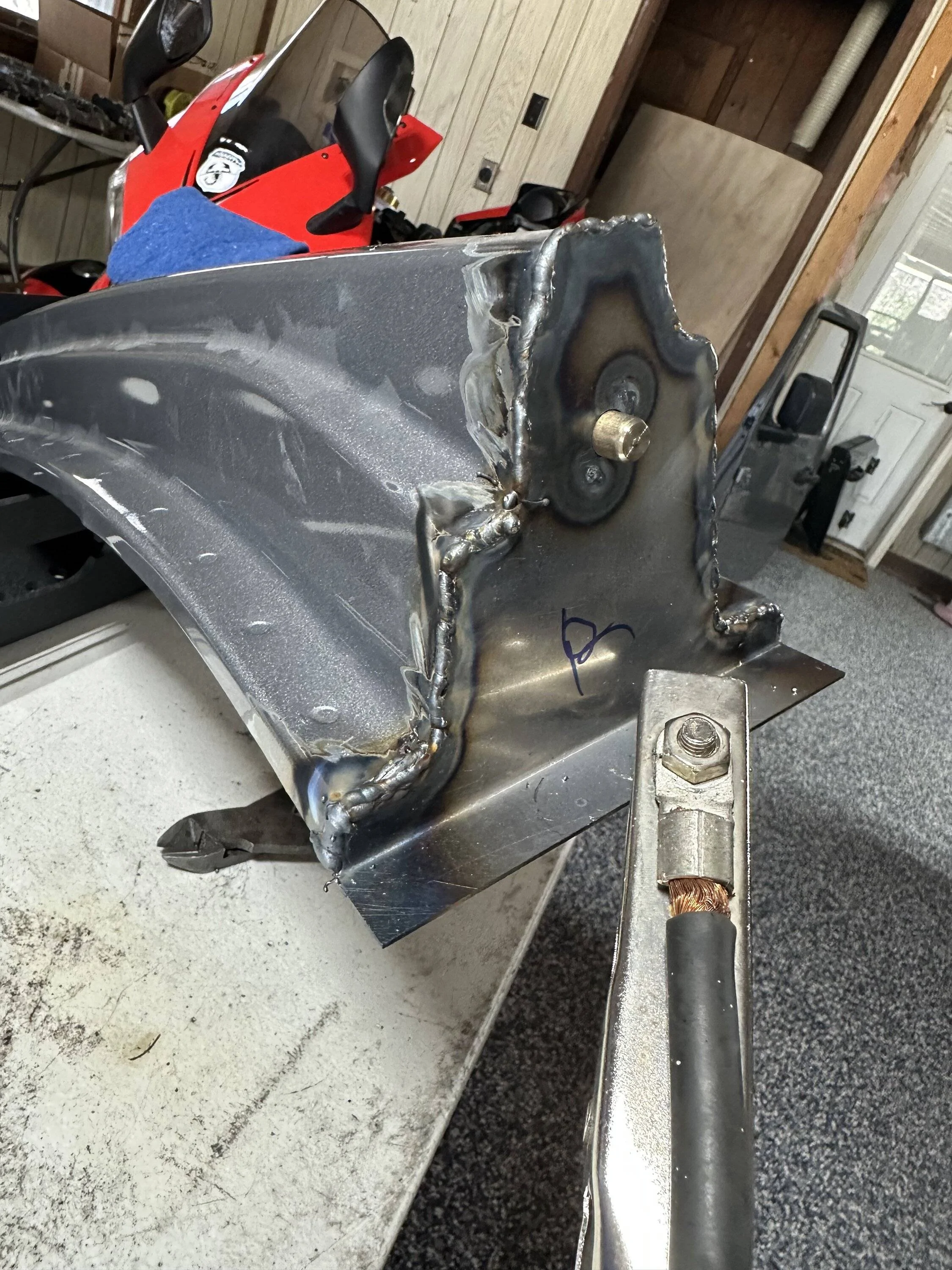

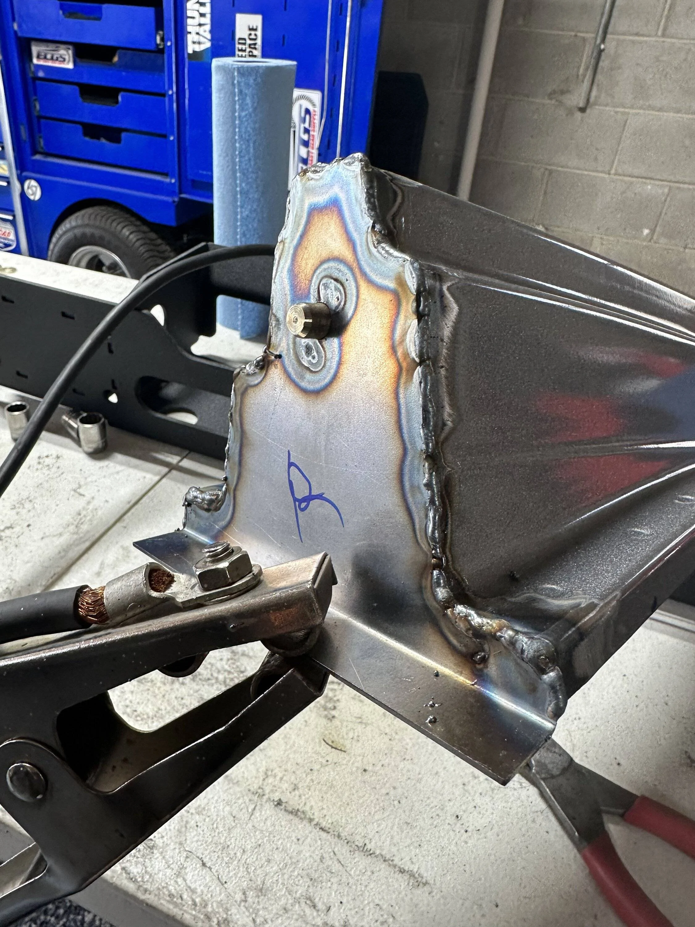

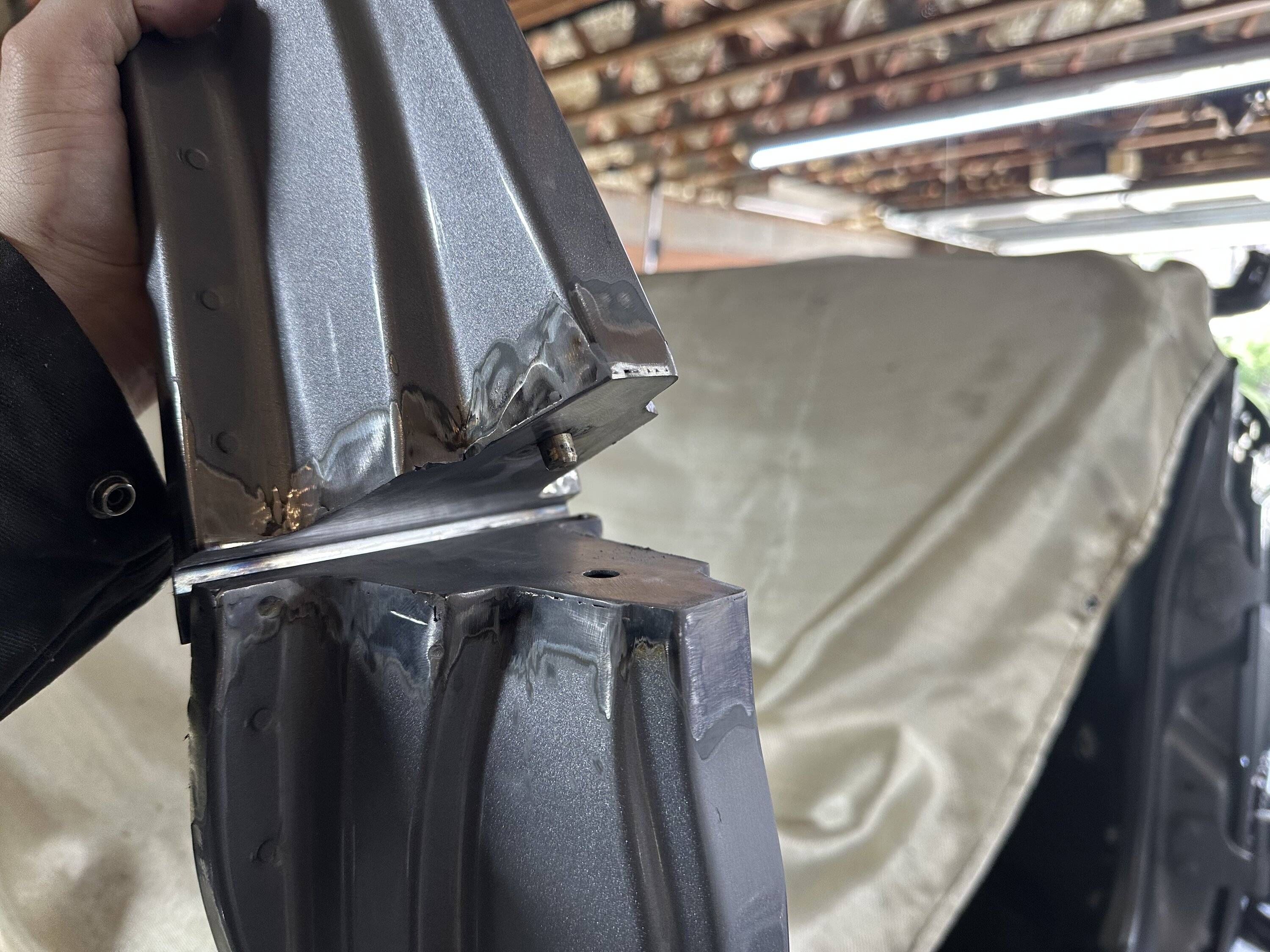

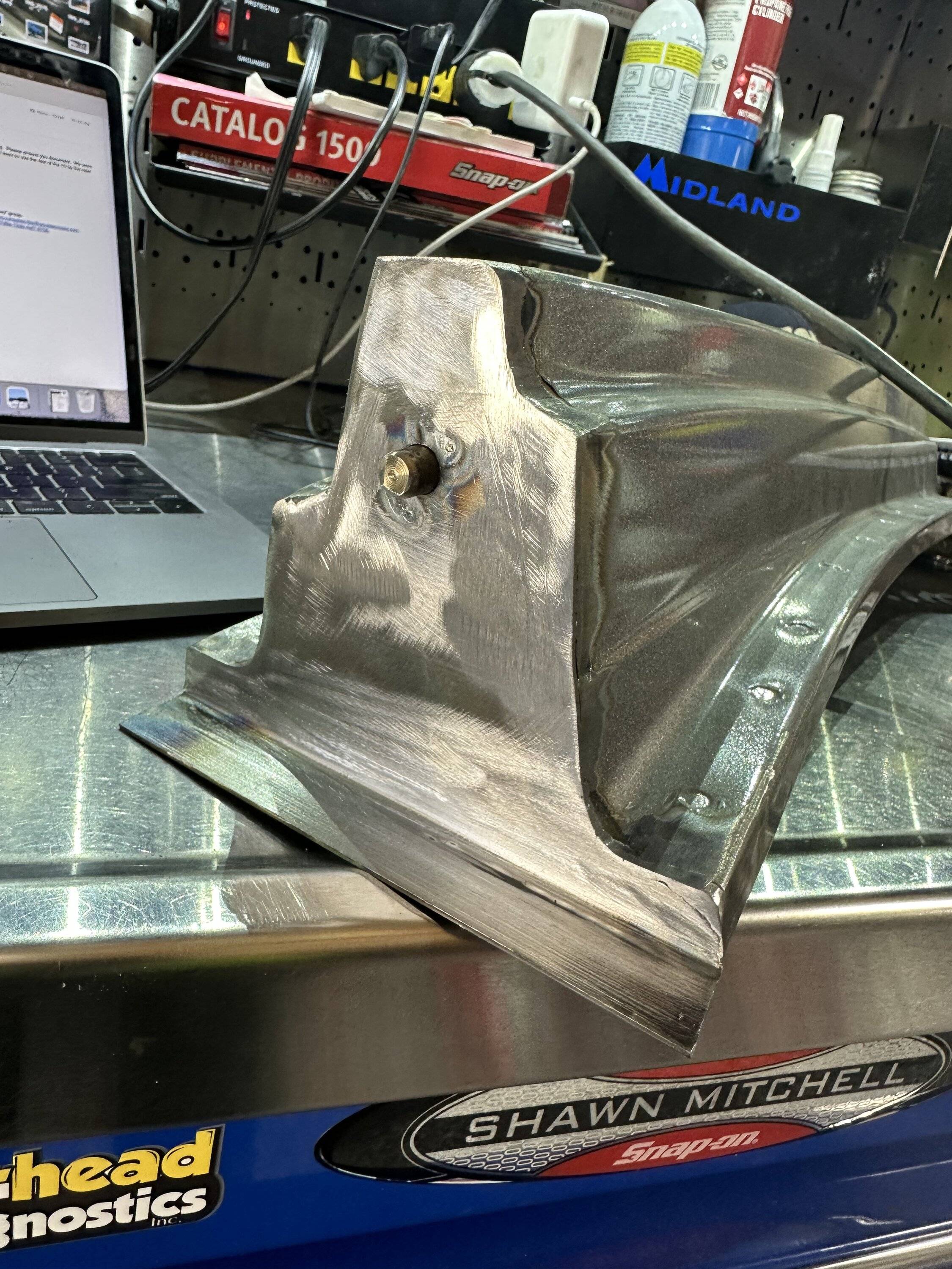

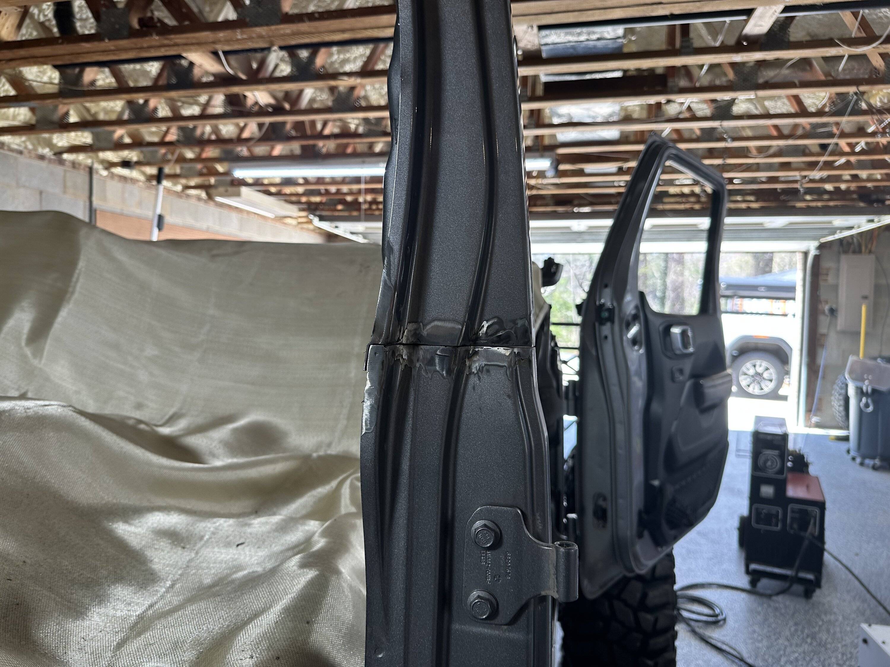

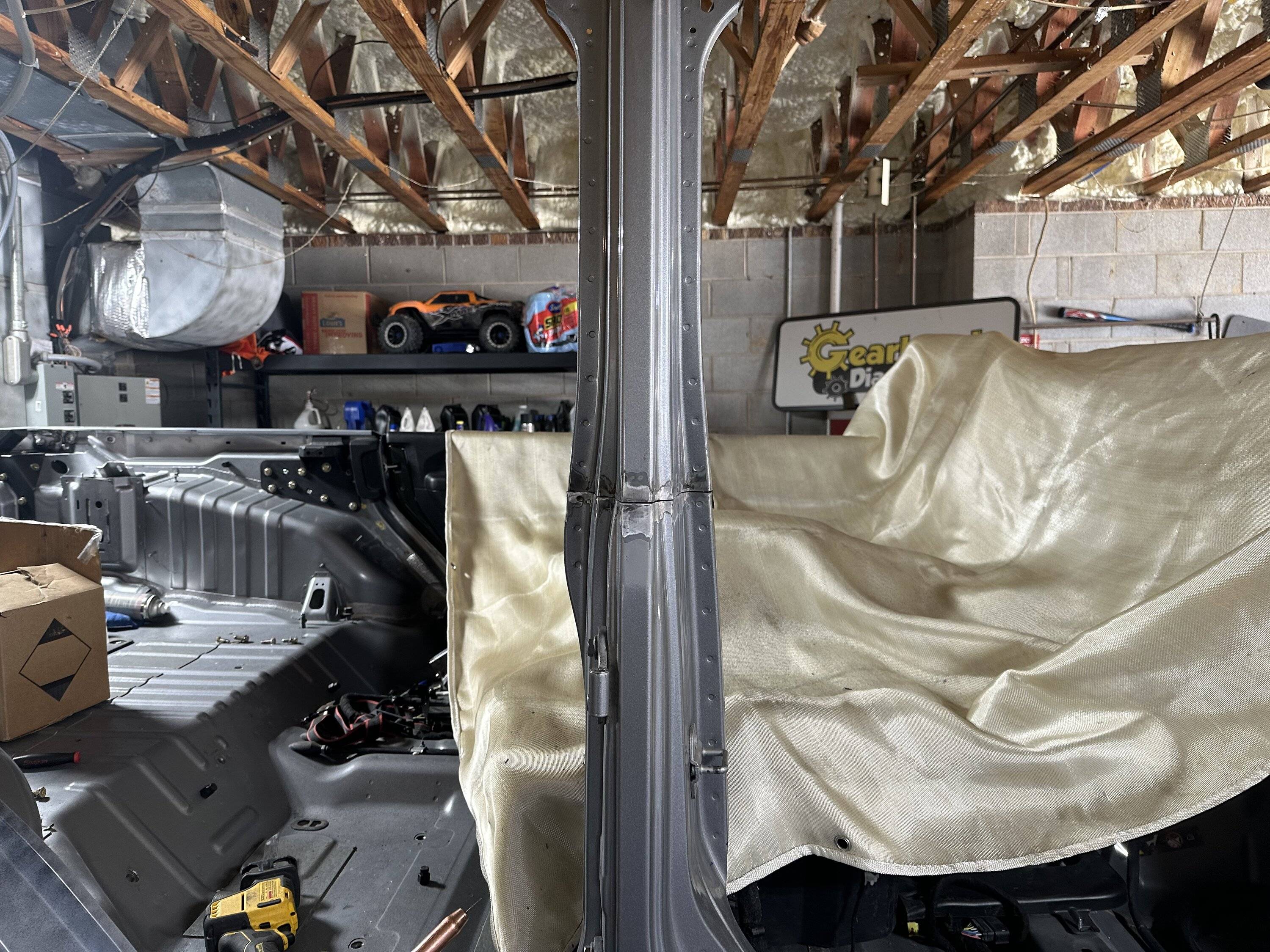

Passenger B-pillar complete. Next step is to get some fiber resin and fill in the pinholes and sand it down smooth, feather the metal into the existing paint, then paint the whole Jeep.

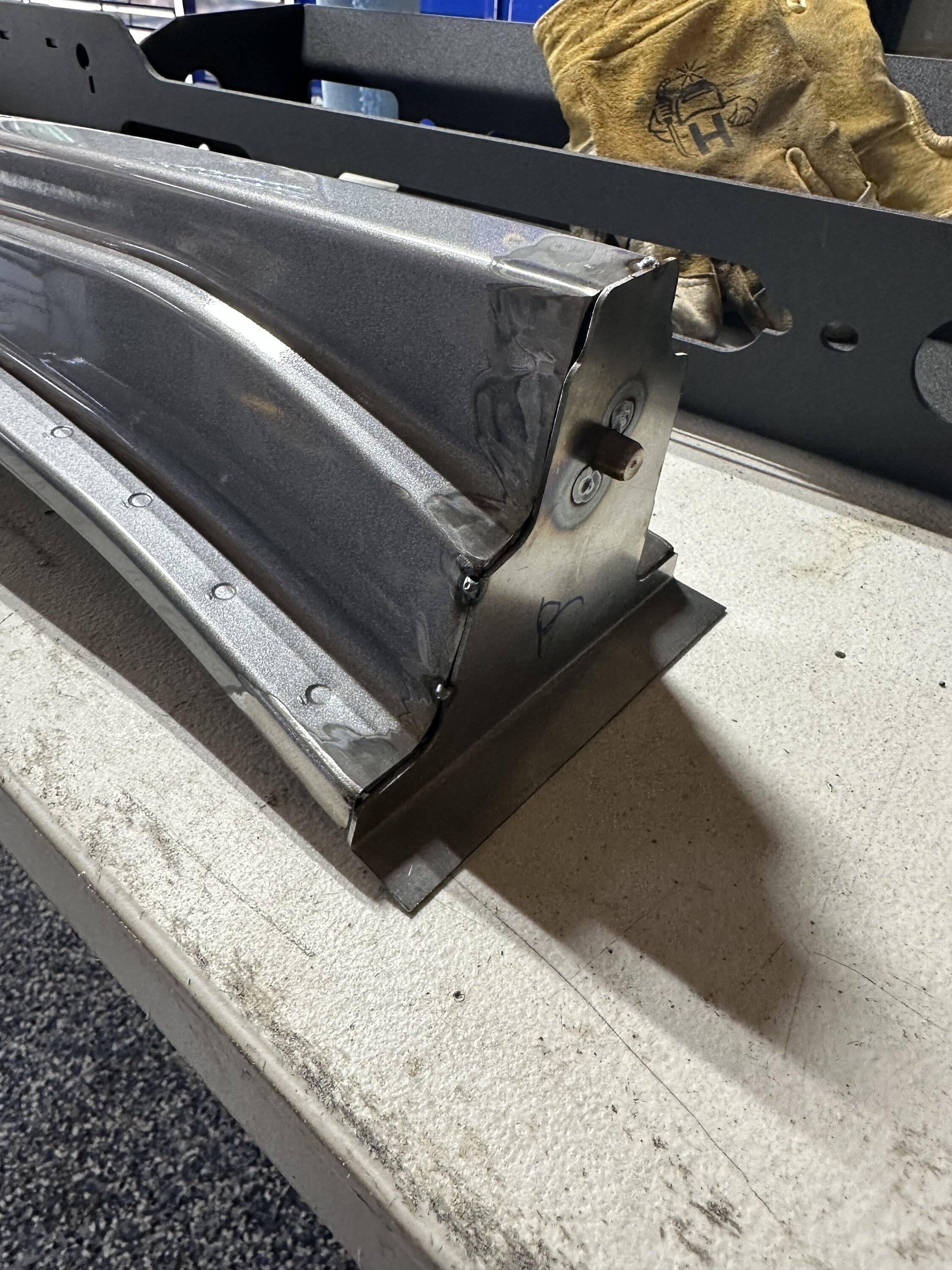

I've got the half doors on the Jeep and getting ready to mark and cut the B-Pillar.
The kit comes with an upper and lower plate that will need welded on along with a rubber sheet to place between the B-pillar pieces once they're apart.
The Chop will allow the removal and re-installation of the B-Pillar upper half. You do need the GenRight cage for this mod since there are specific brackets built into the cage to securely mount the upper piece.
