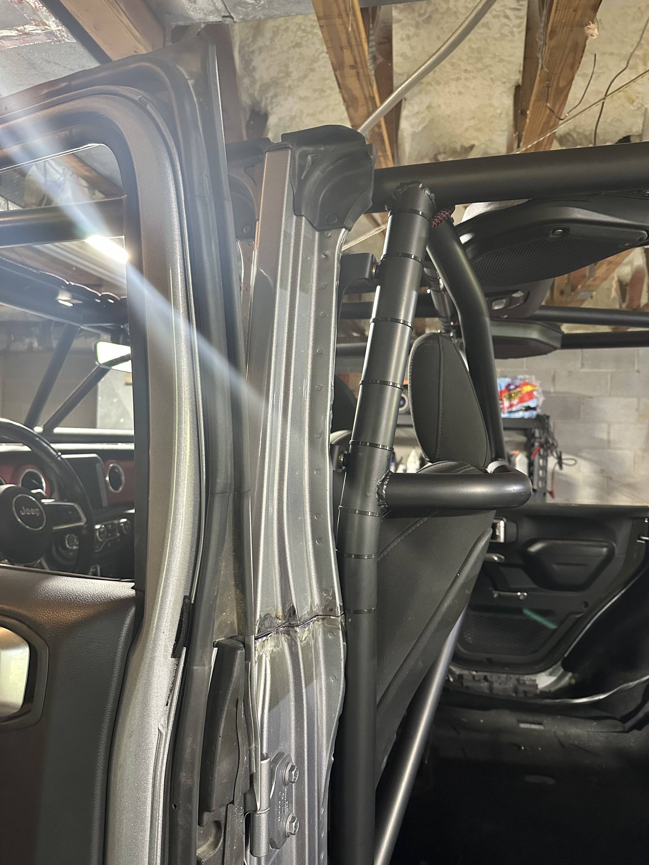

How do they attach to the cage at the top?
There's a bracket that attaches the top portion to the cage. I'll take a pic of the bracket once I get the cage and the rest of the interior put in.

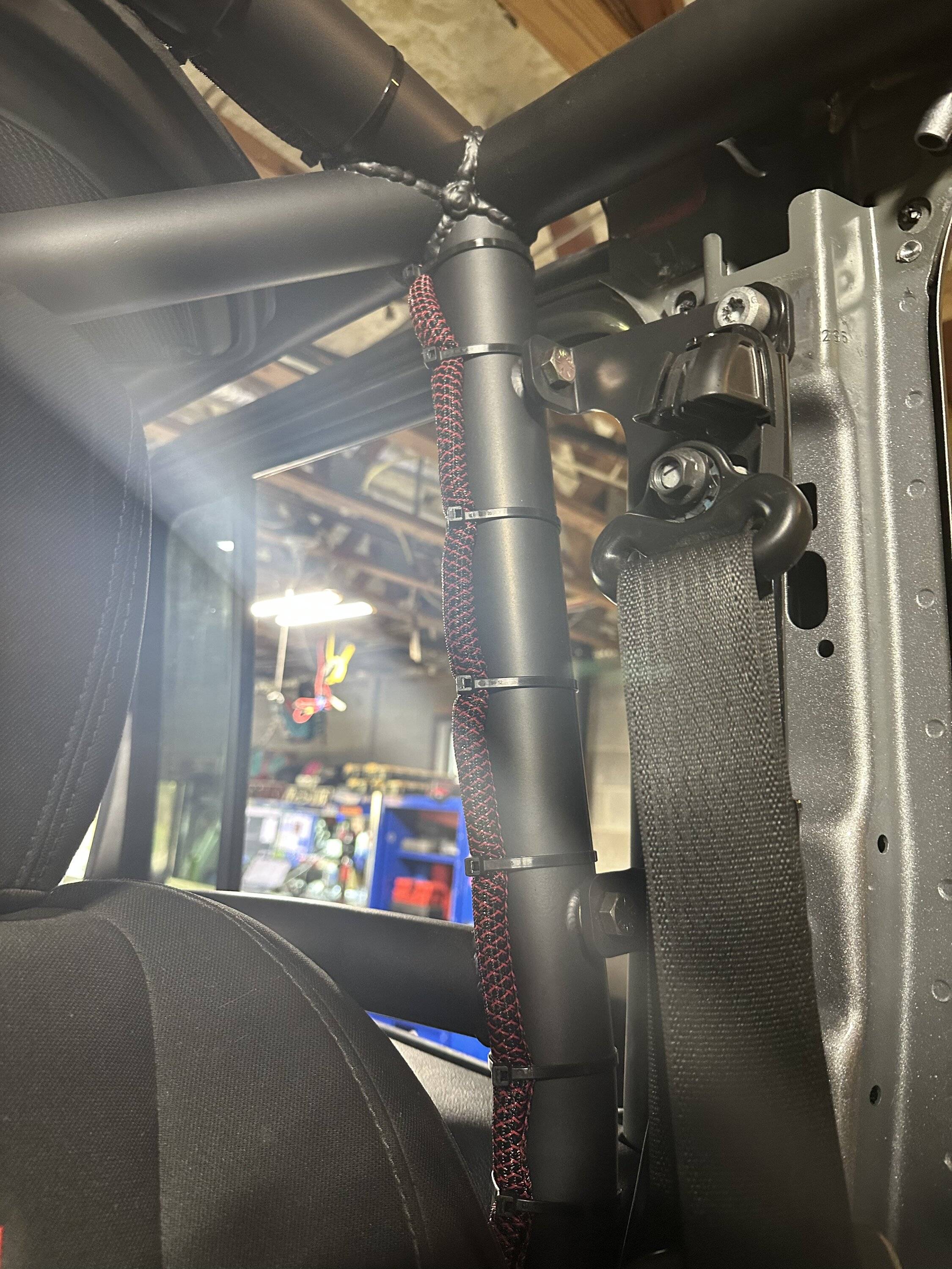

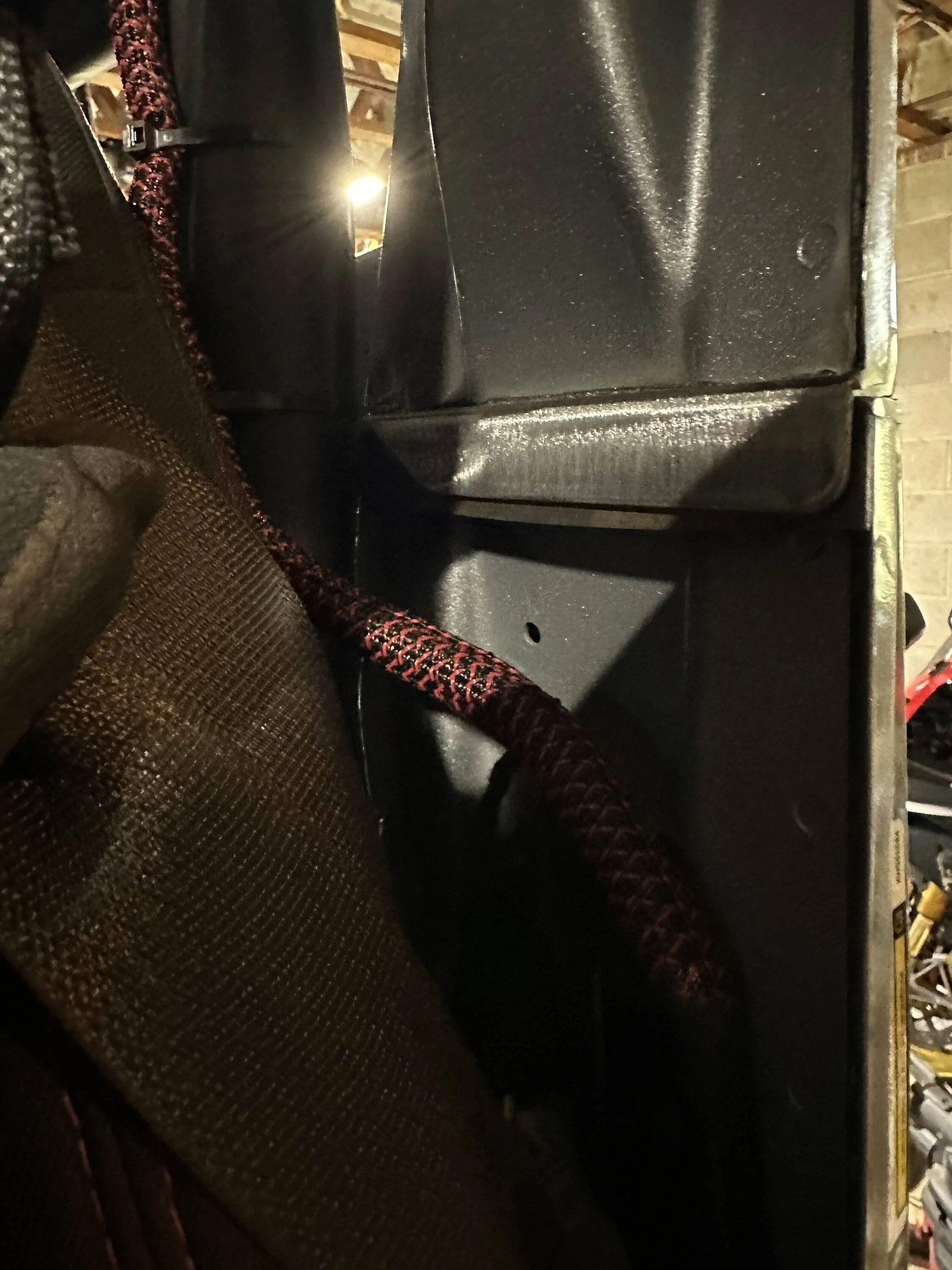

B-Pillar attachment bracket.
Got it lined up and it’s rock solid. The gap is larger than I wanted, but I’ll just get a little thicker piece of rubber to put in the middle.
Just got to get this thing painted and it’ll look/work great.

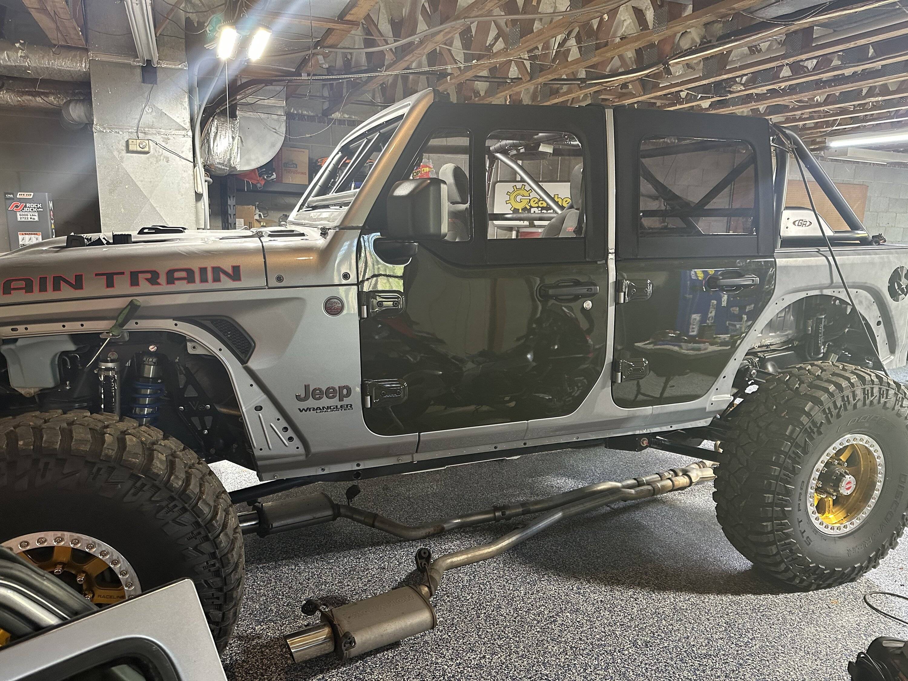

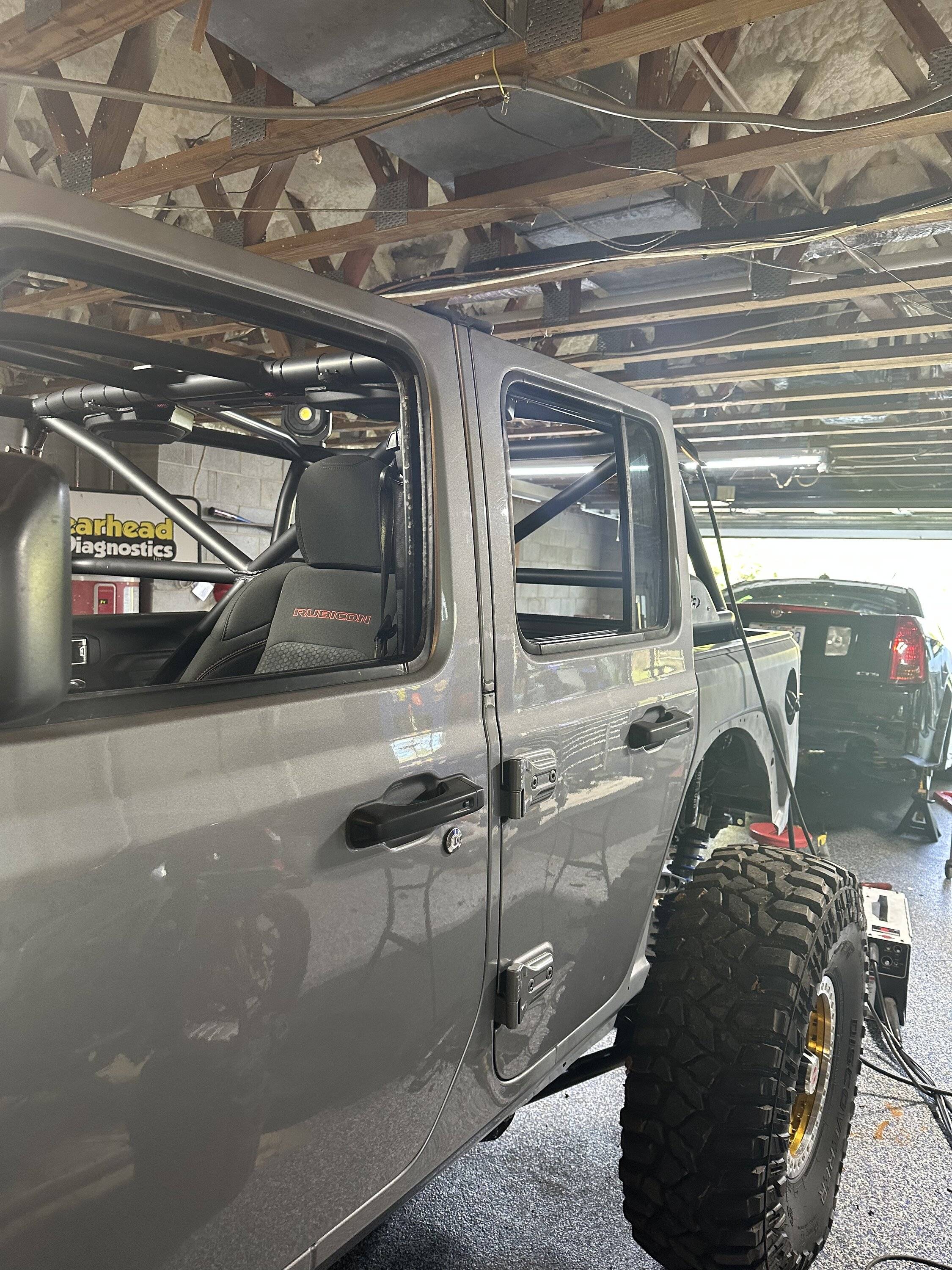

Will you also be running a set of half doors on the Train?
Thanks man.
Yeah, all I’ll run is the half doors. I used the full doors to line everything up since the door is more solid. I don’t have a full set of full doors. The passenger side doors were wrecked in the roll over.
Just finished test fitting the half doors with uppers installed a second ago. On to the other side now.

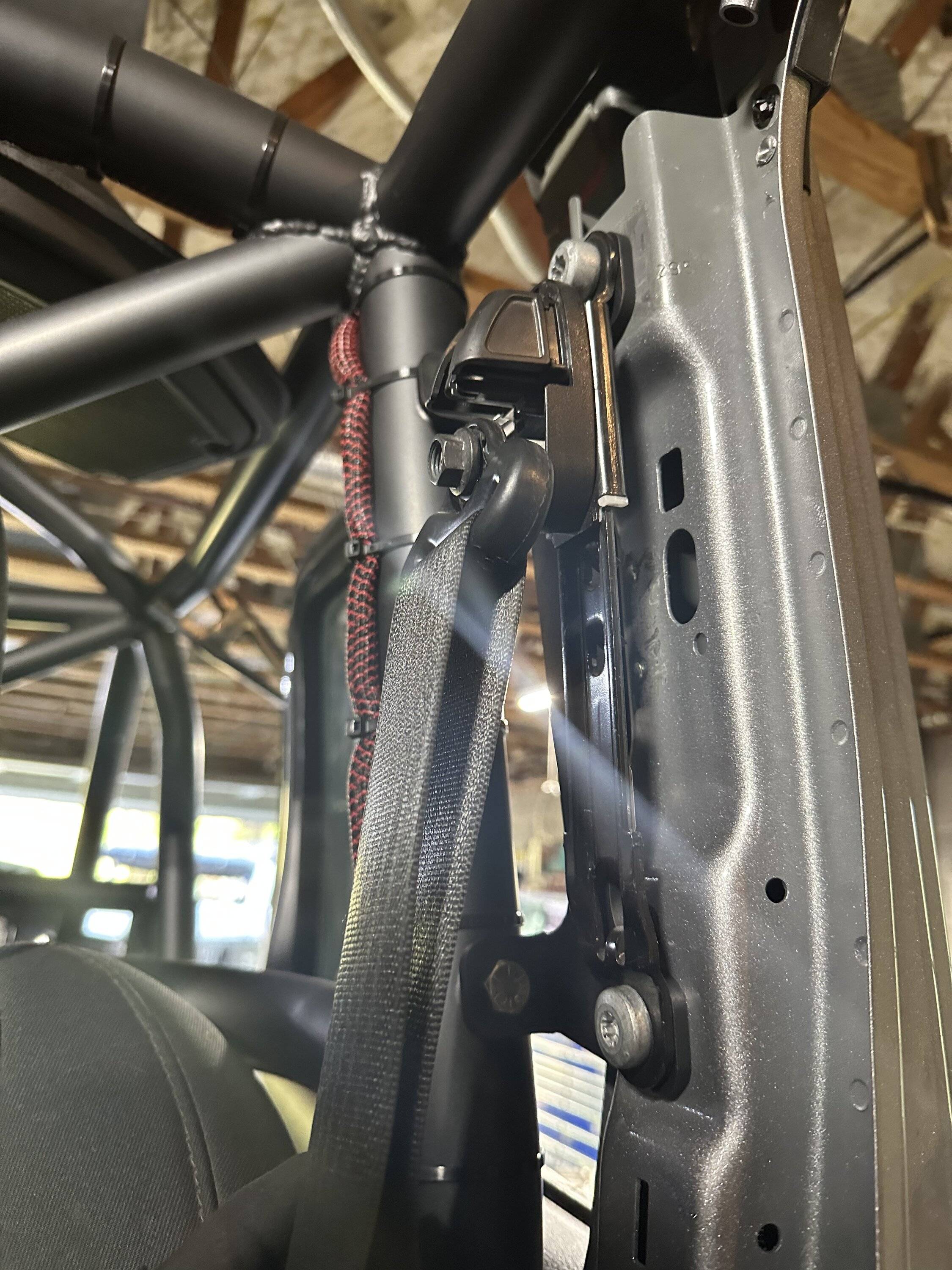

Any concern that the belt is bolted to the removable b-pillar? Surprised they didnt make a relocation bracket to the cage.

The adjuster can be mounted to the cage when the b-pillar is not in use.
I'll end up with 4 point harnesses at some point before the trip to CO in July.
