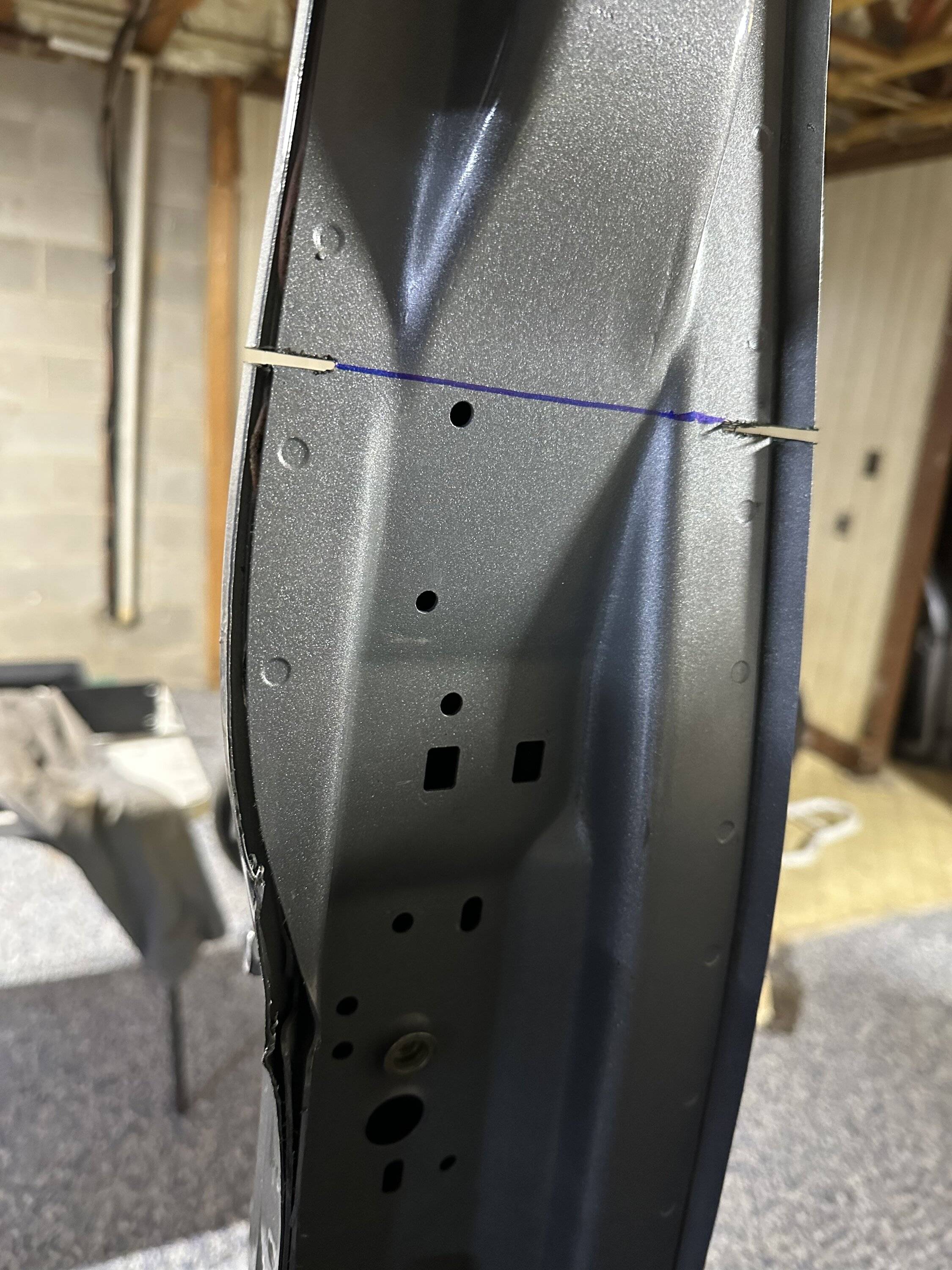

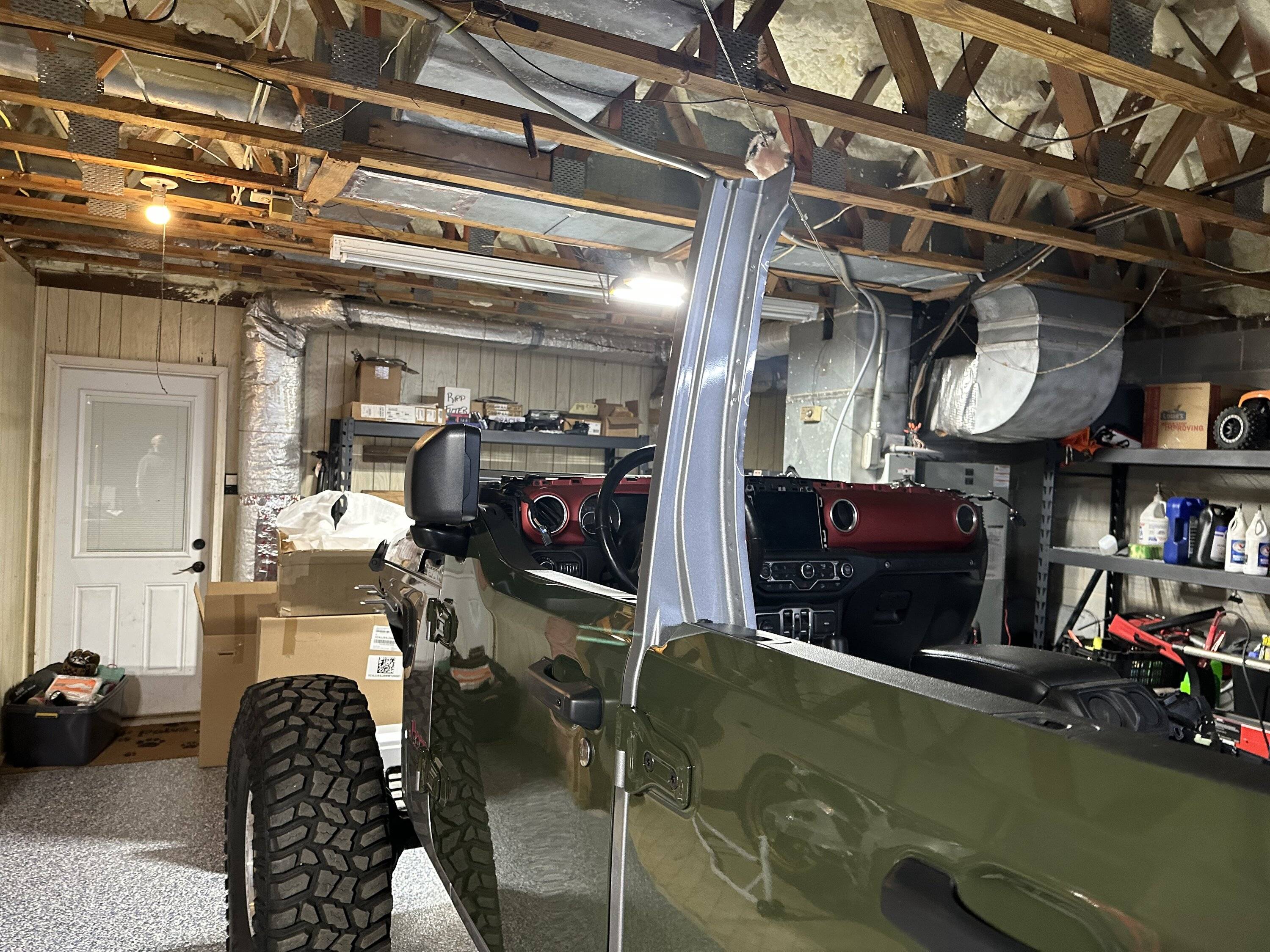

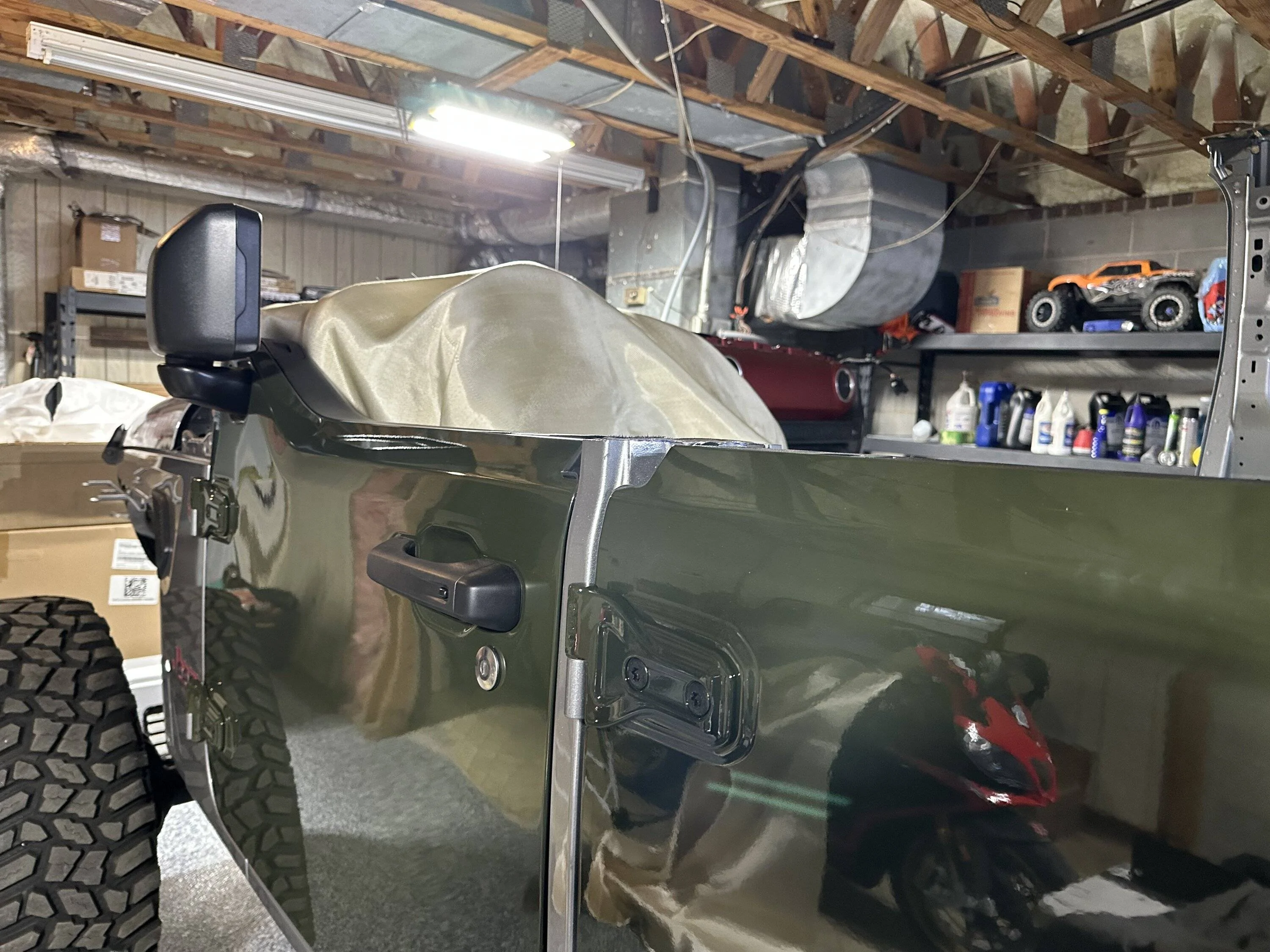

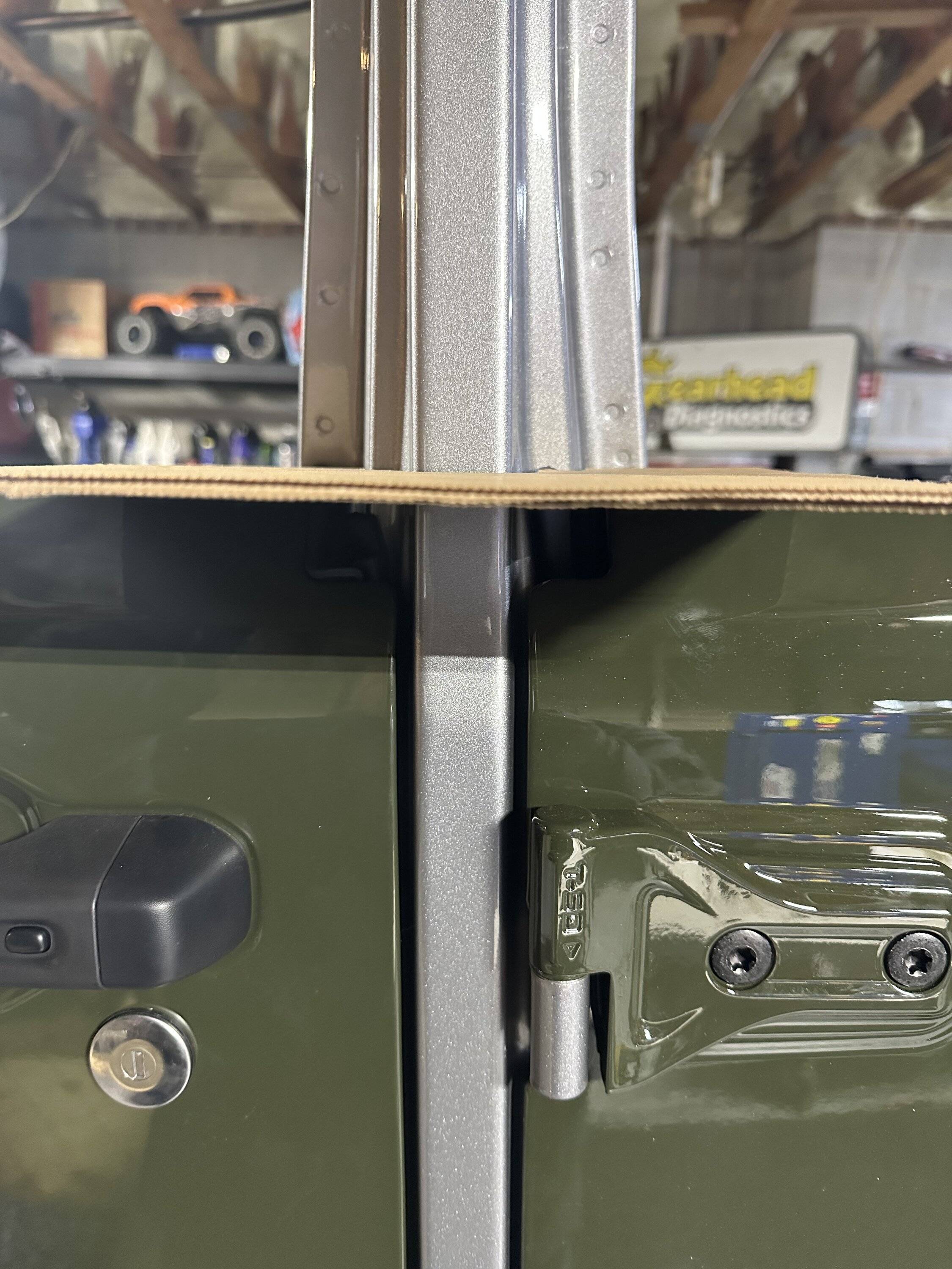

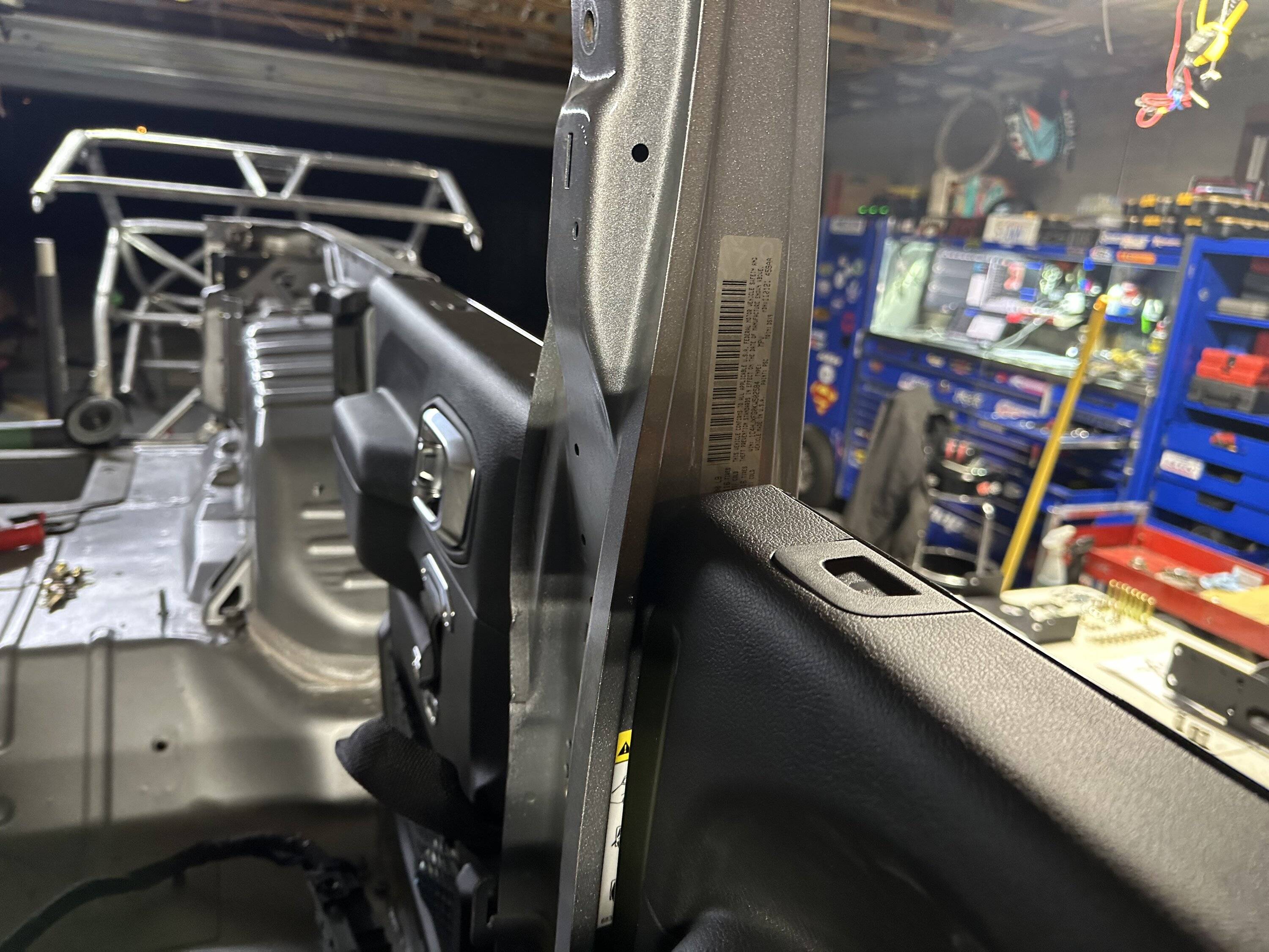

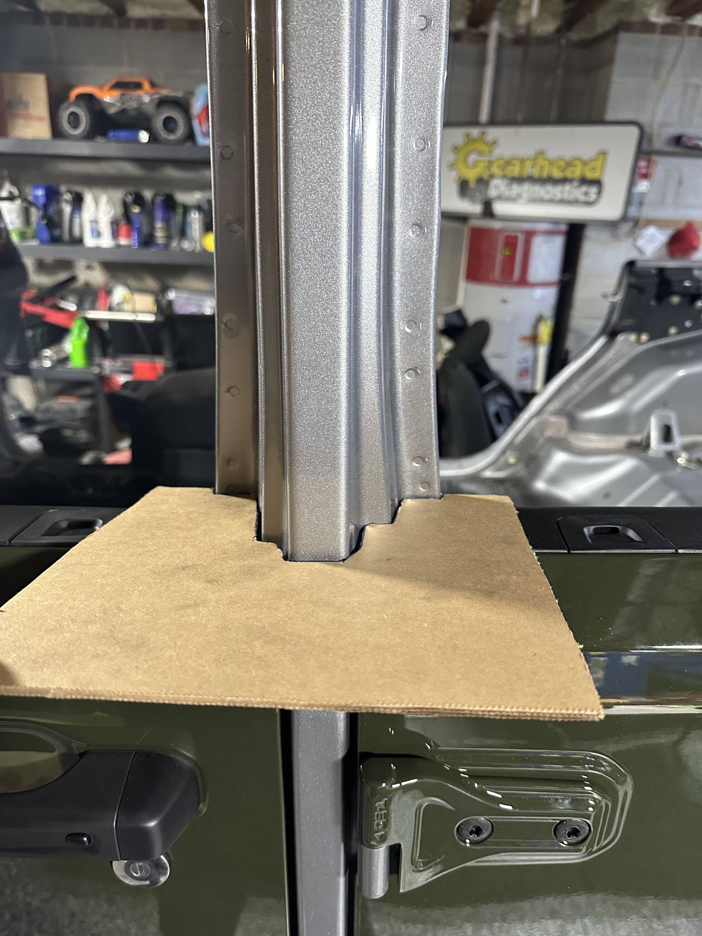

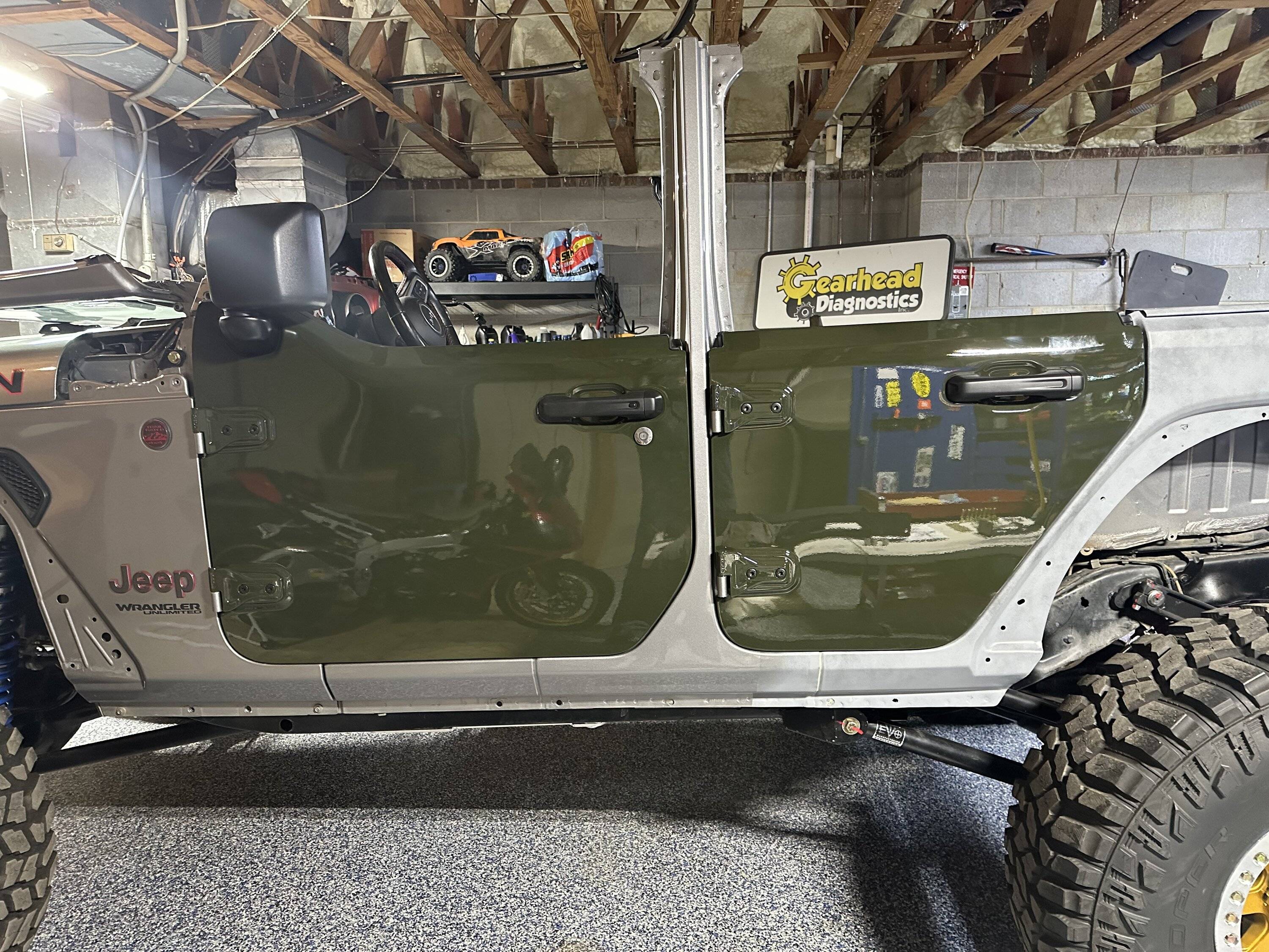

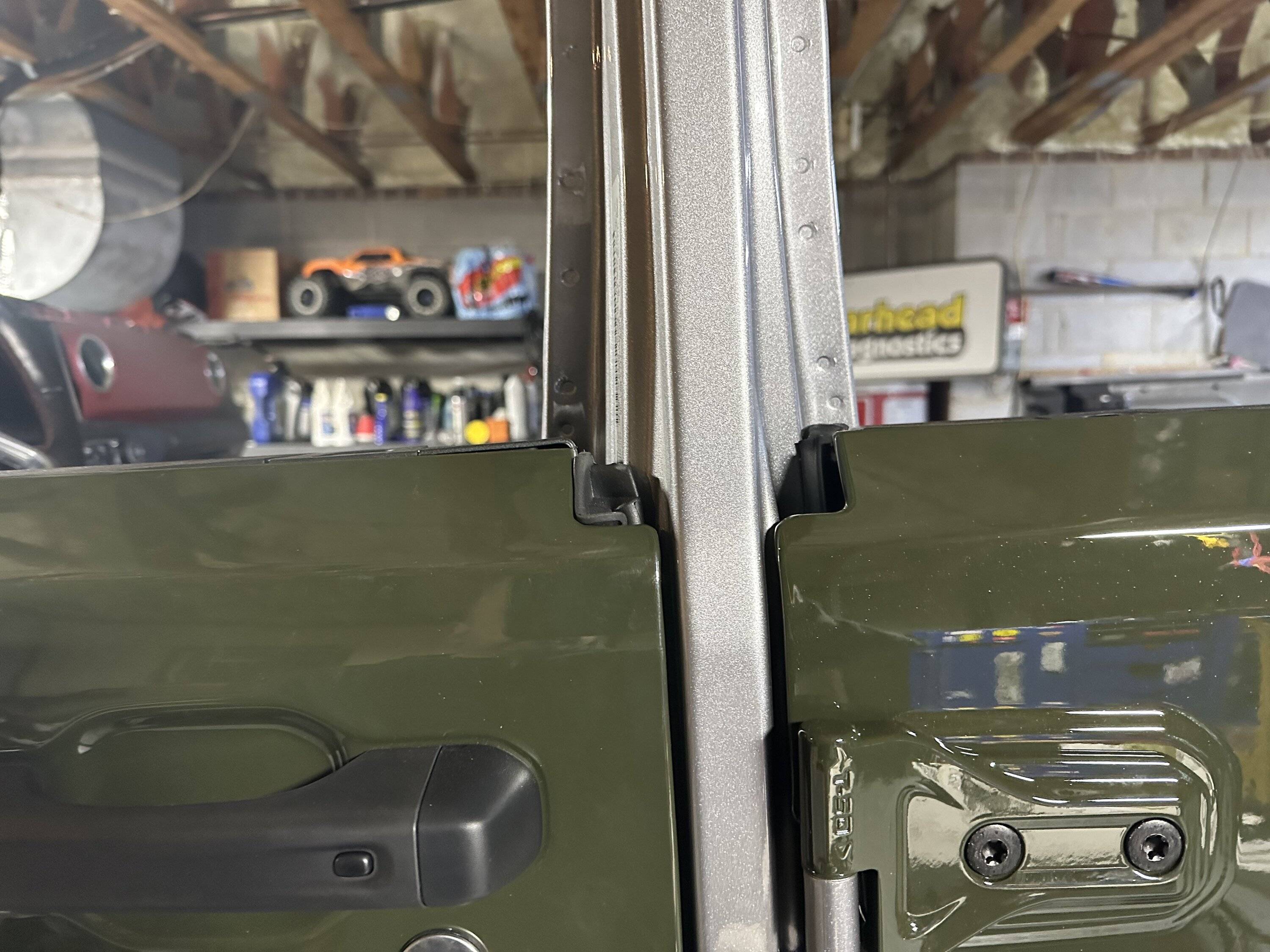

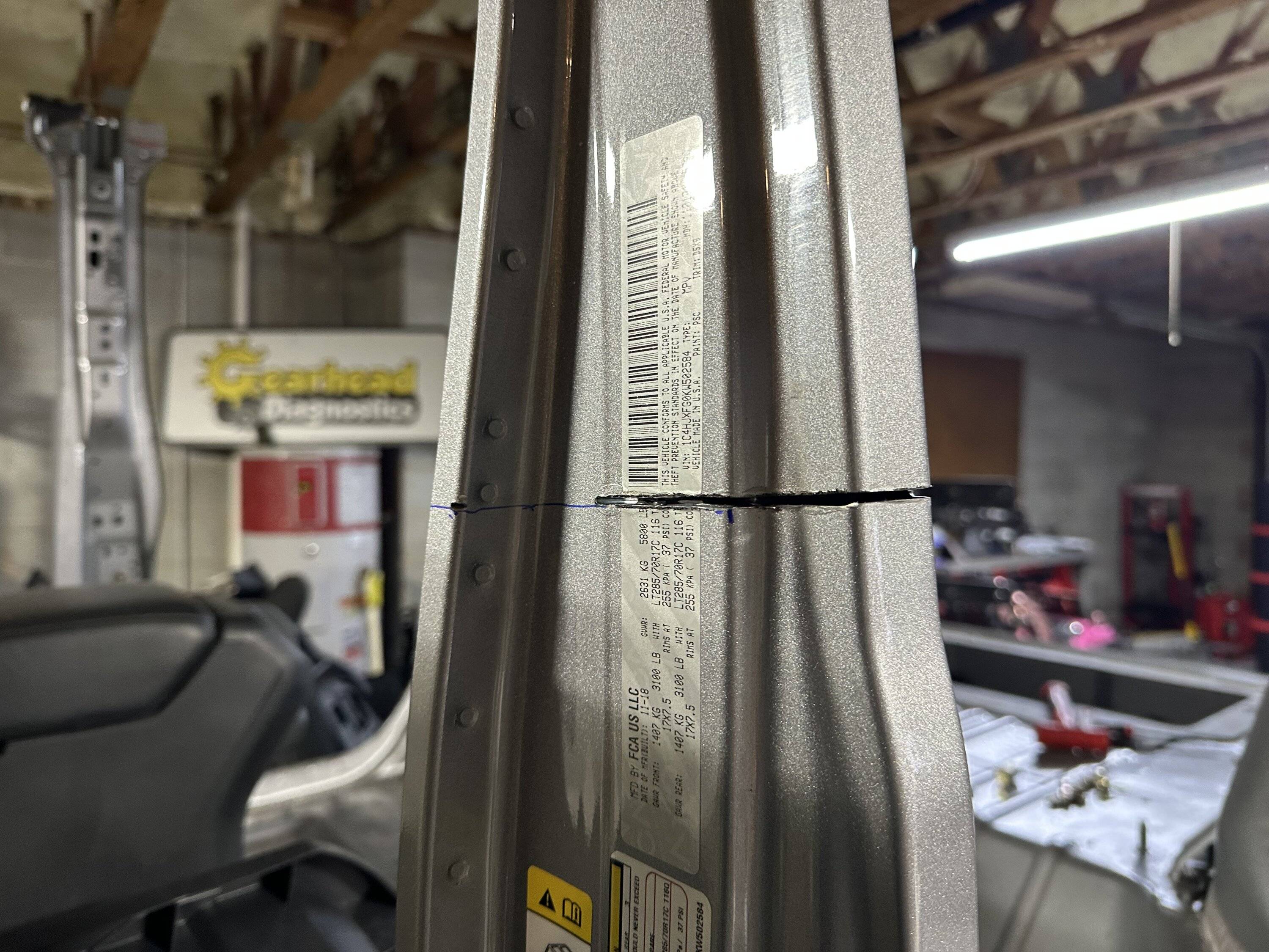

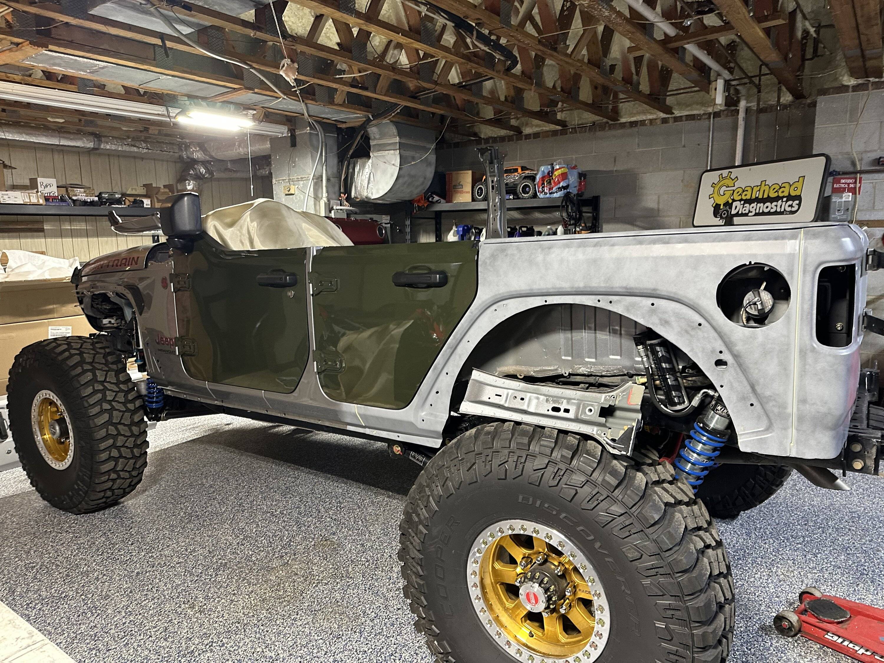

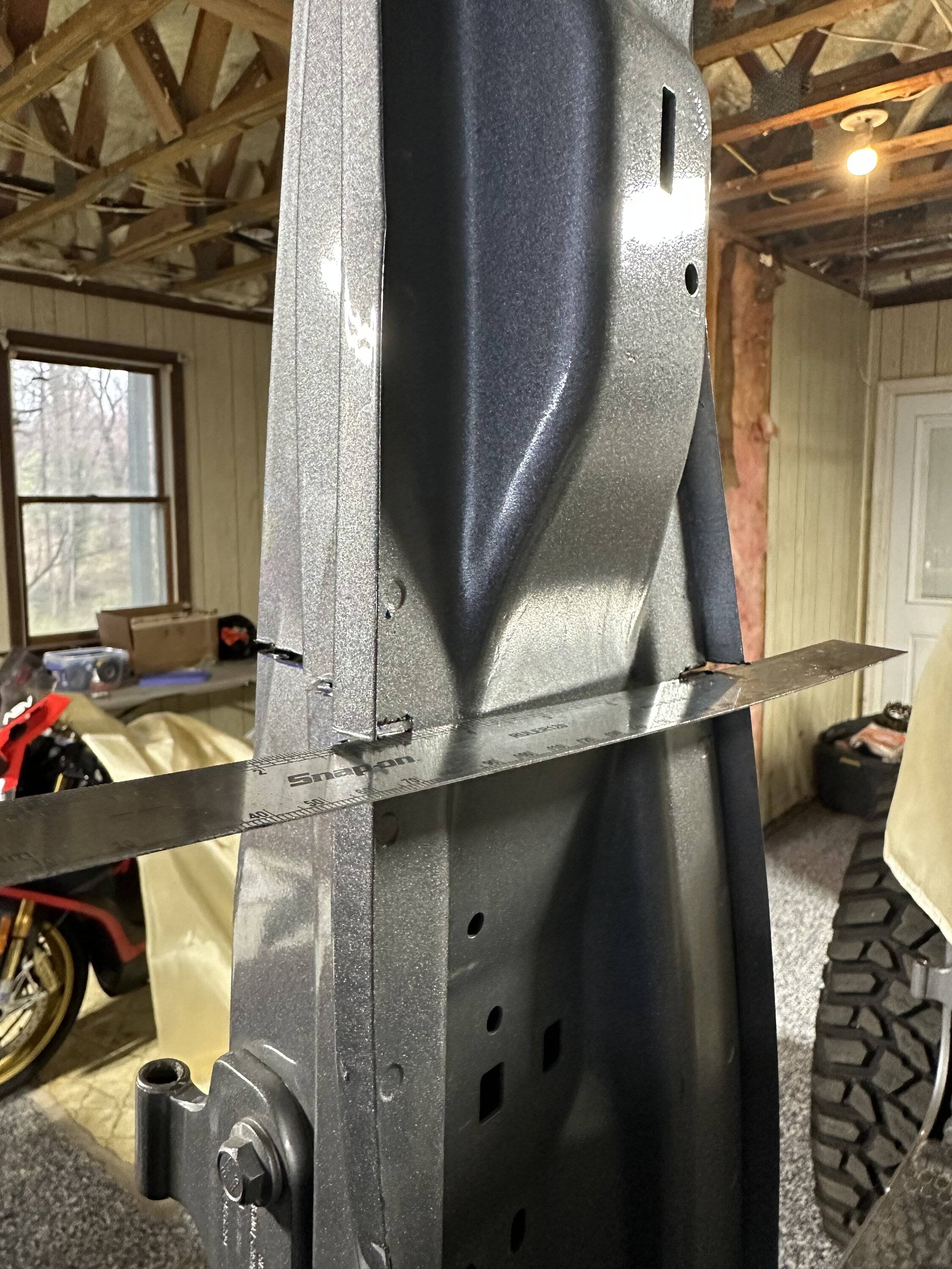

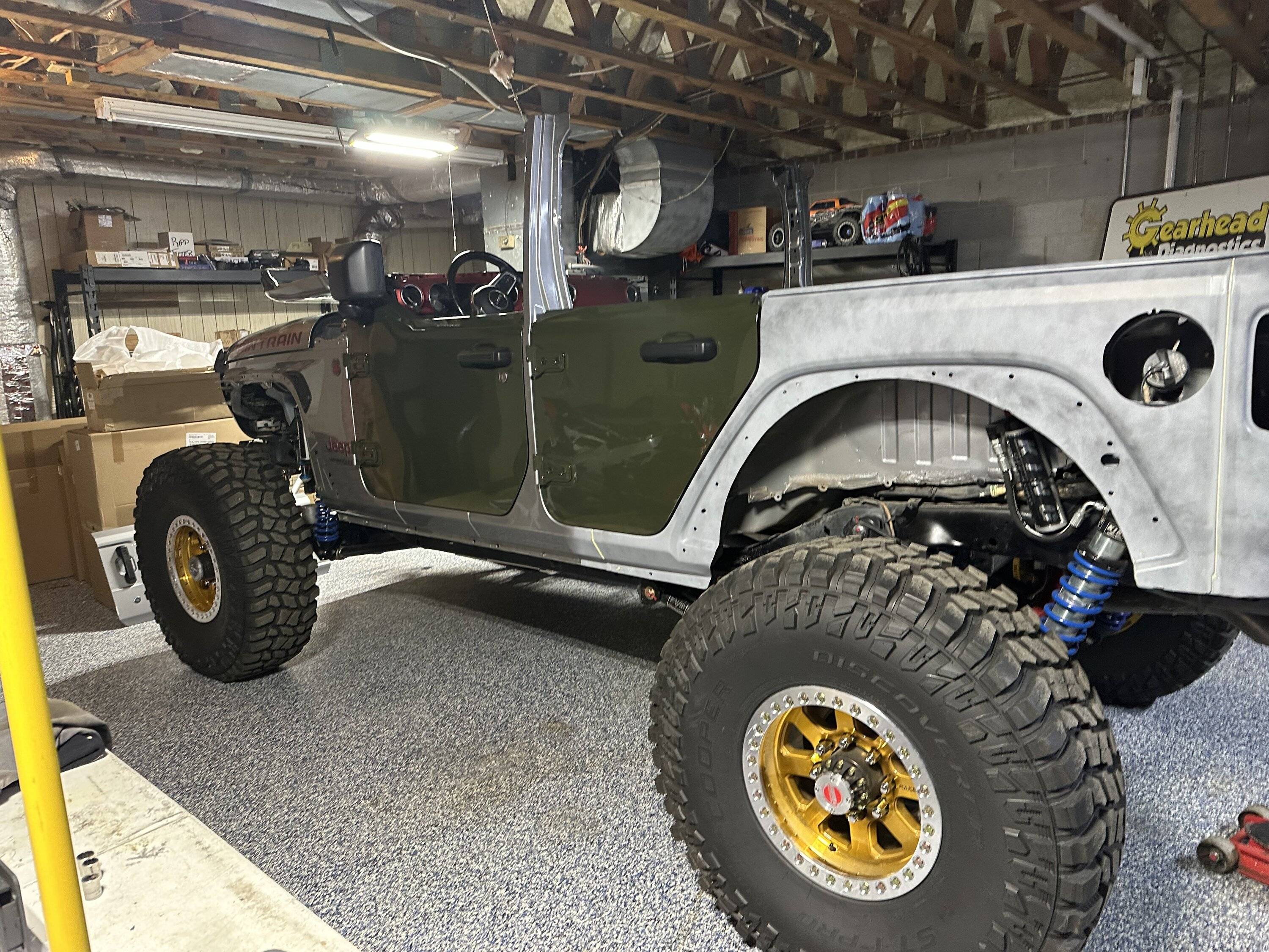

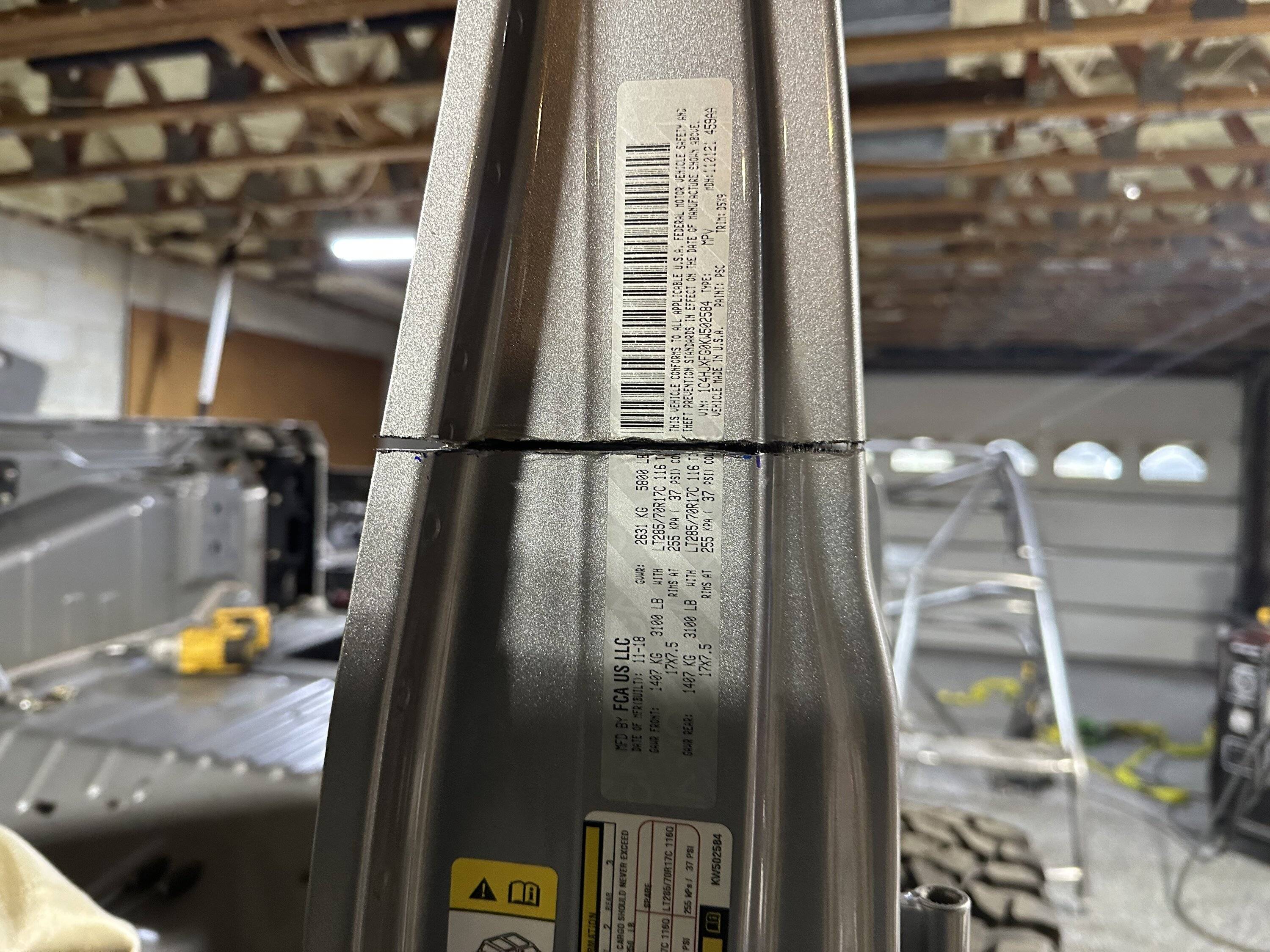

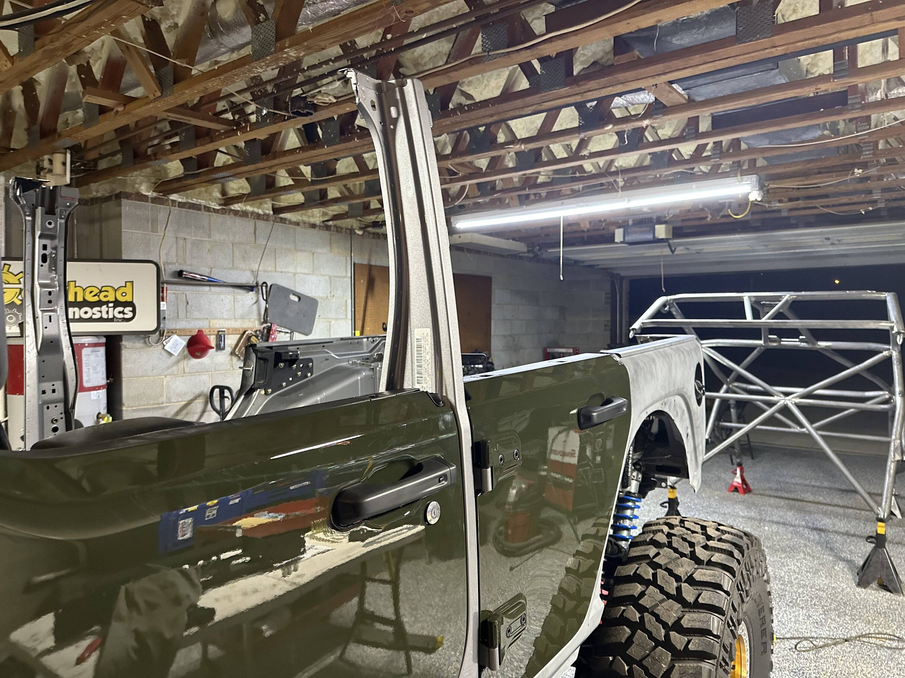

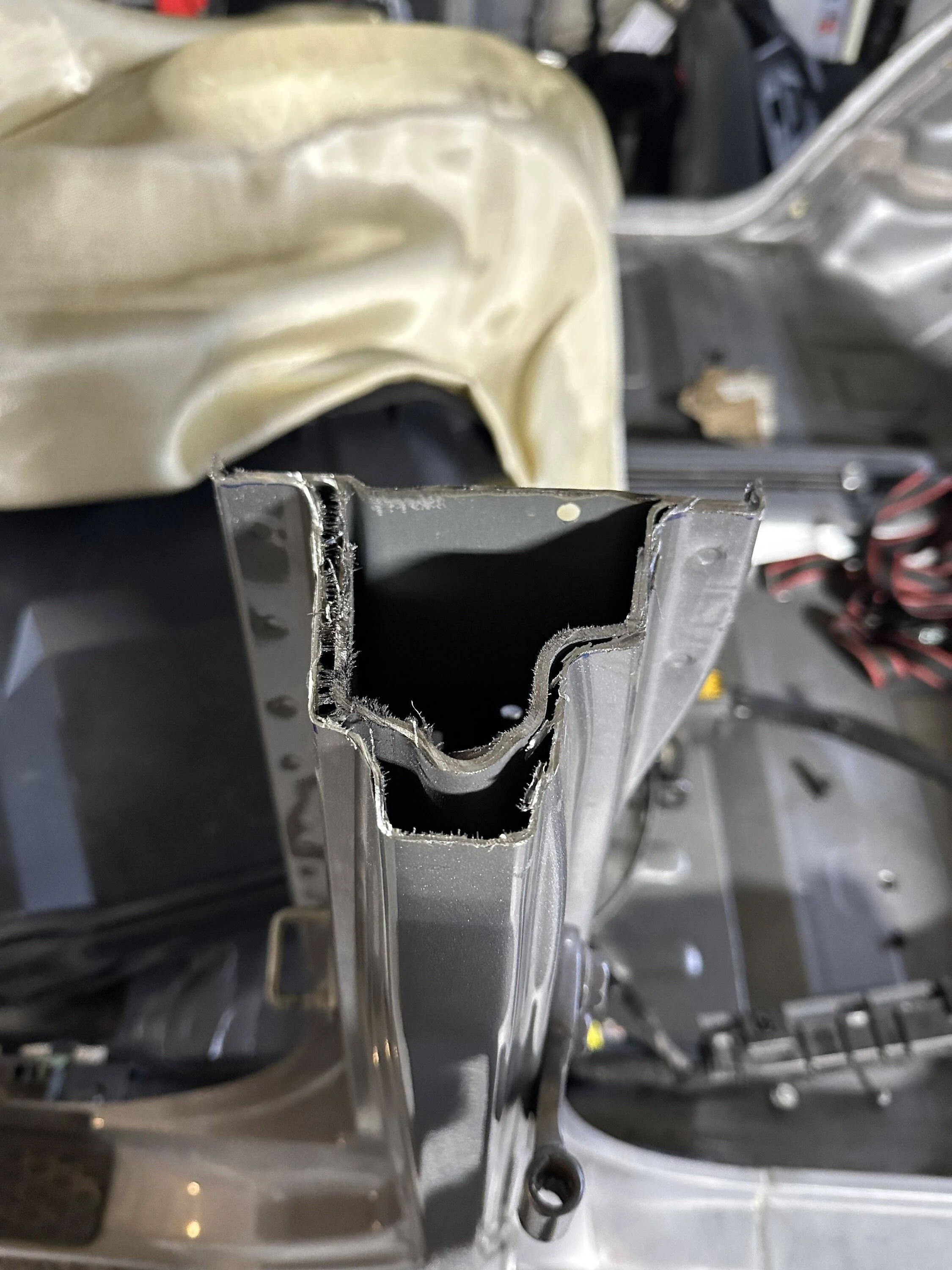

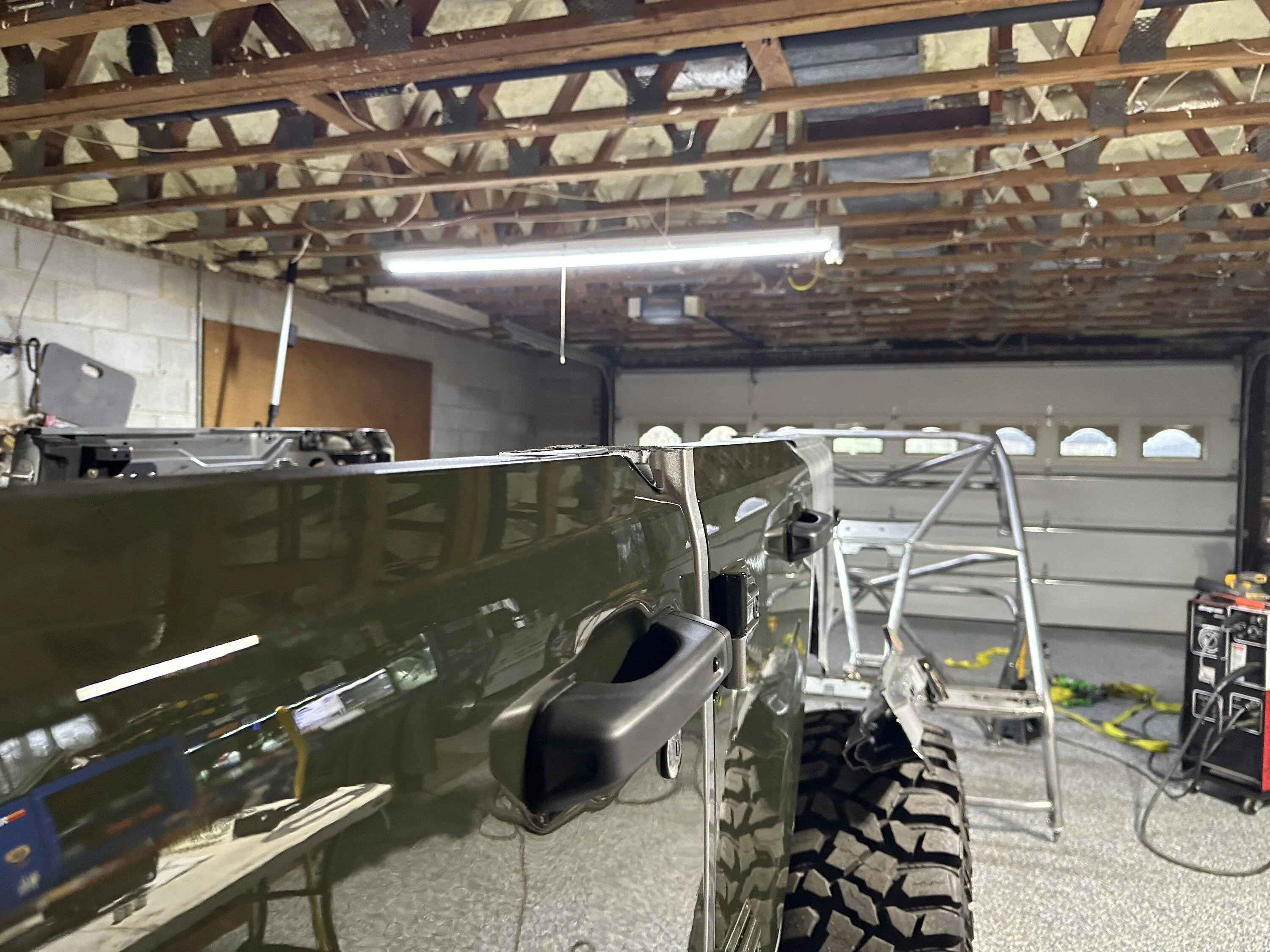

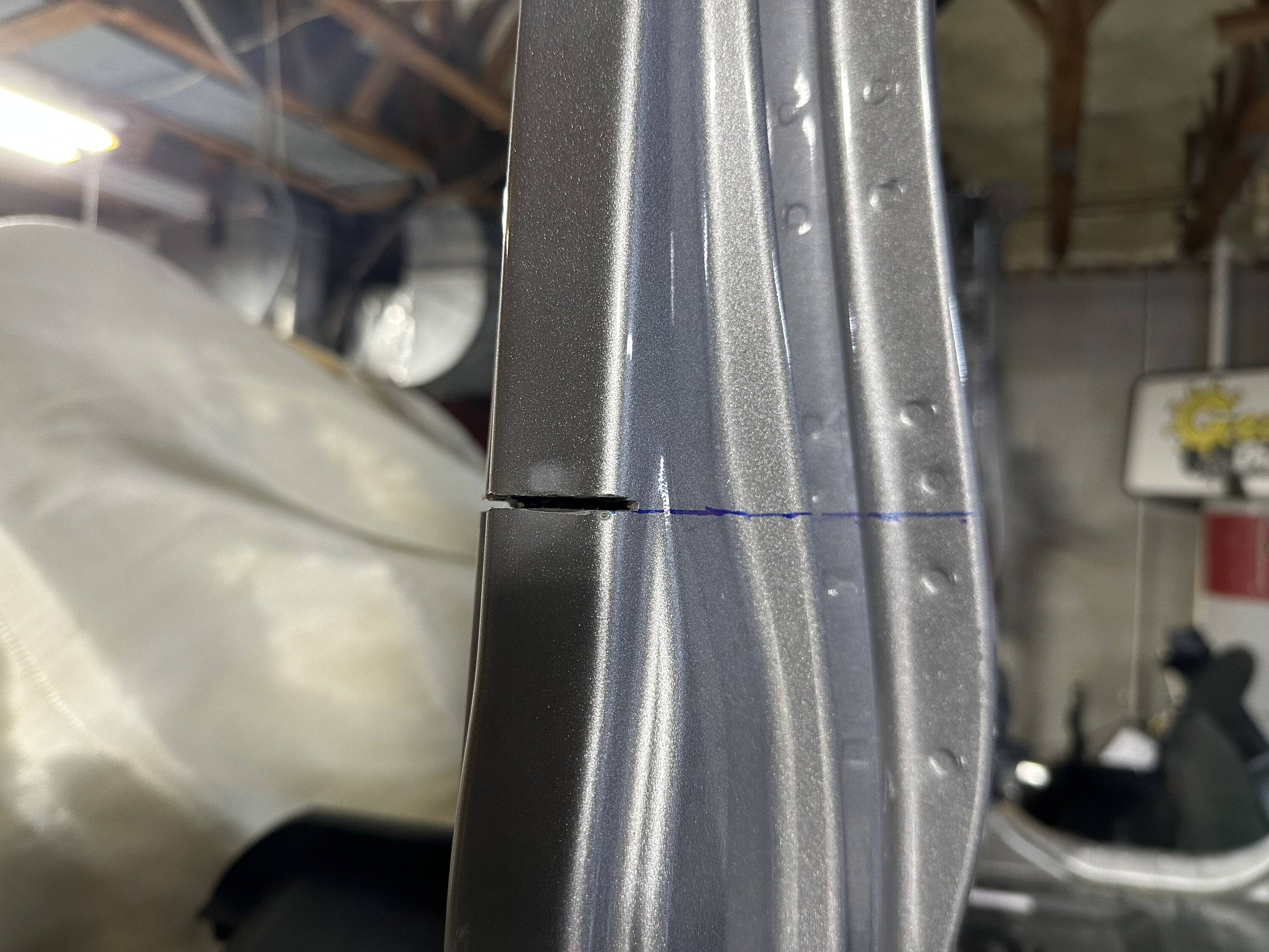

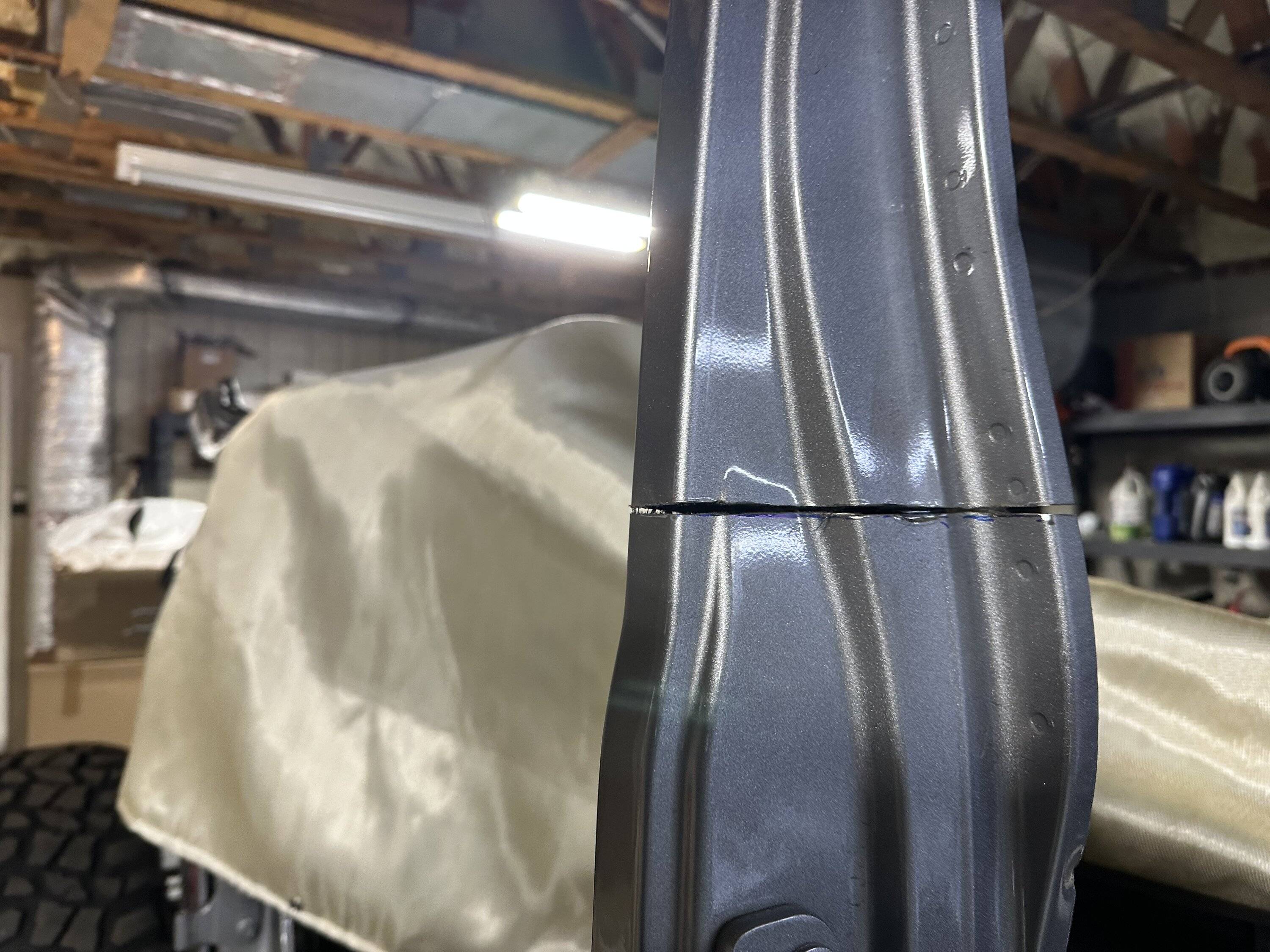

I've got the half doors on the Jeep and getting ready to mark and cut the B-Pillar.

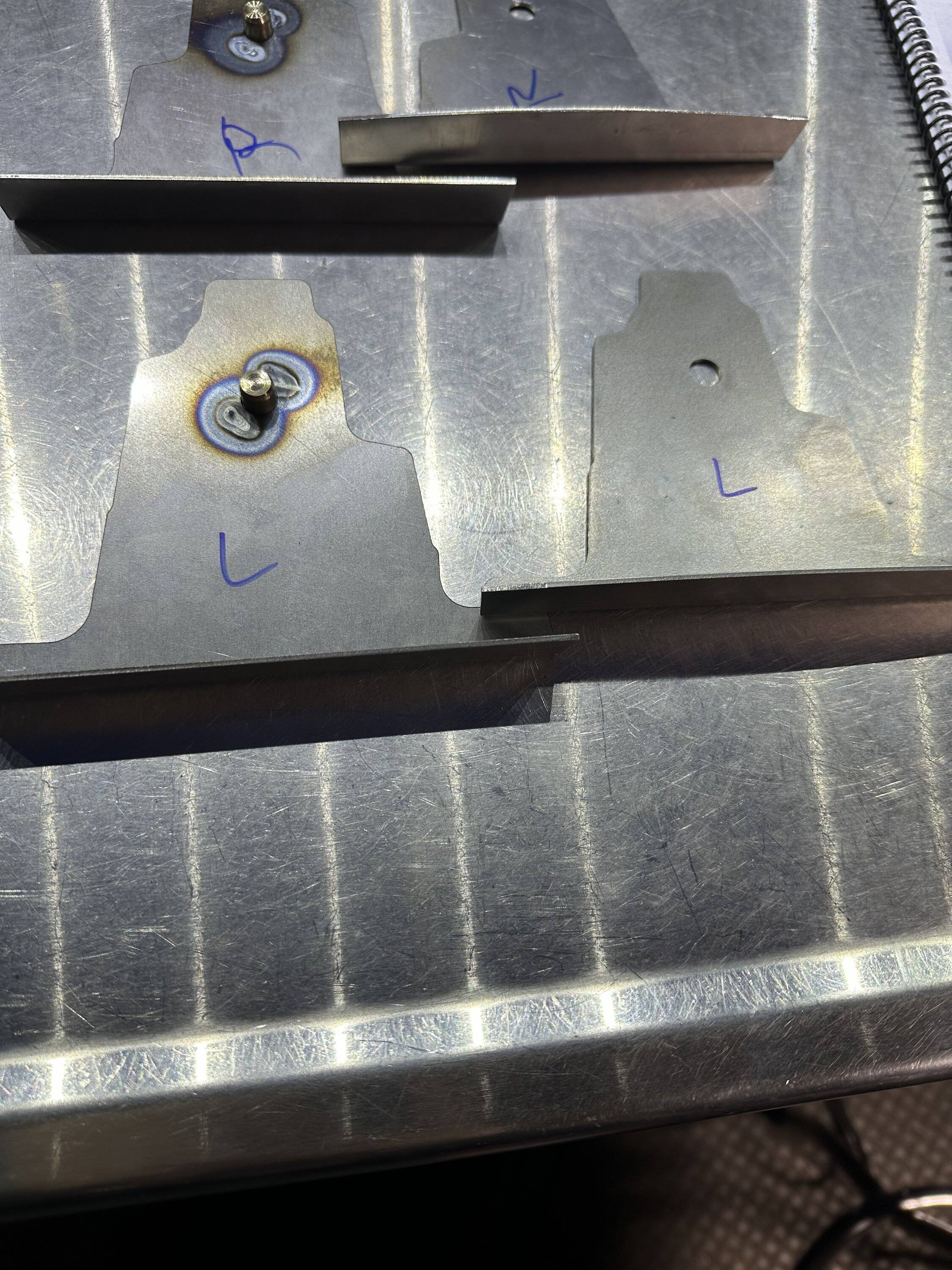

The kit comes with an upper and lower plate that will need welded on along with a rubber sheet to place between the B-pillar pieces once they're apart.
The Chop will allow the removal and re-installation of the B-Pillar upper half. You do need the GenRight cage for this mod (see this thread) since there are specific brackets built into the cage to securely mount the upper piece.
I may get to this, this weekend. We shall see. Right now, here are some before pics.

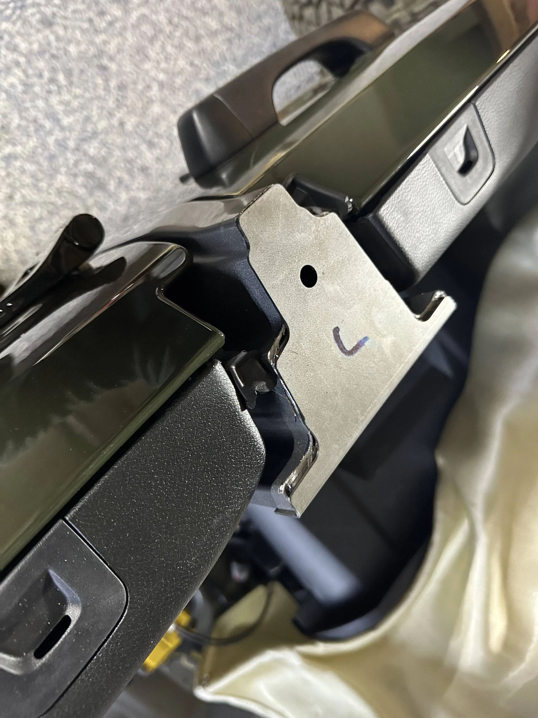

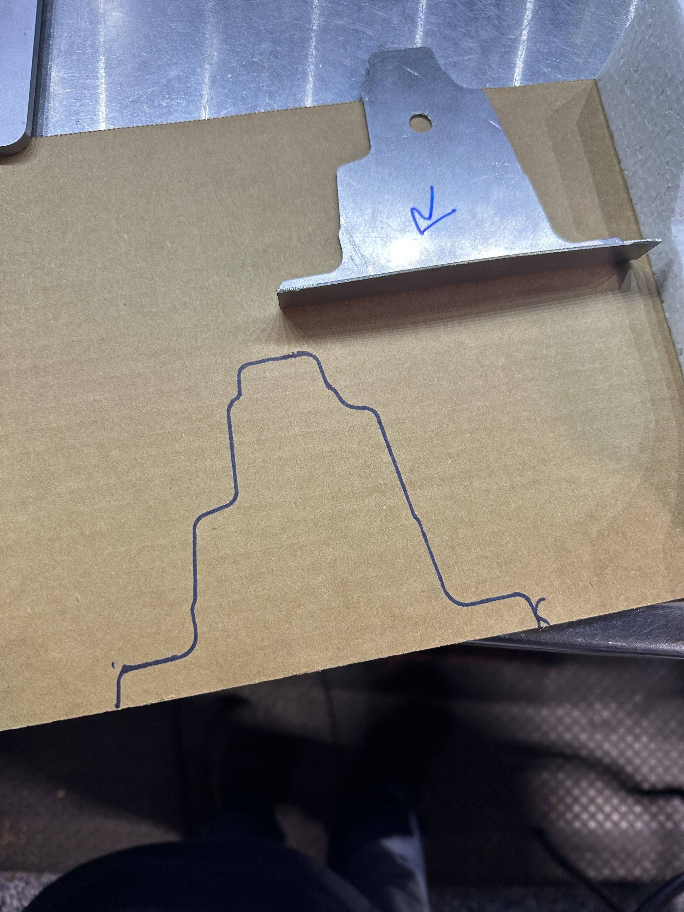

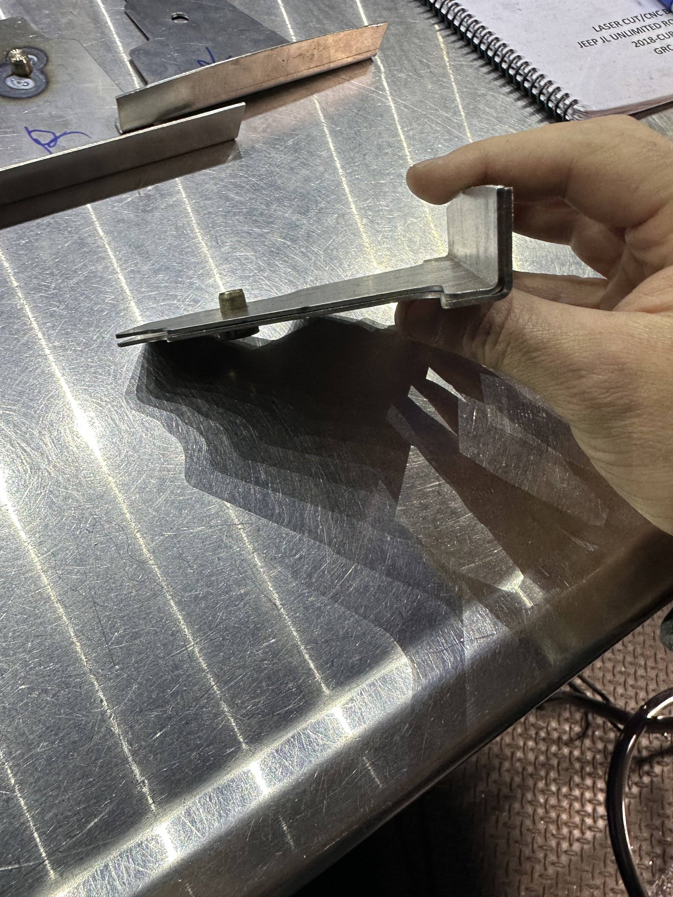

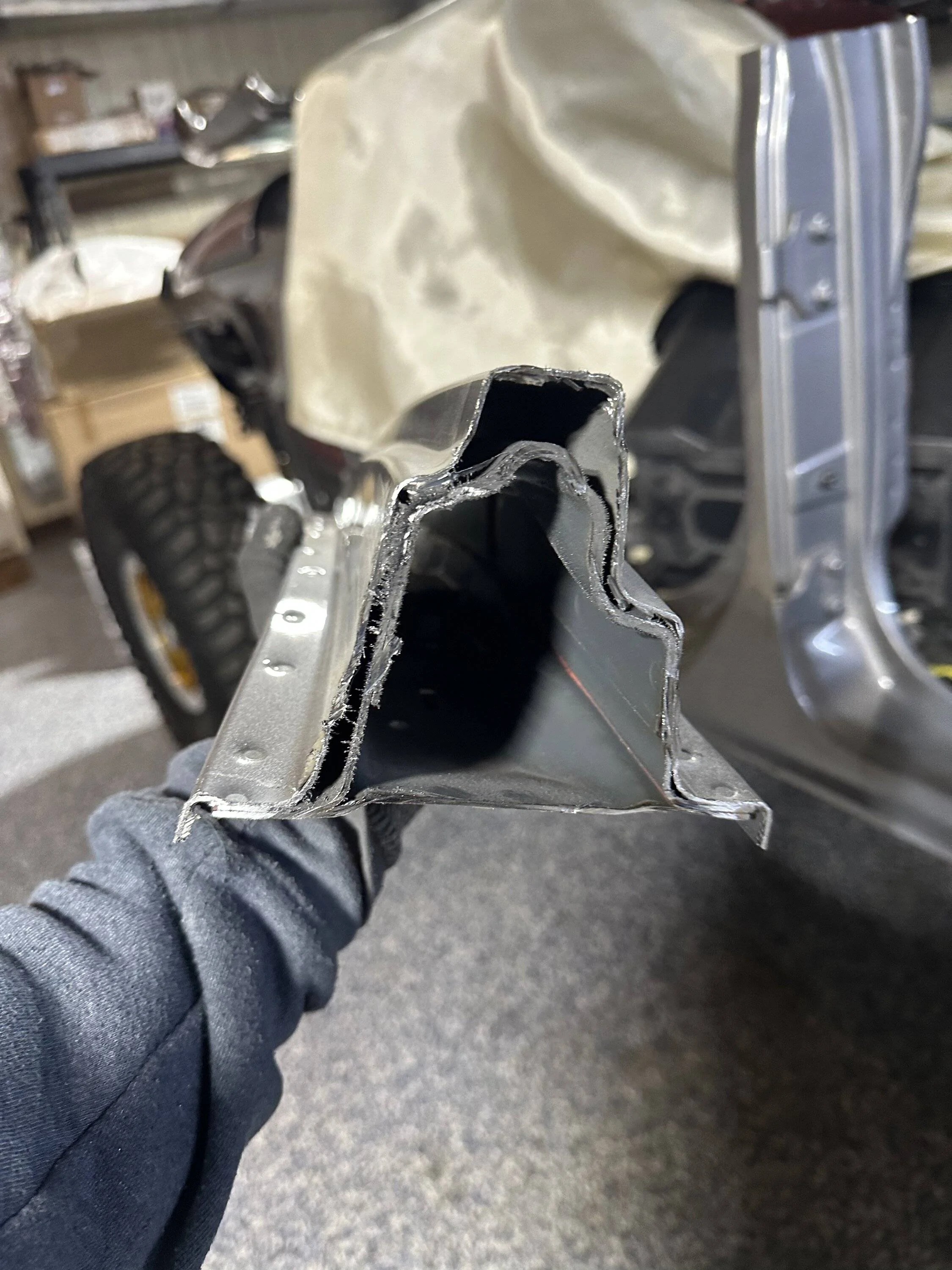

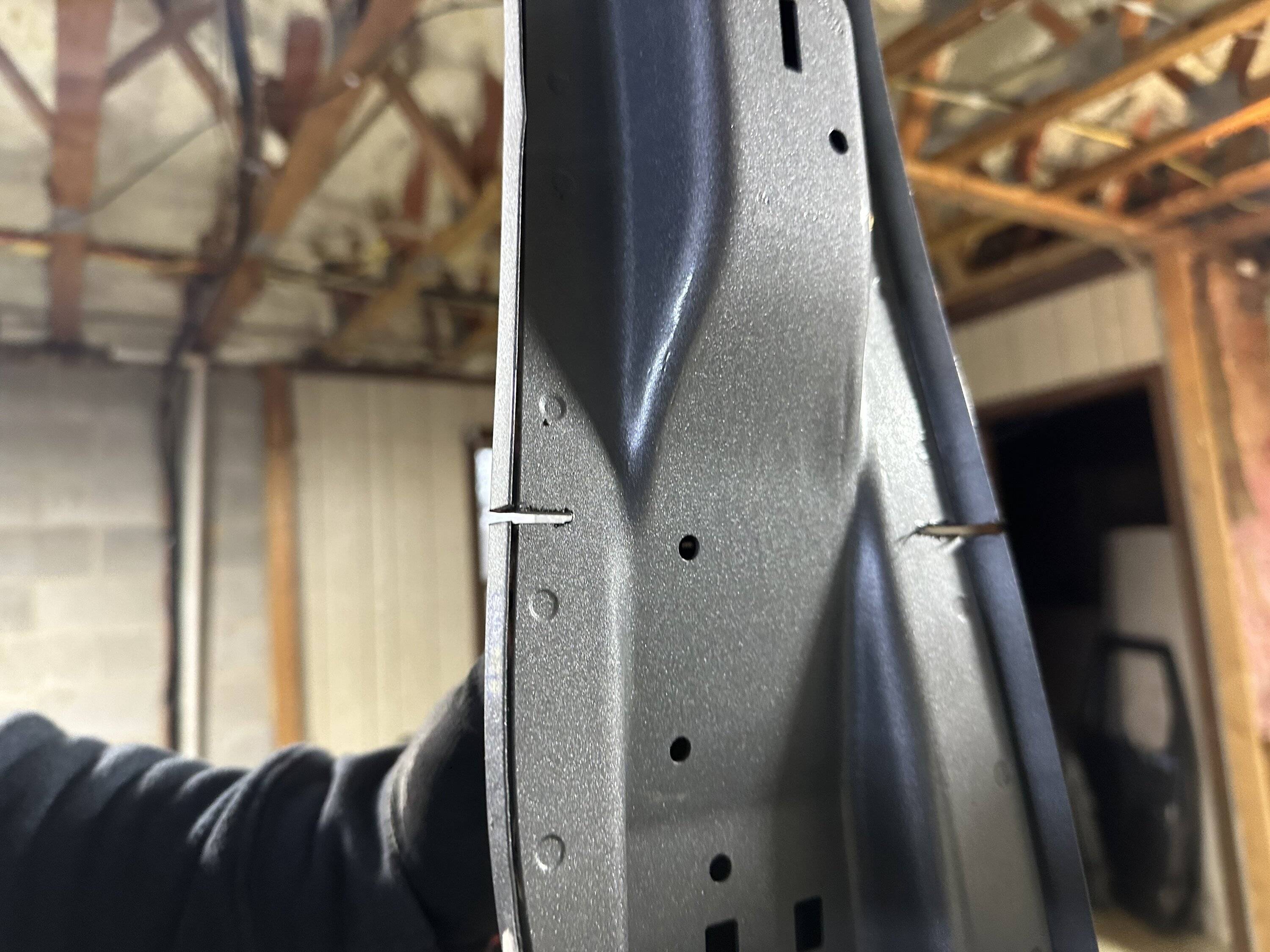

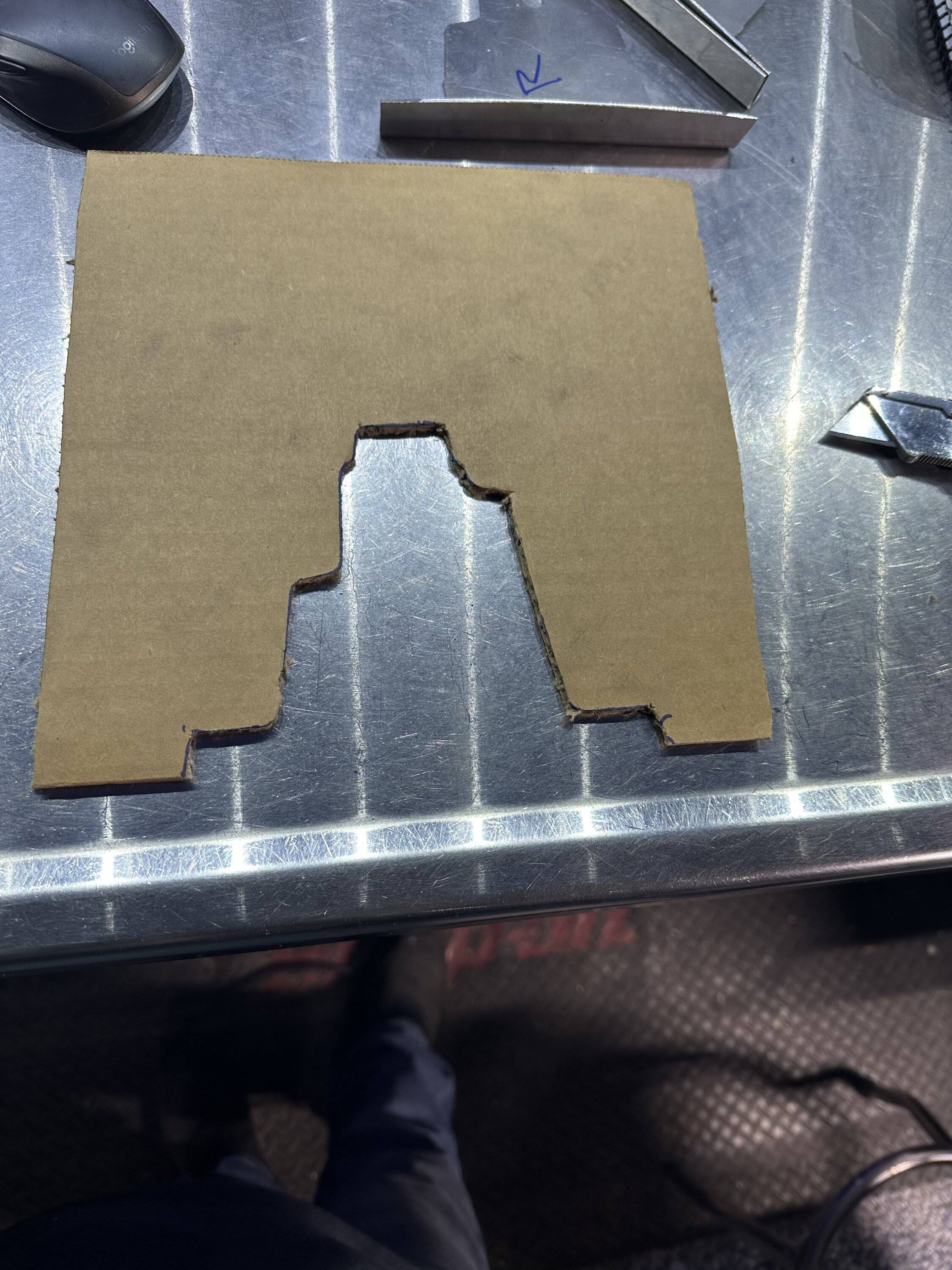

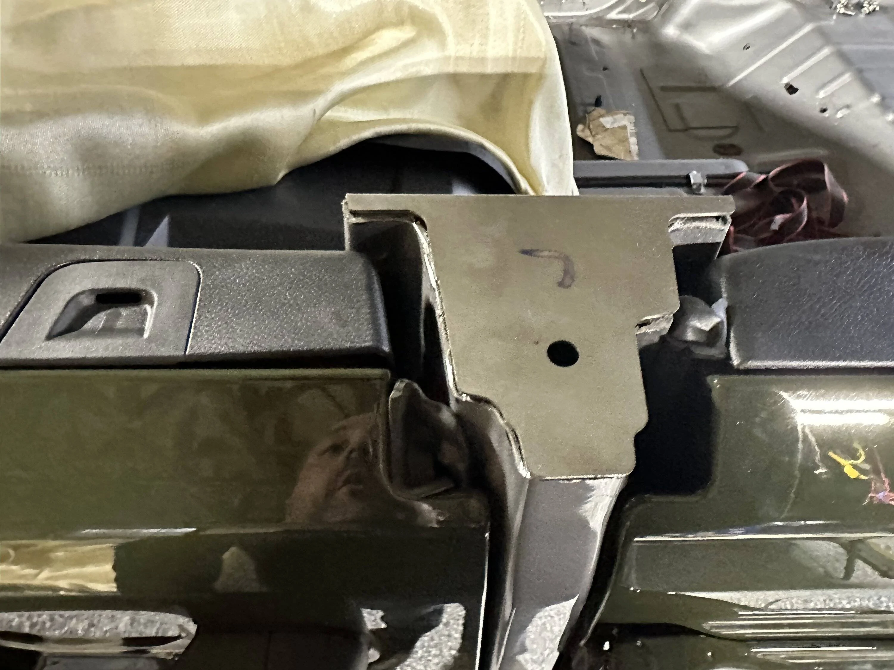

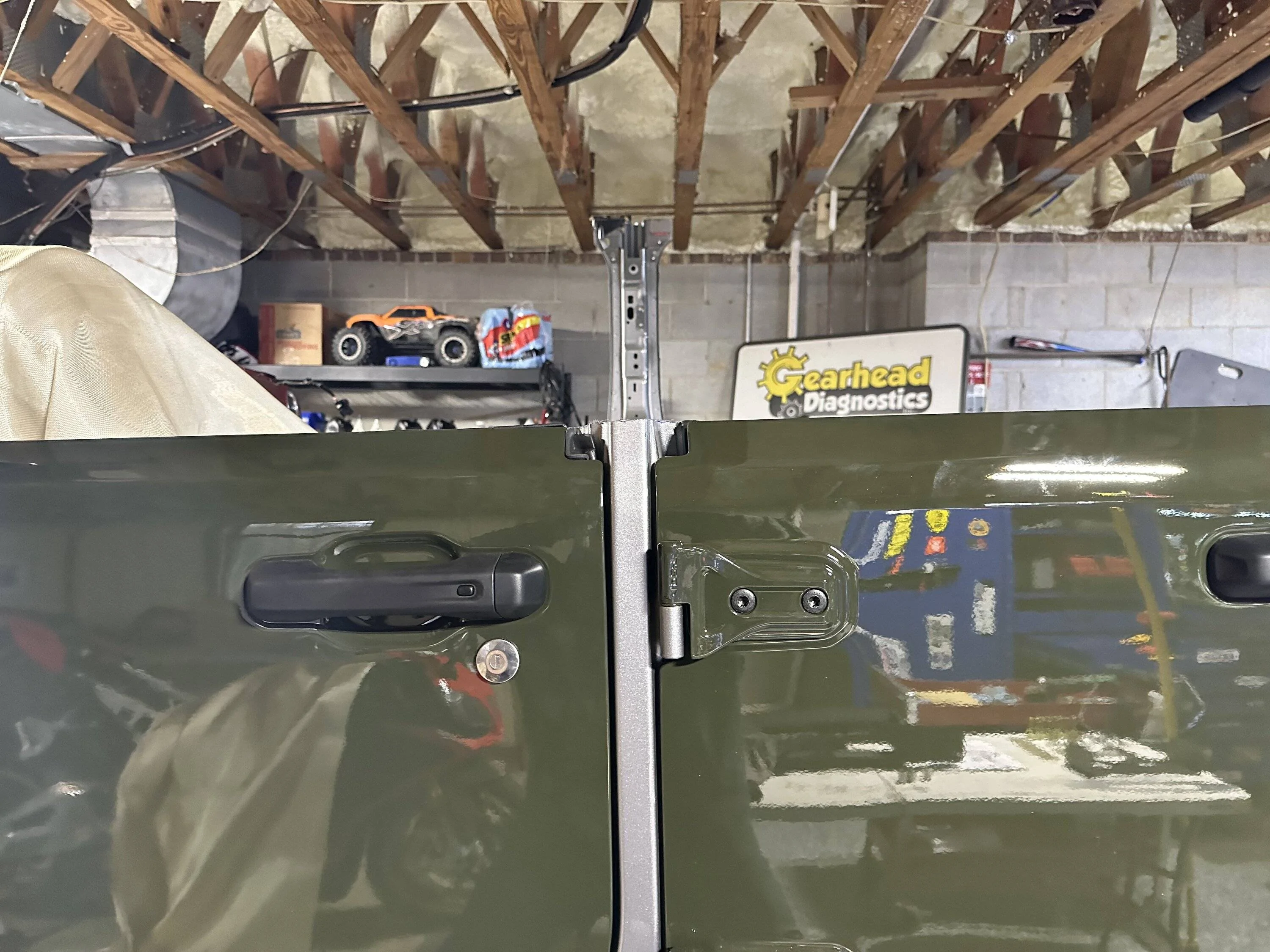

GenRight plates fit perfect using that template method.
The plates are made for their half doors but this worked perfect for the factory half doors.
Pretty happy with this.
