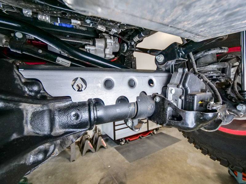

Artec - ~1/8” designed for strength and light weight:
Jeep Wrangler JL Front axle truss options IMG_3010

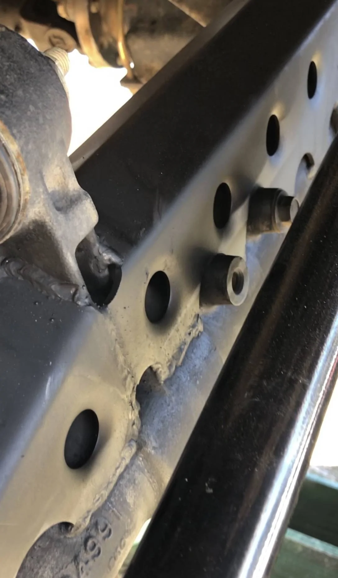

Barnes4WD - $80 3/16” says ~2” lift. Bridge over FAD
Jeep Wrangler JL Front axle truss options IMG_3013

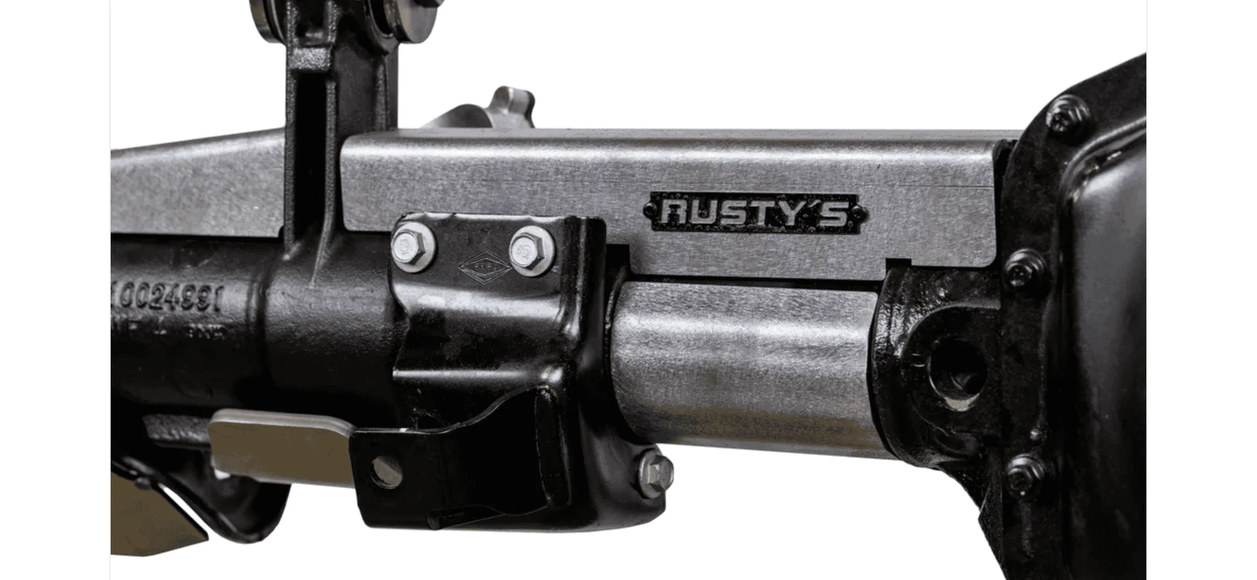

Rustys - $179 3/16”. collar under center axle tube, no lift description
Jeep Wrangler JL Front axle truss options IMG_3014

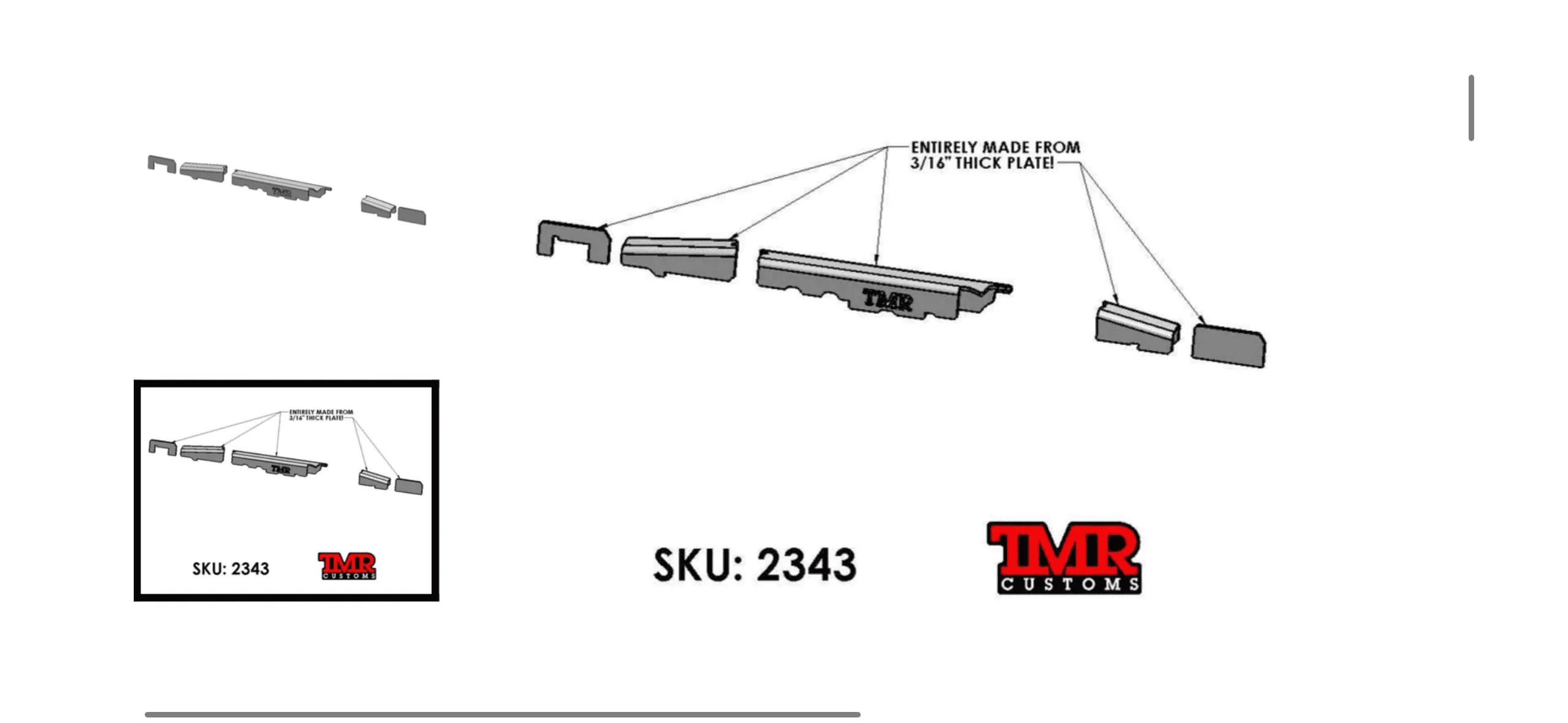

TMR customs - $119 3/16”. Says 1.5” lift
Jeep Wrangler JL Front axle truss options IMG_3016

I have the full Artec set front and rear (trusses, gussets, and skids).
Don't let the lightweight design fool anyone...the shape when welded in is as strong if not stronger than thicker designs.
I also have the Artec truss front and rear. For the same reasons.

I welded the Barnes front truss on mine and ran into the clearance issue (because I didn't read the instructions lol) If I could do it again, I like that Rustys truss because of its low profile, although I'd put a couple drain holes along the bottom edge.

I like how the Barnes bridges over the FAD, what kind of clearance issue? Frame, oil pan? What bump stop?
fat_head
Mar 28, 2018
1,055
2,305
2018 JLU

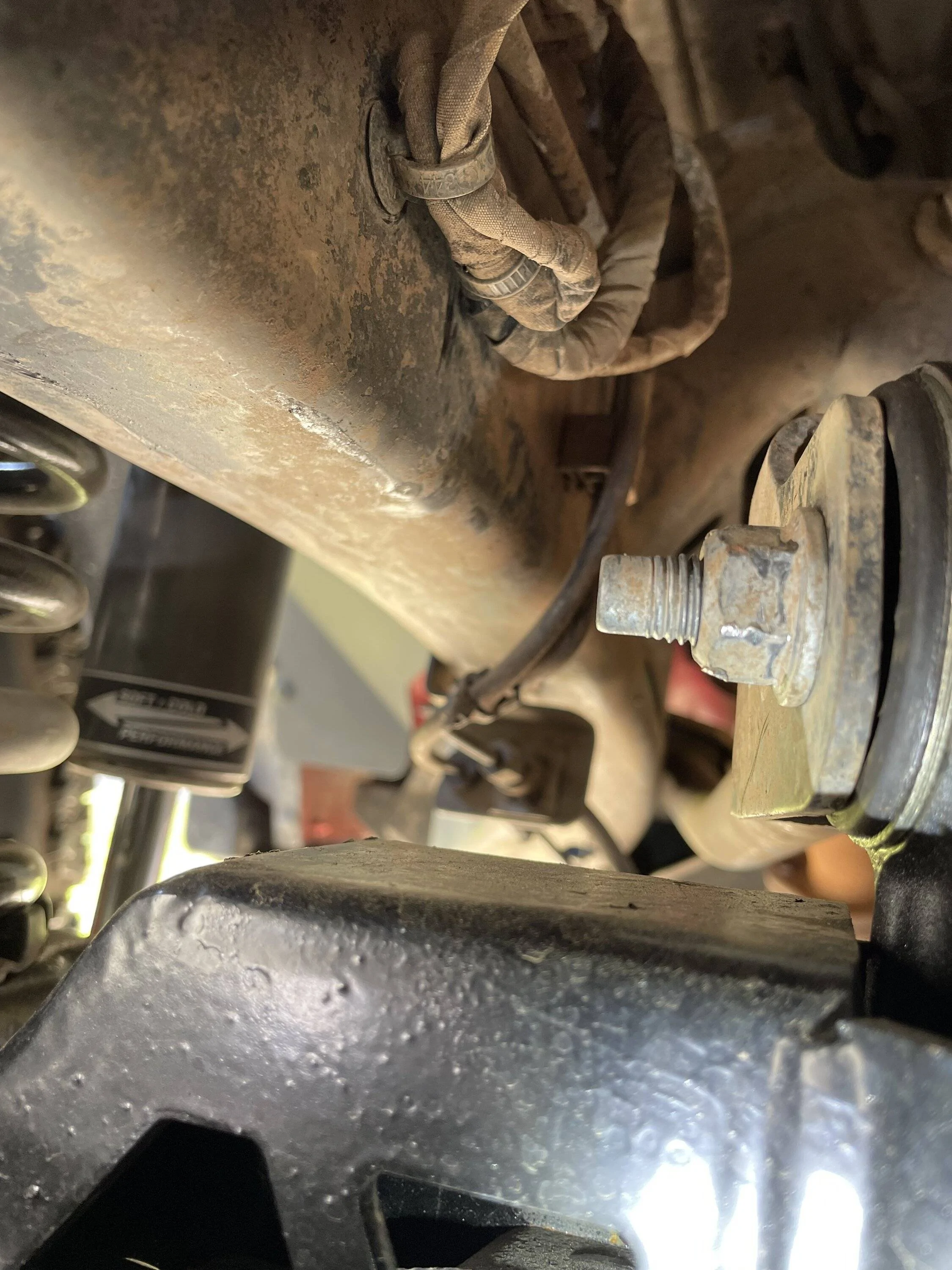

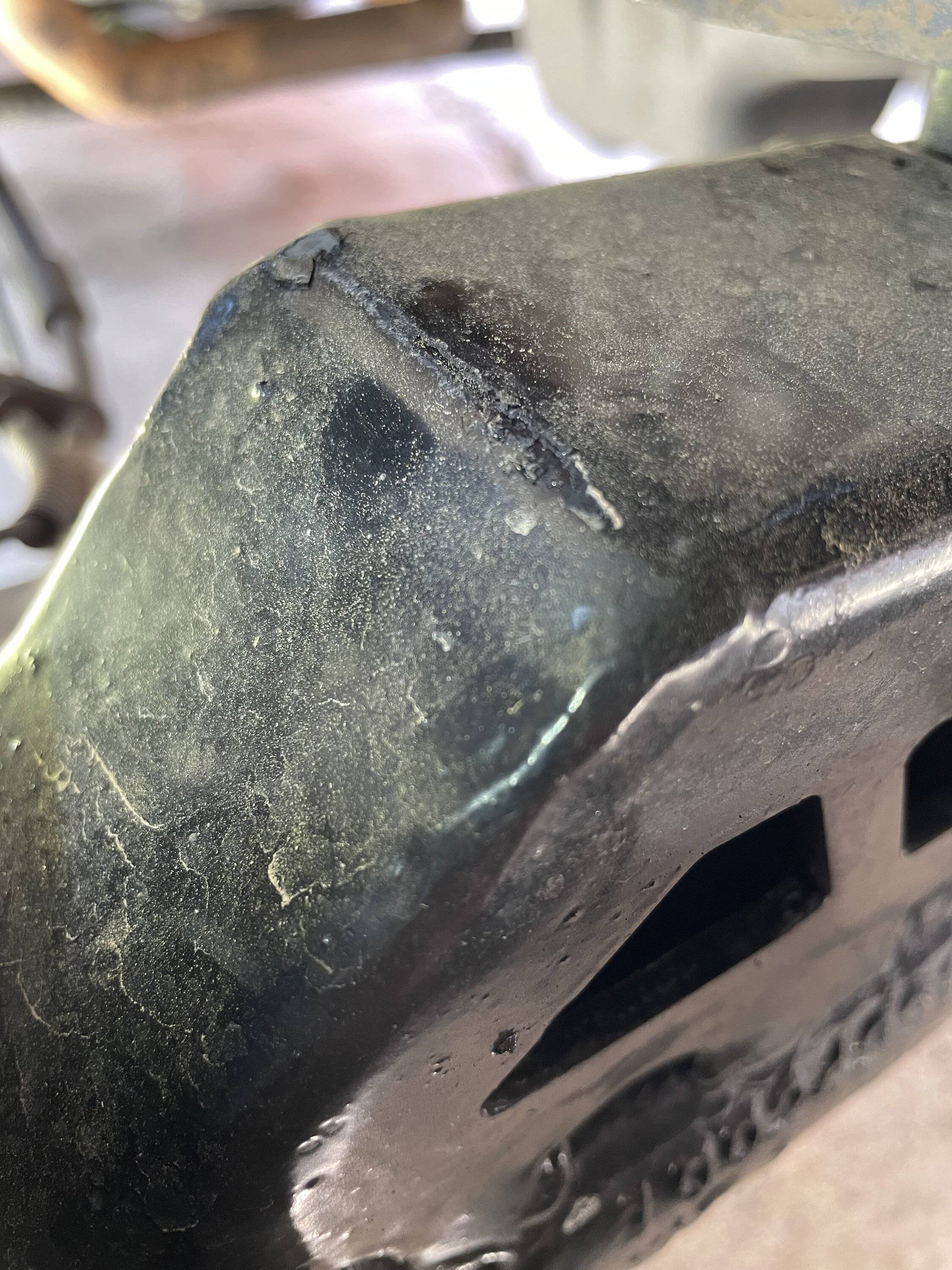

Jeep Wrangler JL Front axle truss options IMG_6917
Jeep Wrangler JL Front axle truss options IMG_6916
The top of the truss was making contact with the frame of the Jeep. Had to install bump stop extensions. Also, the barnes truss only crosses/bridges the FAD on one side (front side). I added a piece of steel to bridge it and tie it all together on the back side. That clearance problem I don't think I would have had with that lower profie truss.
Thanks - Rusty’s definitely looks appreciably lower… actually they all angle down and look lower lateral to the UCA bracket compared to the more square Barnes?

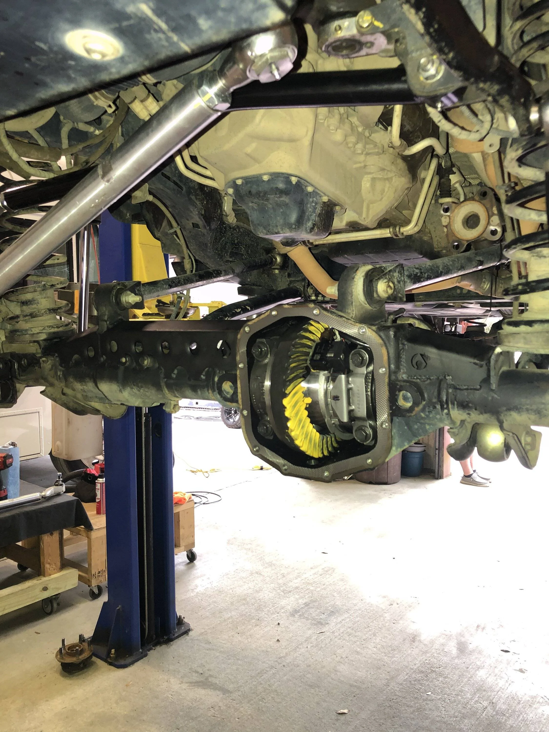

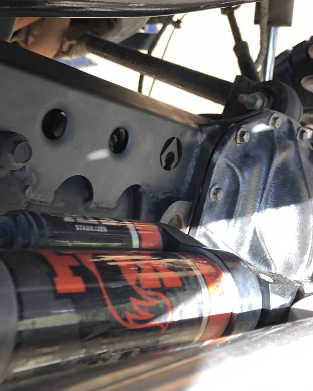

Late to the party, but here’s some pics of Artec…..I just wanted the fad reinforced, so I didn’t do under spring perch, or Cs ……
Jeep Wrangler JL Front axle truss options 23A373CC-7C21-448A-8FA5-AE87ABCFADFC
Jeep Wrangler JL Front axle truss options C82A8EE2-49F1-45CB-972B-63B2C0FFFD92
Jeep Wrangler JL Front axle truss options 09DAA4A5-4ABC-4228-B7CD-1F2BC06C083F
