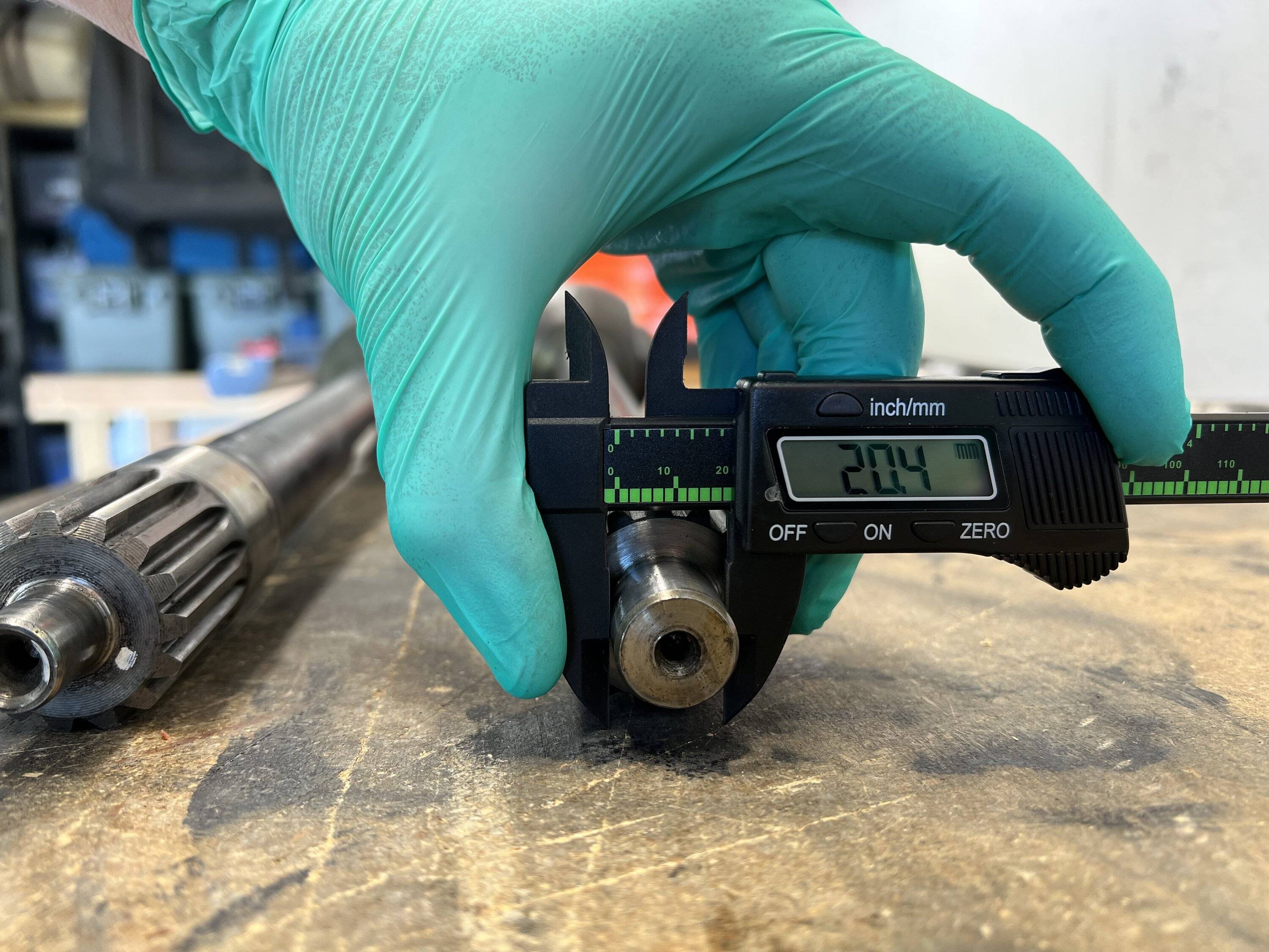

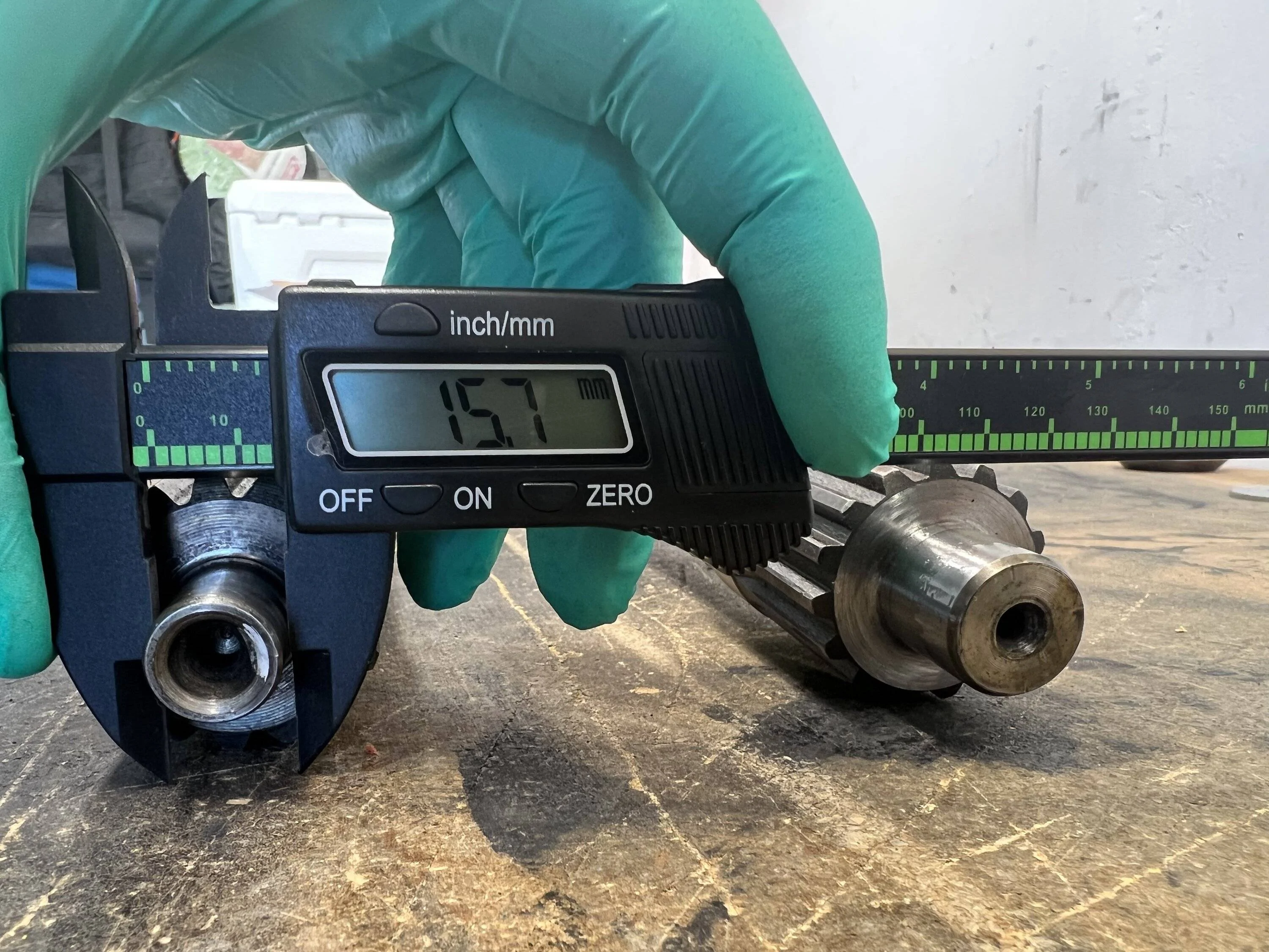

Quite a bit that would need to be milled off the DS nipple. Hmmm?

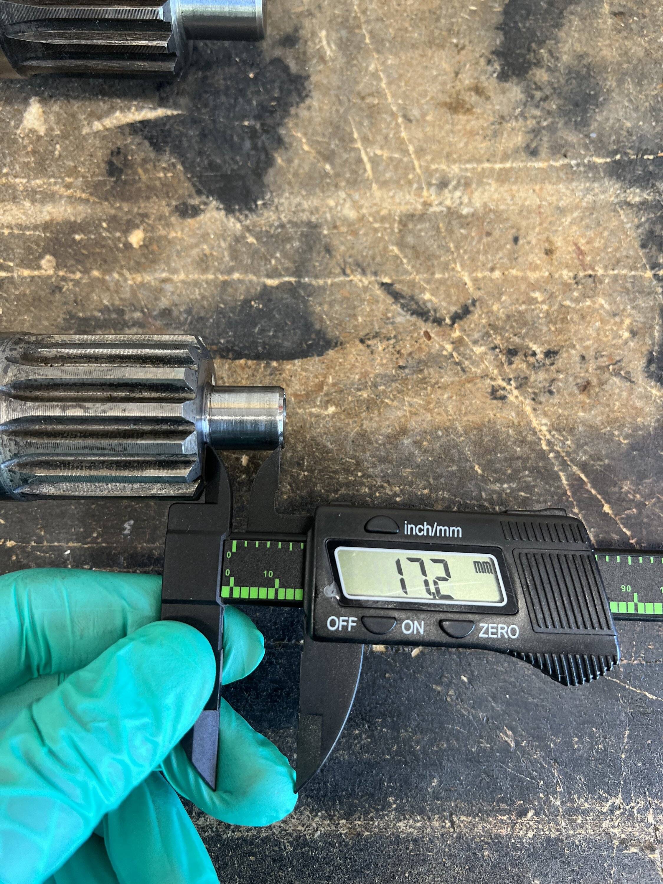

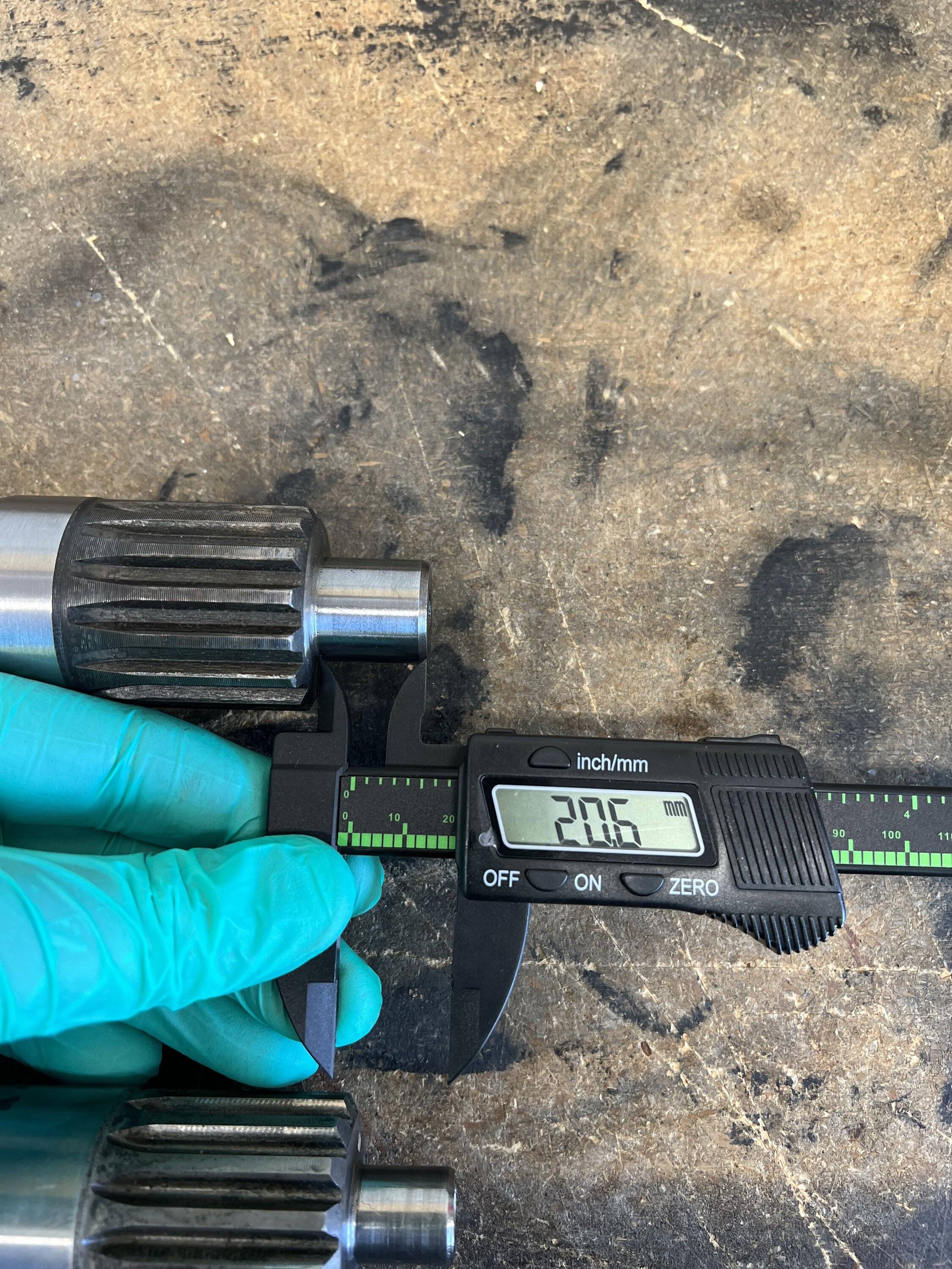

The lengths of the nipples are different too. The DS is longer

This explains why my shafts bound up and the nipple was galled. I am not understanding Dana's logic in this design. The FAD delete kit bushing does not work either so why is it included?
Also obvious, that unless you machine the DS nipple to match the OEM's dimensions you cannot use a bushing--plastic or otherwise.
