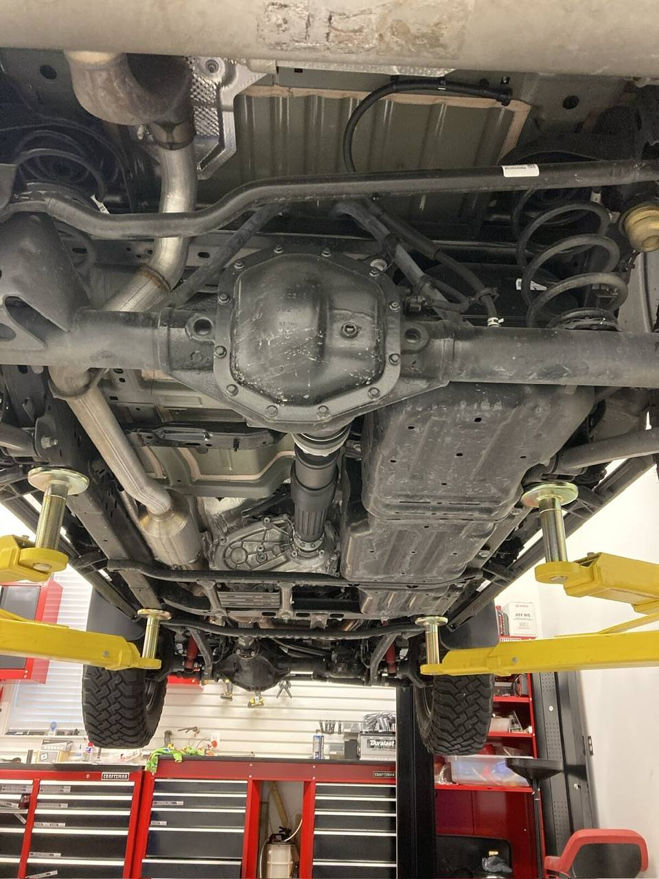

If you don’t want to do the axle, these are safe points on the jeep
Thanks for the pic! Since I'm only interested in the front end at this point, do you have a photo that shows the front a little better? Kind of difficult to see the actual contact points up there, but no worries if you don't have a photo from the opposite direction.
One other question....while these points may be safe to use together with the weight evenly distributed across all four, does that necessarily mean that they are safe to use individually?
I used them individually, but take a look at this link https://thptnganamst.edu.vn/actualizar-61-imagen-jack-points-jeep-wrangler/

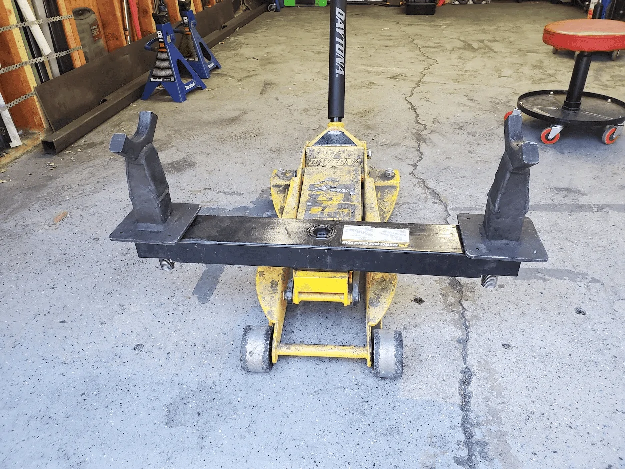

OK, I know this is a pretty lame question with a simple answer so please don't beat me up.
Just got a new floor jack and want to jack the entire front end of my stock, 2-door Sport. The front diff is offset to the driver side, so I can't jack from that point, but there seems to be sufficient bare axle tube available at the center point. This is the obvious contact point, but was just curious if jacking in this spot might damage something.
I know...dumb question, but I've always just used a scissor jack at each end and never had to think about this before. Appreciate any advice from our experts here on the forum, and thanks in advance for your help.
If you are able to fabricate stuff you could create something like this.. .it allows me to jack up either the entire front or rear of the rig...
Here is the related forum thead:
https://www.jlwranglerforums.com/forum/threads/pumpkin-jacking.91305/post-2314551

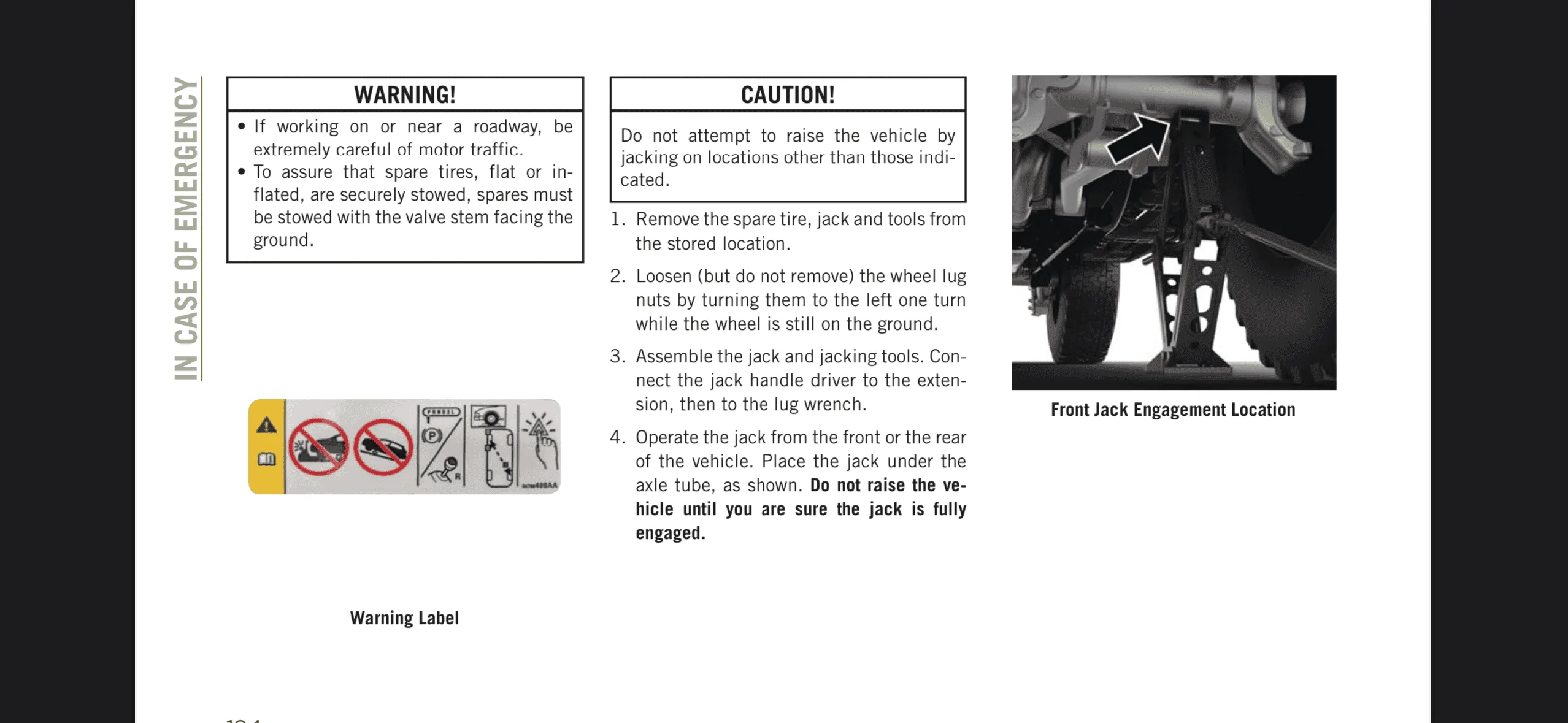

Thanks guys. These are two very different answers, and exactly the concerns/considerations that caused me to post my question in the first place. Definitely agree about avoiding the FAD too. Perhaps not a lame question after all, but I do appreciate the great input.
It’s covered in the manual. Axle tube is correct.
Thanks...I'm totally aware of the normal jacking points covered in the manual and perform this operation often. However, they are only for jacking one corner at a time. Even then, the two front corners are somewhat confined and don't accommodate a floor jack very well. Both of these issues were the basis of my original question, but I do appreciate you weighing in nonetheless.
