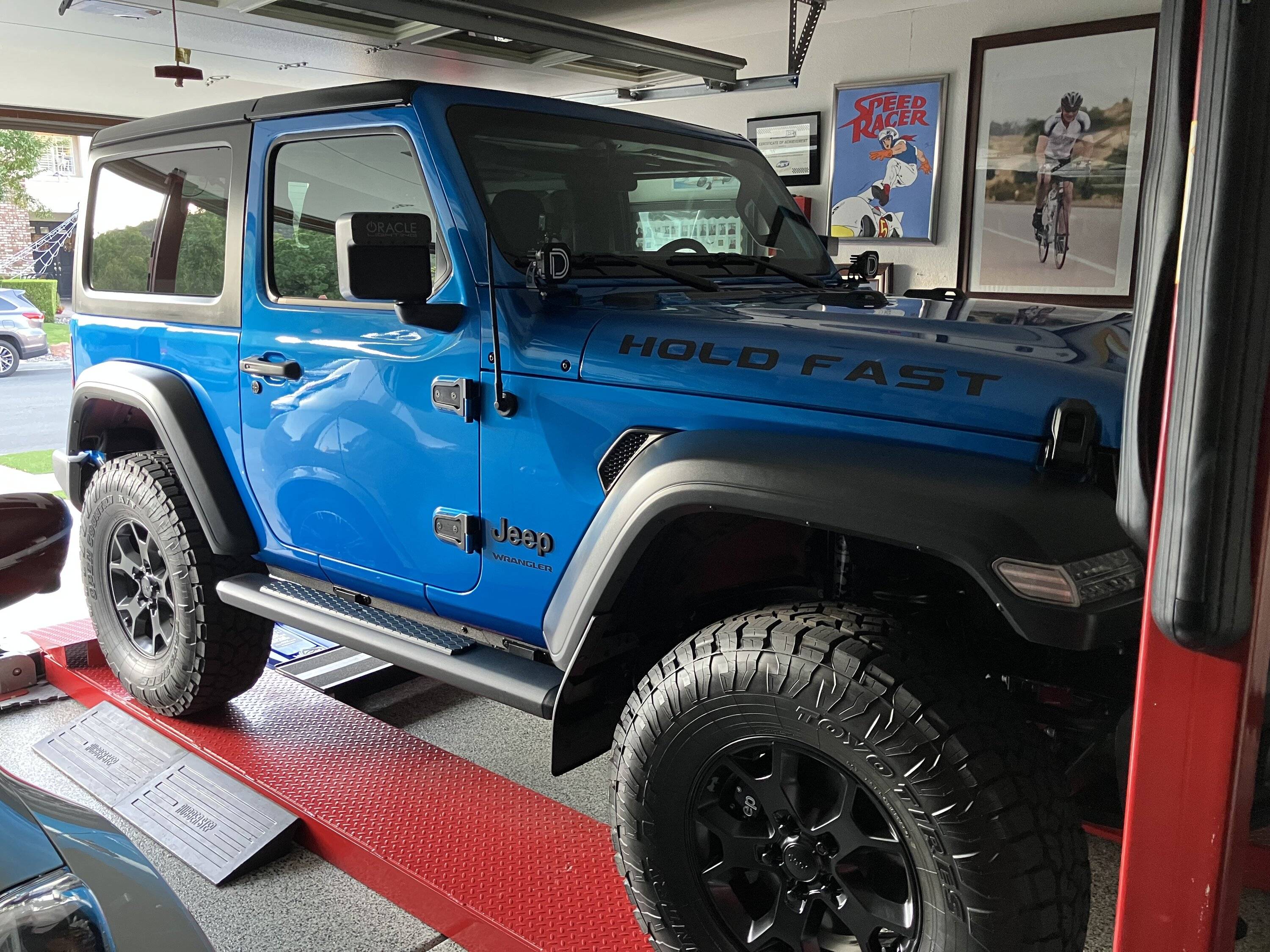

I wish, got that off the internet, I do have a four post backyard buddy, that works well, but disadvantage of wheels on ramps
That's still a pretty sweet setup...and a good looking 2-door as well!
Yep, like I said " you lucky dog! " ?
What side step/rock rails are those? They sure do look nice.
