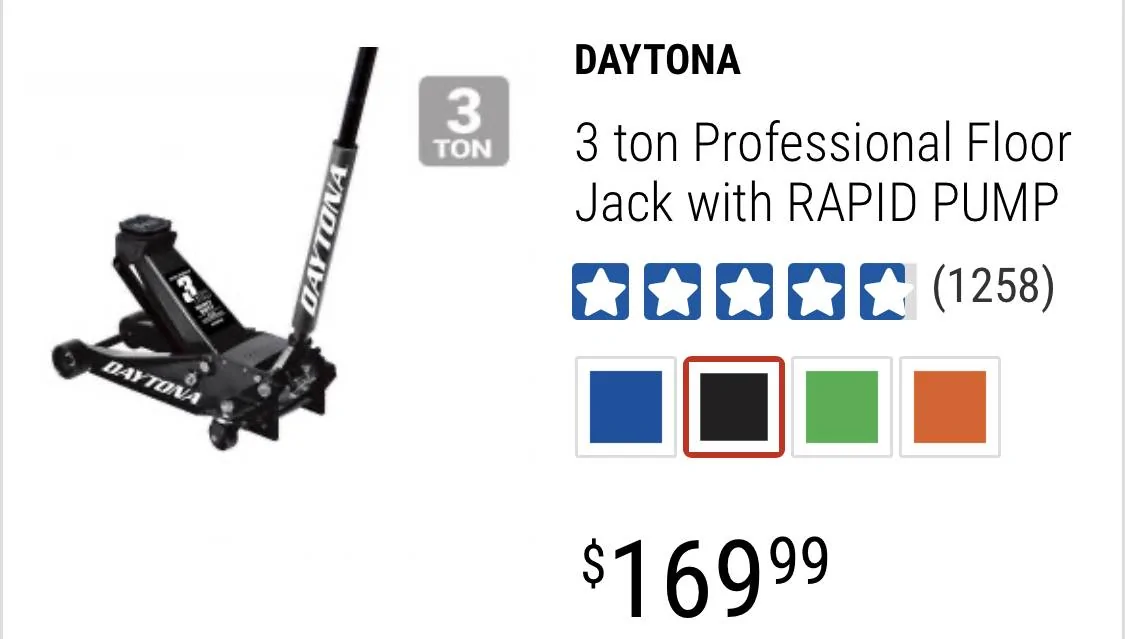

Looks like Project Farm has it figured out. The Daytona is the jack to get.

I love my HF Daytona. I have the super duty version, it has a ton of lift, which is why I bought it. I got it when they first came out and it works great. I did have an issue once for a bit where it wouldn't self lower when releasing it (had to step on the pad to lower it) but I changed the fluid in it and it's been good as new since.

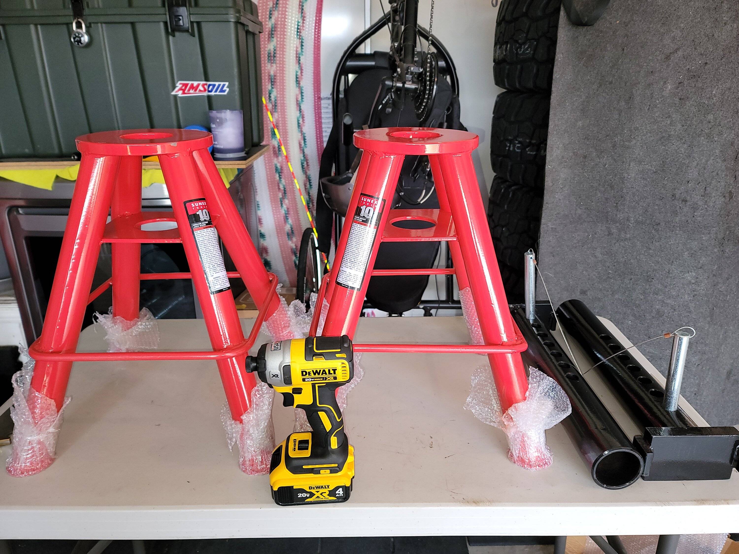

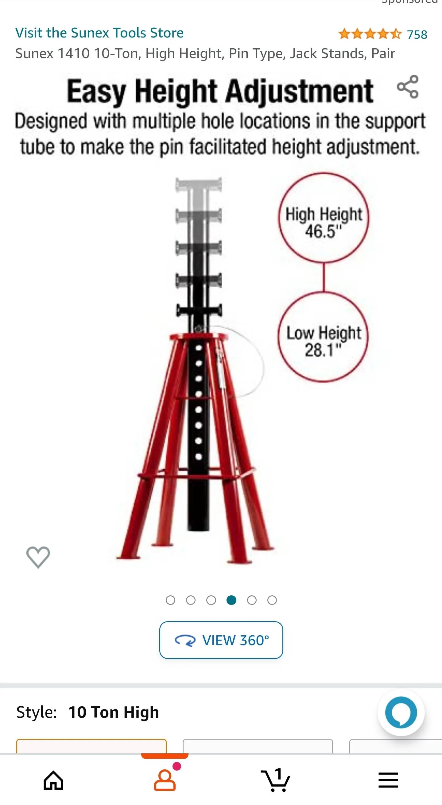

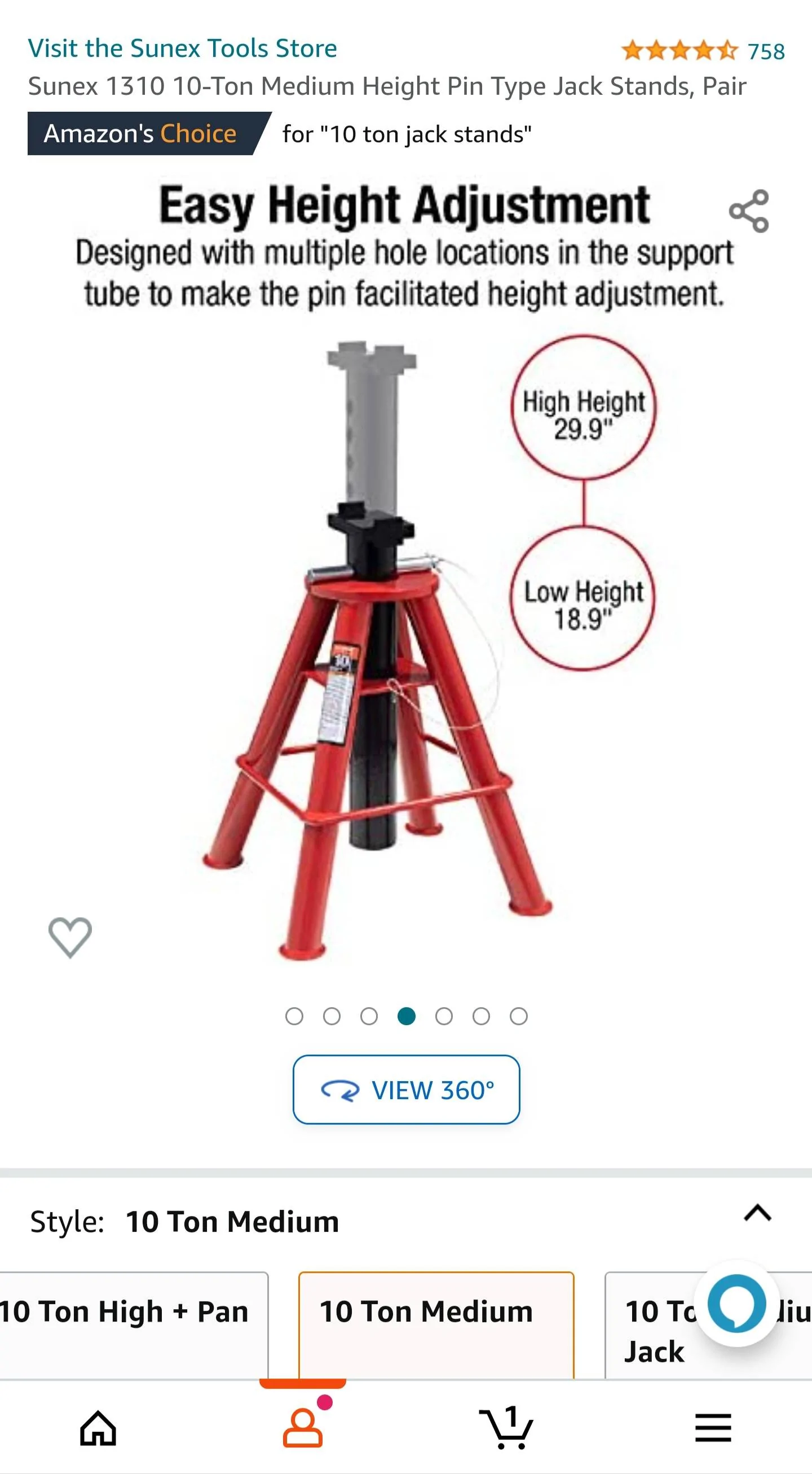

I would HIGHLY recommend you get 6 ton jack-stands. 3 ton stands are short for a stock jeep and too short for a lifted jeep. I learned the hard way.

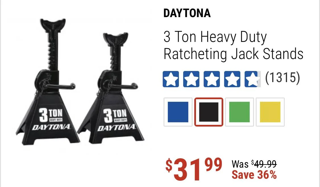

It’s floor Jack and stands? Save your money and go to harbor freight. Cheap Jack stands work great. And a cheap hydraulic Jack works great too.
