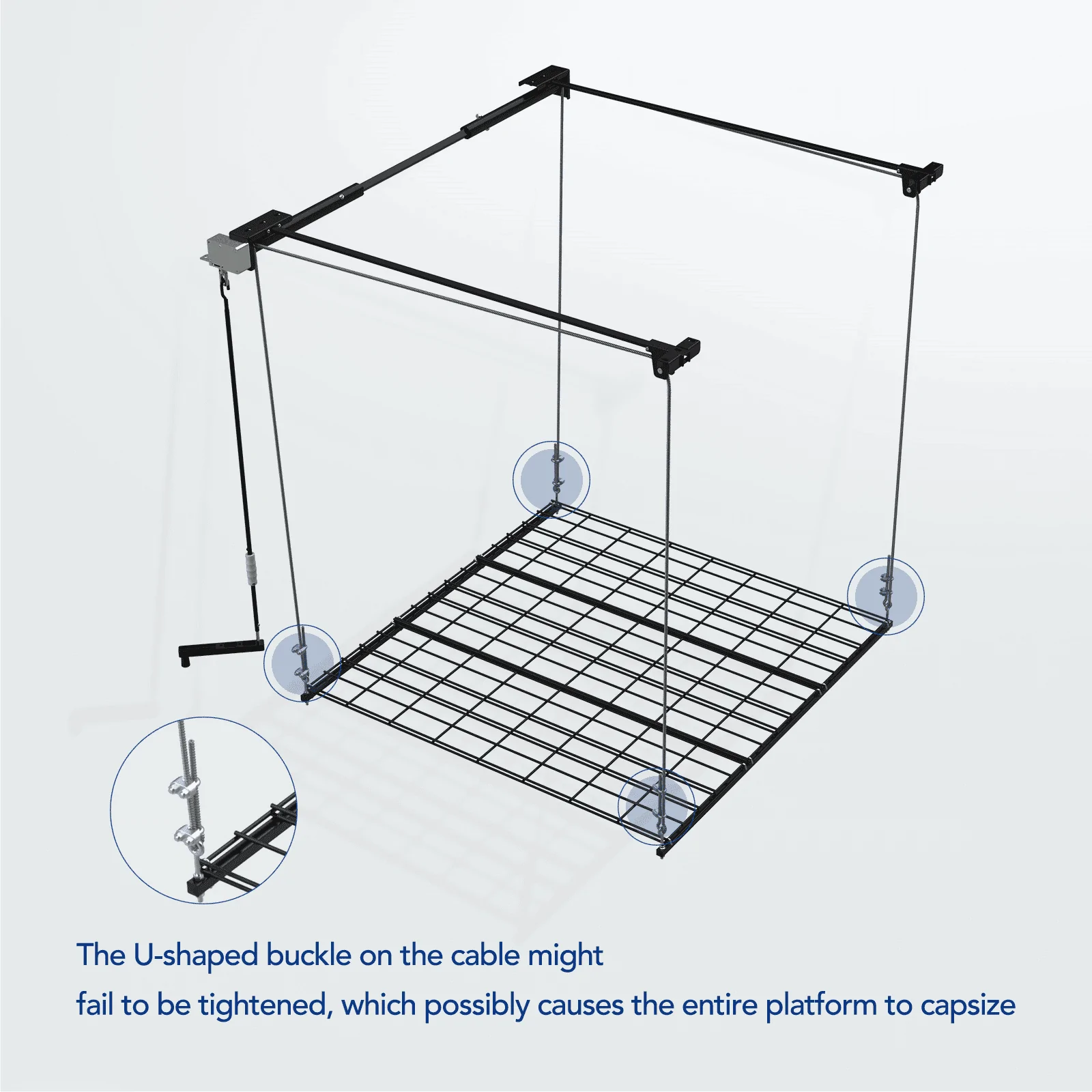

I had to tighten them during install after one corner failed empty.
It’s been hanging the hard top for 8 months now.
That’s good to hear. I’m hoping that’s all it is, just tightening those should be enough. It’s nice to know that yours is holding well.

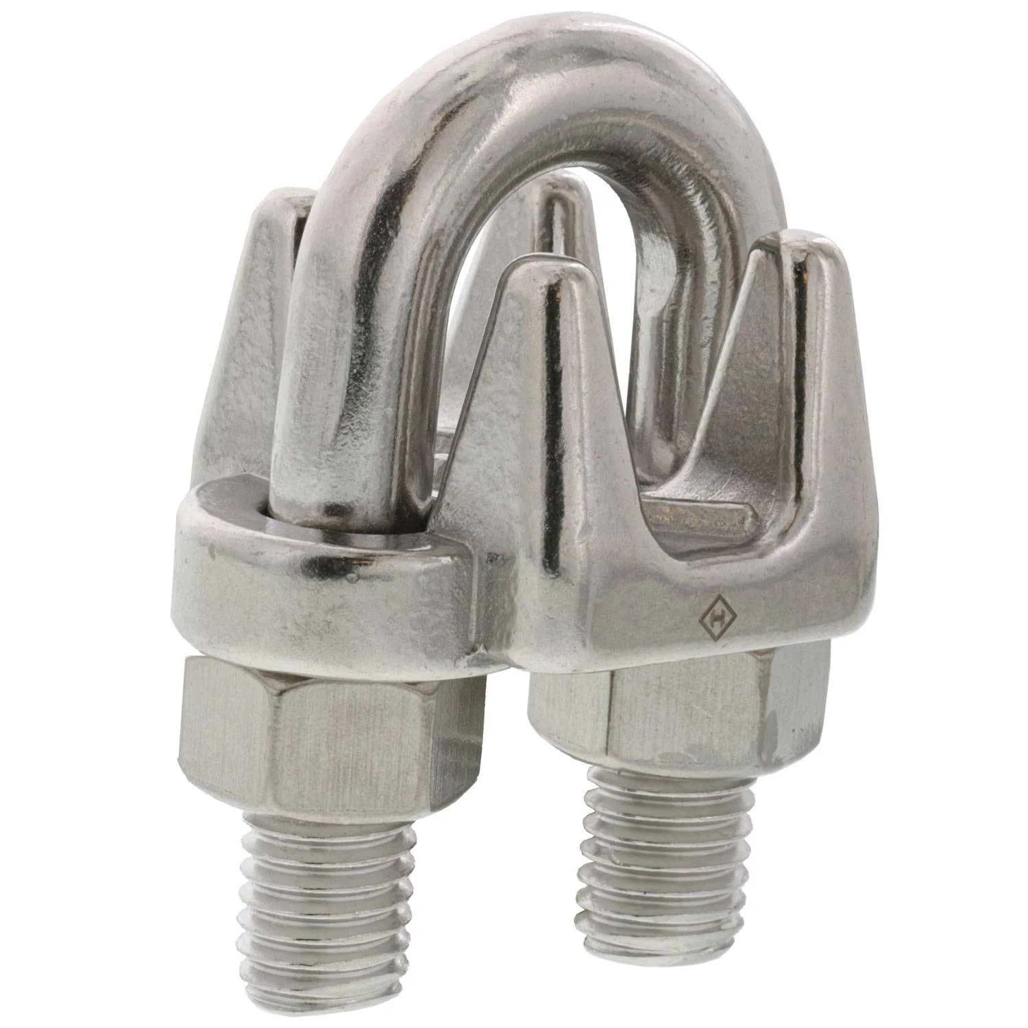

By U-bolt do you mean:
Yes, that's the U-bolt Travis is talking about. The ones that came from Fleximount were low quality and a couple stripped the threads in the cast piece when I tried to tighten them. I simply went to the local hardware and bought the same size, but better quality as I didn't want to take any chances. Only cost me a few bucks, the peace of mind was worth it. Otherwise, I have been very pleased with this system. I use my cordless drill to raise and lower and appreciate the degree of control over the process this method gives me.

3. I worry about this a bit. But there are a lot of people using it that seem to feel good about it. I hung on it, and I’m sure I weigh more than the hard top. There is a little more concern now that they’ve sent out emails to people saying to stop using it. You can see the details on that in the posts above. I’m pretty sure it is just because the ubolts aren’t completely tightened. Mine is just hanging with nothing on it yet.
