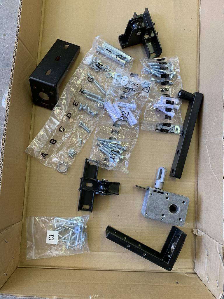

1. Everything comes neatly packaged and the hardware is labelled in a way that corresponds with the instructions. So there was zero difficulty in identifying the bits for any given step.
2. The welds appear to be of high quality, and the overall quality of the hardware isn't bad either. Not the finest I've seen, but it's much better than what I'm used to in kits like this.

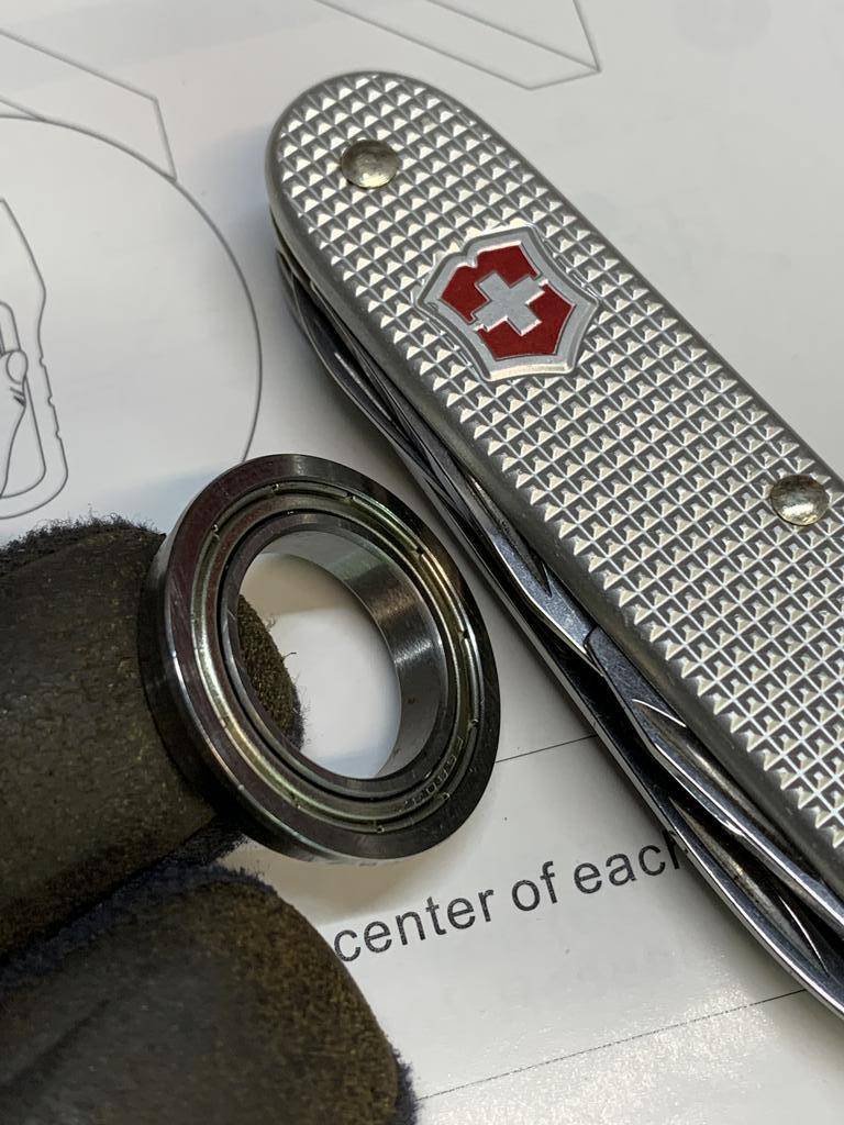

The bearing was oily and had good action. No flat spots or grinding in its action that I could detect.
The welds were smooth and nice, and the powder coat finish on all parts was also of high quality. No blisters, flaws, or peeling paint.
3. The first thing you do is install the bearing between the gearbox and one of the brackets. The bearing just presses in with your fingers. It was a perfect fit on mine. I could see grease in the gearbox's innards, and it appears to be of high quality. The case is cast metal, zinc I'm guessing.

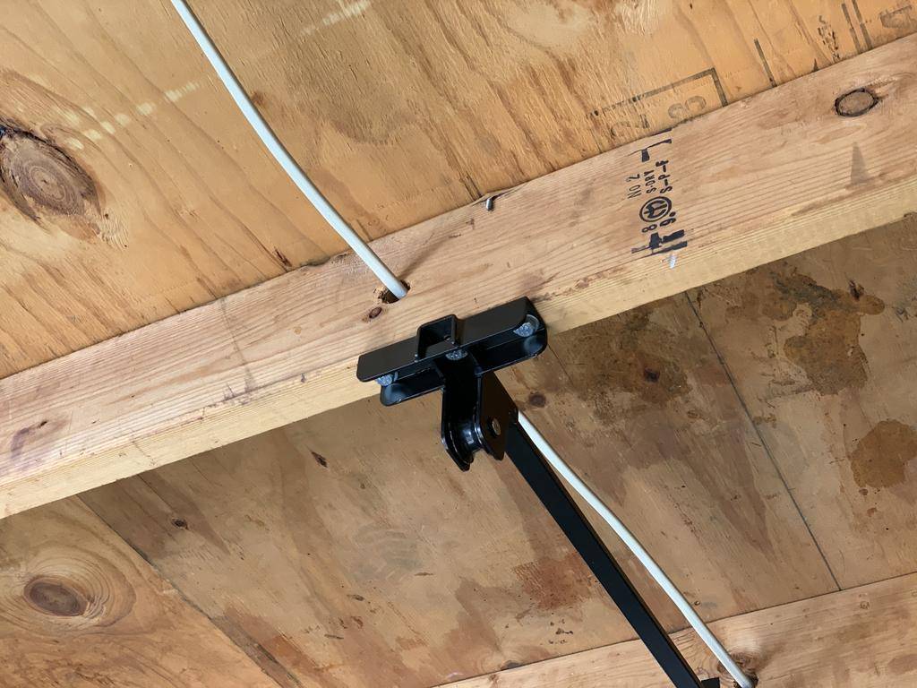

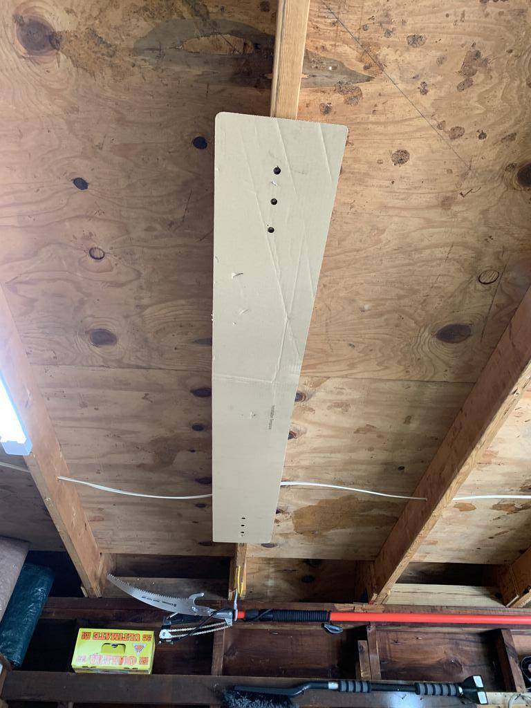

4. Next is to mount the corner brackets on your truss. Fleximount includes a template that spaces the three holes for each bracket exactly 48" apart. Since I was working alone, I used my staple gun and stapled the template on the underside of my truss, marked my holes with a sharpie, removed the template, drilled my holes, and mounted the brackets. The lag screws (3 per bracket), are of very good quality, and none of them broke off while I was screwing them in.

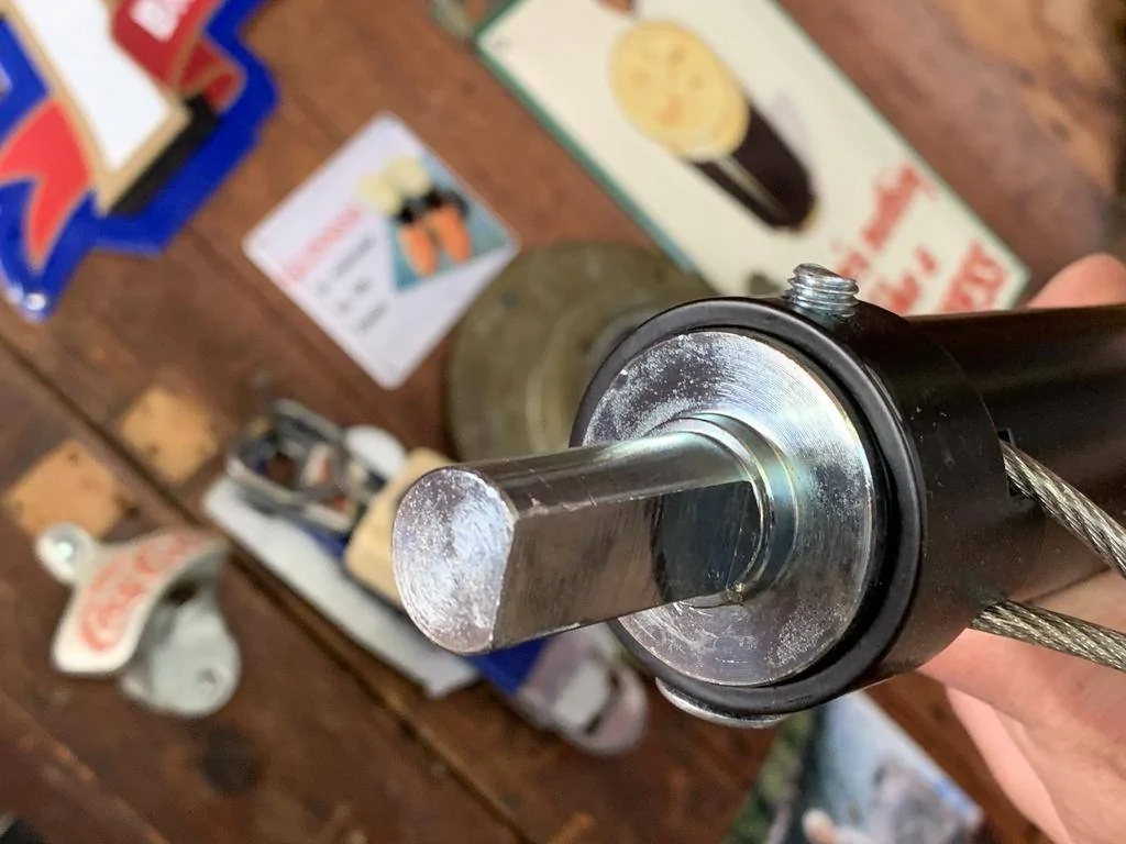

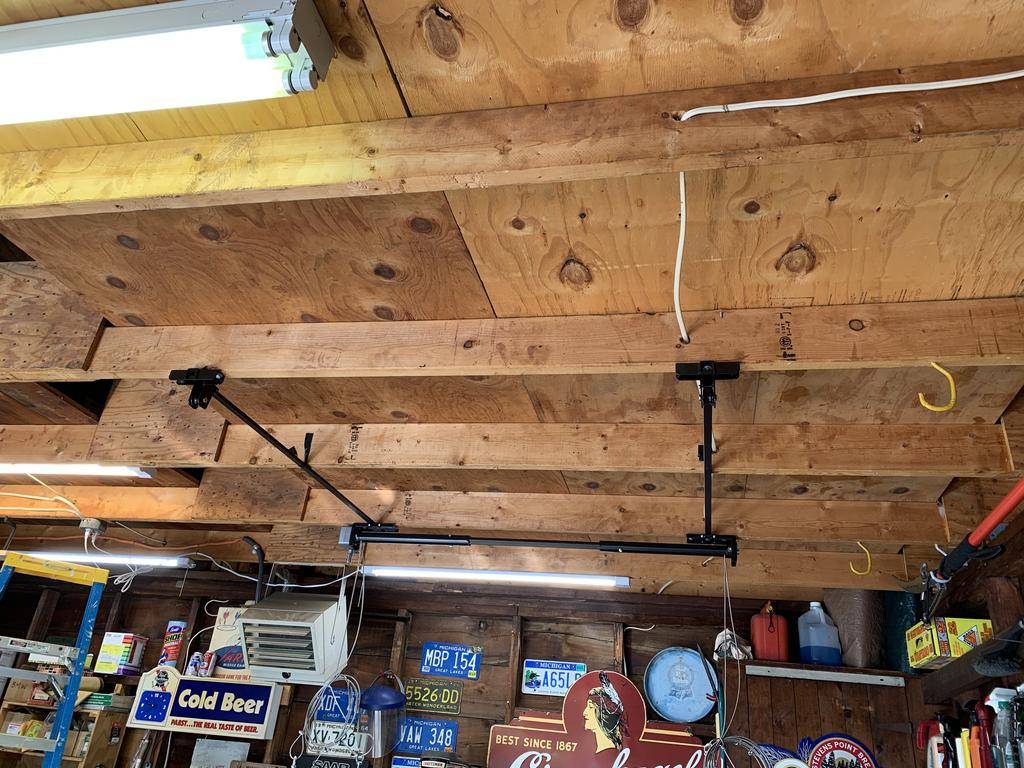

After fastening both corner brackets, the winding shaft is installed between them. The clever design of the winding shaft allows the brackets to be installed first, and then the shaft is expanded between the brackets, with small screws holding it in its expanded length. The end that goes into the gearbox has a flat on it, and the fit into the gearbox is snug. I actually had to give mine a few gentle taps with a dead blow hammer, and then it went right in.
Here's the winding shaft installed between the two corner brackets. The cables come coiled up like this from the factory. So far so good.
Here's the flat on the shaft that goes into the gearbox. You may need to gently tap this in (I did). A helper would be handy here too.

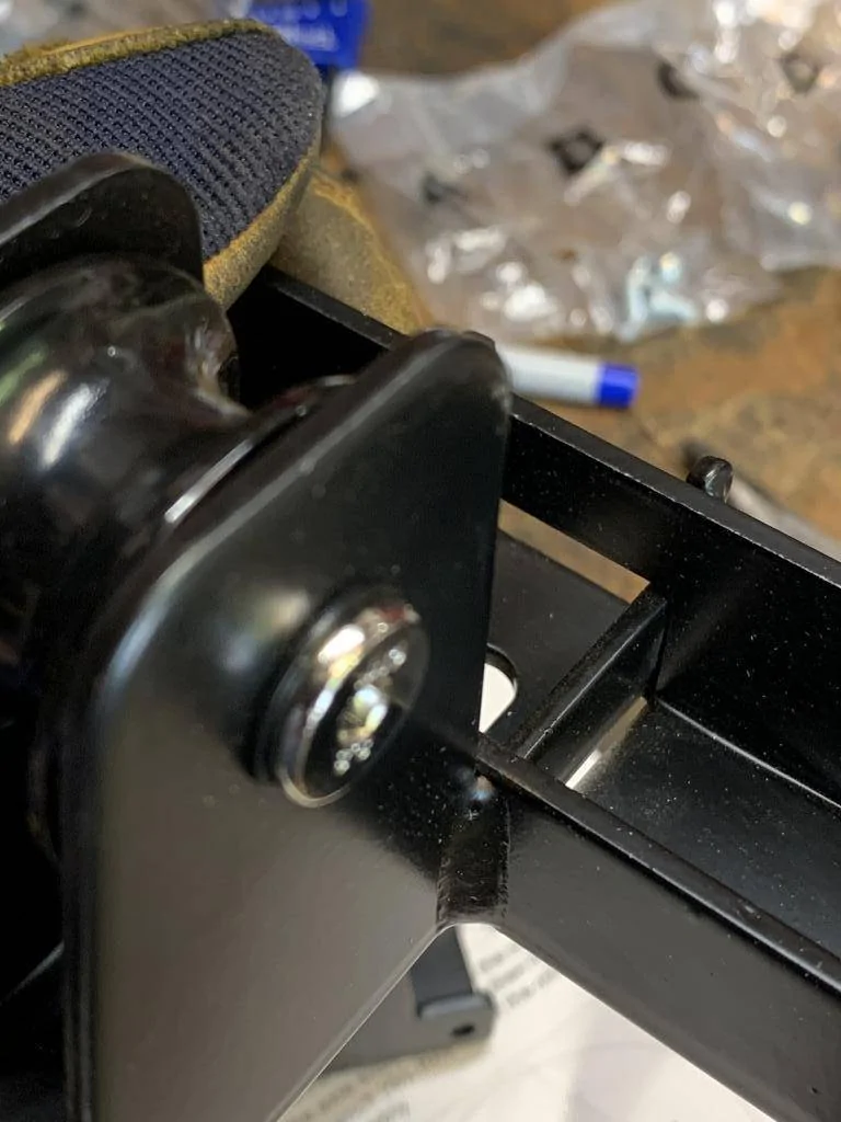

5. Perhaps the trickiest part, and where you will probably need a helper, is installing the bars that extend away from the corner brackets. It's tricky because you screw them into the corner brackets and then they have to be supported while you mark the opposite ends for drilling and fastening on the other truss 48" away. Since I didn't have a helper, I used Gorilla Tape to support them in the middle, and then stapled the Gorilla Tape for good measure.
You first fasten the latter pulley bracket to the bars using a screw that functions as a wrist pin. Then you drill and fasten the pulley brackets quickly before your Gorilla Tape fails. After the bars are installed, they look like this:

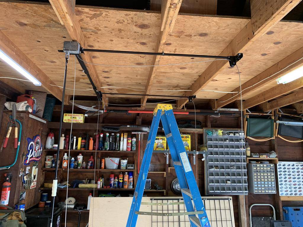

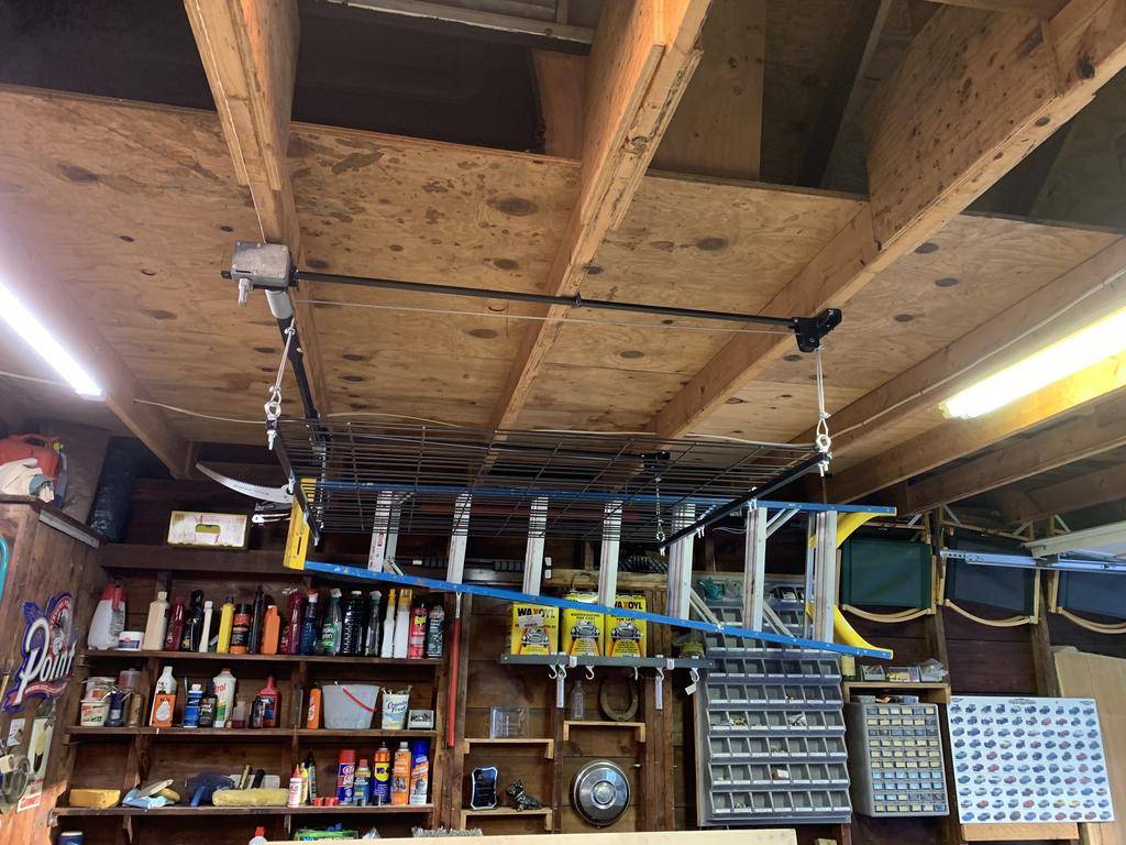

6. Next, you thread the far cable ends over the pulleys you just screwed to the truss. Now you have the main brackets and gearbox, two distant pulley brackets attached, and the four corners with cable terminals are hanging down ready for the basket.
This picture also shows the winding rod hooked into place on the gearbox drive connection.

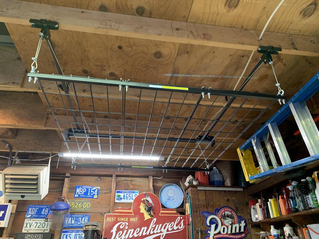

7. You're almost home free now. The basket fastens to two load bars using these somewhat janky "j-screws." Assemble the three wire panels that form the basket onto the load bars, and then put the eye-bolts (which look to be actually forged) through the corners of the load bars.

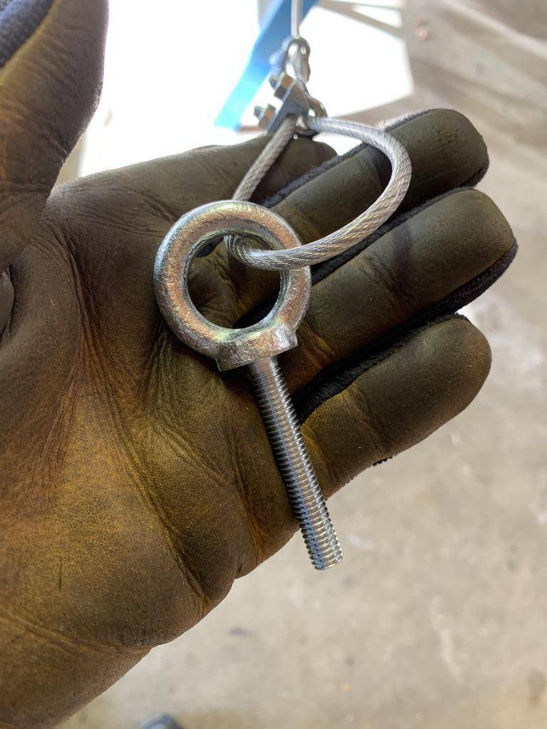

8. Crude adjustment happens at the cable crimps. Fine adjustment is possible using the jam nuts on the forged (?) eyelet bolts.
