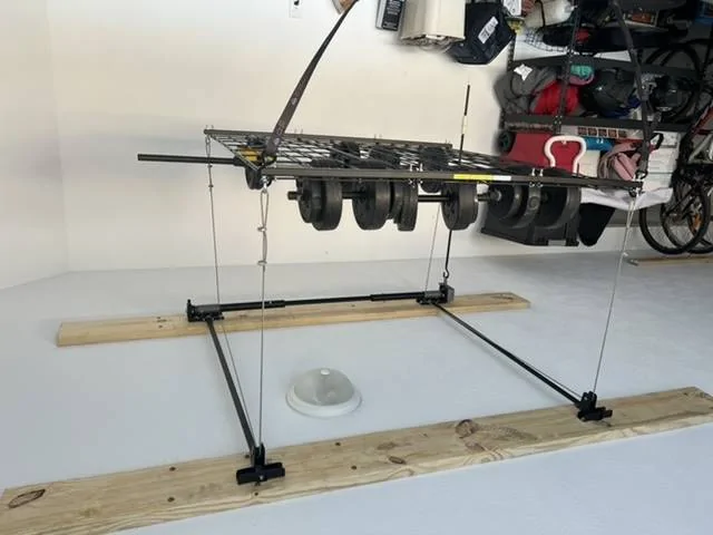

@Myron, @druggist55, or any others who are using this. How secure is this hoist? I have one installed, but it isn’t holding anything as I’m still waiting for my Jeep. However, I just got an email today from Fleximounts telling me I should demount it immediately. The email said that they have found some of the u-bolts aren’t tightened, which could cause it to fall. I did notice during my install that they weren’t all tightened, so I just tightened them myself. So, I think it is probably okay, but I wanted to hear from people who have actually been using it.
This is about 115 pounds sitting on it to test it all. Been about 12 hours. Gearbox is loud, but it’s working fine
Edit: not sure why the picture is flipping upside down…
